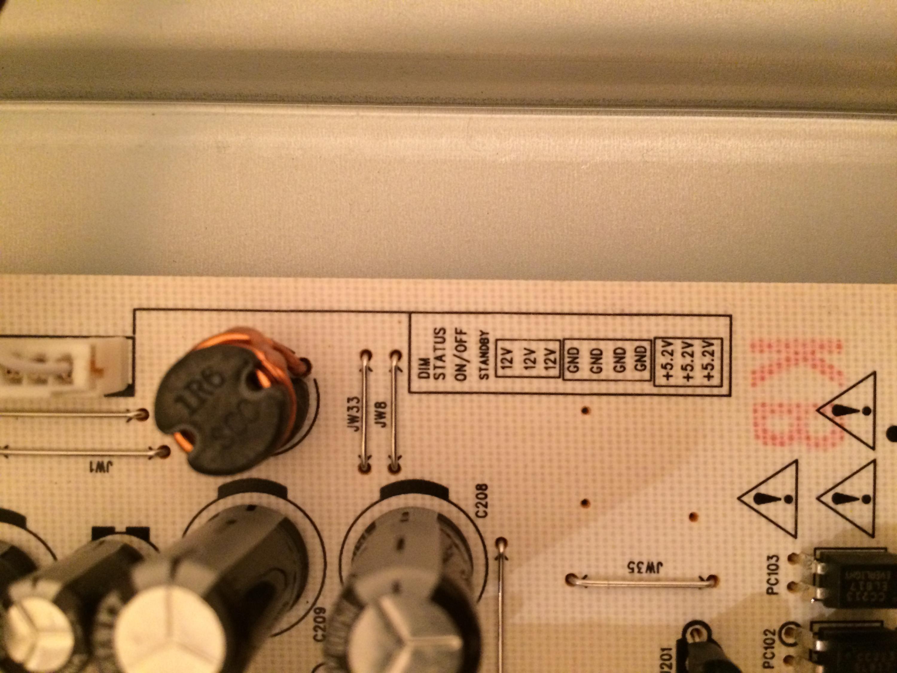

    I have a JVC JLC47BC3002 47" LCD TV that does not power on, and has no lights illuminated when plugged in. I got the TV in this condition, so I don't have a history of it.
    Visually, everything looks good to me on both the Main and Power board. I don't see any burned components, or bulging caps. I measured the voltages at some of the points on the Power board. I got 212.0 VAC on both sides of the main power fuse (the only fuse I found on the PCB).
    The only voltage I measured from the PCB to Main board connector was 5.14v at the labeled 5.2V terminals, all others were 0V. Full detail below.
    DIM = 0V
    Status = 0V
    On/Off = 0V
    Standby= 0V
    12V = 0V
    12V = 0V
    12V = 0V
    Grnd = 0V
    Grnd = 0V
    Grnd = 0V
    Grnd = 0V
    5.2V = 5.14V
    5.2V = 5.14V
    5.2V = 5.14V
    Any ideas on what to check next? Thanks for any help.

    Re: JVC JLC47BC3002 47" LCD TV Dead - No power on , no lights
    Looks like the main board isn't returning PSon / BLon. STBY voltage is there on the PSU. Equals main board problem.

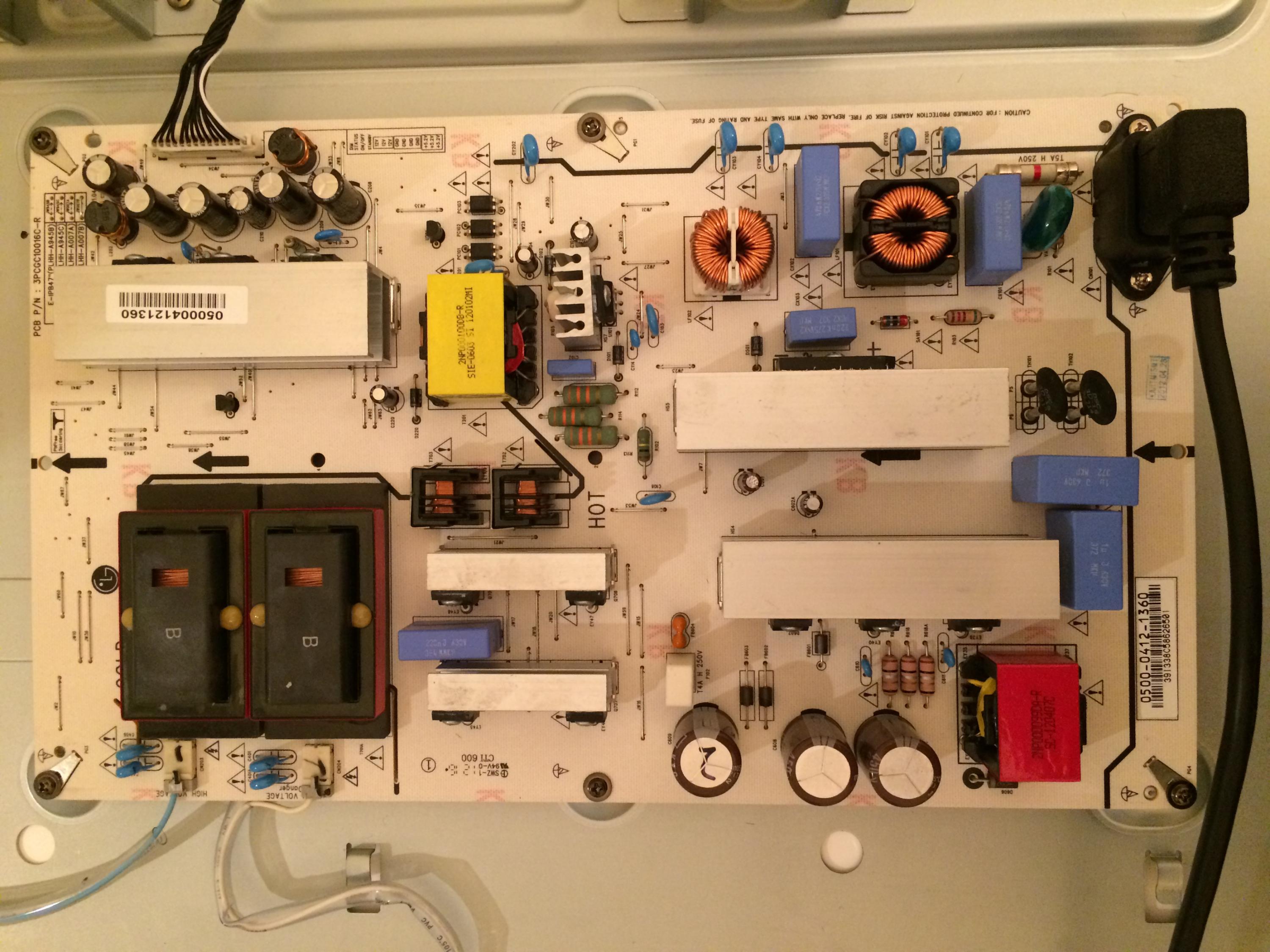

              You can try the PSU by unplugging the main board, leave the back lights connected. Then take two 1k ohm resistors and solder one from STBY voltage to On/Off and the other from STBY voltage to Standby. When you plug that PSU in, it should fully turn on and the back lights should be on too.
              As far as the main board goes, there is probably a "Mediatek" main processor. You can try reflowing it, but I'll give that only a small rate of success. Depending on you 'skill level' you may just want to replace the main board.
              In your case the Standby pin is PSon, the On/Off pin is BLon.
                Thanks for the input so far.
                Here is some more information with the cable to the main board disconnected. I still only see voltage on the bottom 3 pins (all labeled 5.2v). Today I am seeing voltage constantly varying between 5.14v to 5.23v. When I measured yesterday, it was solid at 5.14v.
                With the connector unplugged, there is still no voltage on any of the other pins.
                I can remove the board and check the voltages across the 3 largest capacitors (in the lower right portion of the board as shown in the first photo) if that would help diagnose things better.
                  If the main board doesn't return PSon and BLon, the PSU won't turn fully on. All you see is 5V, that's it until you either fix the main or force it on.
                    I'm pretty inexperienced at this, so just to be sure I'm understanding correctly, it appears that you are calling the three 5.2V terminals "STBY voltage". So I would solder a resistor between one of the three 5.2V terminals and the "Standby" pin to turn on the PSU, and then another resistor to the "On/Off" to check the power to the backlight.
                    After that is done, if the PSU is working properly, the backlight would be on, and the 12V terminals should show voltage.
                      More results:
                      I did not have any 1k ohm resistors, but I used two 3k ohm resistors that I had.
                      I connected the resistors from a 5.2V output to the "On/Off" and "Standby".
                      The backlight worked, and here are the voltages measured from the 14 pin connector output:
                      DIM = 3.33V
                      Status = 0V
                      On/Off = 4.64V
                      Standby= 5.21V
                      12V = 11.84V
                      12V = 11.84V
                      12V = 11.84V
                      Grnd = 0V
                      Grnd = 0V
                      Grnd = 0V
                      Grnd = 0V
                      5.2V = 5.30V
                      5.2V = 5.30V
                      5.2V = 5.30V
                      So from these results, am I correct in assuming the PSU is functioning properly and the main board is the problem, as CapLeaker suggested earlier in this thread?
                      • CapLeaker
                        Leaking Member
                        • Dec 2014
                        • 8352
                        Very good! You are on the right path!
                            Learning curve, yes... I fell for the same thing many moons ago. Trust me, there are a bunch of folks that get confused with that.
                            If you follow the pins on the PSU on picture #2. You need to have PSon and BLon. It can't be the Status or the DIM pin, so there are only 2 pins left. The Standby and the On/Off pin. There is no standard set by the manufacturers, just a bunch like to call them PSon and BLon because it is short and it does identify perfectly what is what.
                            Also you could trace it out on the back side of the PSU.
