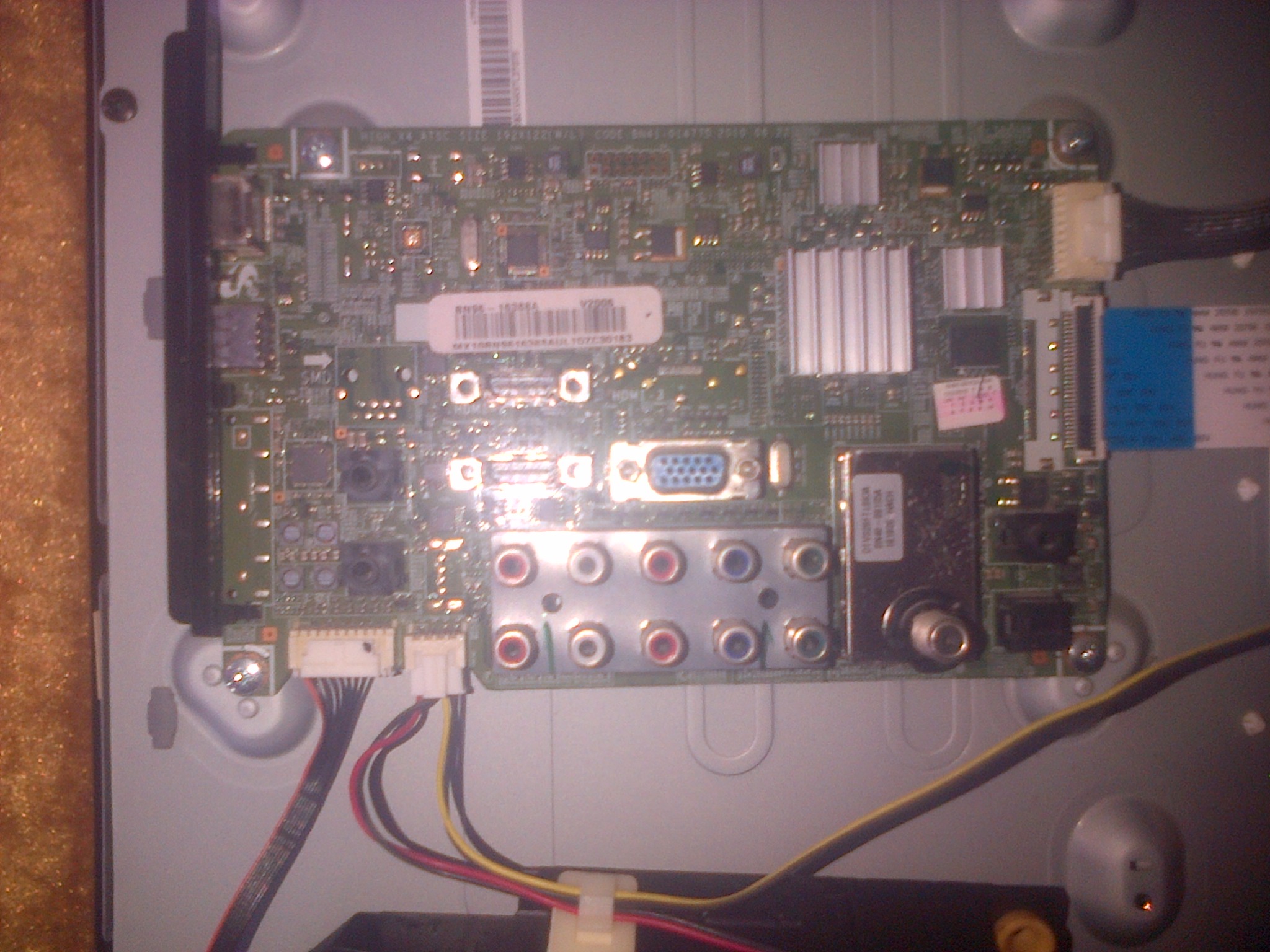

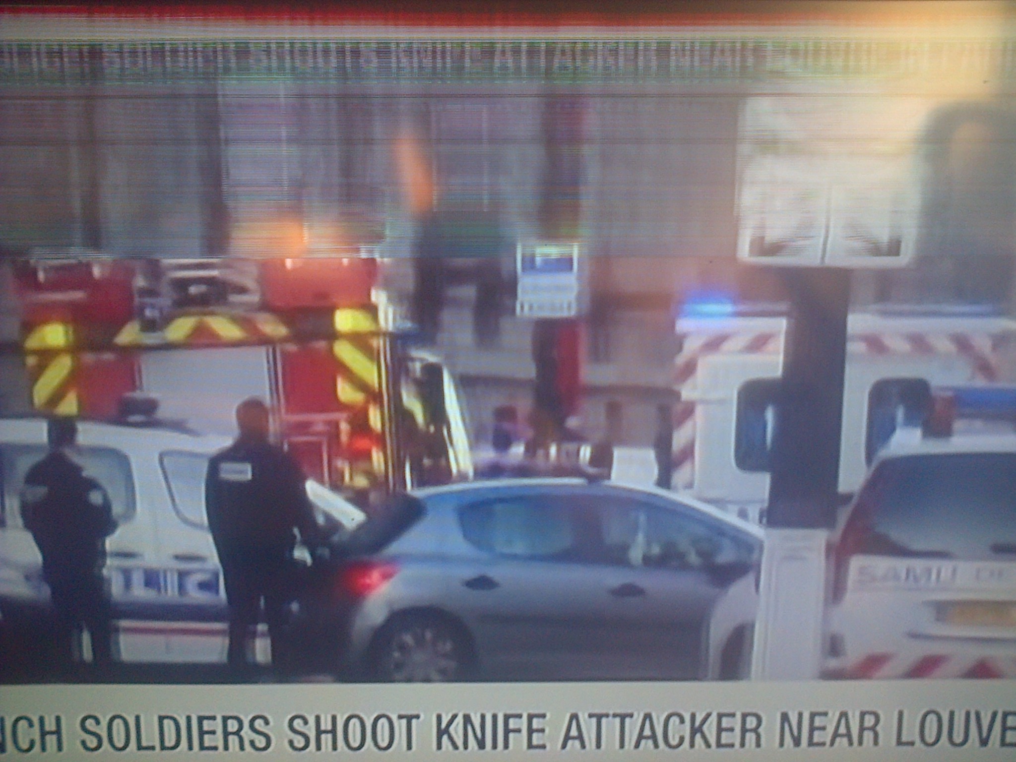

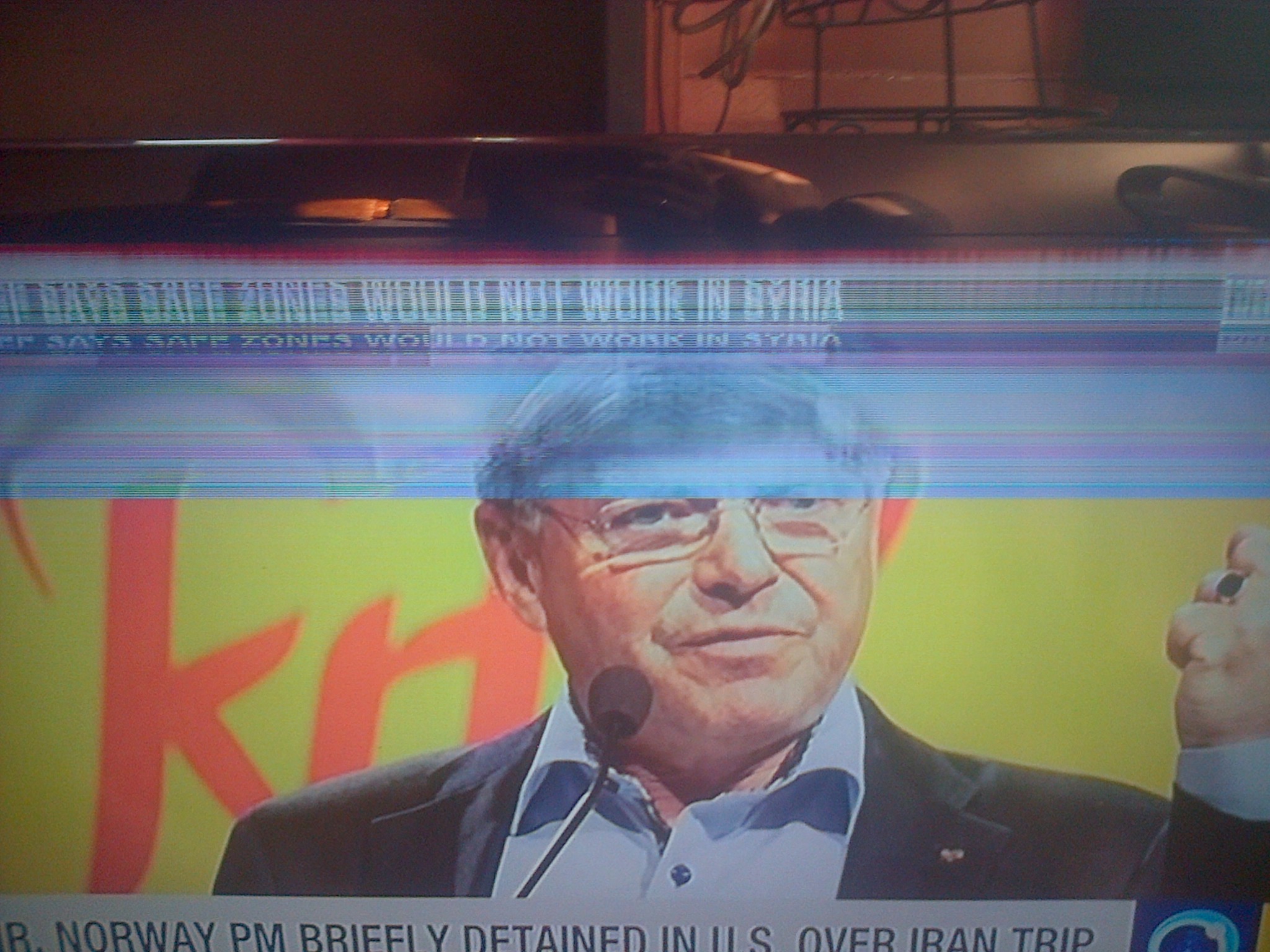

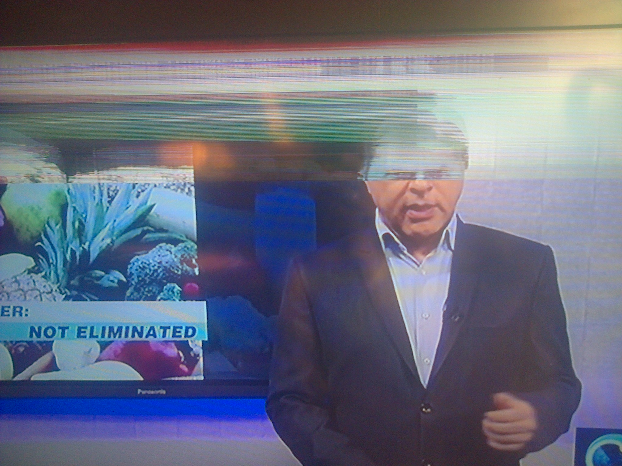

    I am servicing a Samsung LN32C450E1D with horizontal lines at the top of the screen.These lines appear about 20 minutes after the television has been switched on.The photos failed to upload on the previous posted thread.

    For myself would be having a hard look at tcon.

      I also believe that this is a tcon problem but it is bonded to the panel.

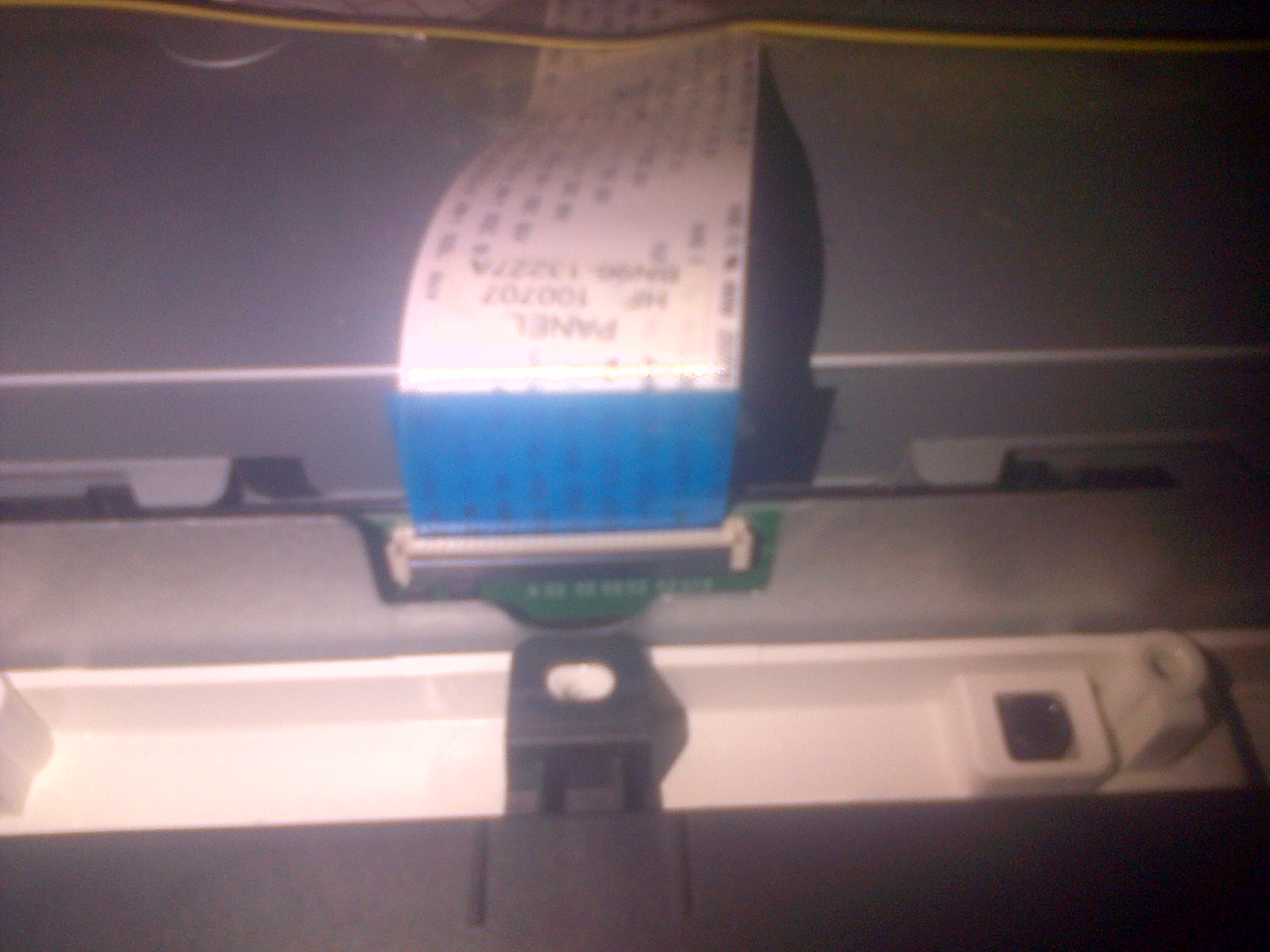

        While still mounted and when problem apparent try wiggling lvds about a bit carefully though to see what happens and also try cooling tcon down with fan especially ICs. The board is more likely "stuck" to spacer blocks rather than bonded but I don't know this model at all.
