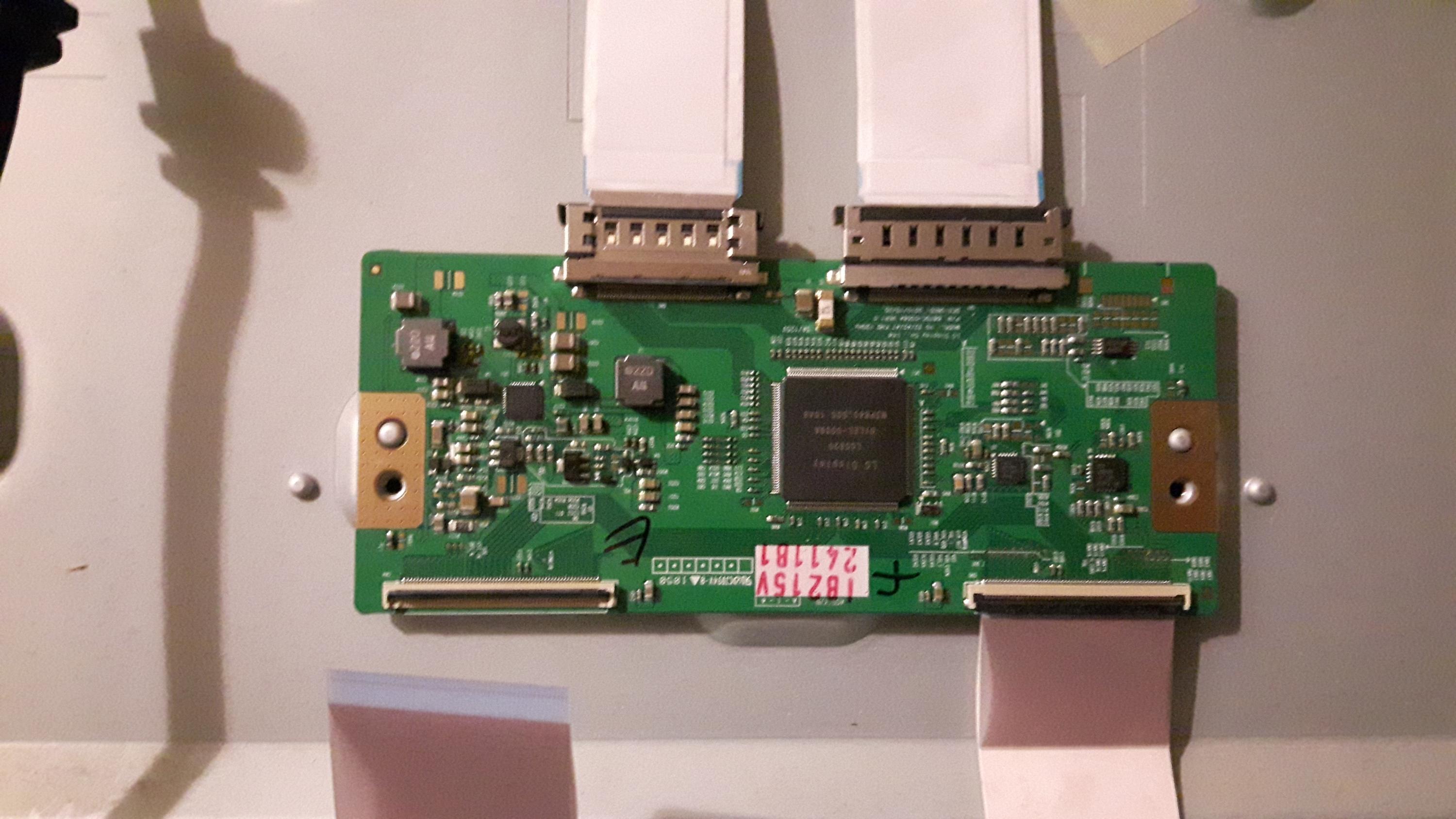

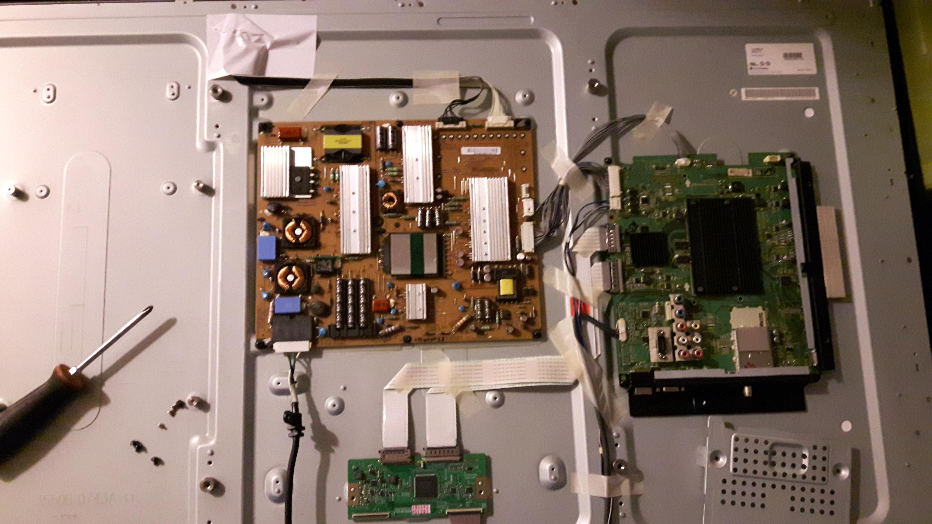

    I have LG 47lw5700
    Initial issue
    I get red standby press button turns blue backlight comes on but no video.
    I have 12v both sides tcon fuse.
    Pin out voltage
    NC 0v error
    12v 11.98v pwm
    12v 11.98v n. C.
    12v 11.98v drv on
    Gnd vsync
    Gnd gnd
    3.5v 3.48v
    3.5v 3.48v
    Gnd
    Gnd
    24v 24.1v
    Pwr on 3.48v
    If I unplug cable on left tcon to panel picture comes up on screen TV functions fine on that half. Is it a bad panel or tcon
    Re: LG 47lw5700 back light no video
    'If I unplug cable on left tcon to panel picture comes up on screen TV functions fine on that half'
    Bad panel.

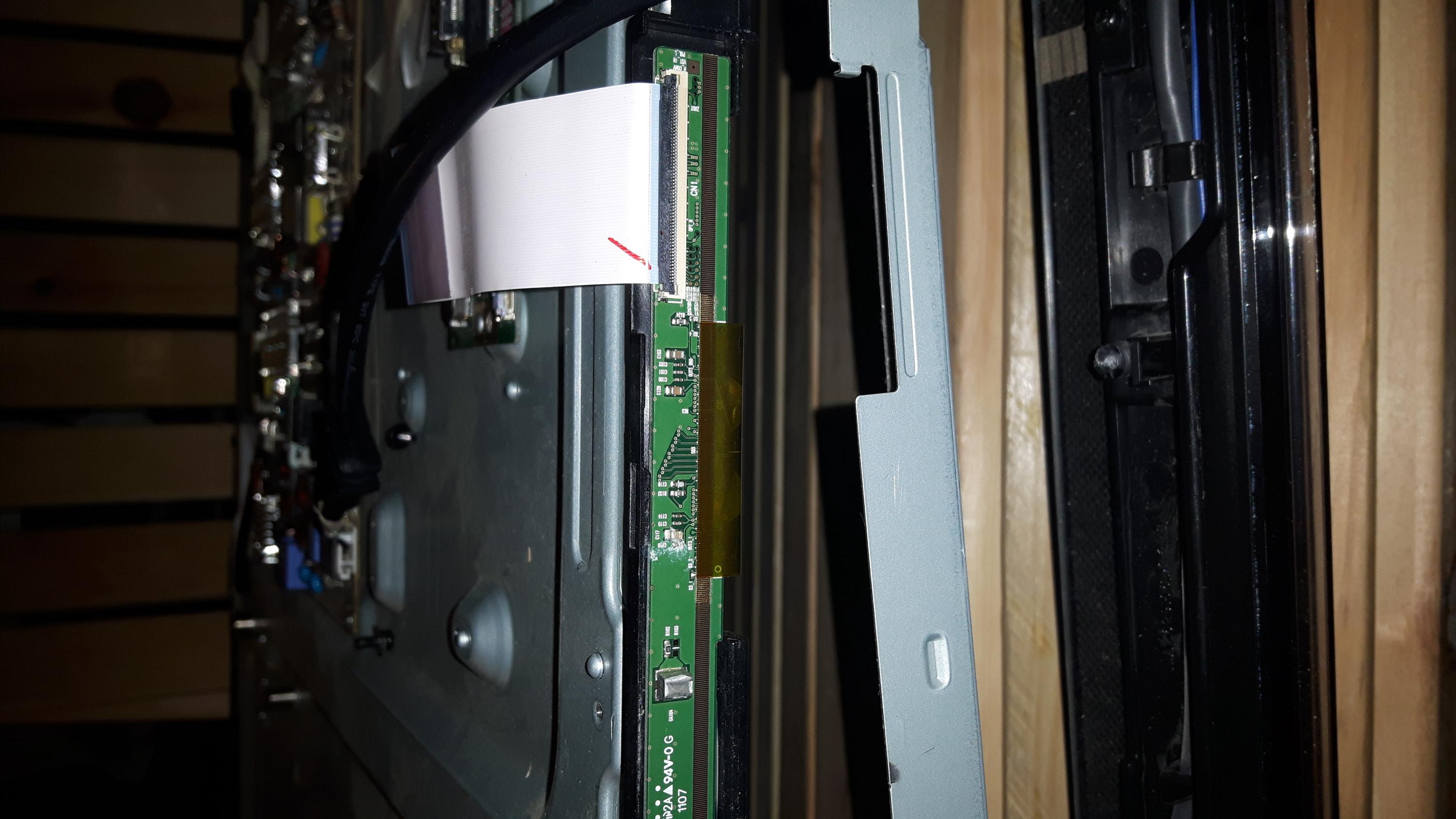

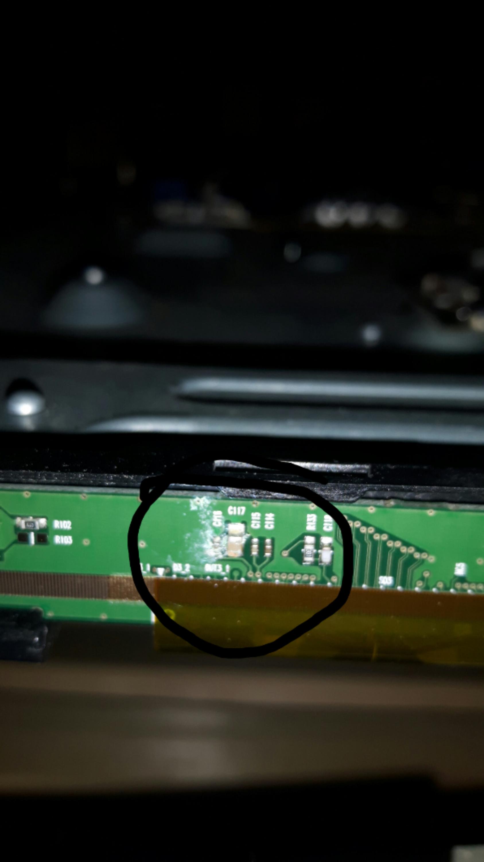

        Found this corrosion on the board that's attached to the panel. Possible this could be causing problems? And panel still good.

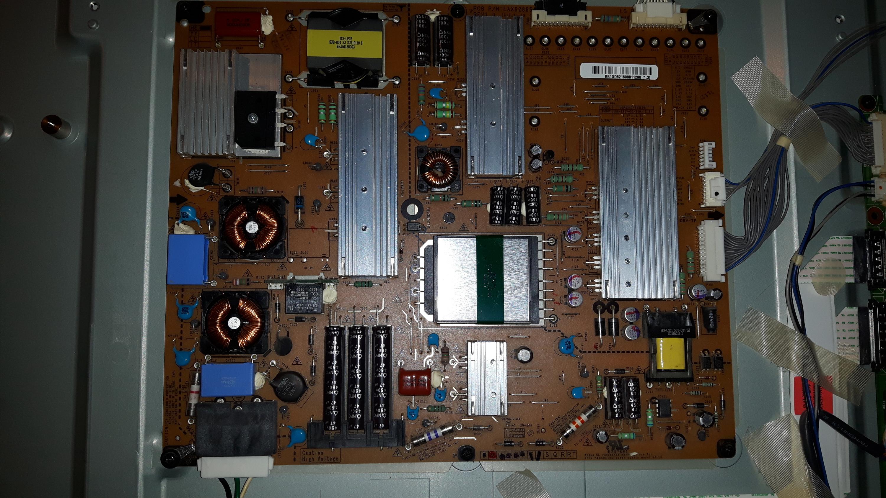

        Cleaned it up but when I was probing psu to main pinouts I shorted 24v to ground now plug in relay clicks on psu I still have all voltages coming out of psu but no red standby does nothing when power button pressed. Would this panel be used in a LG 47lh30 or 47ld520?
          One of those LCD panel with tab bonding board on the bottom edge of the panel, people just spray the cleaner on the screen and it drips all the way down to the boards and ruin it.

            So not worth me trying to fix main board then. That corrosion ruined the panel

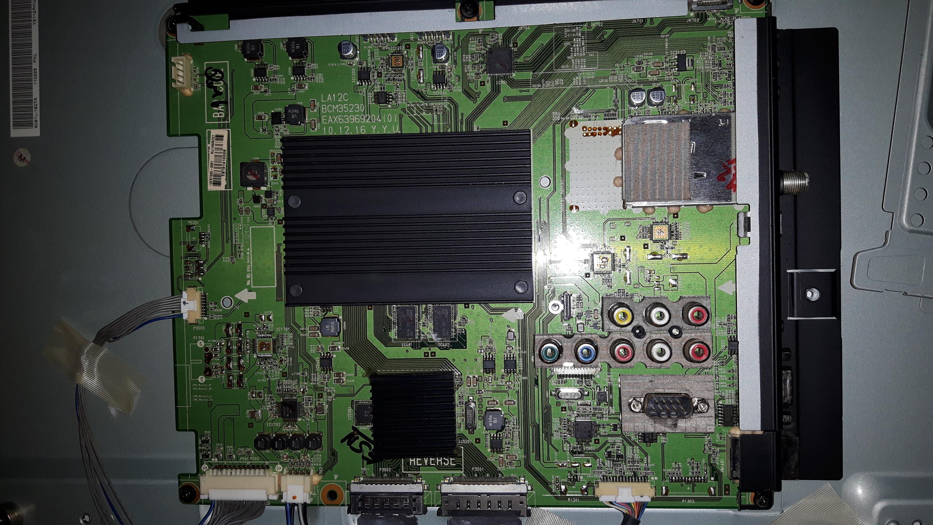

                i fixed one like this model, with the same problem, it was mainboard problem, i got a backlight but no picture, i did a CPU reflow,and i put a small fan to avoid any overheating in the futur, the Tv still working right now, it has been for 10 months ago, you can try with heatgun, just remove big balck heatsink and heat up a little bit the Bga chip,
