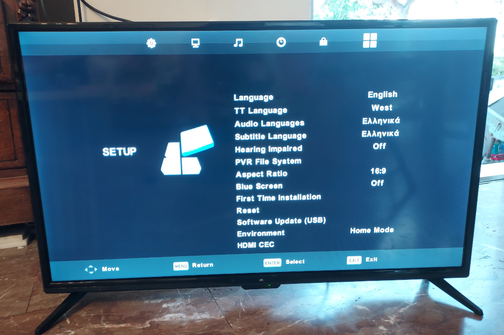

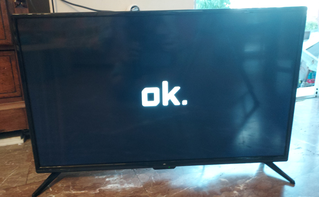

                            Hi!
                            Can you please try to fix my Non-working dump from an "OK TV" (don't remember model) with MB TP.MS3663.PB818 ?
                            Thanks.

                              try

                                #1275
                                Re: Eeprom dump thread!
                                Originally posted by lotas
                                try
                                I will check later today and let you know.
                                BTW the model of tv is ODL 32631H-SB EL
                                Thank you!
                                • dimis7
                                  • Feb 2011
                                  • 20
                                  #1276
                                  try
                                  My friend lotas! I have great news!
                                  Your modified firmware is working perfectly!
                                  Thank you so much!
                                  So for future reference:
                                  TV MAKER: OK
                                  MODEL: ODL 32631H-SB EL
                                  M/B: TP.MS3663S.PB818
                                  Working Firmware: Download from post #1286 above
