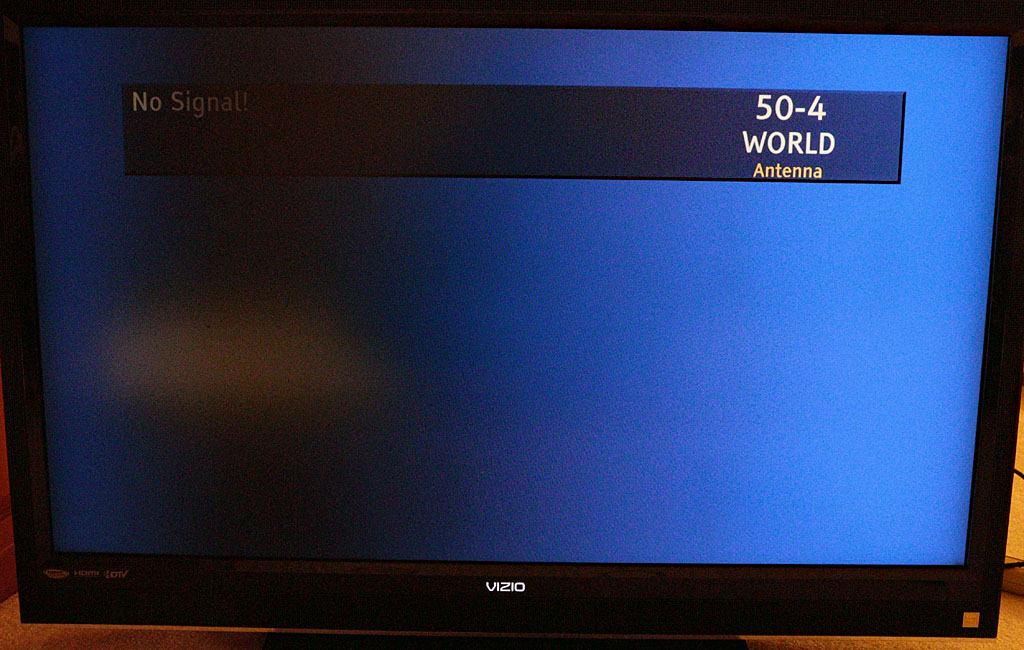

    Some encouraging progress:
    1. On the Slave inverter, I replaced the IC, reinstalled the good MOSFETs, and replaced the two MOSFETs that shorted out.
    2. Now half of the backlight works, the side that's driven by the Master inverter.
    3. One thing though: one of the transformers on the Master inverter is buzzing... A loose winding, maybe?
    4. The backlight side driven by the Slave is still dead, but at least nothing on the Slave inverter has shorted out... So far. *fingers crossed*
    5. Is it possible that one or more of the "good" MOSFETs that I reinstalled on the Slave inverter isn't really good, but not shorted, either?
    Correction:
    It wasn't half of the backlight... I didn't have the room dark enough.
    This is what the display looks like now... But I still get that high pitched whine from one of the the Master inverter's transformers.
      #42
      Re: Vizio VO47LFHDTV10A - No Backlight
      That is due to only 1 inverter board is working, the lamps are trying to come on but not enough drive Voltage due to only one working inverter board.
      It is getting tough for me to do remote troubleshooting at this point.
      It may be that the IC is not driving either set of the MOSFETs right now, the inverter has two set of transformer drive circuit. Are you sure it is getting the 24VDC through the fuse?

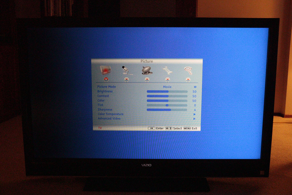

          Today:
          1. I removed all eight MOSFETs from the Slave inverter board, reconnected the power cable and the flat cable from the Master inverter, but did NOT connect the two-wire connector to the CCFLs.
          2. Turned on power and about 3/4 of the blacklight turned on (see photo) and there was no high pitched whine from the transformers on the Master inverter board as from the previous tests.
          3. I would've thought the Slave inverter would power half of the backlight, but this is clearly not the case... Why? What is the main function of the Slave inverter?
            Here is the explanation about various backlights driving methods, similar topology as used in your TV.

              Well, it seems pretty obvious that there's something wrong with the Slave inverter board, but I can't figure out what... I've replaced the IC and the MOSFETs (multiple times) and the board still shorts out not long after power up.
              Could it be one or both of the transformers? They don't show a short condition on my DMM.
              Could it be the support circuitry (surface mount diodes, transistors, caps, resistors)?
              I'm nearly resigned to the point that I'll have to buy a replacement Slave inverter board... If there's one available for purchase... At a reasonable price.

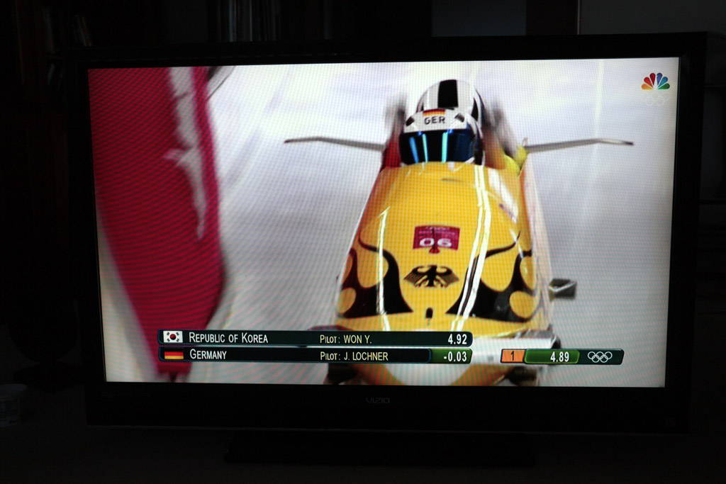

                Success!
                I made one final replacement of the IC and MOSFETs on the Slave inverter board using a parts kit from ShopJimmy.com and it seems to have fixed the problem...
                The only thing I can speculate is that the other ICs and MOSFETs that I purchased from eBay were bad/defective... I'm going break-in/burn-in the TV just to make sure that this repair isn't temporary...
