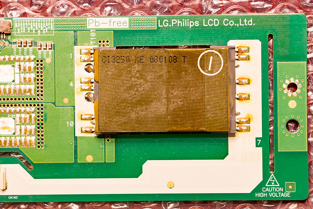

                My brother's VO47LFHDTV10A tanked a couple of weeks ago and I've been troubleshooting it since.
                My observations:
                1. Audio, but no backlight.
                2. Did the flashlight test: there is a picture, but I can't see it because there's no backlight.
                3. Changed out all of the 680uF 35V caps on the master and slave inverter boards... No improvement.
                4. Changed out all of the transistors and ICs on the inverter boards and the backlight flickered on for a minute or two, then disappeared and never came back.
                5. With the inverters disconnected from the power supply, all the voltages to the inverters (24V) are present, but not when connected... A short somewhere?
                6. Voltages going to the other boards from the power supply are all present.
                7. Checked the fuses on both inverter boards... They seem ok: 0 ohms.
                Seems obvious that there's a problem with the inverters, but I changed out the transistors, ICs, and caps and there was no improvement aside from that momentary flicker.
                Any ideas or suggestions?

                  New observations:
                  1. I determined that the short circuit is on the slave inverter board, not the master.
                  2. Since it's not conclusive to determine that one or more of the FDD8447L MOSFETs is shorted by checking them on the board, I painstakingly removed them one by one until the short was gone.
                  3. Turns out three of the MOSFETs were shorted, so I replaced them.
                  4. Unfortunately, that didn't solve the problem: once I powered up the TV, I got a flickering picture for a moment, then it was gone and the slave had a short again... Probably the MOSFETs again... Grrr.
                  5. So apparently there's something else that's bad on the slave inverter, causing the MOSFETs to fail, but what?
                  6. I'd have to think it might be one or both of those transformers on the board... A test would be to remove both transformers, replace the failed MOSFETs, and power up the board again and see if there's another short circuit... Good thing those MOSFETs aren't terribly expensive...
                  7. If it is one or both of those transformers, I don't know how I could possibly find replacements...

                            #33

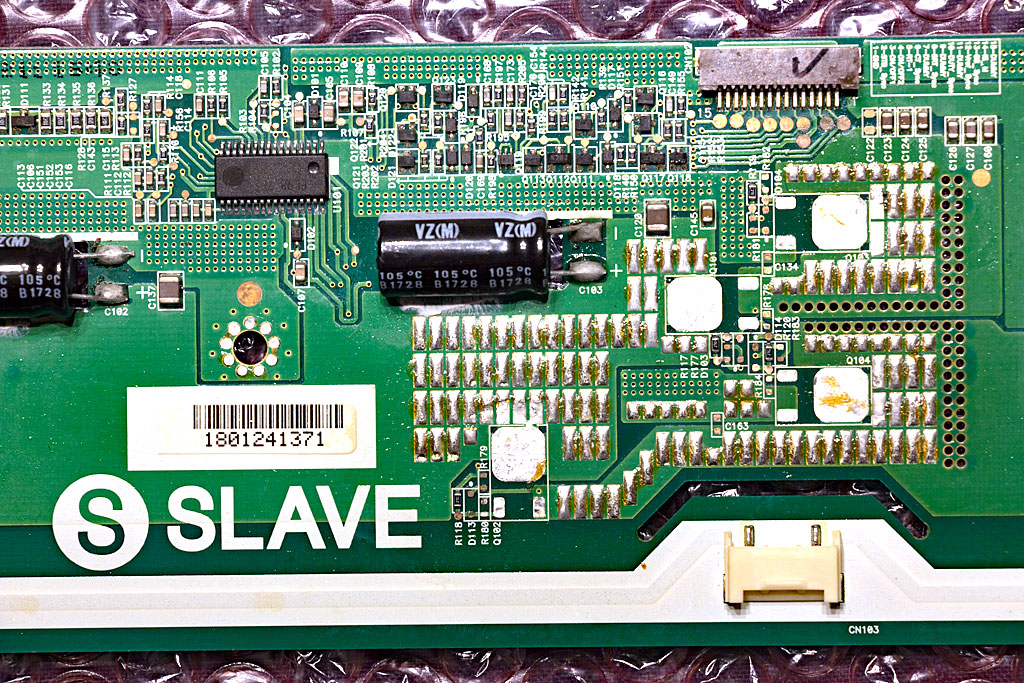

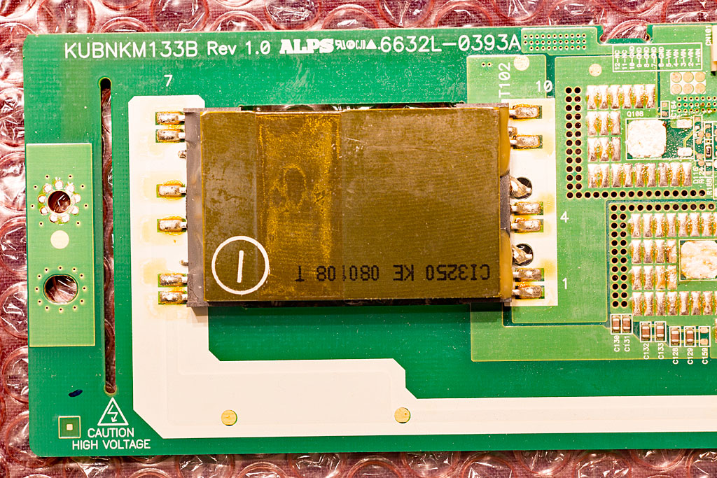

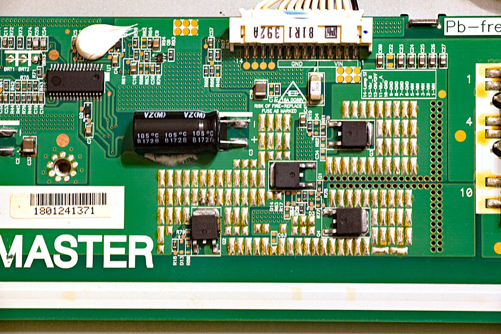

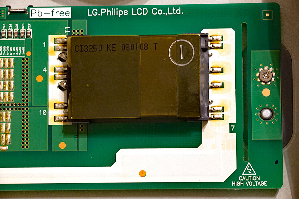

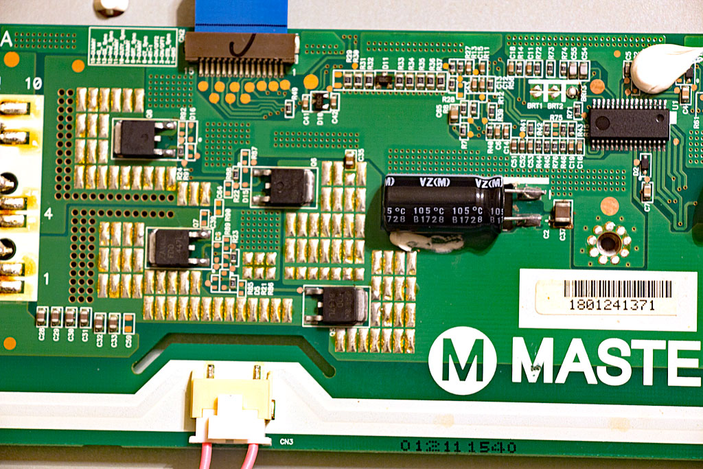

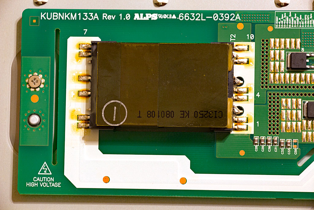

                            Re: Vizio VO47LFHDTV10A - No Backlight
                            Here are the photos of the slave and master inverter boards.
                              #34
                              The flat cable that link between the Master and Slave board is for syncing the Mater and Salve inverters because they are driving the lamps in PUSH-PULL setup.
                              The 4 MOSFETs for driving the primary side of the Inveter transformer are set up a full bridge drive and only two of them should be turned on at the time otherwise you will have MOSFET blown up if more than two are turned on at the same time. I always replace all 4 at the same time.
                              https://cdn.badcaps-static.com/pdfs/...5628d3ac52.pdf

                                #35
                                Originally posted by budm
                                The flat cable that link between the Master and Slave board is for syncing the Mater and Salve inverters because they are driving the lamps in PUSH-PULL setup.The 4 MOSFETs for driving the primary side of the Inveter transformer are set up a full bridge drive and only two of them should be turned on at the time otherwise you will have MOSFET blown up if more than two are turned on at the same time. I always replace all 4 at the same time.
                                So if the master and slave don't sync, that would cause the slave to short out?
                                Is there a way to determine if the master is functioning correctly and not causing the slave to fail?
                                  #36
                                  No, the MOSFETs are driven by the IC not directly by the Master, if they are not synced then the lamps will not light up properly, if the Slave board is bad then the lamps will on be on half the length of the tubes, the dead half will be the one with the bad Salve inverter.

                                          #40
                                          Some encouraging progress:
                                          1. On the Slave inverter, I replaced the IC, reinstalled the good MOSFETs, and replaced the two MOSFETs that shorted out.
                                          2. Now half of the backlight works, the side that's driven by the Master inverter.
                                          3. One thing though: one of the transformers on the Master inverter is buzzing... A loose winding, maybe?
                                          4. The backlight side driven by the Slave is still dead, but at least nothing on the Slave inverter has shorted out... So far. *fingers crossed*
                                          5. Is it possible that one or more of the "good" MOSFETs that I reinstalled on the Slave inverter isn't really good, but not shorted, either?
