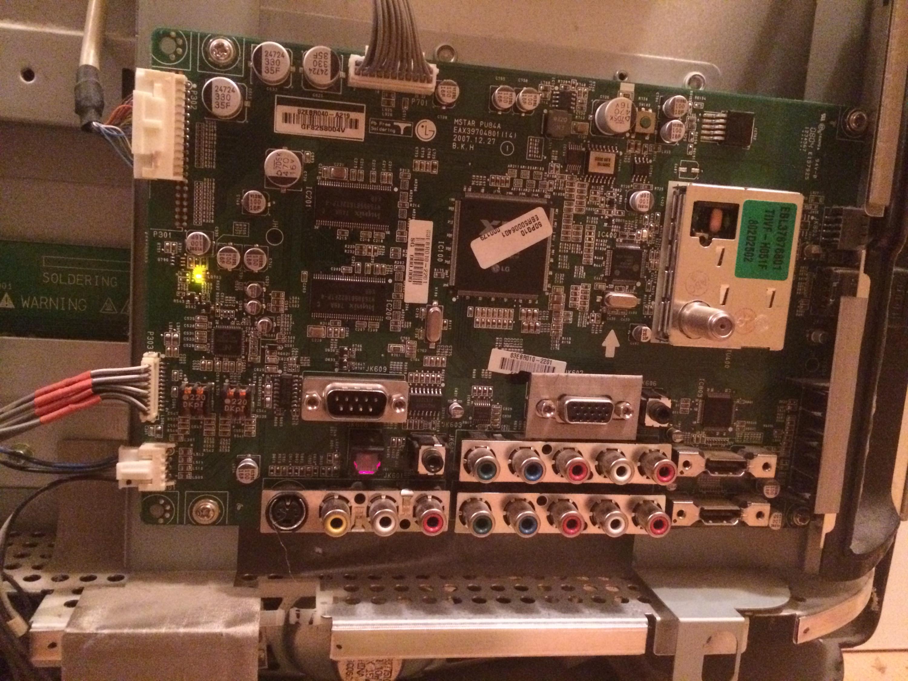

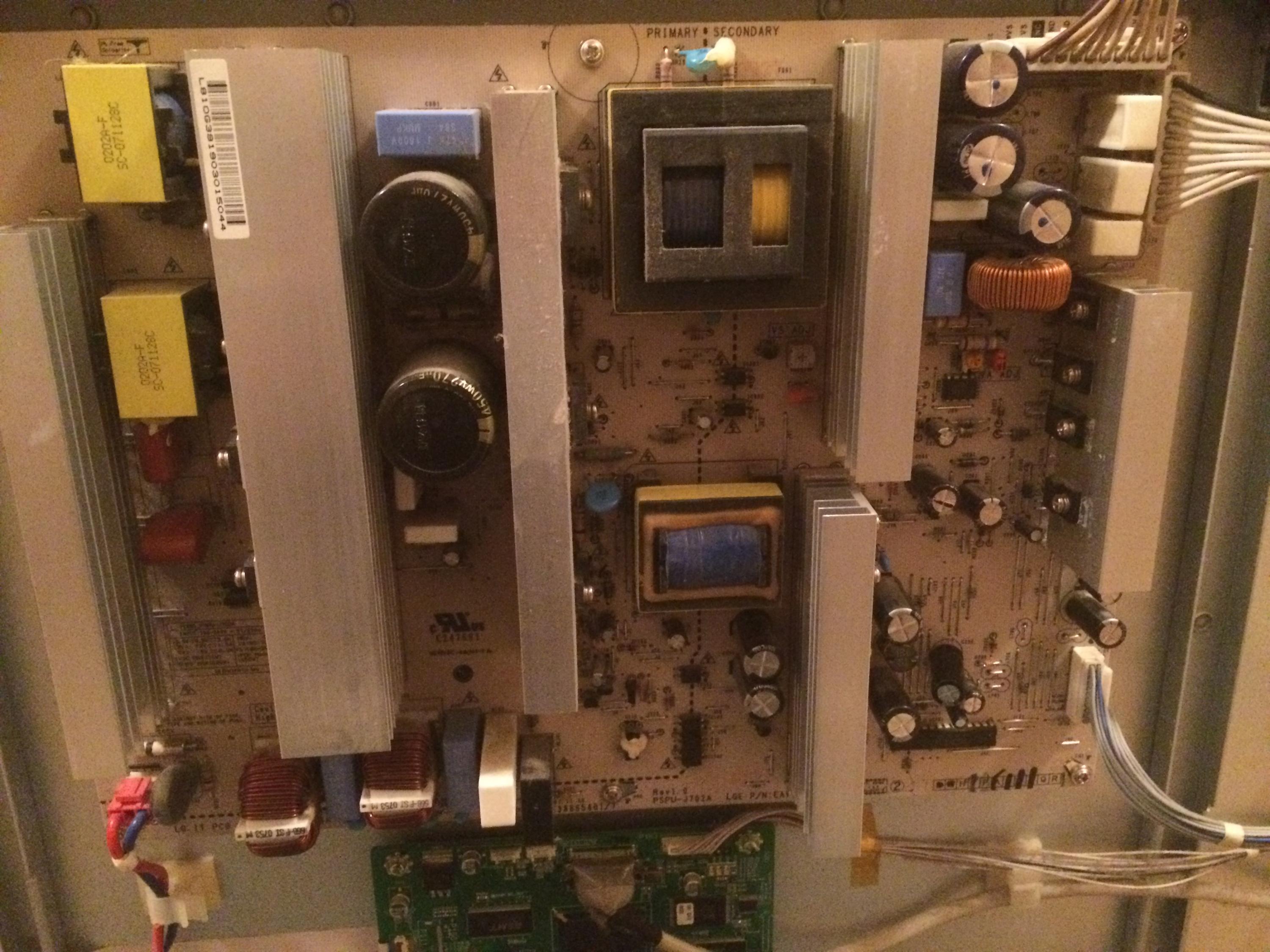

    I have searched the forums and ran every test I found to no avail.
    All voltages are good. Test pattern results in black screen. Pulling the top/bottom YSUS produces nothing. I have tested every fuse etc I can find but there is no image on this thing.
    Any help would be greatly appreciated.

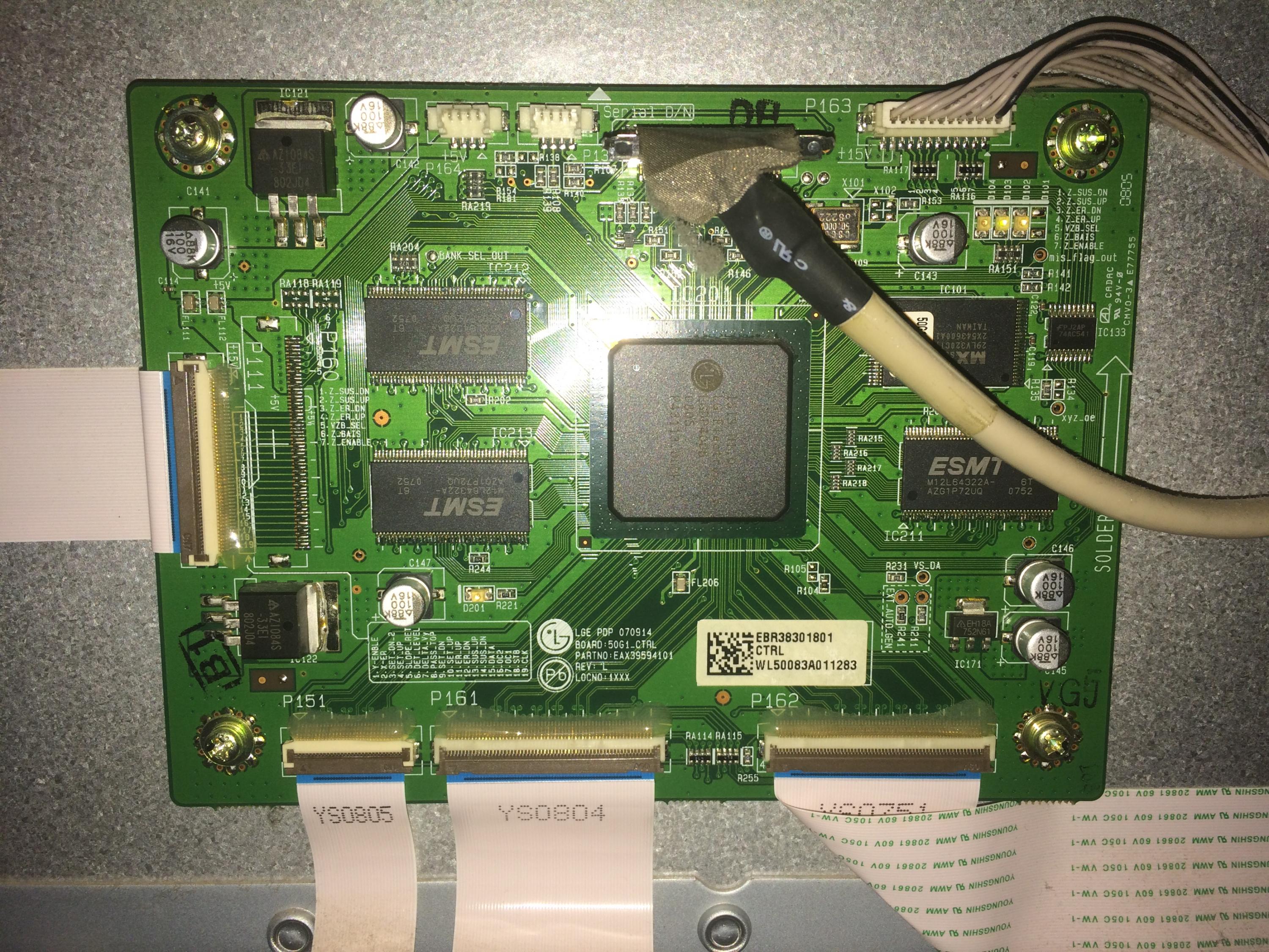

    Remove top Ybuffer does bottom half of screen work ?
      Re: LG 50PG10 Sound No Picture.
      No just a black screen.

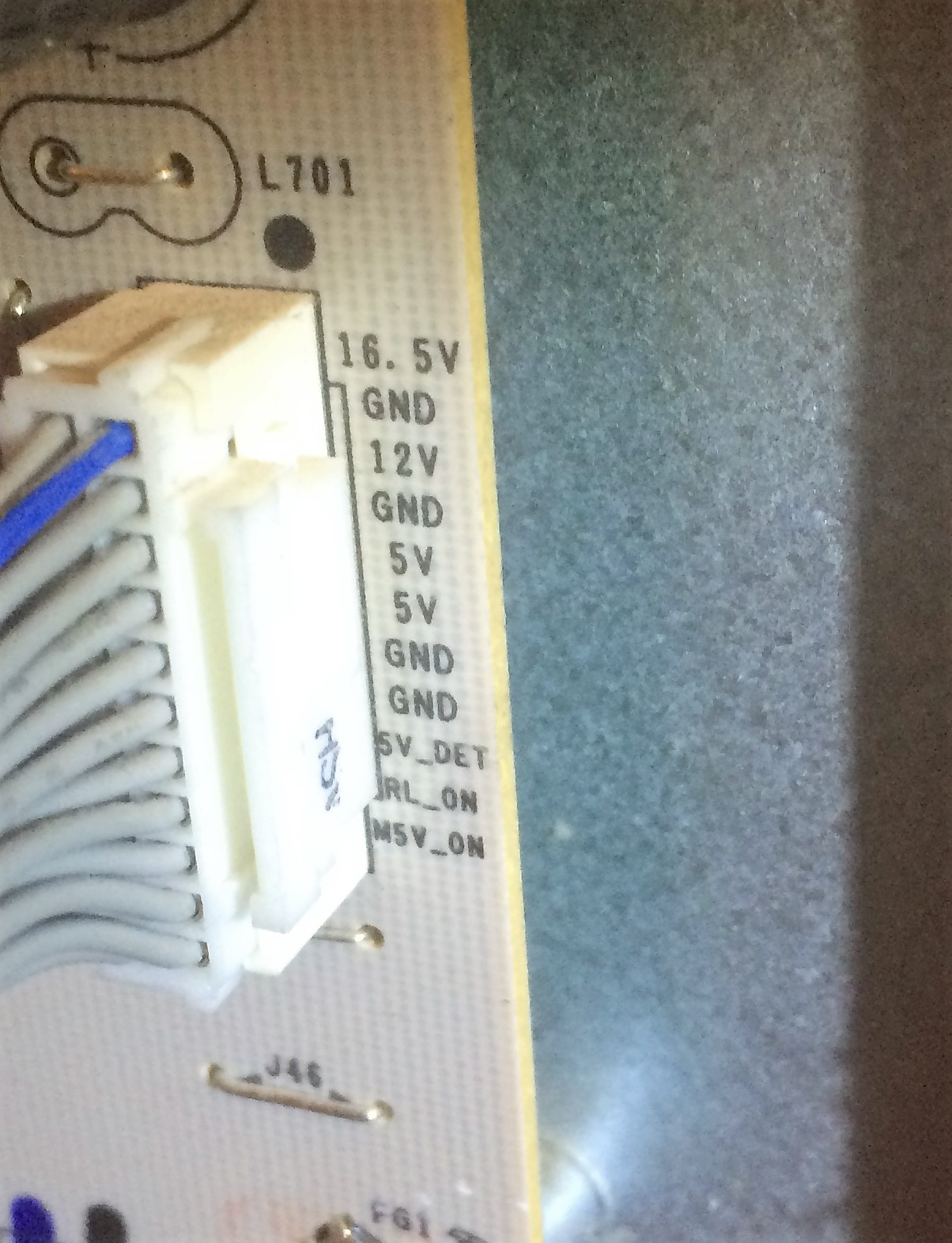

        Right what voltages have you tested ? No point just telling us they are fine need to verify. Need Vsc, Vz, Yup etc. cheers.

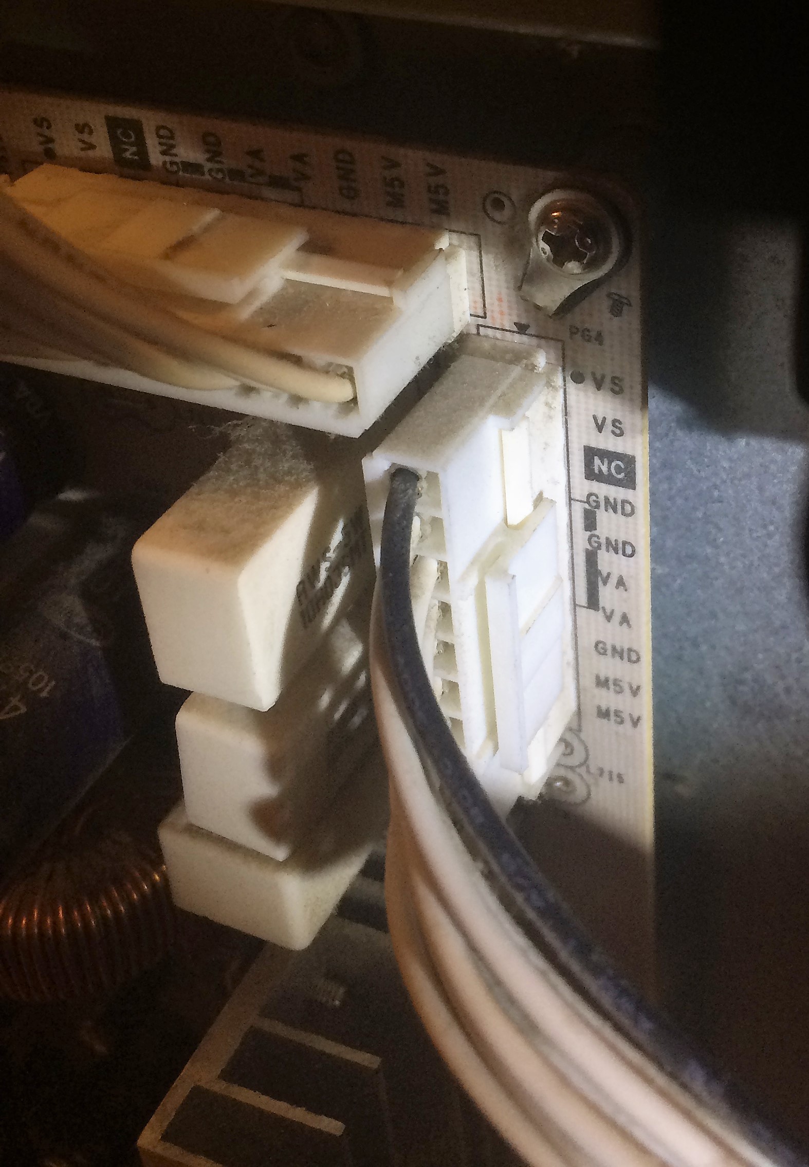

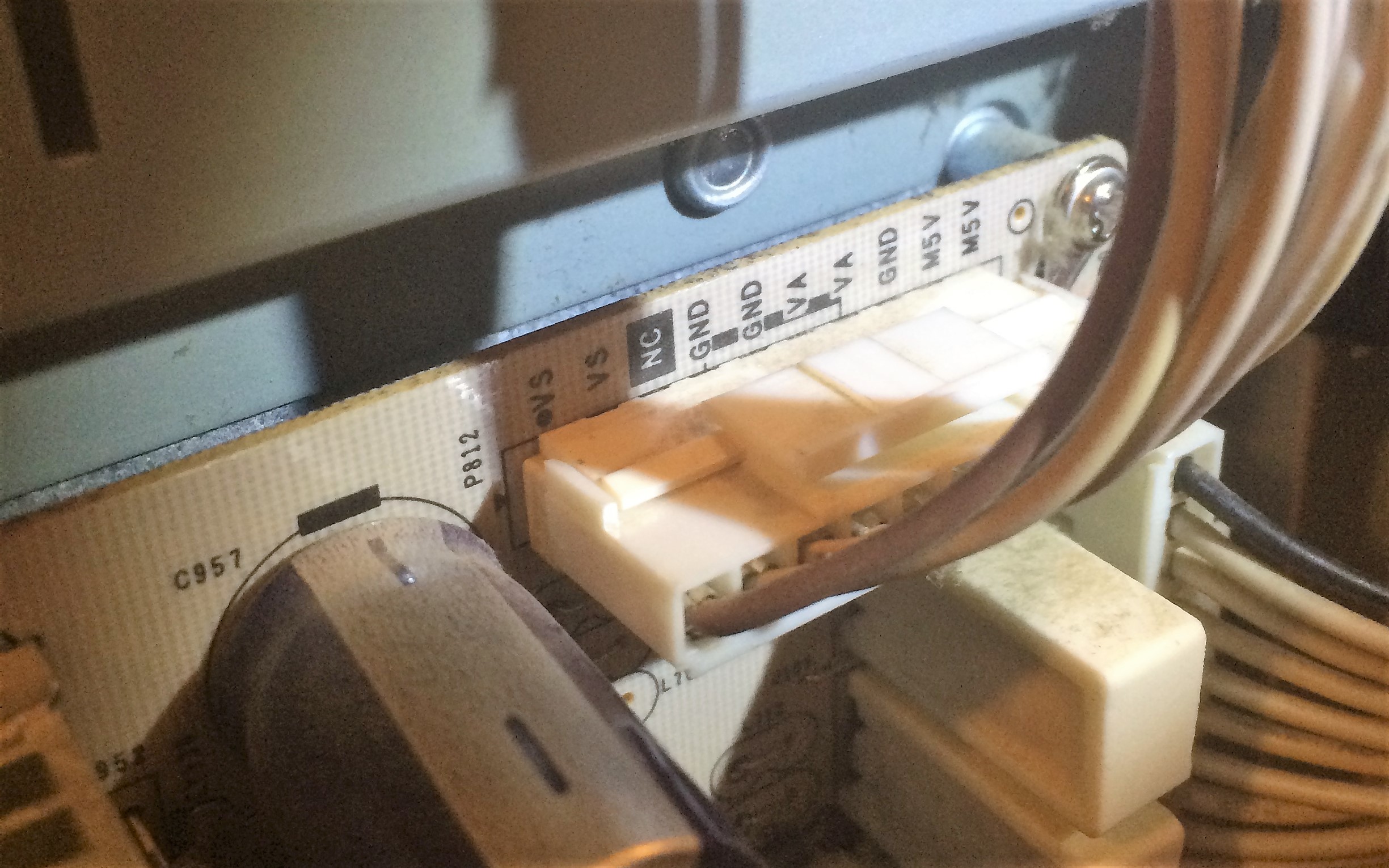

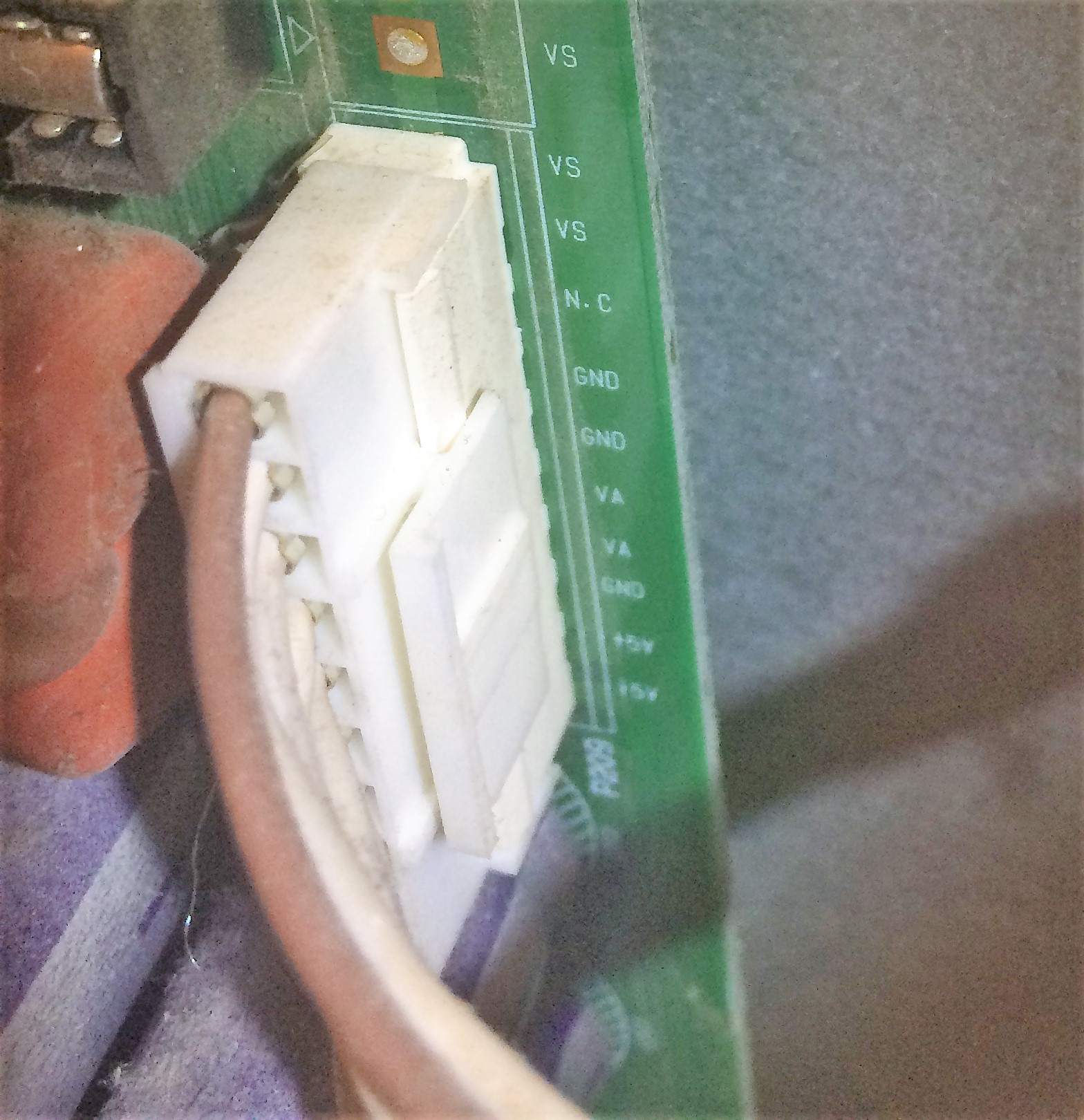

          Vs 191v at all points
          Va 63v at all points

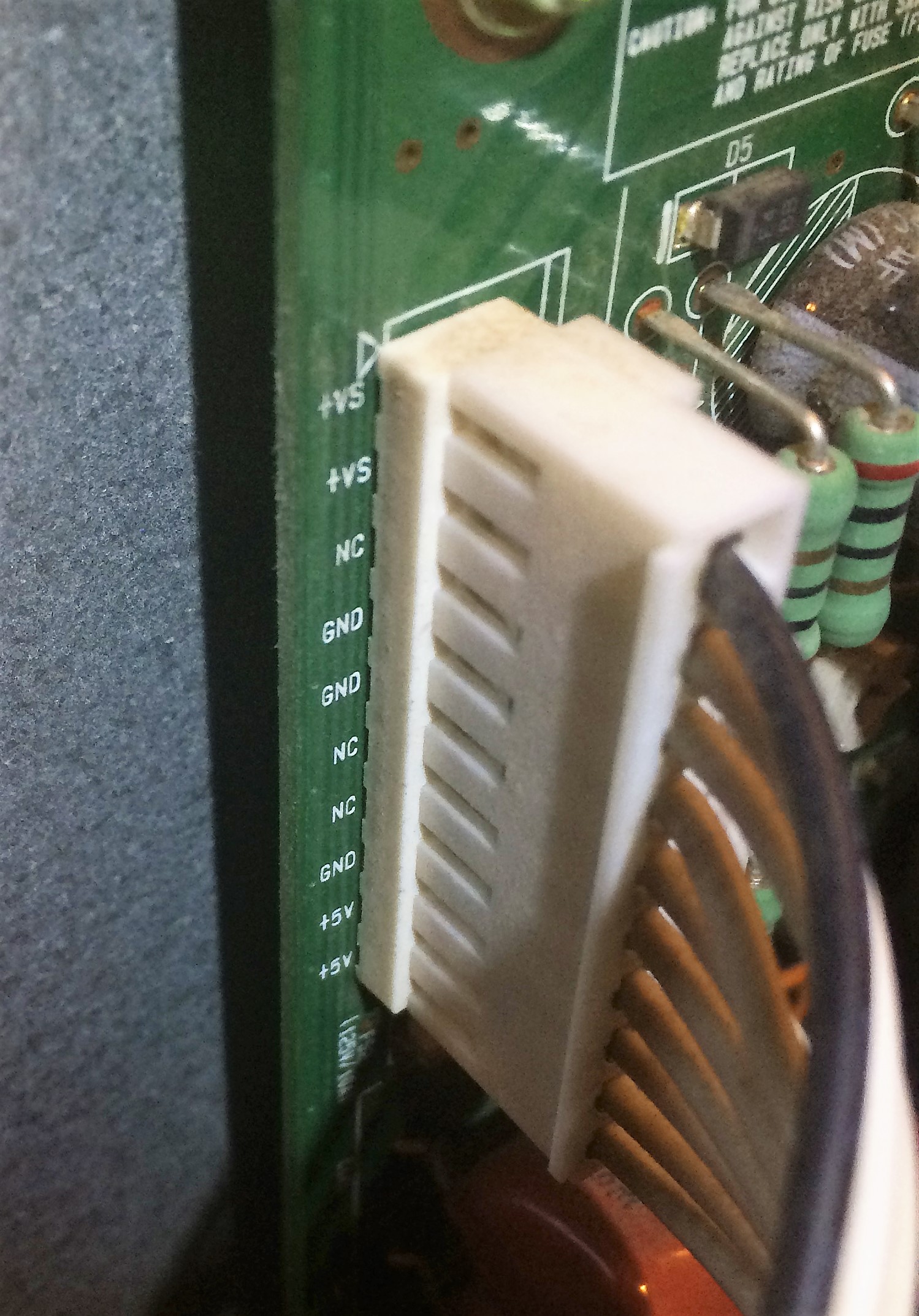

          M5v 4.96V
          5v_det 5.02v
          RL_ON 3.22v
          M5V_ON 3.75v
          all fixed voltages ie if it says 12v or 5 v or 16.5v also correct.

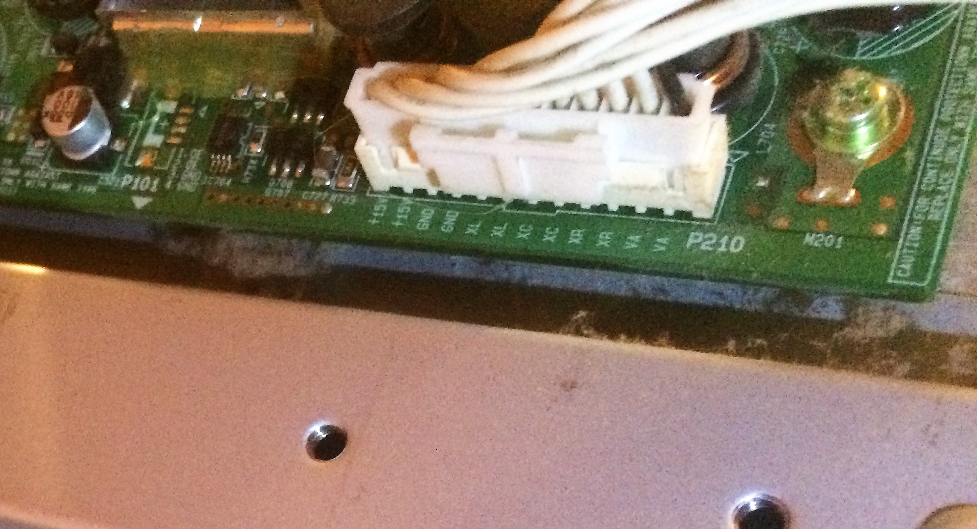

          There are others leaving the Ysus down to the bottom board
          XR 16.52v
          XC 16.57v
          XL 16.50V
          Will get the rest after work tonight.

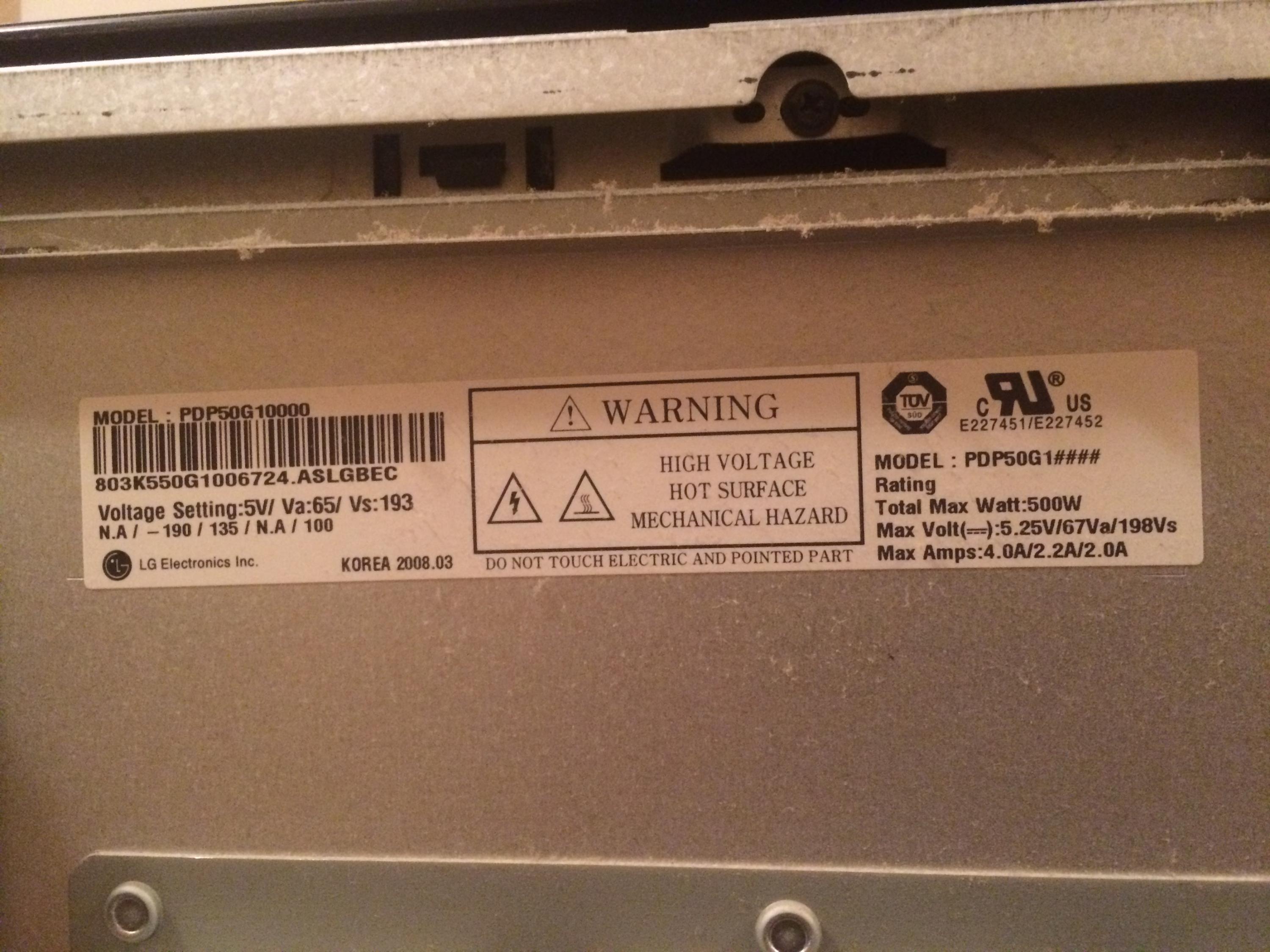

            What voltages are listed on the label on the rear of the panel?
              back of the panel is
              5V
              Va: 65
              Vs: 193

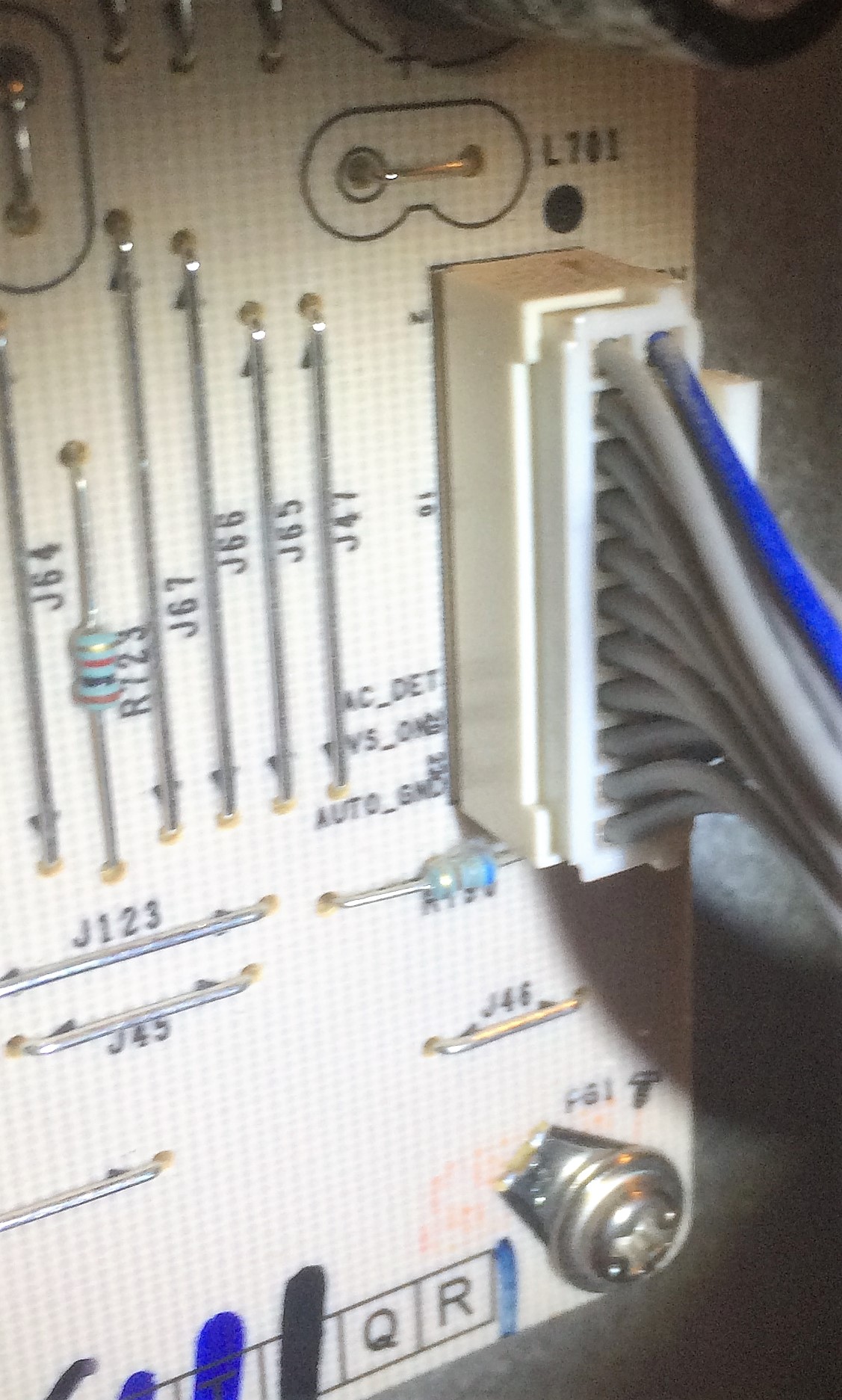

                all the test voltages and points that I check. Was not able to find the ones Vsc, Vz, Yup
                M5v 4.96V
                5v_det 5.02v
                RL_ON 3.22v
                M5V_ON 3.75v
                AC_DET 4.95V
                VS_ON 3.26V
                AUTO_GND 3.25V
                XR 16.52v
                XC 16.57v
                XL 16.50V
                +15v 16.51V
                Va 62.1V

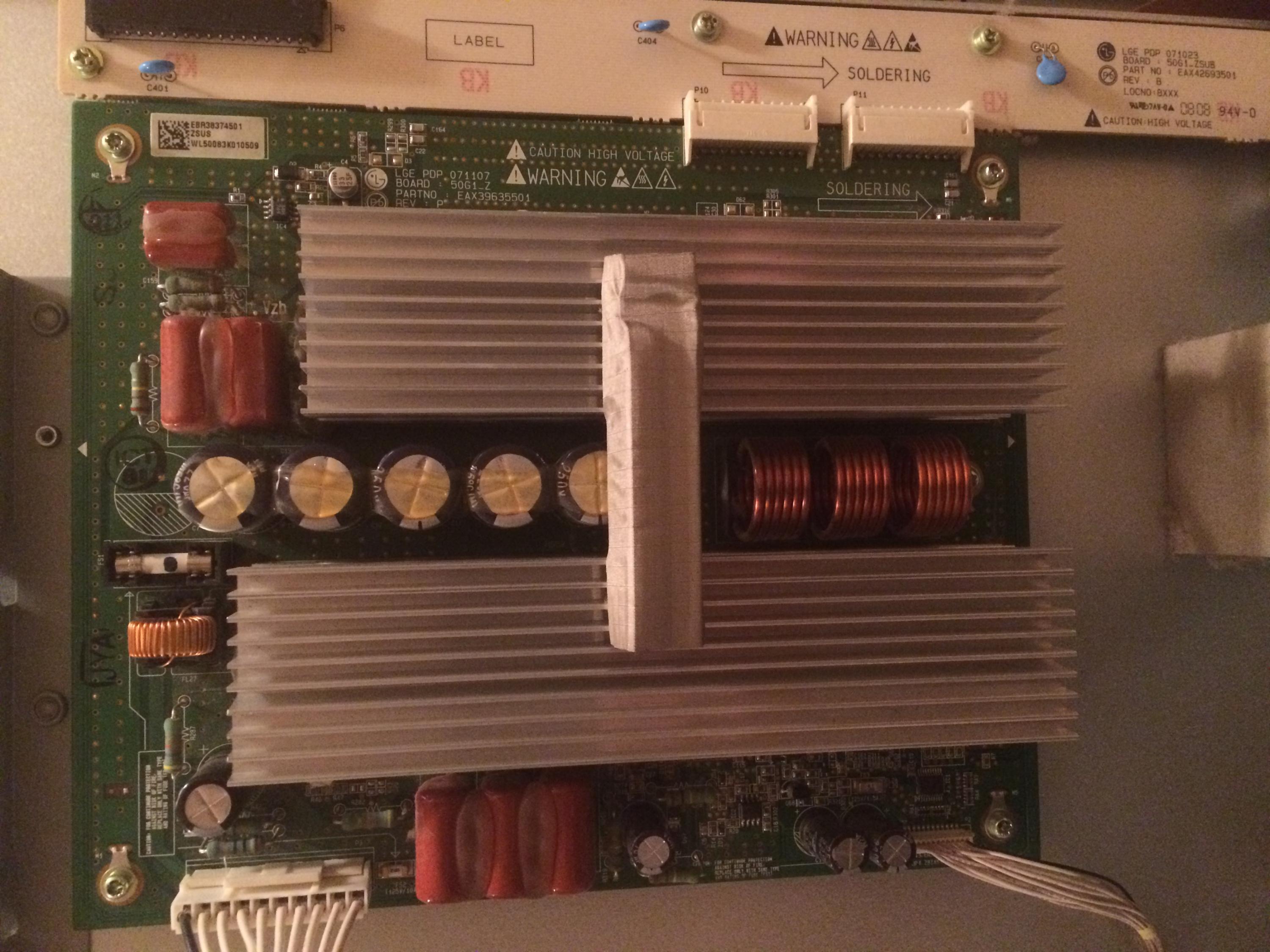

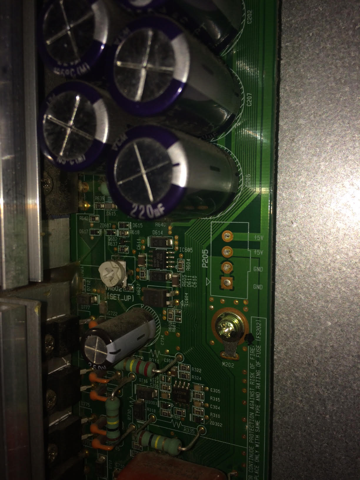

                    Vsc testpoints are located on the y-sustain board
                    Same for -vy
                    Should be printed directly on the board , look like your y sustain not prime the panel
                      On your sticker you see
                      N.A/ -190 / 135 / N.A / 100
                      According to LG these readings are standart for all plasma models
                      Setup / -VY / VSC / VE / VZB
                      -vy and vsc testpoint are on y sustain , ans vzb are on the z sustain
                        If you have no image but sound and the screen is same as if it turned off and the fuse on the y sustIn is not blown i bet for an blowed open mosfet like "45F122"
                        But can be a burned open resistor on the board
                        Did yku hear de sustain buzzing when the tv is on ?

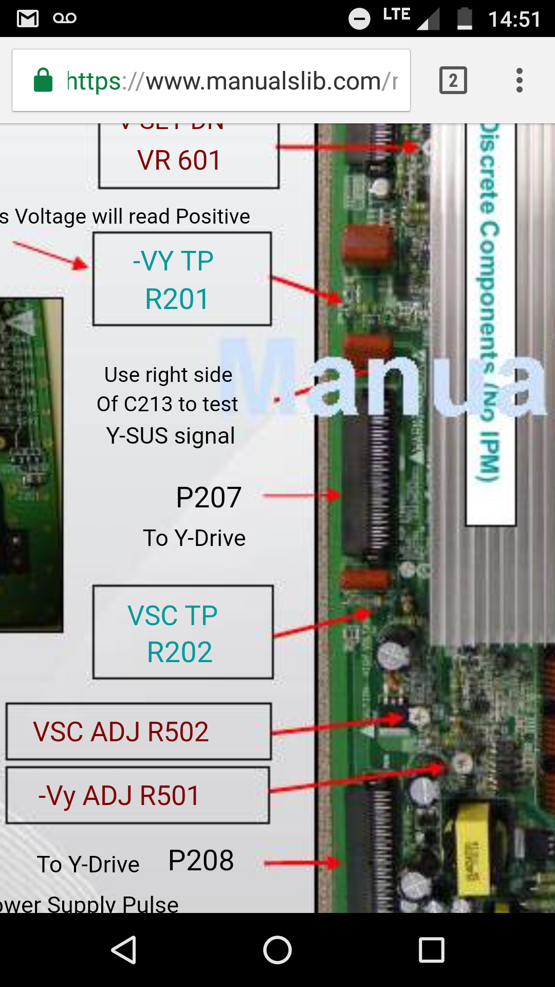

                            Check here
                              I do hear a buzzing when there is no audio playing. Checking the points you posted in your last response shortly.

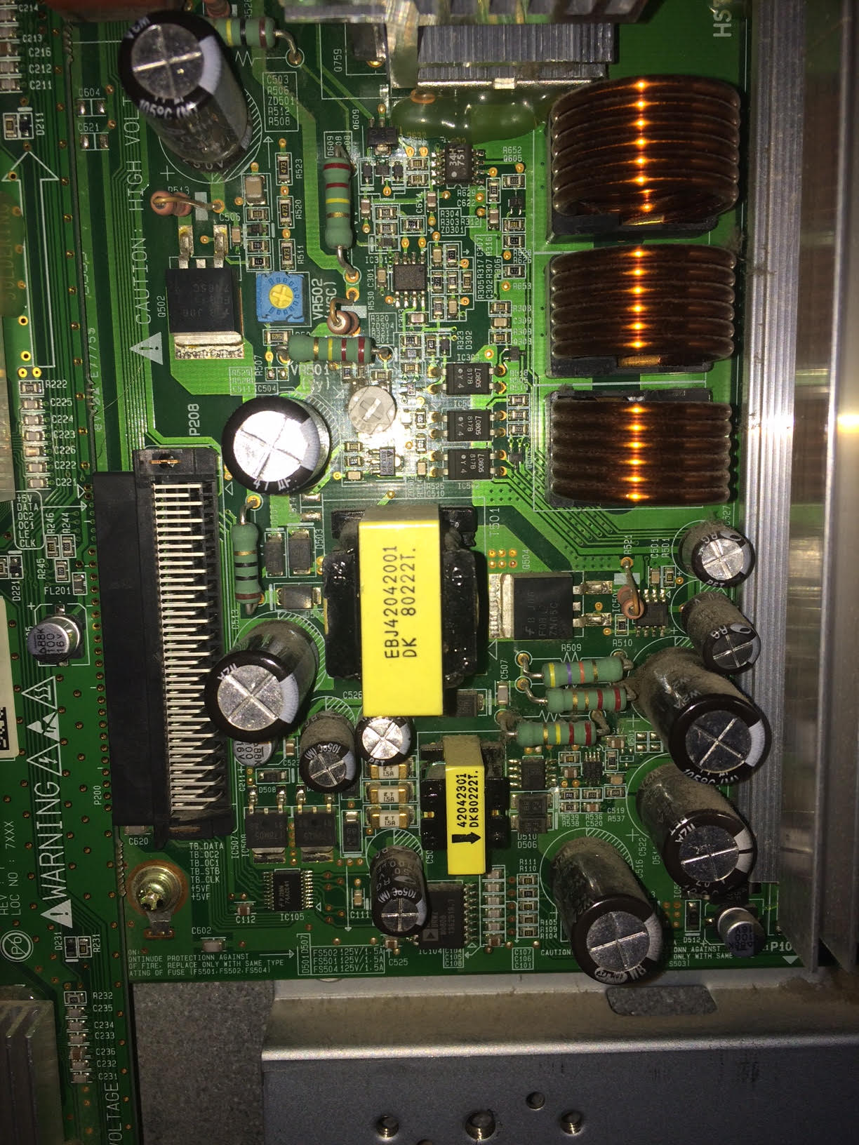

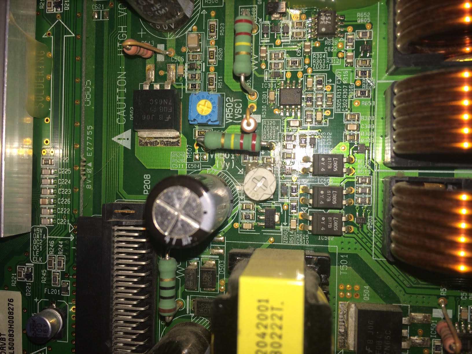

                                Check here
                                VY R201 5.21V across resistor
                                Vsc R202 153.0V " "
                                C213 135.1V on right leg
                                I am assuming R201 is way to low?
                                  I agree vy should be 185 volts over there and is probably why ur tv fail , all other reading look good exept vsc , too high + 20v
                                    Was mis-typed Vsc is 135.2V

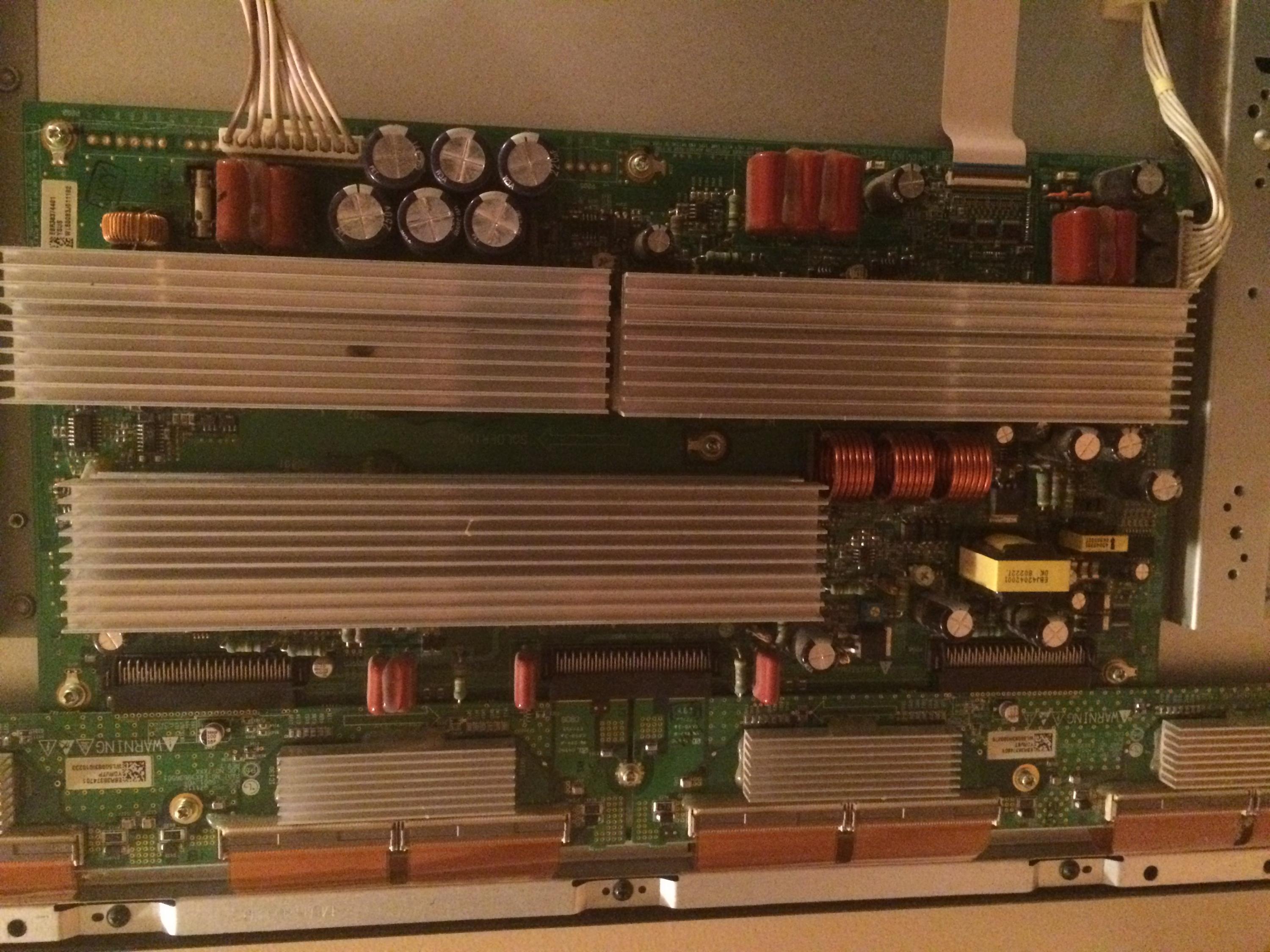

                                    Still checking but no luck so far finding the cause of the Vy being so low.
                                      Removed the buffers and retest Vy.
                                        both buffers out:
                                        Vy 0.01V across resistor : 20V referenced to ground
                                        Vsc 135.2V
