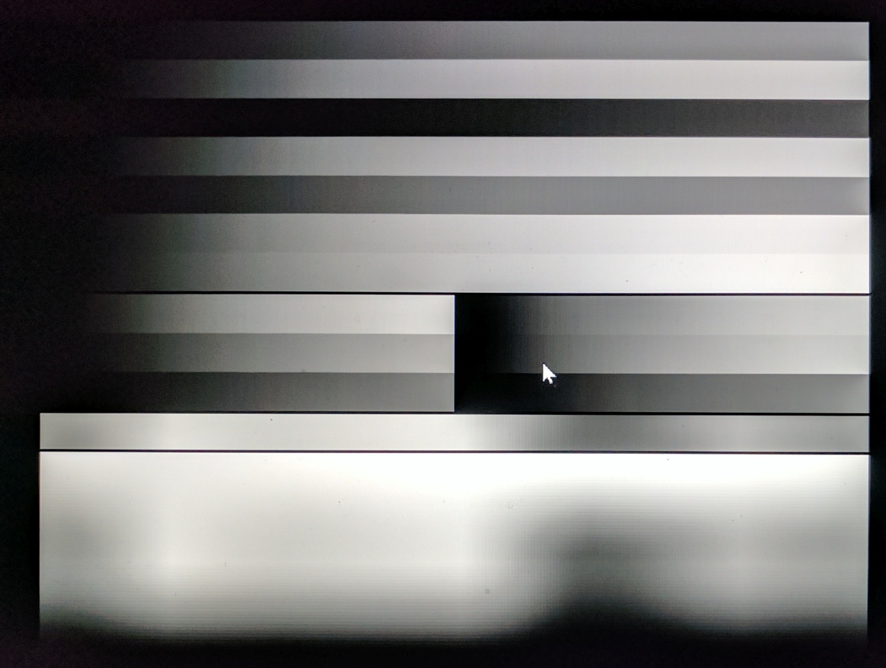

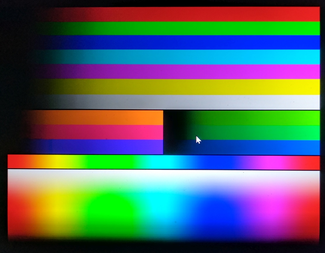

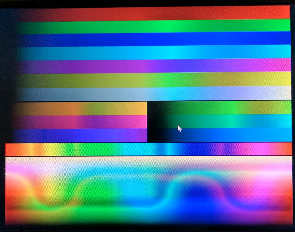

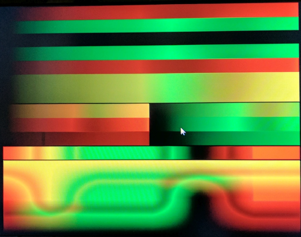

    My Bravia KDL-37v5810 has worked well with pretty good colour accuracy (IMO) for 6 years from new but colours have suddenly gone wrong. Image stability, geometry and rest of TV functionality are all fine. Have tried factory reset, leaving TV unplugged for 24 hours. Firmware is up to date but TV won't let me reinstall firmware as it's up to date. Service status screen shows 10K panel hours. Some non-zero values are listed under DTT_WD - some posts on the net list this as software or firmware error.

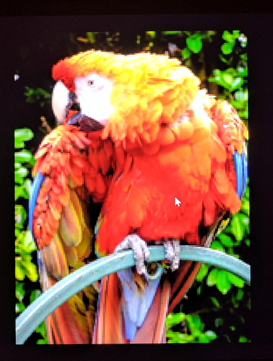

    Have attached test images taken with same camera on working laptop and same display mirrored on TV HDMI connection. Have turned off most of the image 'enhancement' TV features. Original images are from https://en.wikipedia.org/wiki/List_o...d_RGB_palettes. Input from TV tuner or other sources shows errors that are similar in character.

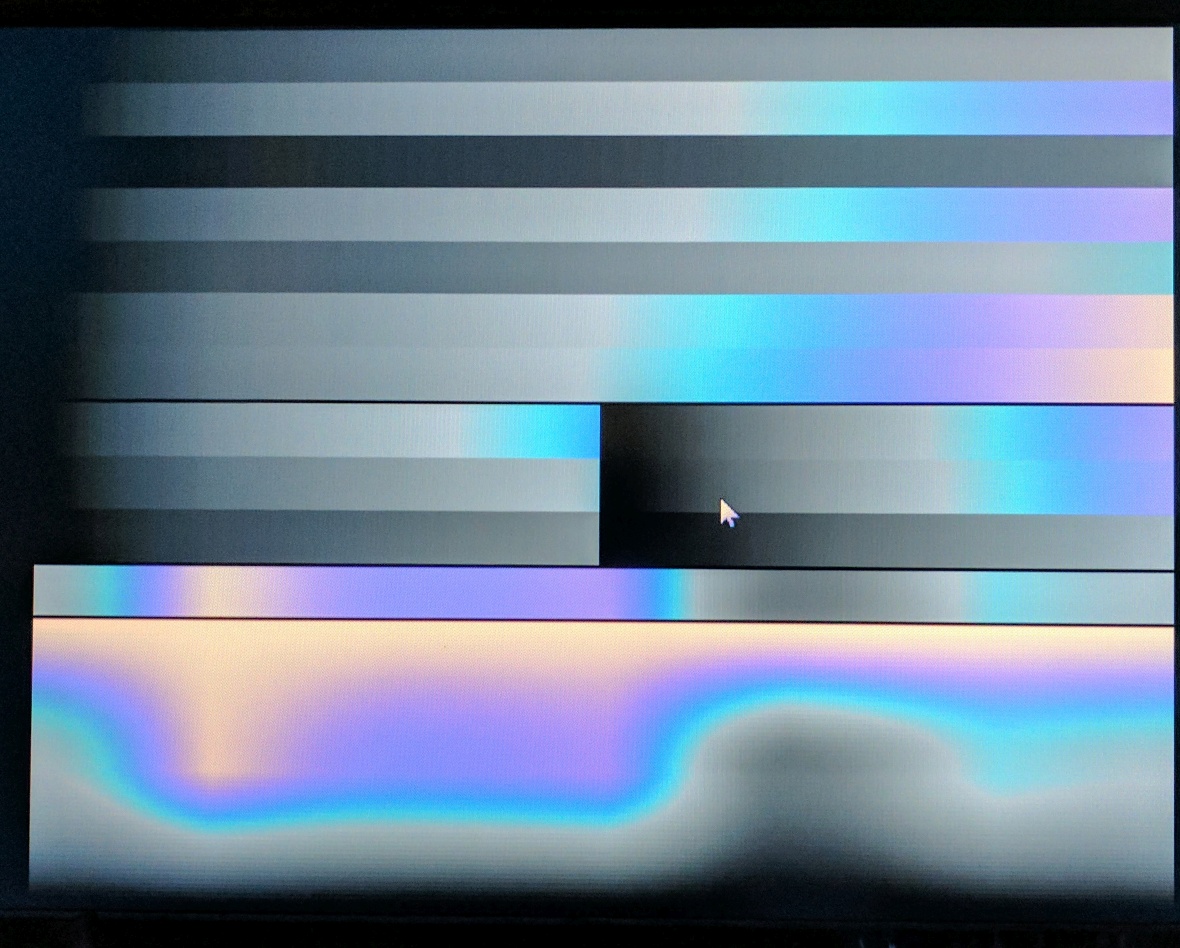

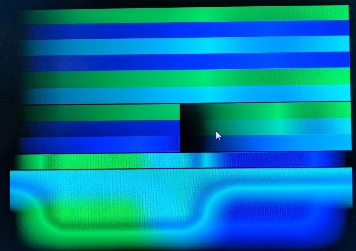

    Judging from gradient images, there's a similar error in the gamma curve for each component but in a slightly different place for each component so the greyscale gradients show colours.
    From what I've read online this looks like a classic AS15 chip failure. Does the AS15 work on each individual component independently in RGB colour space, or YCbCr or is it more complicated than that?

    If the t-con has the AS15 chip and has colour issues, it's the first thing I replace.
    Takes me longer to take the back off the TV than it does replace them now.
    If you want to be sure you can measure the voltages on the test points.

      I'd agree with diff that it does look like a tcon problem and a chip change would hopefully fix it.

        looks like an AS15 fault to me, I just search ebay for TCON repair - I have used louise.cole19862012 on a few occasions, always been spot on.
