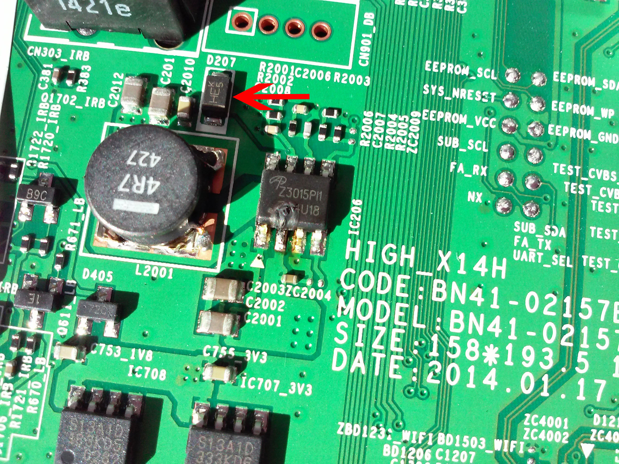

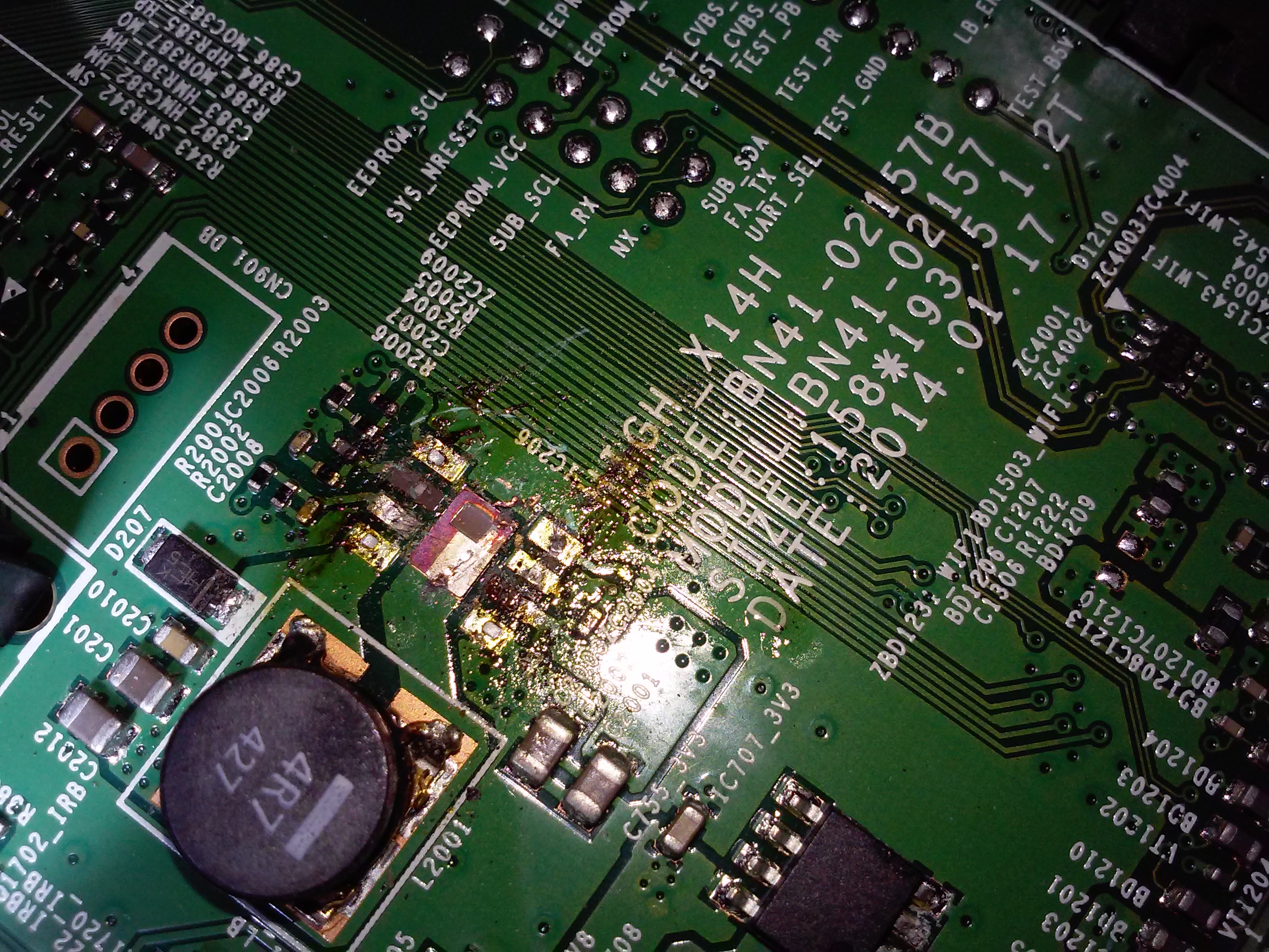

    Samsung UN60H7150AF Burned IC
    TV won't power on. When I unplugged the main board the back lights come on and stay on. Was able to test power supply voltages with main board removed they all looked within margin. I spotted burned (IC206) on the main board but can't find a schematic for this TV.
    Was wondering if I should just order a new IC and cross my fingers? Or that something else is the cause for the IC to fry?

    Re: Samsung UN60H7150AF Burned IC
    you need to be checking everything connected to it ..without a schematic its not so easy .. only things to short are semi conductors and the occasional capacitor .

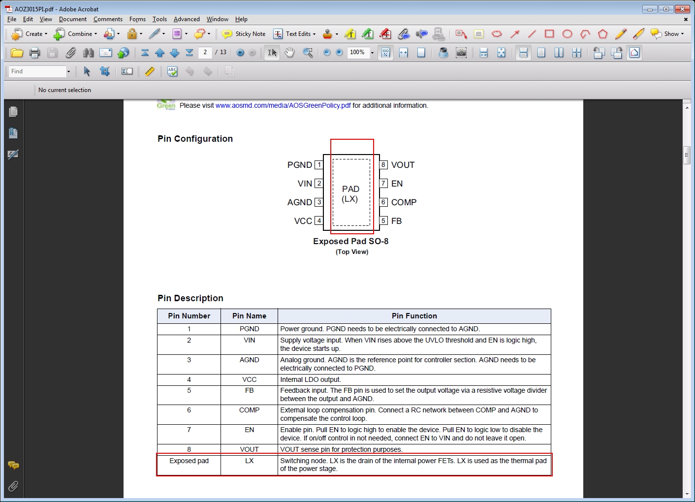

    you could take an educated guess and look up the data sheet for the ic . looks like a z3015pi1
      Okay thanks. I found the data sheet for it. Will post back when I find anything else wrong.
        http://www.aosmd.com/search?pn=AOZ3015
          Check the input voltages before replacing it. Anything above 18v-20v frys that chip. Its supposed to be good for 3A. The output voltage for this circuit will be,
          (R2003+R2004+R2005)*0.8/(R2003+R2004)
          If you measure those, you can work out what voltage this circuit is supposed to be generating.
            I'd be checking th buck regulator's output to GND. If there is a low resistance, either remove that dc to dc buck converter or the inductor beside it and check for a short to GND again.

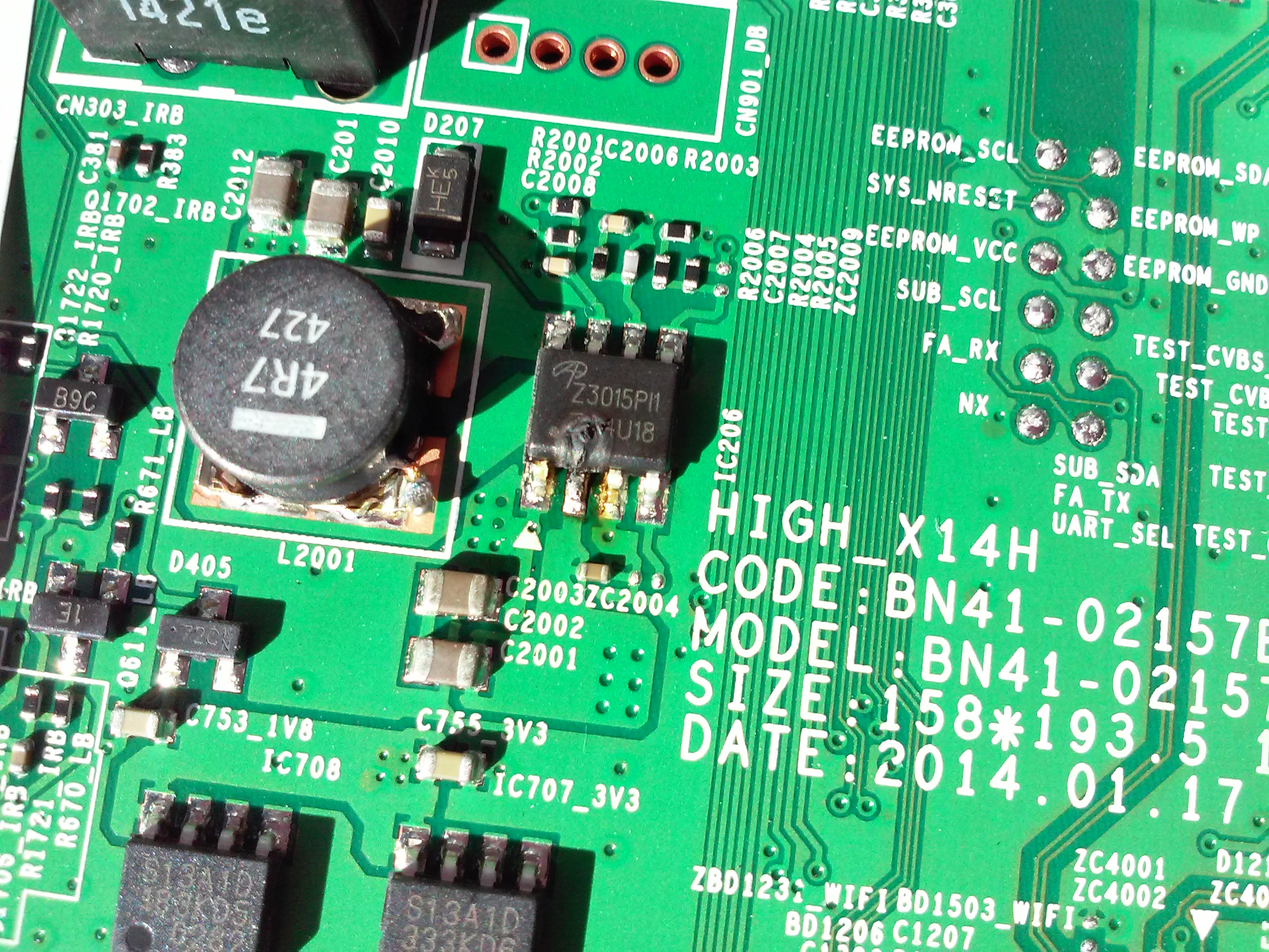

              I get no reading for buck output to ground. However I found low resistance on D207 and the 4 caps to it's left. I didn't know if it would be safe to power it up and test the voltages?
                any reading and this burn IC still on board are useless. must be out from the board first then test around in general this regulator should it had zinner diode in circuit i cant find it on board.. it may the ZC2009 fly out by heat !!!
                  That does not make sense for you to not see at the output low resistance reading to GND since the CATHODE of D207 (Anode connected to GND) is connected to the VOut pin 8 of the IC. D207 looks to clamping diode to protect the circuit in case the internal MOSFET Q1 of the IC shorted out.
                    Suck the chip off and measure it separately. This fault may also have been caused by something upstream or a short in the inductor (shorted turn) or shorted fly back diode. measure the output resistance to ground with the chip out to see if the load is also causing a problem.
                          There is bare pad on the bottom of the IC (see IC spec sheet) to transfer the heat to the copper pad on the board so it will take quite a bit of heat to remove the IC.
                          Cut the legs off the IC first will help.

                                • tvfixer007
                                  • Feb 2015
                                  • 86
                                  I tried soldering iron first no success. Lost my heat gun. Tried to cut pins off but scalped a few traces.
                                    I looked at this board on a few sites which ZC2009 and ZC2004 are not present on these boards.
                                      I tested D207 out of circuit and it's shorted.
                                        Yep, that is why the IC burnt up, Q1 was feeding that shorted out D207, the protection (Vout sense pin) did not act fast enough to turn off Q1.
