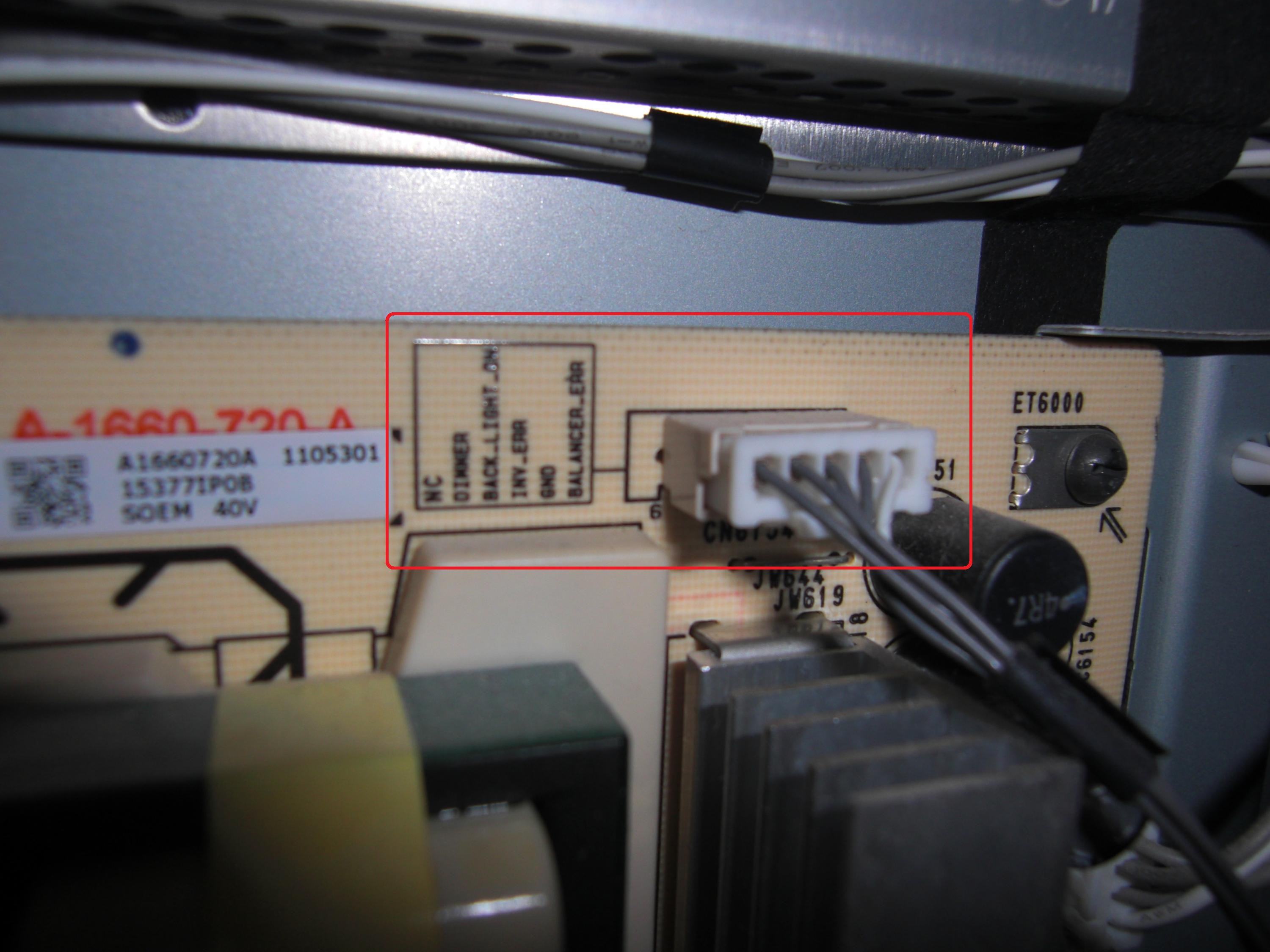

          What voltages do you have at the connector?
            Re: Sony Bravia KDL-40W5500 backlight issue
            I did the following DC measurements for connector CN6154 (connection with logic board):
            * NC: 0V
            * DIMMER: 0V
            * BACK_LIGHT_ON: 2V
            * INV_ERROR: 0V
            * GND: 0V
            * BALANCER_ERR: 0V
            But some values change 3 times for a few seconds, the third time the tv shuts down and the led starts blinking red 6 times. When the values change you can also hear some kind of "buzz" sound. Each time the values change to:
            * NC: 2.5-3V
            * DIMMER: 2.5-3V
            * BACK_LIGHT_ON: 0-0.5V
            * INV_ERROR: 0V
            * GND: 0V
            * BALANCER_ERR: 0V

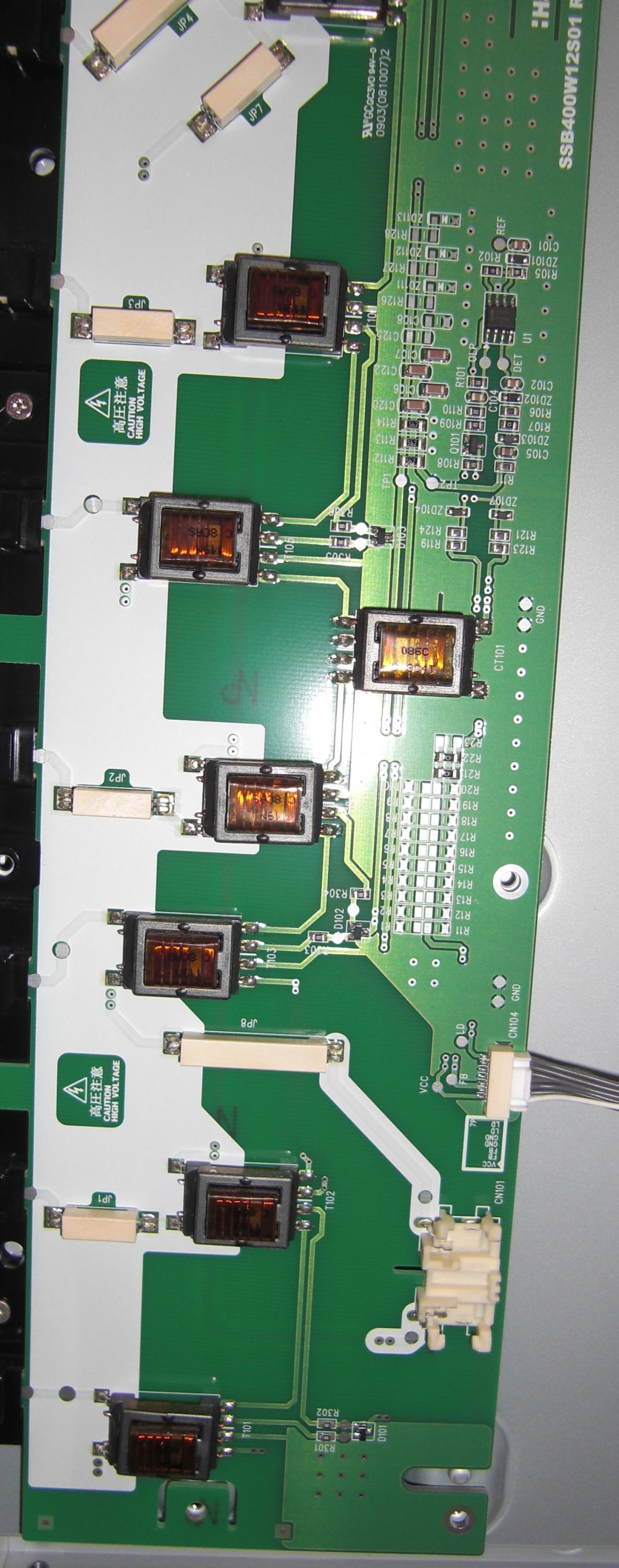

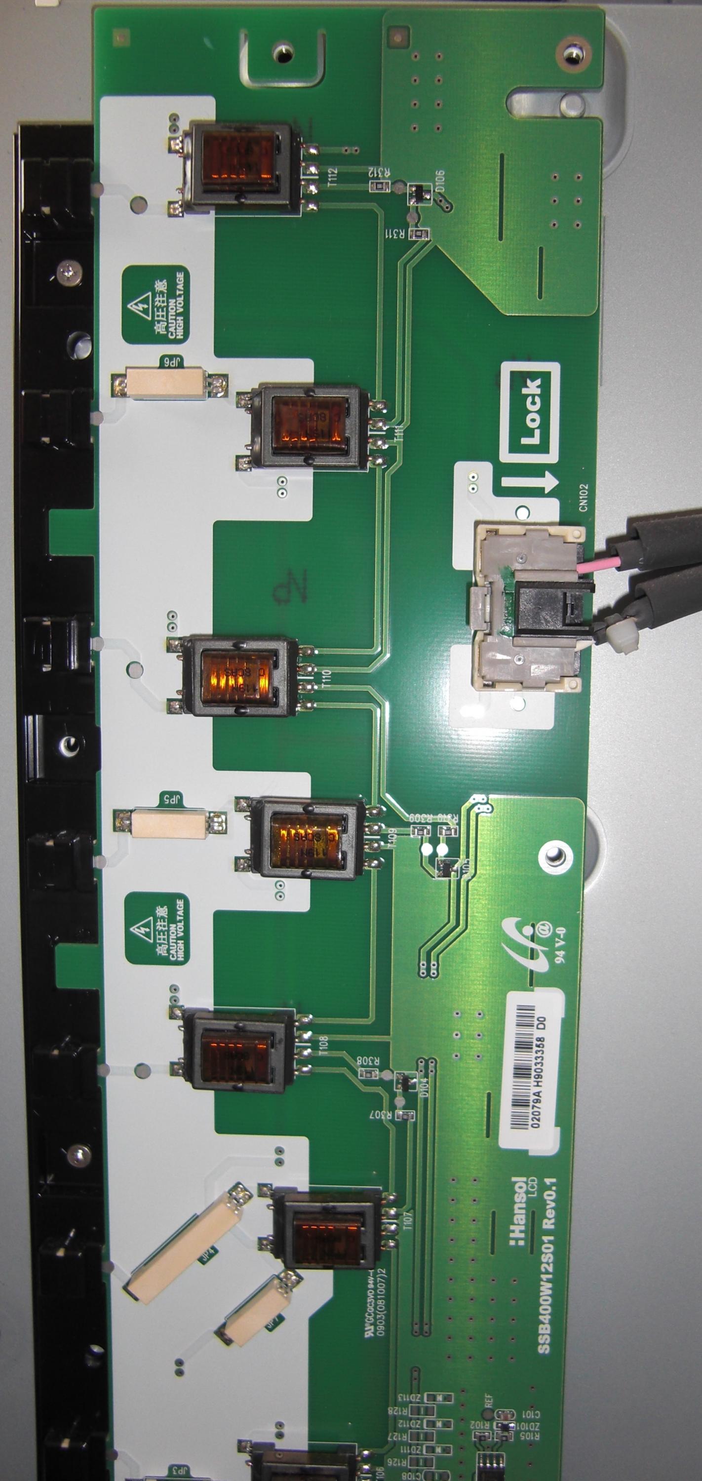

              Can you post a photo of your inverter board
                See attachement: because the board is so large, I took a picture for both the lower and upper part.
                  OK, so it appears that your problem is that no 12V supply to the inverter board.
