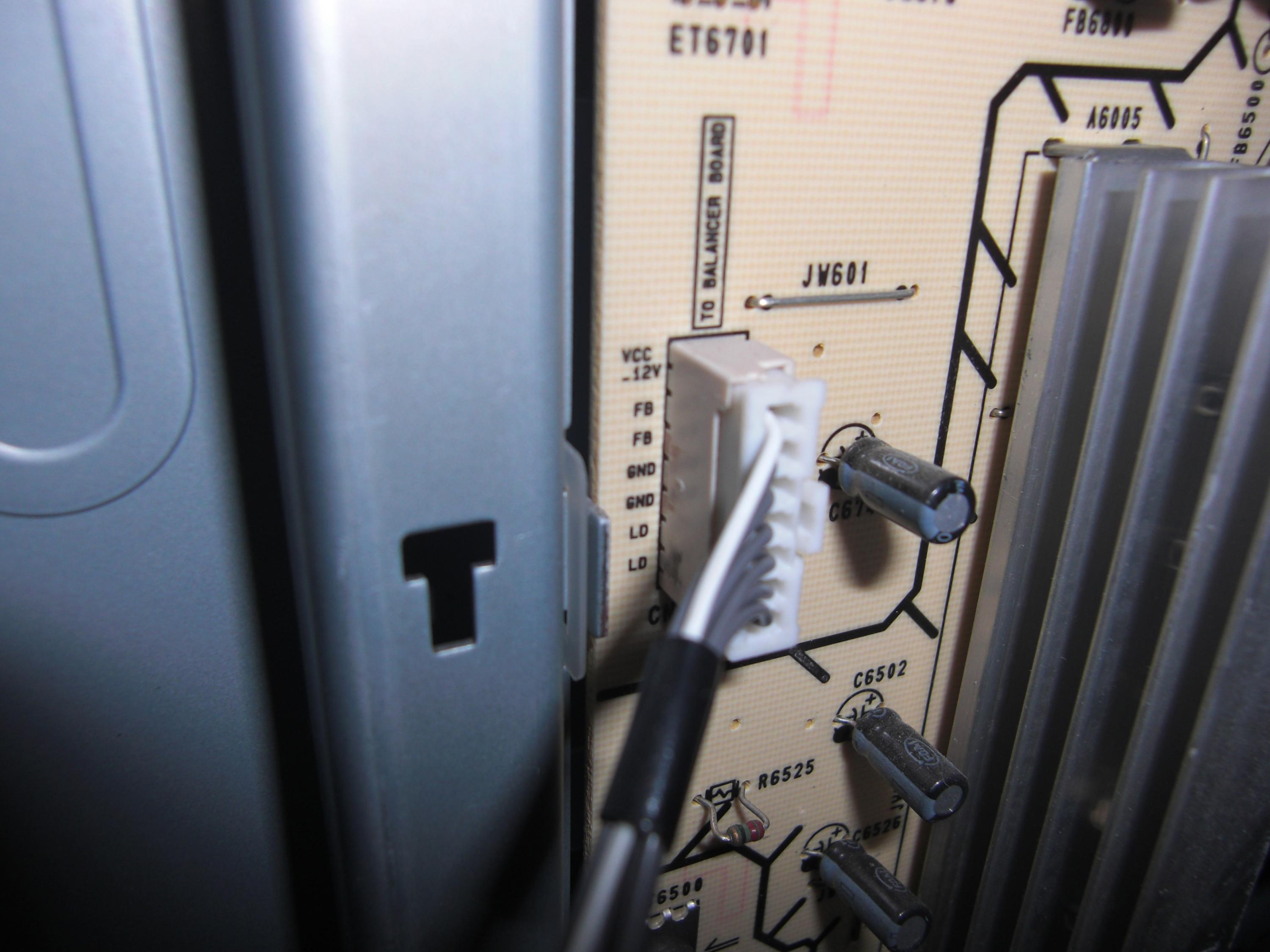

    I opened up the TV and did the following measurements:
    CN6701 connector (to balancer board):
    * 12VCC
    * FB
    * FB
    * LD
    * LD
    All these read 0V DC.
    All the transformers on the inverter board all read around 0.15V AC.
    I would be pleased if you can guide me finding the root cause of this problem!

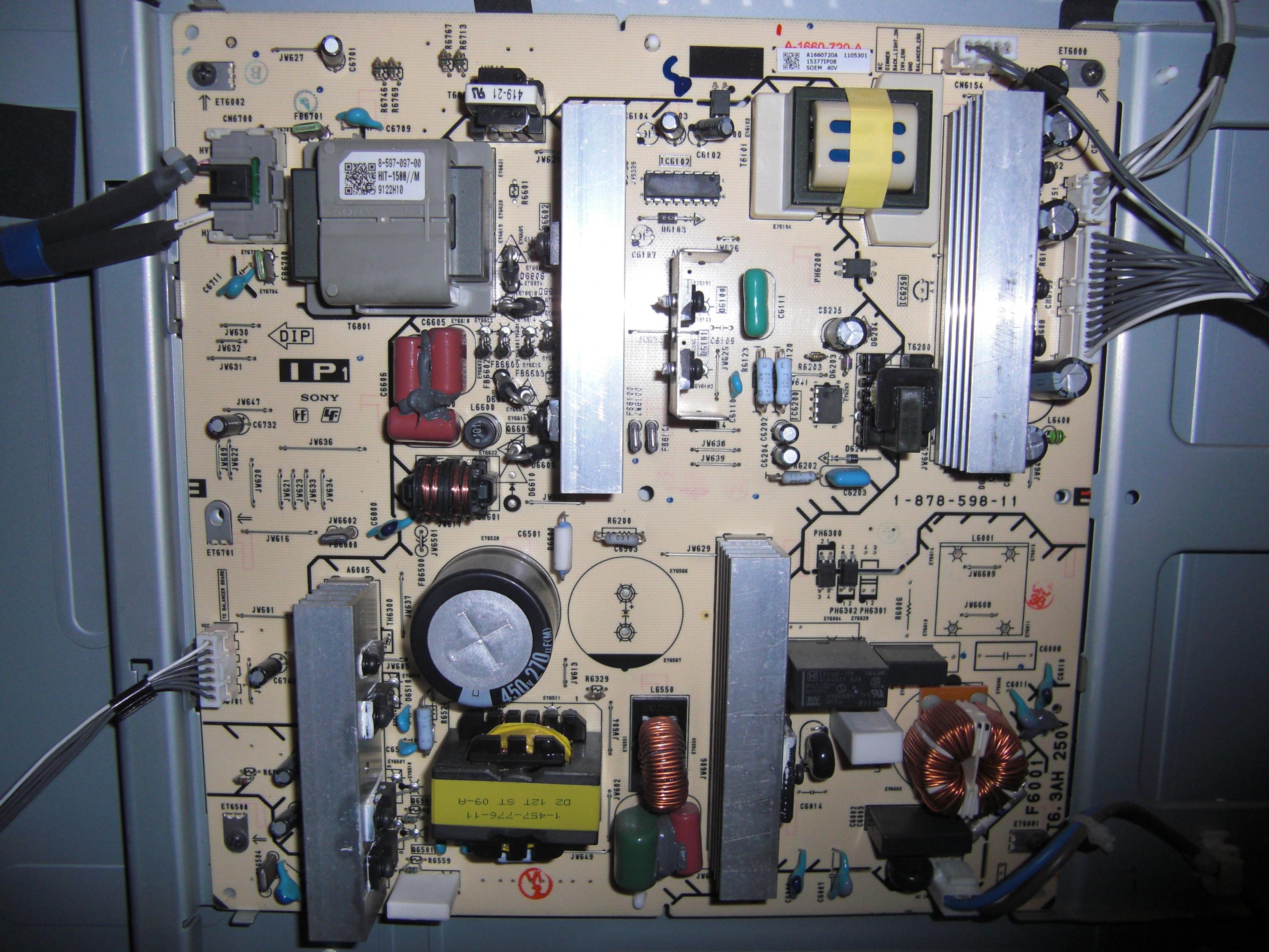

    Can you post some good clear pictures of all the boards in the tv?

        We need good clear pictures of your power supply board.
        What other Voltages do you have on other connectors of the power supply board?

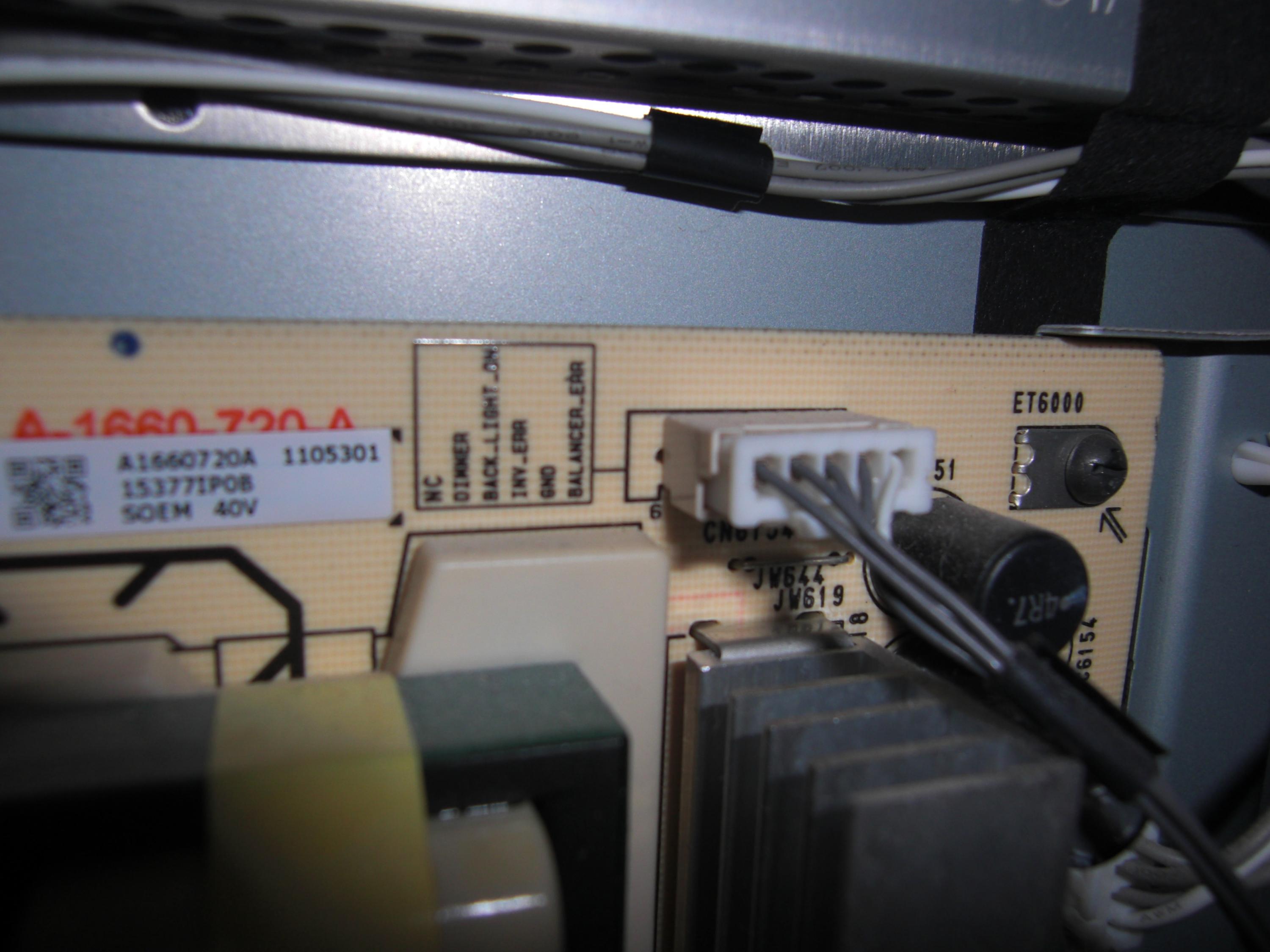

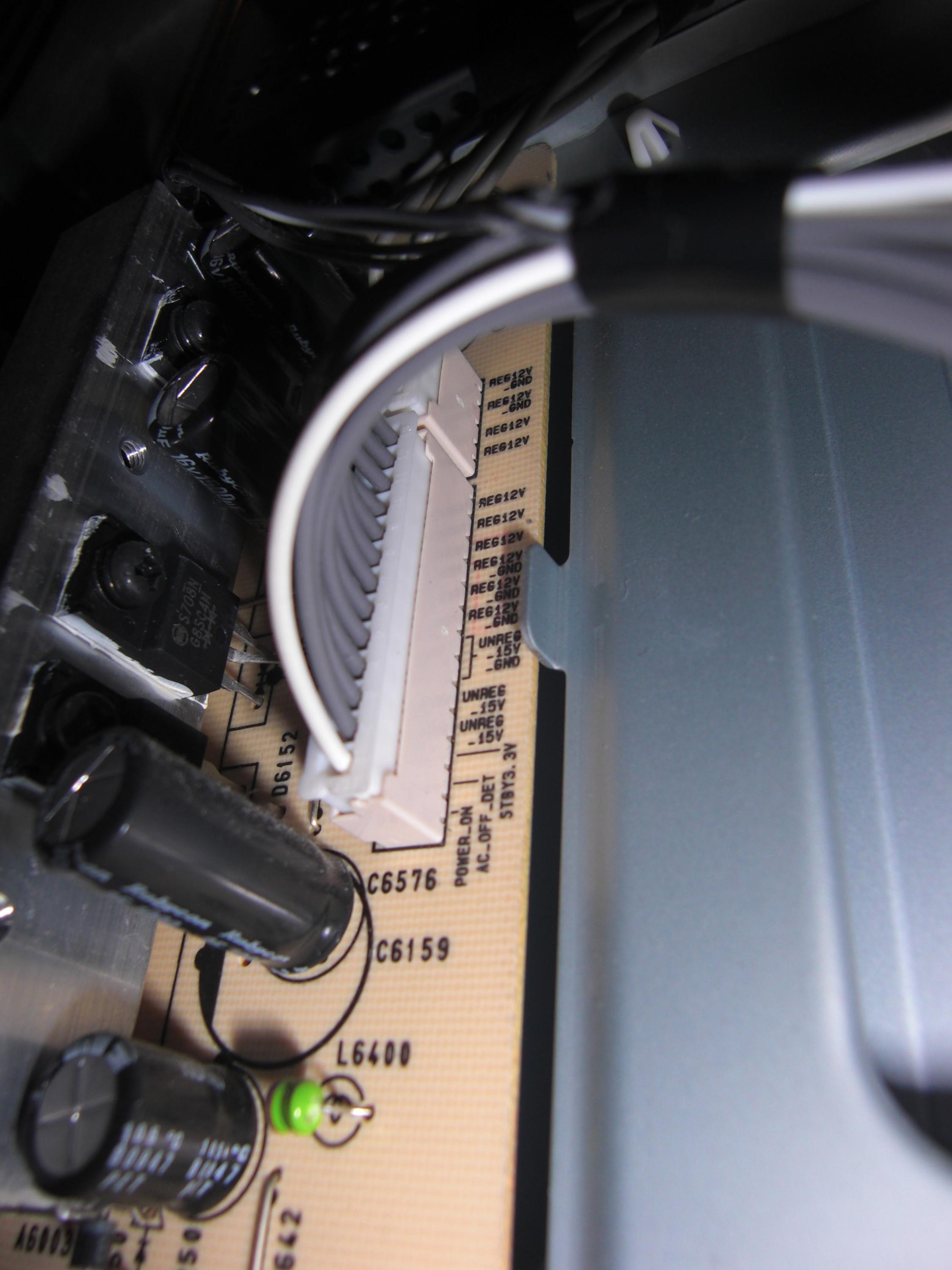

          In the attachment you can find the pictures. If they do not suffice, please let me know. I did some measurements. All readings are with TV turned on and are DC voltages.
          Connector 1 [CN6154] (connection with logic board):
          * NC: 0V
          * DIMMER: 0V
          * BACK_LIGHT_ON: 2V
          * INV_ERROR: 0V
          * GND: 0V
          * BALANCER_ERR: 0V
          Connector 2 [CN6151] (connection with TCON board):
          * Reg 12V - GND: 0V
          * Reg 12V - GND: 0V
          * Reg 12V: 12V
          * Reg 12V: 12V
          Connector 3 [CN6150] (connection with logic board):
          * Reg 12V: 12V
          * Reg 12V: 12V
          * Reg 12 V: 12V
          * Reg 12V - GND: 0V
          * Reg 12V - GND: 0V
          * Reg 12V - GND: 0V
          * UNREG 15V [?]: 0V
          * GND [?]: 0V
          * UNREG 15V: 15.2V
          * UNREG 15V: 15.2V
          * STBY3.3V: 0V (3.4V in stand by)
          * AC_OFF_DET: 3.4V
          * POWER ON: 3.3V
          In the last connector, I’m not sure if I read the names correctly for 2 wires (indicated with [?]). The readings for the fourth connector (connection with inverter board) are listed above.

                              Fusible R6500 (next to C6501) is the fusible resistor (white ceramic body).

                                I measure 0.4 ohm for this fusible resistor, which is pretty close to the 0.47 ohm indicated in the service manual.
                                  Re: Sony Bravia KDL-40W5500 backlight issue
                                  Have you visually inspected under the powerboard? In particular, check under the transformer (top left in pic 1) to see if there's any cracked soldering.
