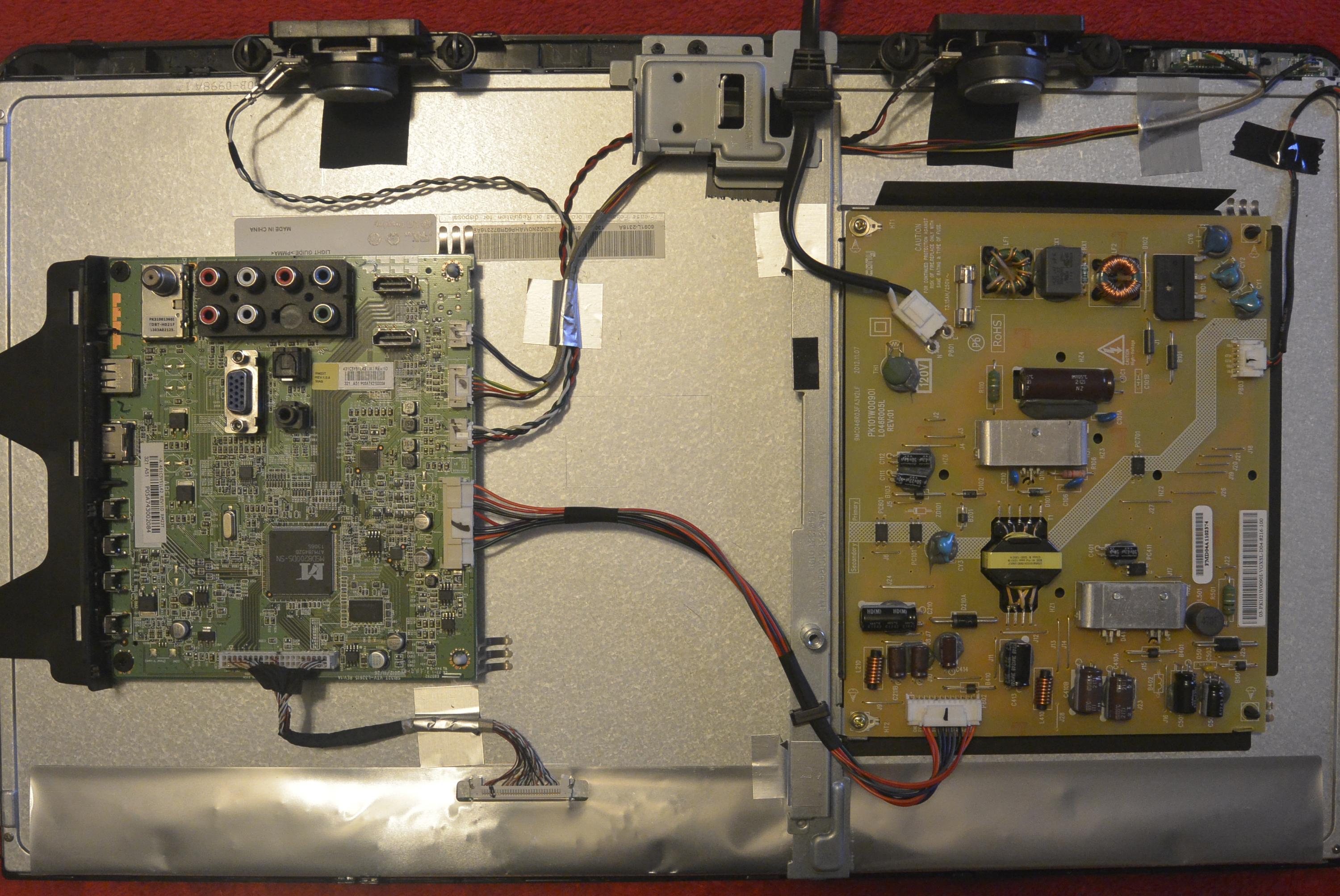

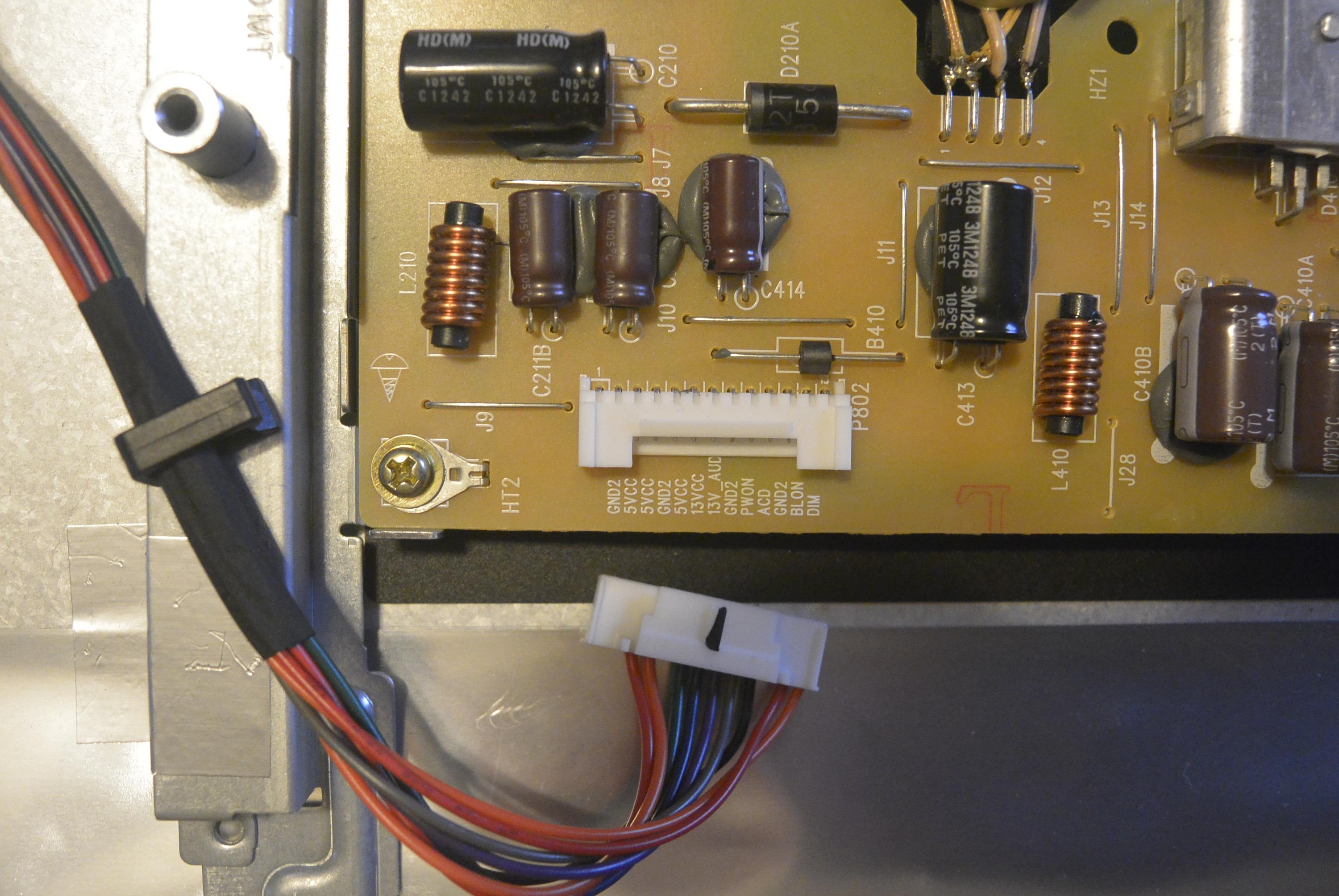

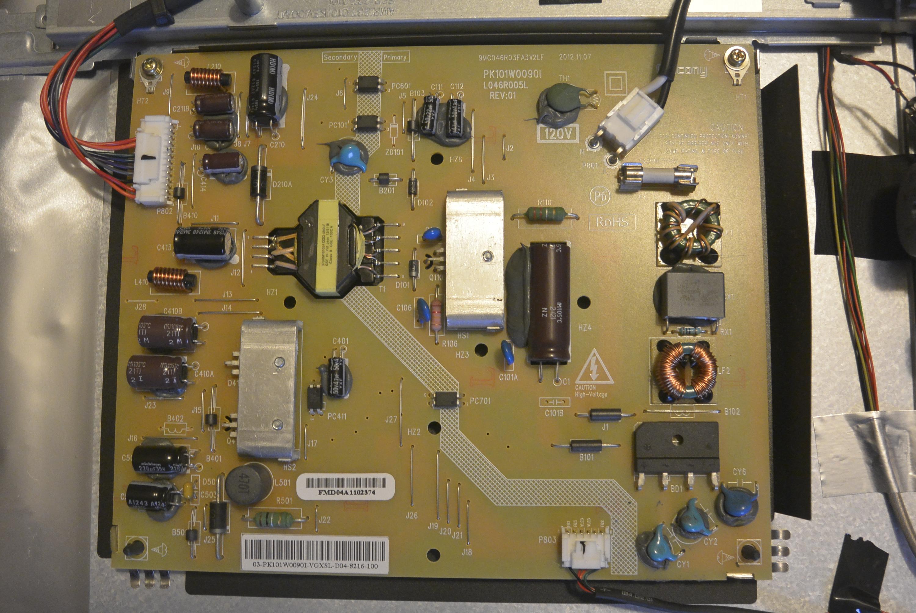

    There's no standby led lighting up. Without the main board connected, I get 5.14 on the 3 pins labeled for 5v for what I assume is standby(con isn't labeled as such...see pics). With main board connected, I get the following pin voltages:
    1 gnd
    2 5vcc 5.21
    3 5vcc 5.21
    4 gnd
    5 5vcc 5.21
    6 13vcc 12.71
    7 13vcc_AUD 12.71
    8 gnd
    9 PWON 3.03
    10 ACD 3.46
    11 gnd
    12 BLON 0
    13 DIM 0
    I realize that pins 6 & 7 are supposed to be 13v. I don't know what pins 9 & 10 should be, nor 12 & 13. Also, when checking diodes and fuses, I found that D210A on the Secondary side has reading both ways (208 and 1342) I keep running into this, and am wondering if this is normal on the secondary side, or not? I usually don't take the diodes out of circuit when I test them...maybe this is why I get this?

    I would say that the backlight on is missing (around 3V) and also Dim voltage
      Re: Toshiba 23l1350u standby voltage present, won't power up
      i would say that the backlight on is missing (around 3v) and also dim voltage
      +1
      12 blon 0
      13 dim 0
      • CapLeaker
        Leaking Member
        • Dec 2014
        • 8146
        BLon and the DIM signal are coming from the main board.

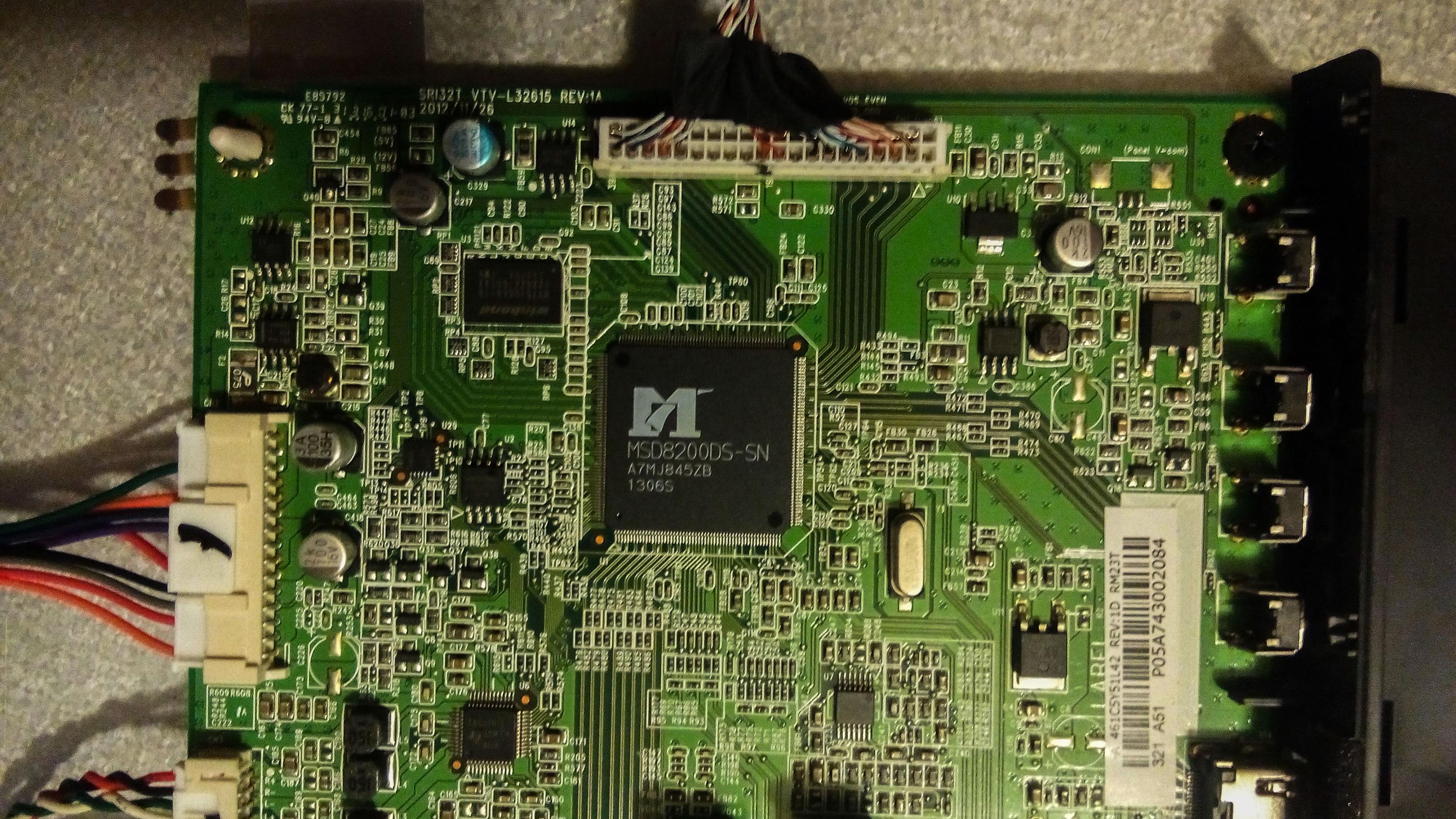

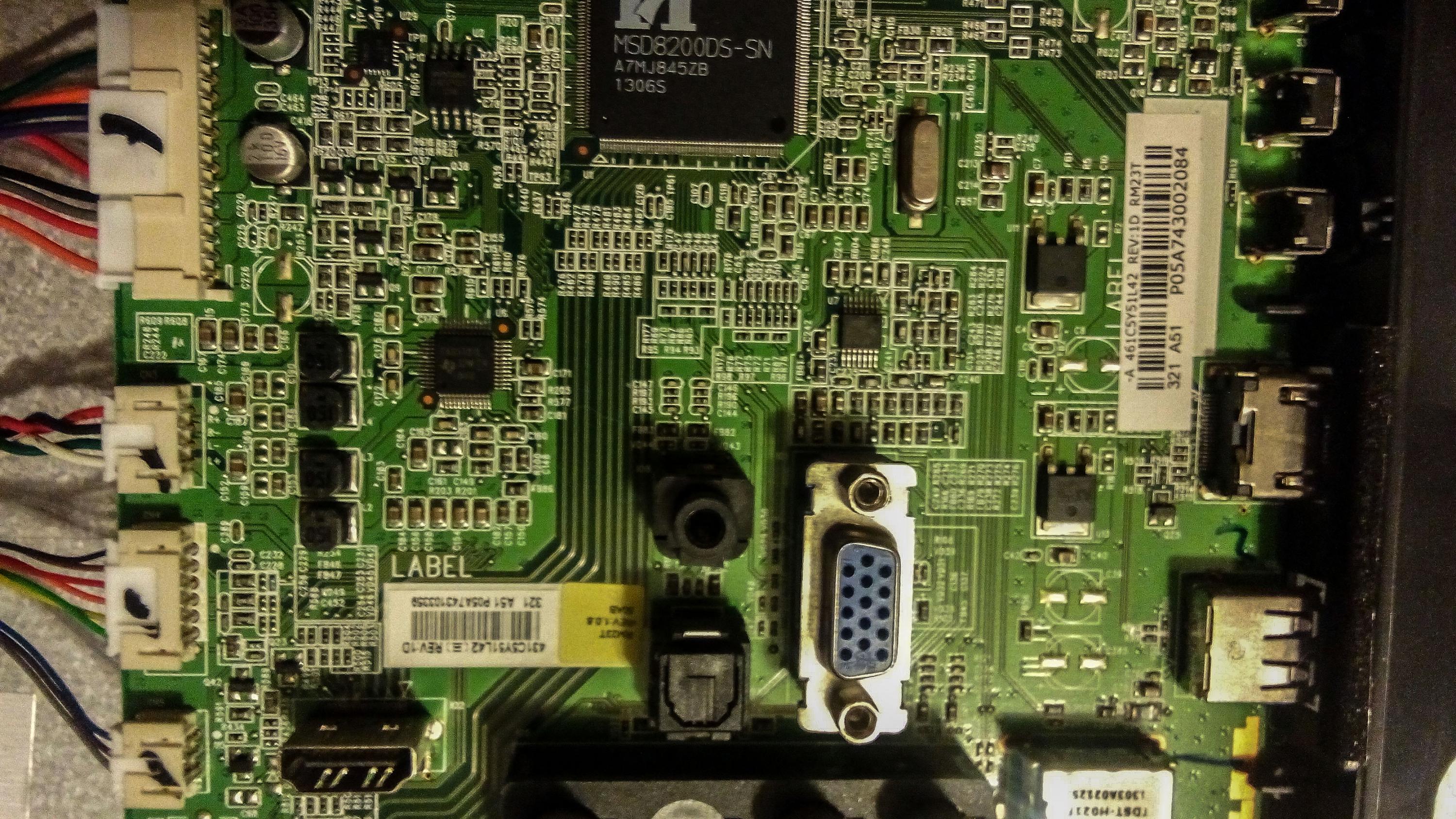

          try replacing the 1117-ADJ regulator.it is on the main board.located near lvds connector.
          • koka0011
            • Apr 2013
            • 30
            • Sri Lanka
            i have highlighted the regulator

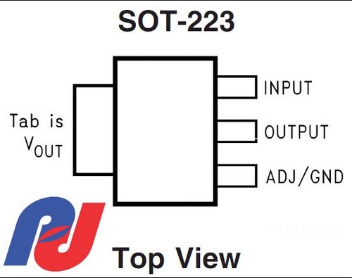

                    I've looked for the label on this regulator, and it doesn't have what you've indicated...does this matter? The number code on the second line reads "17-33"...with possibly being "17-331". The top line isn't readable except the last bit of "3BC". I am wanting to make sure I have the correct specs for seeing if the output I get is good.
                    • vinceroger69
                      • Mar 2012
                      • 6714
                      • uk
                      Originally posted by AcGeorgiegirl
                      I get an input voltage of 5.21 and an output of 3.25.
                      maybe a IRU1117-33 in a 5V to 3.3V regulator so if it is it working ok

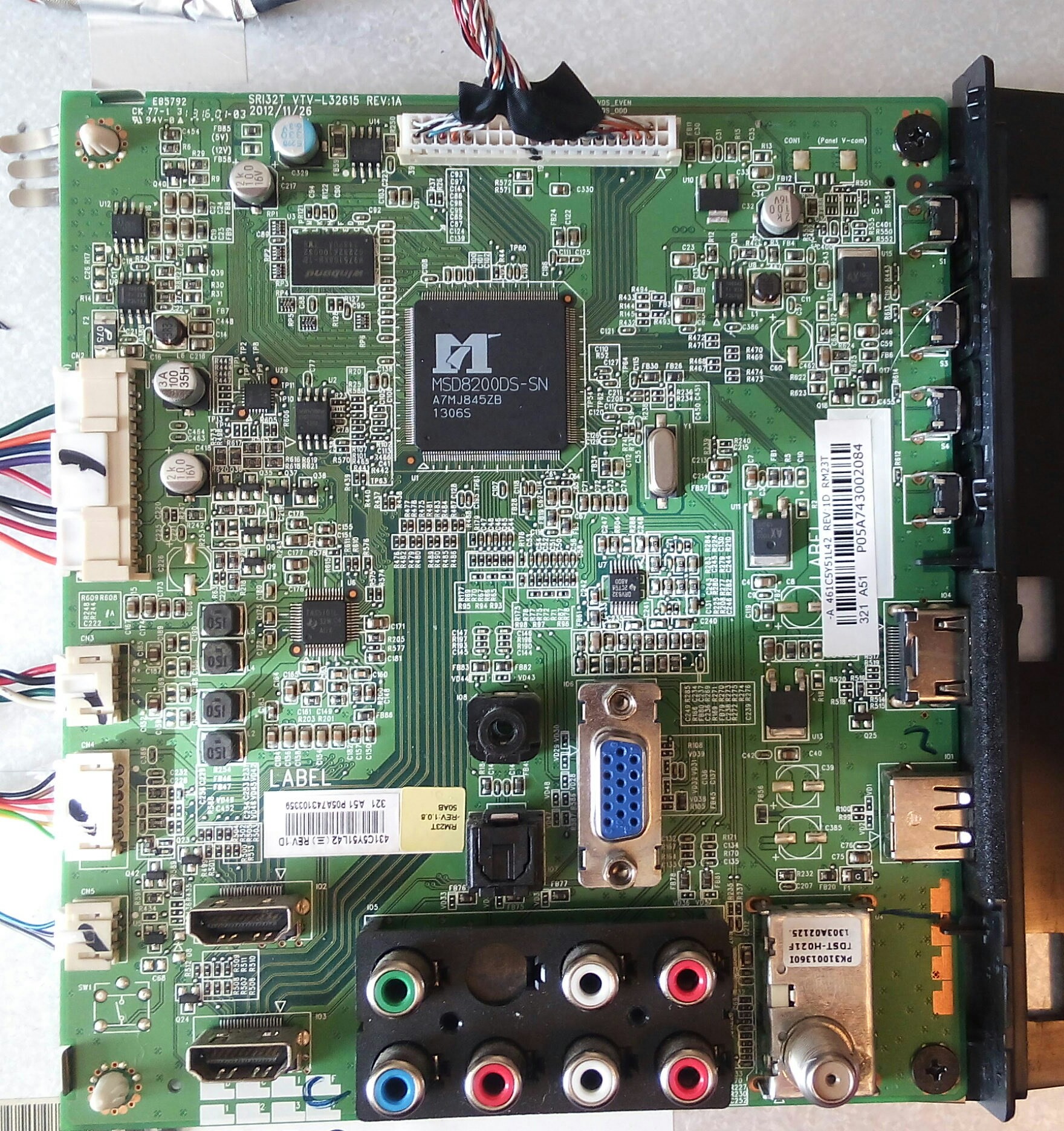

                        Are there any other regulators? I see some larger parts which could be higher current regulators. (From stock photos, seem to be U11, U13, U15)
                        There are also a few switching regulators, it seems.
                        Can we have a better photo of the mainboard?

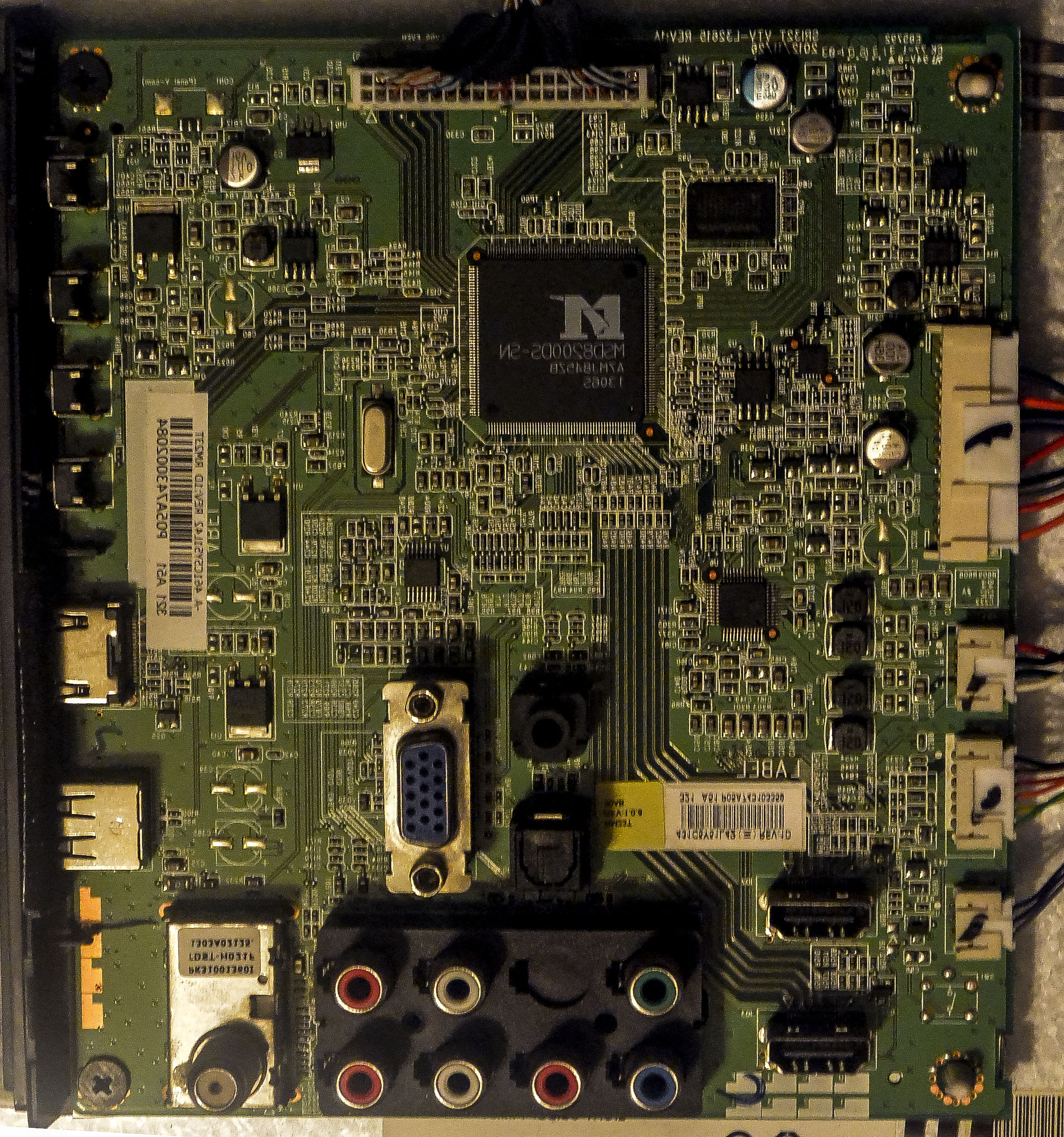

                          I couldn't get in close enough for clarity, but here's some pics I hope will help.
                          • AcGeorgiegirl
                            • Jun 2013
                            • 202
                            The three regulators you've indicated are correct...they read:
                            U11 no input voltage
                            U13 no input voltage
                            U15 input 4 v
                            output 2 v
                            *this one, at first was reading 3v as input, but a couple of minutes later was 4
                            • AcGeorgiegirl
                              • Jun 2013
                              • 202
                              I am understanding this looks like a main board issue, right? Any suggestions as to what I can test for failure, or do you guys suggest just replacing the board? I'd much prefer learning how to repair what's wrong, which is what you guys are so good at helping with!
                                Yes, the main board problem, the key is to get the schematic diagram of the main board to do the component level troubleshooting of the complex main board.

                                  What's the resistance between Pin 12 (BLON) and Pin 1 (GND) at the power supply connector and the equivalent positions from the main board?
                                    Ok. Can you tell me, on the board, where the PN is, so I can start searching? I see two white labels that might be it, as well as what's written directly on the board at the far left top.
                                      I'm not sure what I would put my DMM on as far as mode...would I use Ohm's mode and then set it to range at 200(the lowest setting)?
                                      ...and should the power be plugged in and turned on, etc?
                                      • vinceroger69
                                        • Mar 2012
                                        • 6714
                                        • uk
                                        no power on as testing resistance then test between pin 12 and pin 1 and yes ohms mode
