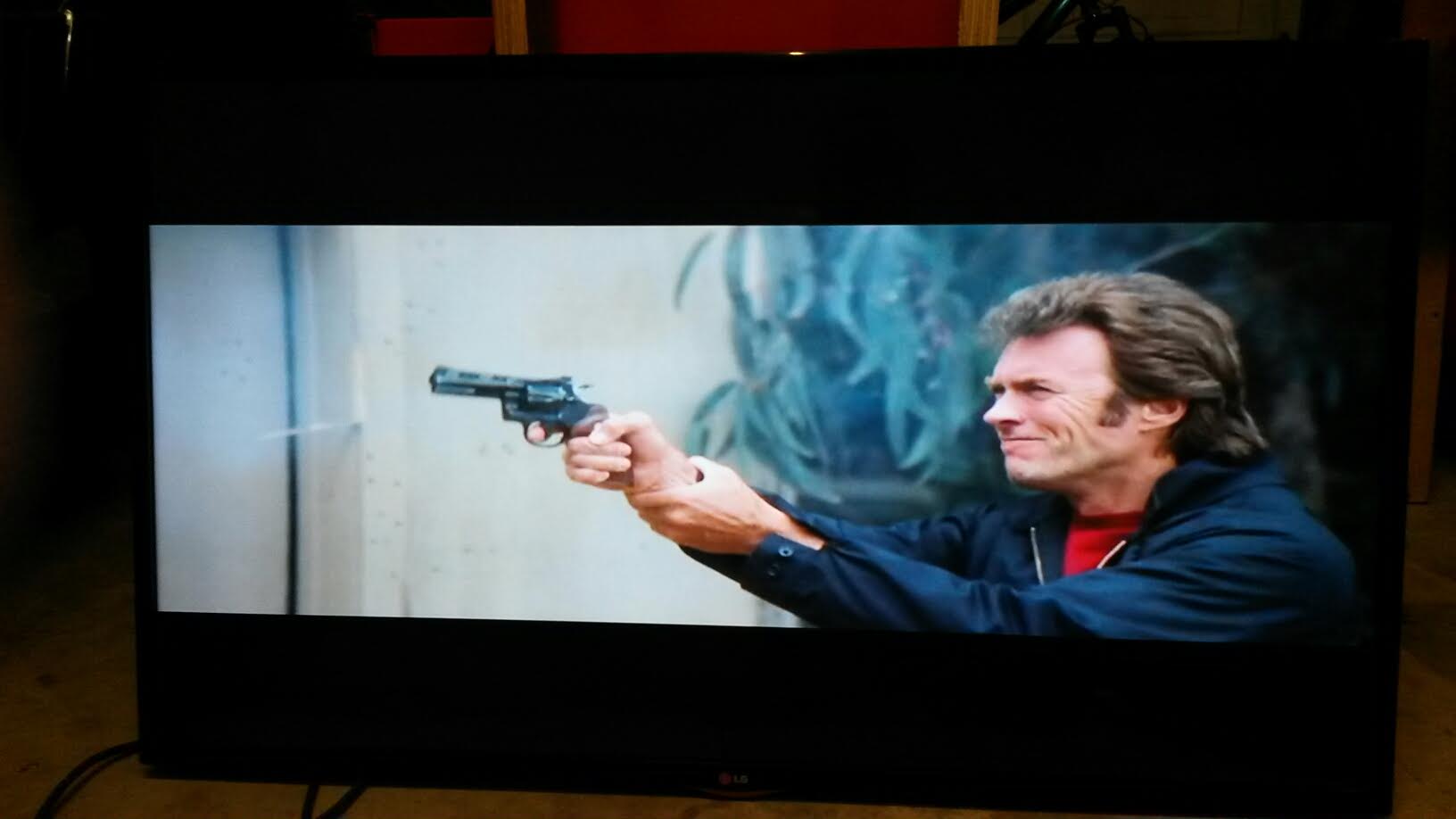

    You only need to cover those pins that return the picture to normal. Try and keep as many of the pins in use.
    I have seen this trick done but do not know what if any the long term effects are.
    Post a picture of the final results of the screen.

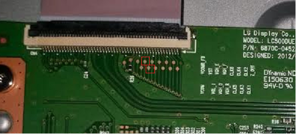

                  Ok, let me run this by you guys. With the ribbon cables connected from the
                  t-conn to the panel (no Tape), and I check the voltage on the 2 test points on the t-conn (with the red squares in the picture), they both cycle constantly from +30V to -4V. Everytime the voltage cycles, the picture changes on the screen, but there are still lines on the screen at both voltages. With the ribbon cables disconnected from the t-conn to the panel , the voltage still cycles from +30V to -4V.
                  Now what I am wondering here is, if the ribbon cables are disconnected fom the t-conn to the panel, doesn't that eliminate the problem if it were a panel fault?
                  If so, would that indicate a main board fault since the t-conn has been replaced, and the old t-conn was showing the same voltages when I probbed the test points on it?
                  • jjanssen7
                    • Nov 2012
                    • 252
                    #29
                    Re: Lg 50ln5100-ub
                    If there are lines on the screen with both voltages, doesn't that eliminate the voltage change as a cause/symptom of the lines?
                    • Fisher77
                      • Feb 2016
                      • 229
                      #30
                      Re: Lg 50ln5100-ub
                      Damn, I didn't think about it that way. Good point jjanssen7.

                      • Fisher77
                        • Feb 2016
                        • 229
                        #31
                        Re: Lg 50ln5100-ub
                        Well it is taped now. I had to cover 12 tracks of the right ribbon cable. It still has a slight twitch in it, but with a movie going it is barely noticable. If I tape over 13 tracks, the twitch is gone, but it has a line on the screen.
                        Thanks jjanssen7 for cluing me in on the tape trick
                        Thanks for all the help everyone.
