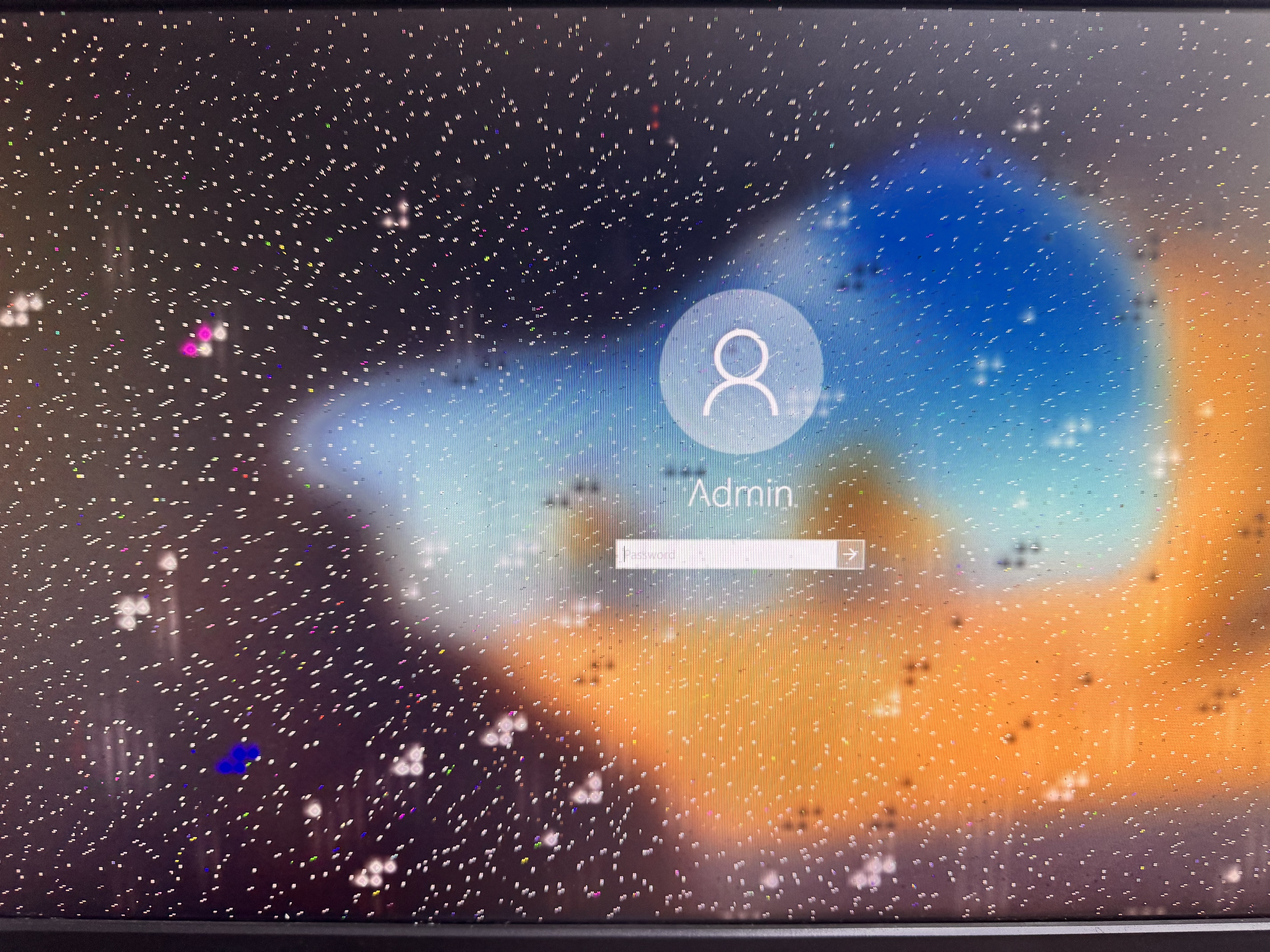

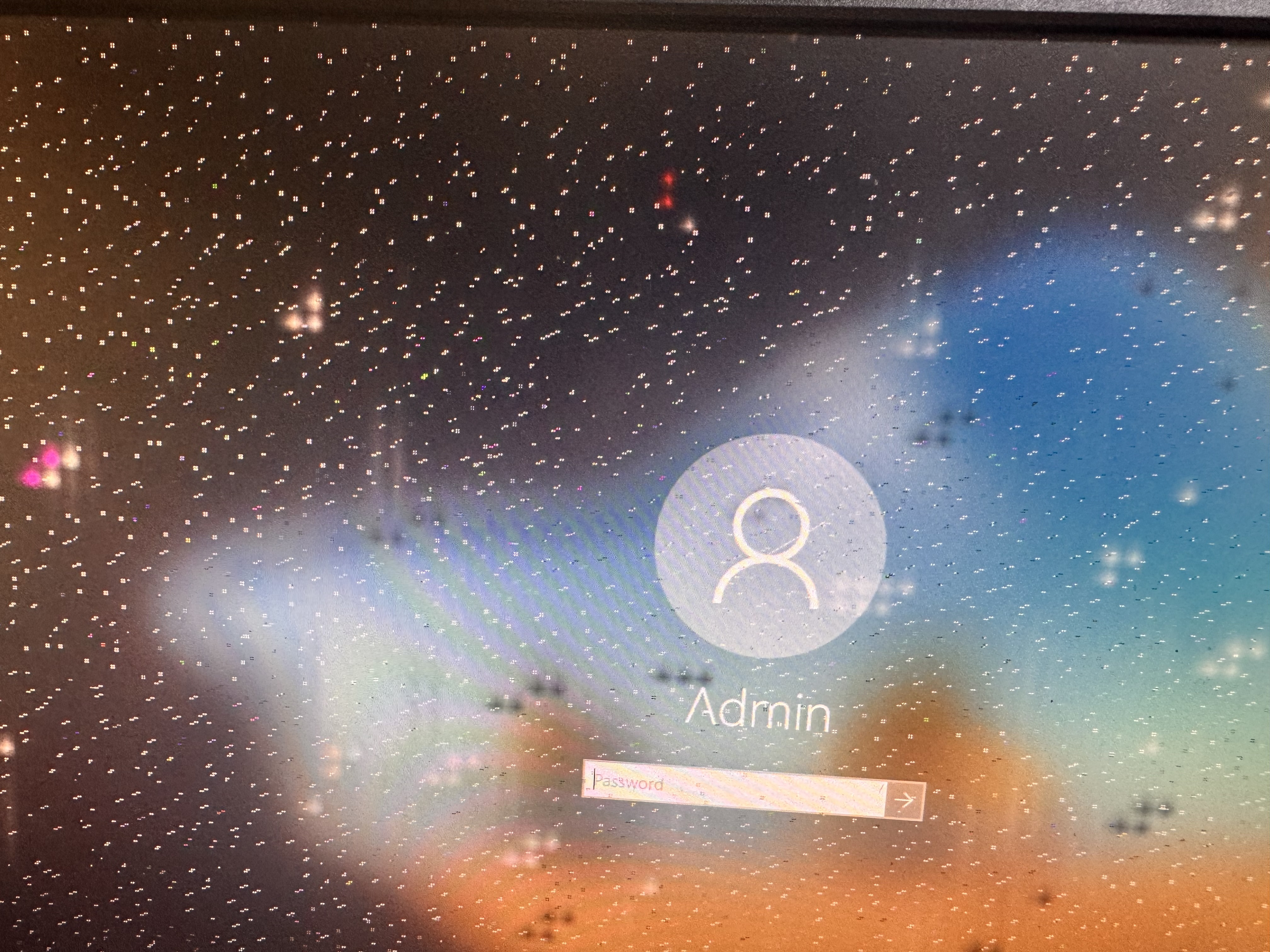

    HP 820 G3 Dots/Blurry Screen
    Hp 820 G3
    6050A2725001-MB-A01
    This laptop has dots that show up once on the windows login screen. The bios menu and windows loading phase doesn't have them.
    What I have tried:
    change screens but it's not a screen issue as they show on internal and external display.
    Changed SSD and Windows
    Wrote a new bios
    Inspected if there is anything unusual on the board, none
    Has someone seen this before, what could be the issue
