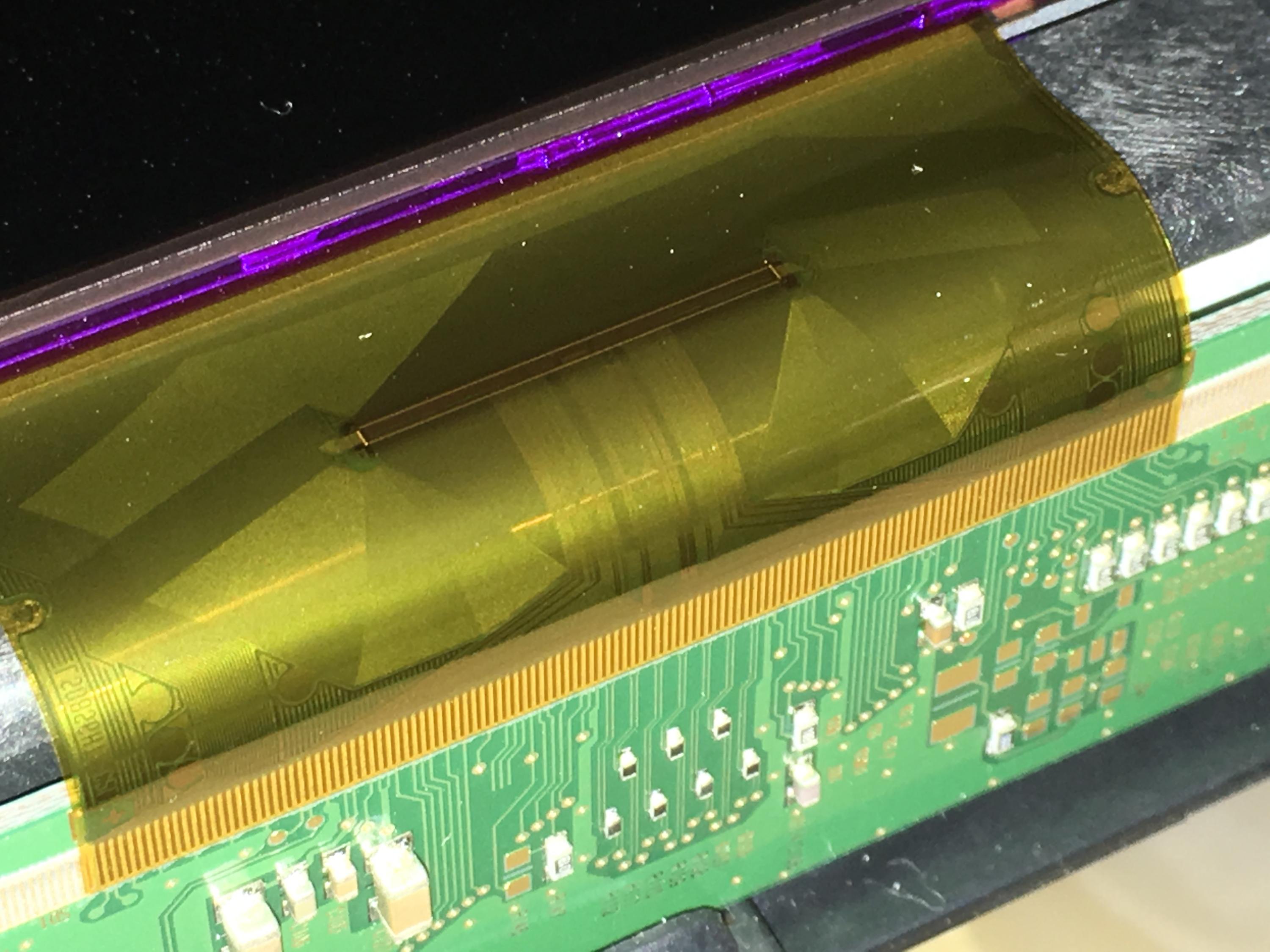

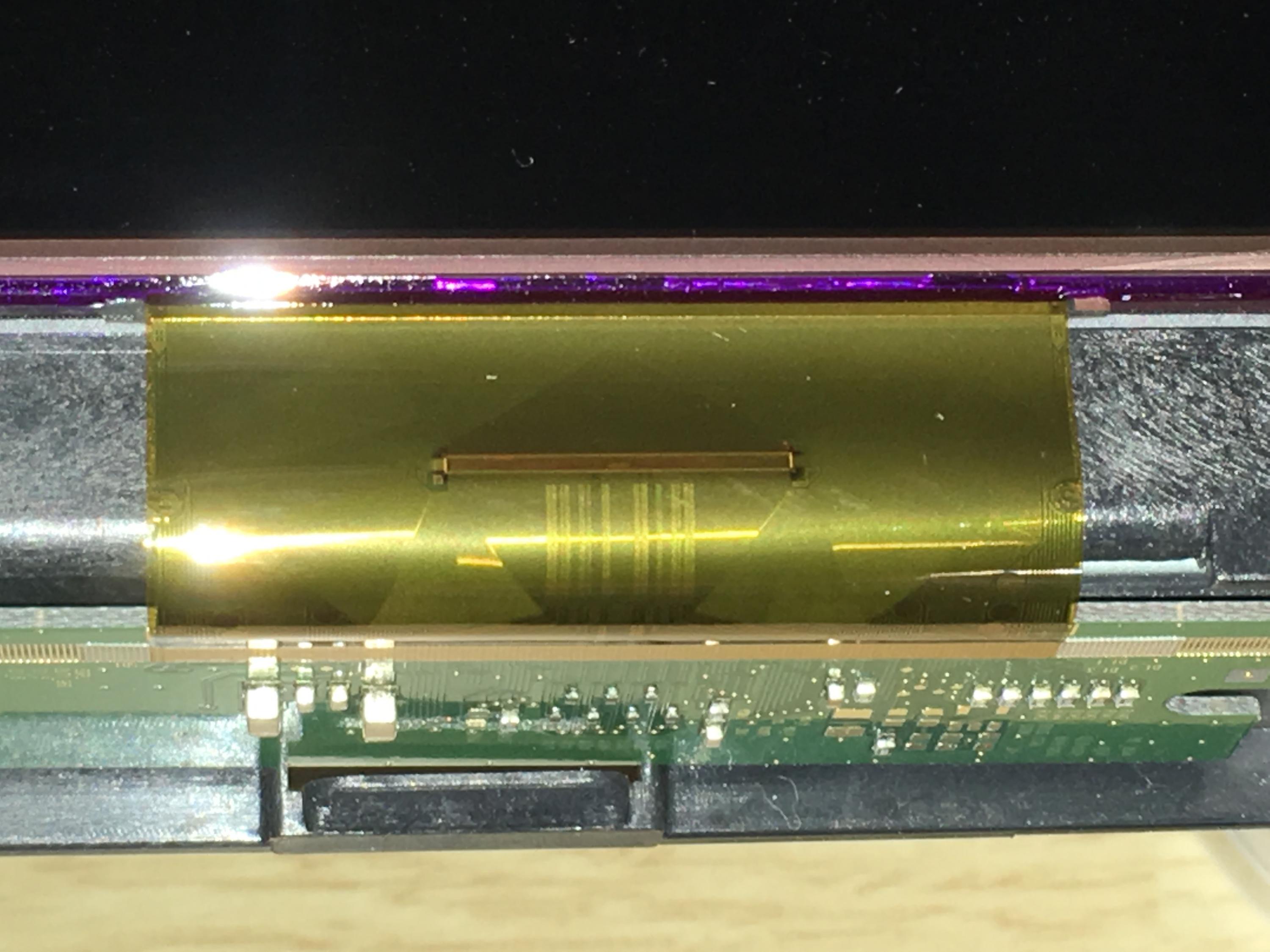

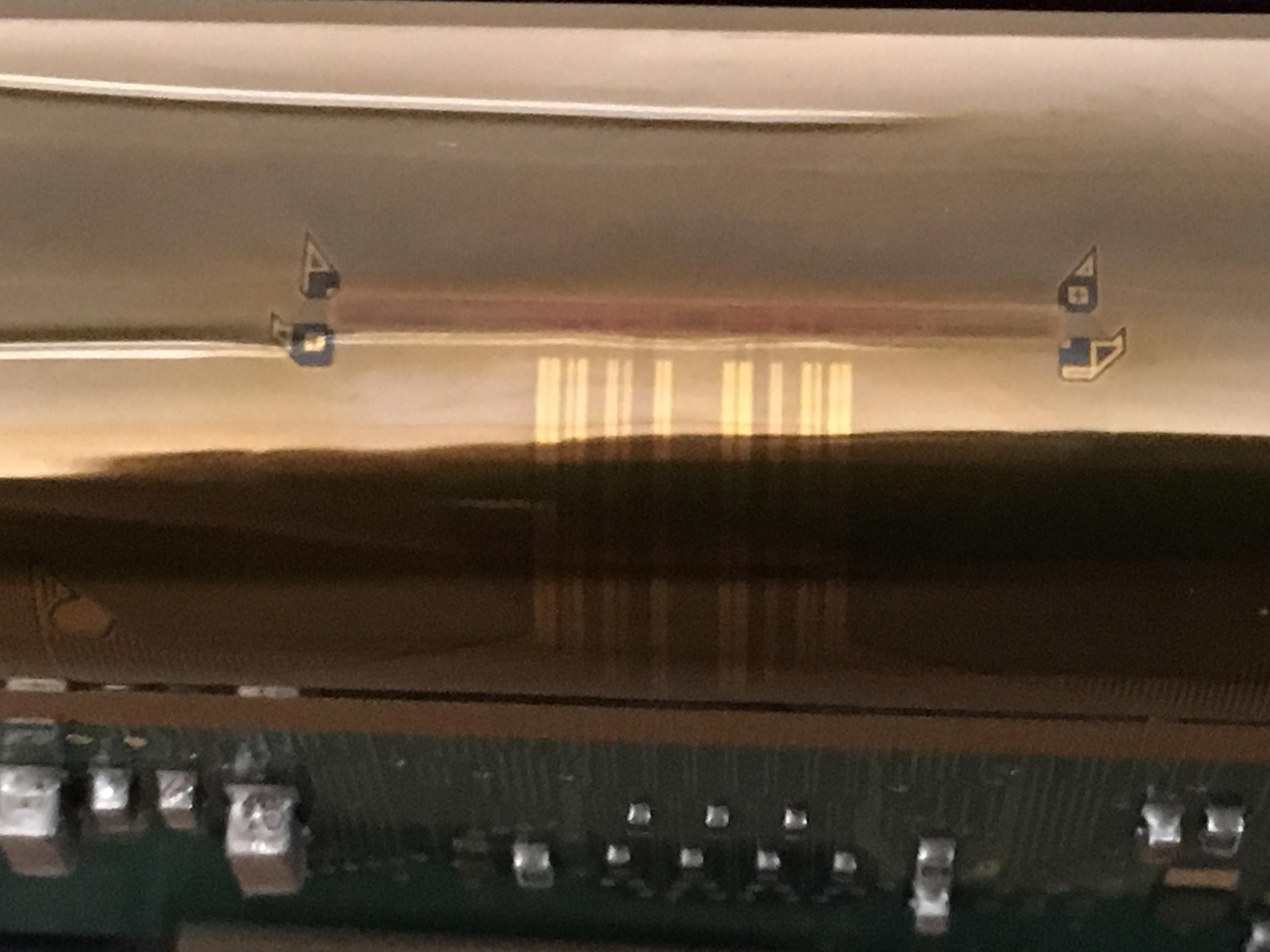

Before I used the hair dryer on the tab I used a 5mm nozzle and 2mm nozzle (see attached image) on my SMD rework station to heat the PCB. I heated each SMD on the PCB. It was when I used the 5mm nozzle on the tab that I discovered that heating only the tab fixed the problem. I took my time holding the 2mm over each component on the PCB with no effect. I was not heating the PCB when I used the 5mm on the tab. When I heated the PCB end of the tab, there was no effect. Only when I heated the panel side of the tab did I discover that the tab was the issue. I used a hair dryer in the video only because it was easier. I tried pressing lightly on the tab to see if maybe using a shim would work but it had no effect. I will try to find the thread that you suggested.
