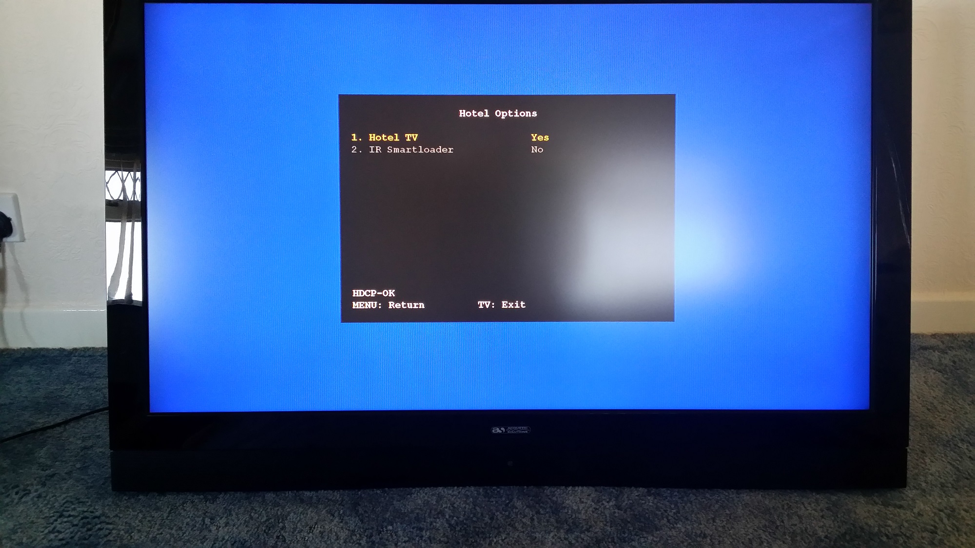

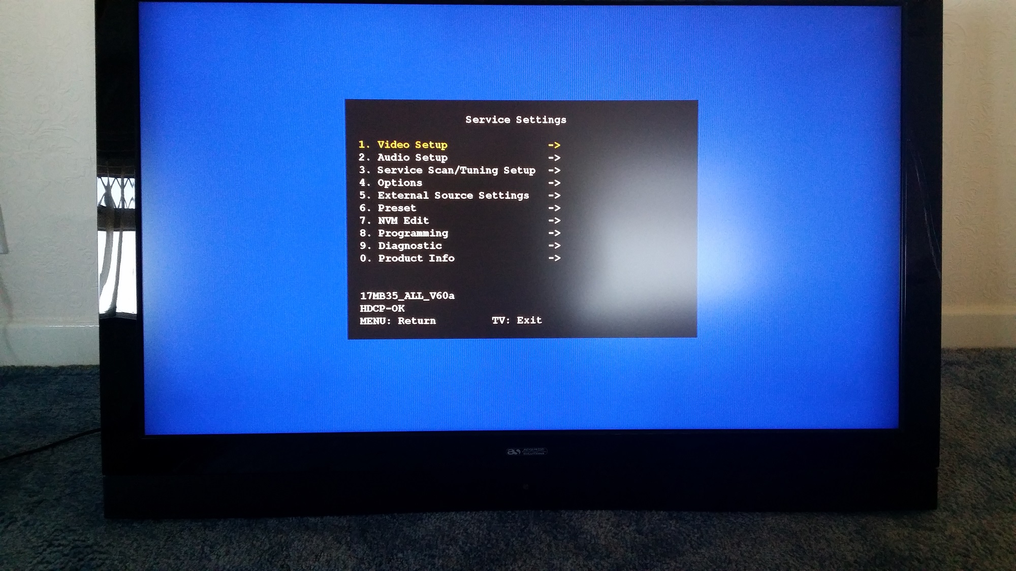

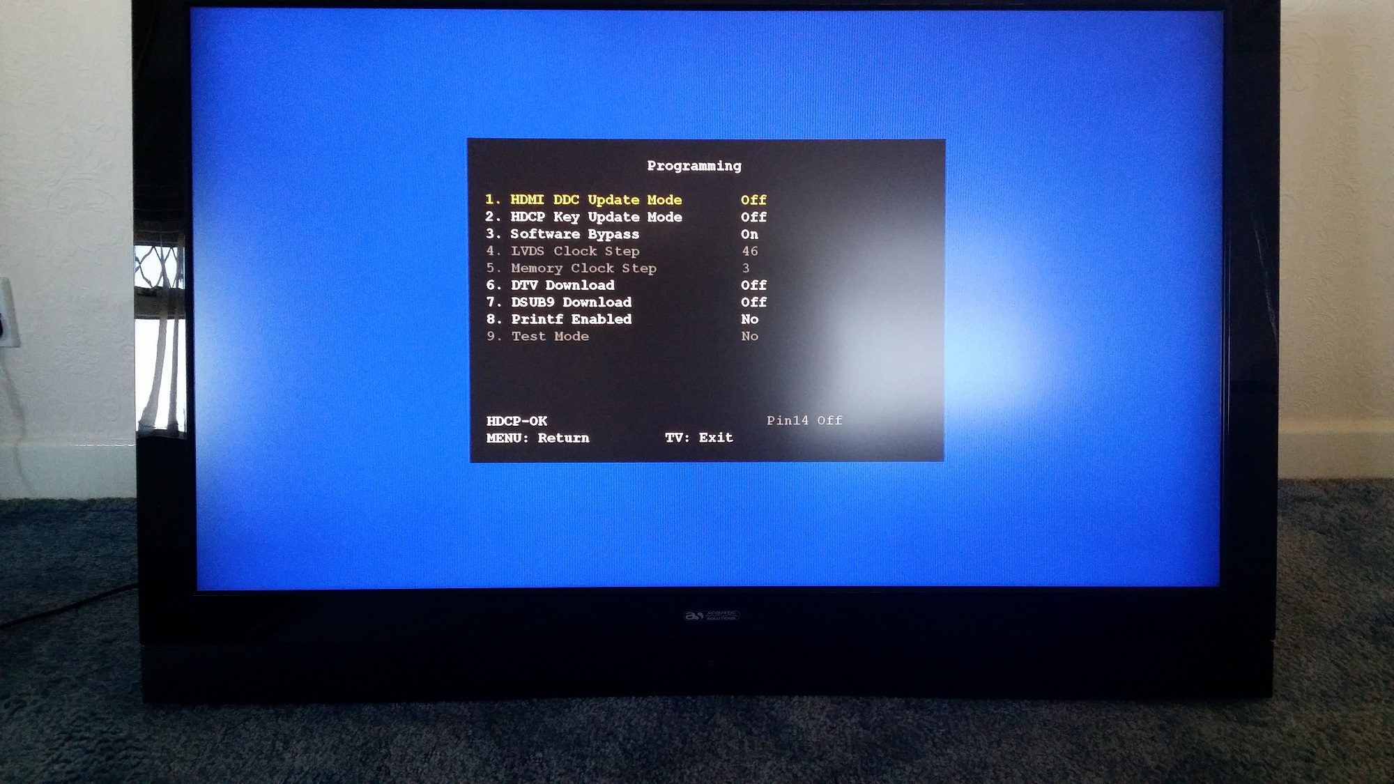

                          Had alook at service settings . see Pictures.
                          The hotel option is set as yes and grayed out "cant be switched to no"
                          I went into the programming section and uploaded pic of settings in there too.
                          I have not adjusted any settings .
                          The problem with this tv has me tearing my hair out.
                          I get no sound or video inputs eg hdmi, scart etc. yet in the menue screens i can adjust the picture/ volumes/ pip/pap settings, everything is still user adjustable. There is no DTV at all. I cant remember the dtv because ive always used a HDMI freeview set top box with recording functions built into it.I forgot that this TV even had a freeview tuner built into it.
                          When this tv went off , I had my laptop connected to it through HDMI , i was reinstalling my laptop with an image created earlier. I left the room to come to my gamer pc , when i went back the tv has the problem mentioned here.

                                try unlocking the feature with pin code .. might be 0000 if it hasn't been changed

                                  don't panic its easy to rid off hotel mode
                                  those code for your info
                                  Various VESTEL SERVICE MODES to try:
                                  STANDARD/DEFAULT: MENU, 4,7,2,5;
                                  CALIB MENU: MENU, 4,7,2,6
                                  HOTEL MENU: MENU, 1,3,2,5
                                  VESTEL - 17MB25-35 CHASSIS
                                  HOTEL MODE: MENU, 7,9,3,5
                                  if in digital, press MENU, then select TV setup, and input above.

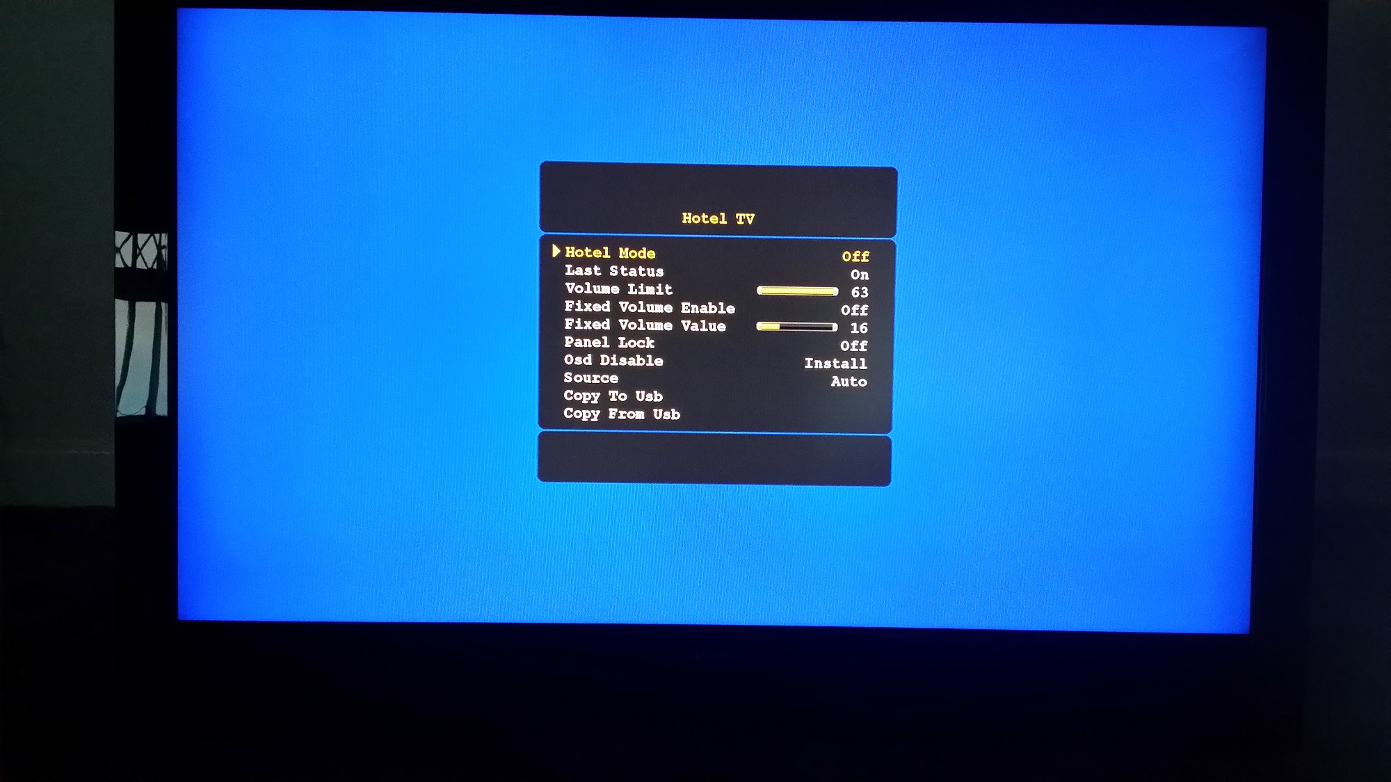

                                    I followed that guide and the hotel mode is set to off. In options on TV Hotel options is set to yes and grayed out.
                                    Reece
                                    in service settings,
                                    6. Preset shows
                                    1 USER ADJ
                                    2 ADC ADJ
                                    3 SERVICE ADJ
                                    4 ALL ADJ
                                    5 INIT FACTORY CHANNELS
                                    All came up with Please wait and then Done.
                                    Pete
                                    That instruction went straight over my head.

                                      Hotel screen
                                      • vinceroger69
                                        • Mar 2012
                                        • 6714
                                        • uk
                                        #39
                                        Re: Acoustics Solutions Lcd42761f1080p
                                        that looks like its turned off ok now have you tried re tuning the tv channels
