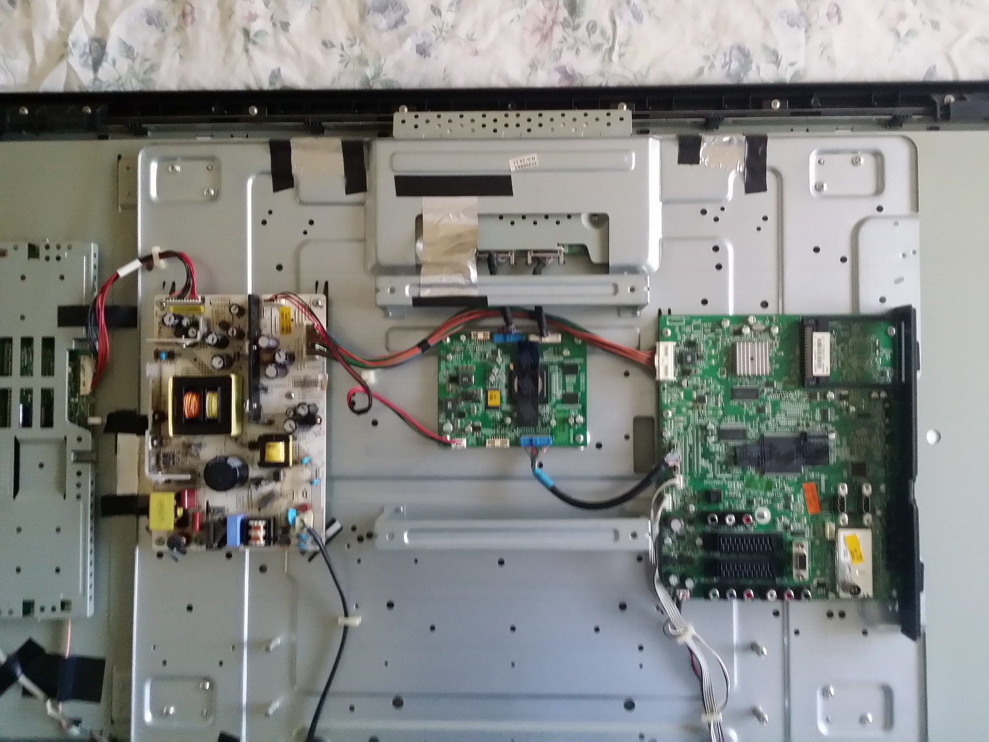

    Long story short.
    15th December Tv went off stuck on standby flashing blue light.Tv would not start up. Took back off found 2 bad caps and replaced. Same problem flashing blue light wont come out of standby.

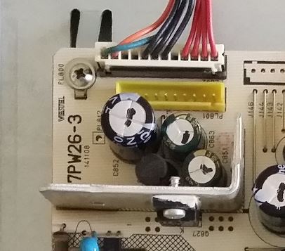

    Bought 2 Boards off Ebay, Both DOA, one sent back, other board still to send back. Bought new caps replaced all ones in pic, psu marked with black marker pen.

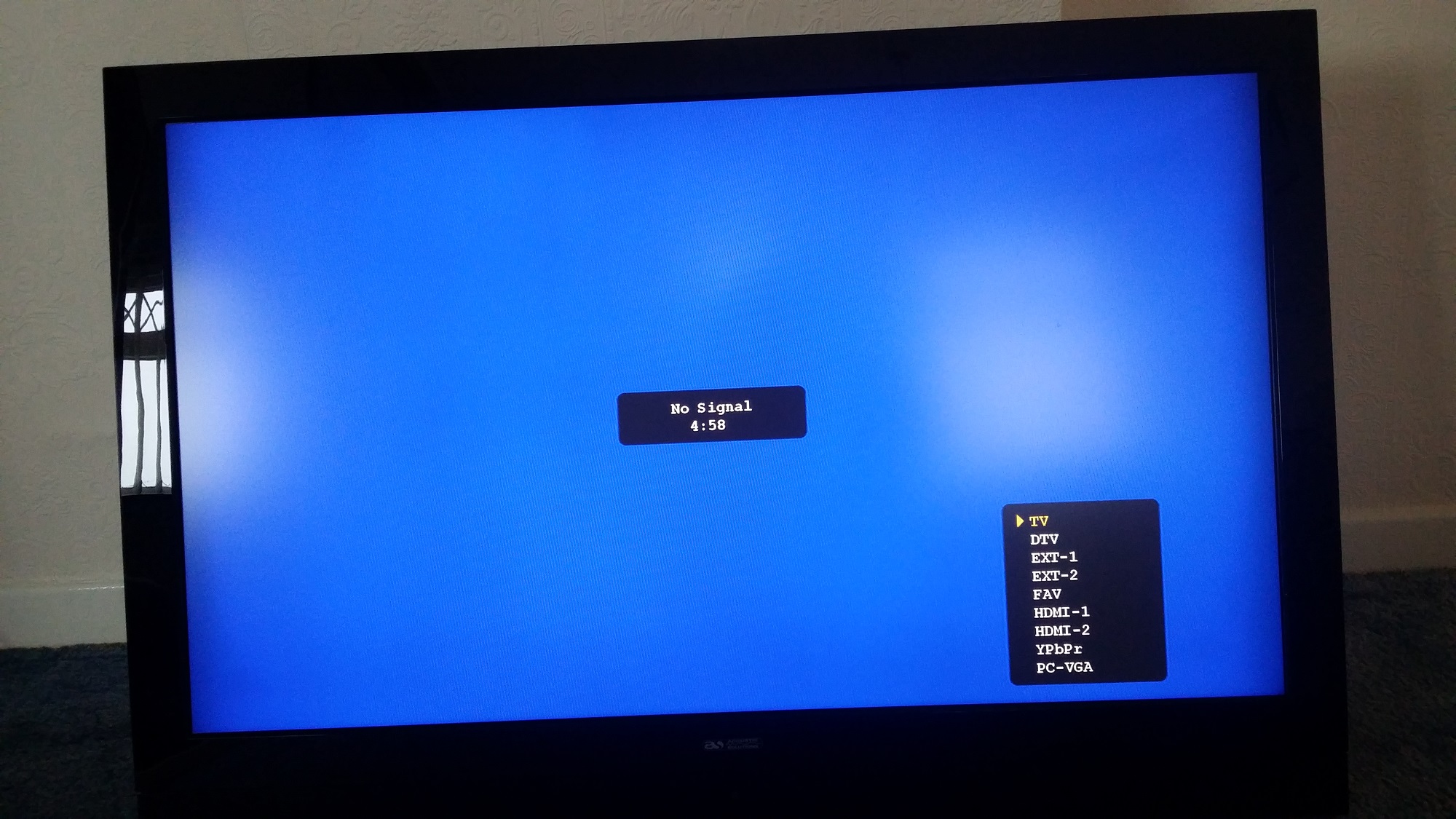

    Tv now comes on and stays on but no picture or sound. Does not recognise any inputs from HDMI, scart etc. Does show all inputs on screen to choose them.
    Tv has a blue screen, i can get into all menues.

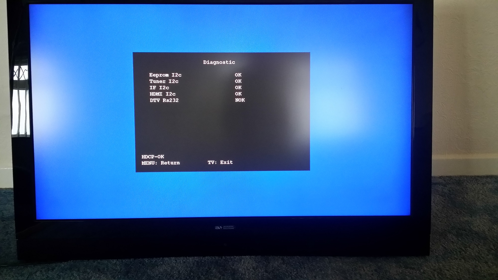

    On entering 4725 and engineers diagnostics everything is ok apart from last check which reads DTV NOK.
    My guess is a problem still with the psu voltages .
    I have watched many youtube videos and there is a very informative video of my exact tv with a link which lead me here. however here is my problem. I have downloaded many scematics for the voltages and there all different. so many Vestel boards.
    Could someone please give me the voltages for the pinouts and testing procedue on the 28 pins that go from psu to main board.I have read here that some have to be tested in standby and then tested again when tv switched on ?.I guess the pins from 2 to 28 are standby and pins 1 to 27 are the voltages to main board when tv is switched on ?.
    I used to tinker many years ago with broken apliances, Have capacitor tester, multi meter and soldering equipment.
    This is a last ditched effort to fix my tv.
    I just got it back from a Tv engineer free estimate , quoted £130 to fix Tv but wont inform me where the problem is. I can use the other board to test and switch out parts it need be if its psu problem.
    Christmas has left me skint, No Tv and i am climbing the walls now.
    I am willing to try and fix it following your guidance.
    TY for any help in Advance .. I read the rules and have attached pictures of the boards in the tv to help you out.

    I cant even understand anything you've said at all. So the Tv just doesn't show any sources ? But comes on to the blue no signal background ? Psu would be fine in that case. Maybe reinstall the Tv in the first time install menu on the Dtv. Also it always says dtvnok on Vestels and it says that on this as the tuner is built onto the Mb and not external. You have done a good job on the psu recap though. Mainboard will be faulty if anything. But you cant just swap them over on these sets as they are panel matched.

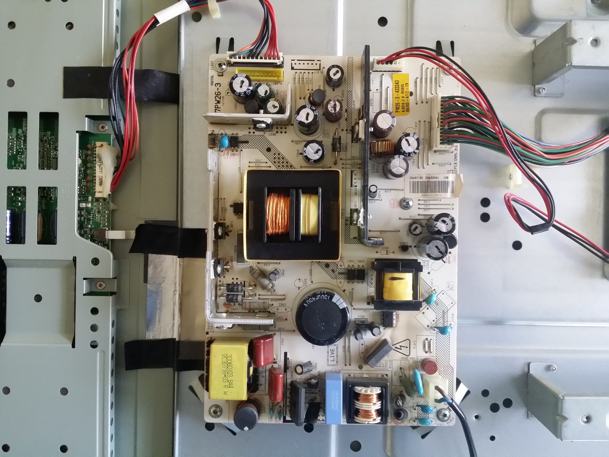

        If you check the voltages on PL816 to see if any are missing when the set is powered up with the blue screen would be a good start.

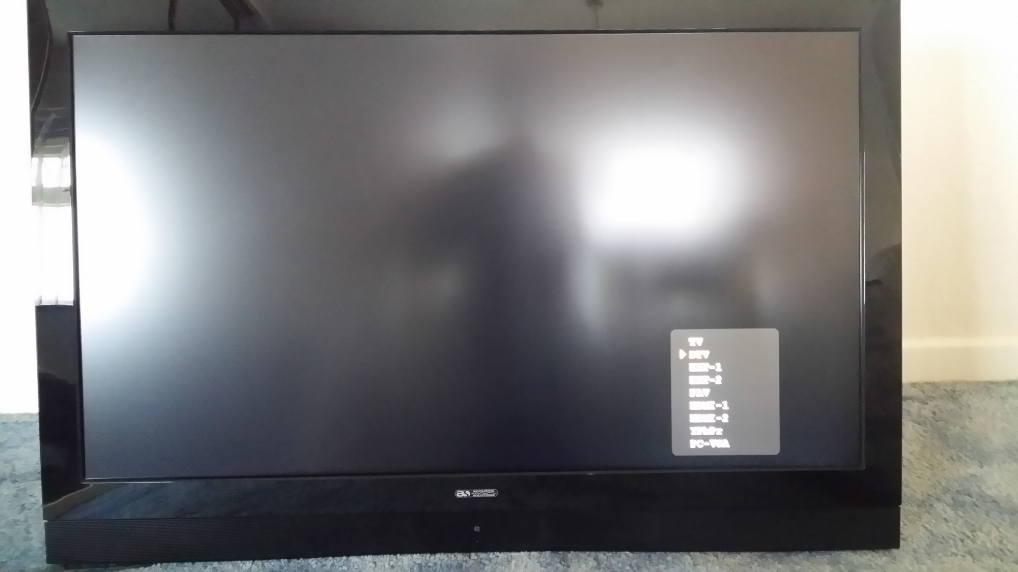

            The tv is turning on now via its remote. I push the source button on remote and can see all the inputs on screen to choose from, "see picture source". when i choose the source ,eg hdmi, scart etc it changes to it on screen but i still get a blue screen. It wont switch to my dvd player "scart" or HDMI ecostar set top box.

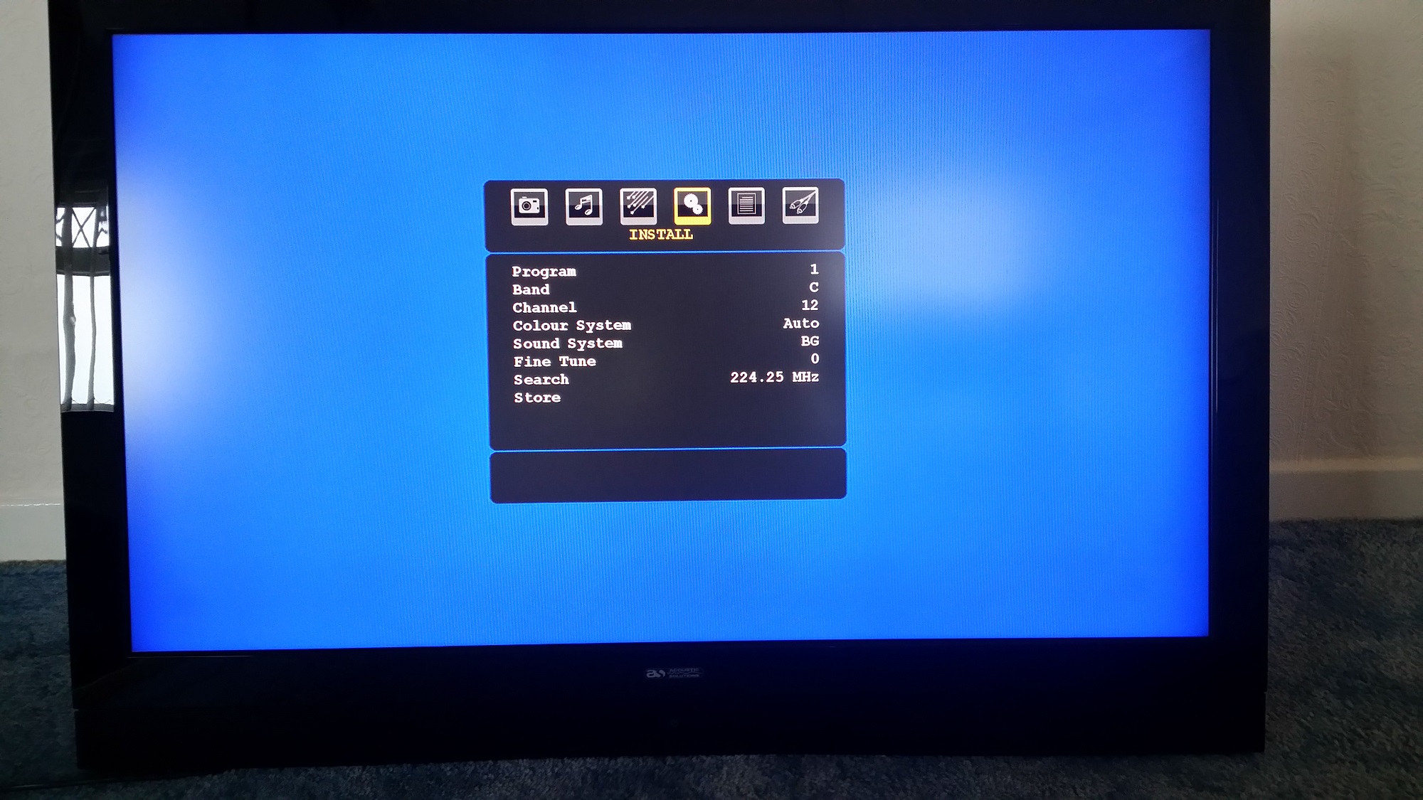

            When i select tv source "on remote" i get the no signal as its analogue . On pushing the menu button on remote it shows the tuning section to allow me to tune it.
            When i push the DTV source "via the remote" its just a black screen. The menu does not come up on the screen when i push the menu button on the remote. the screen stays black , see pic.
            The last picture is the diagnostics screen.
            I dont think the main board is getting the power it needs to power the DTV tuner ?.

            I found 2 blown 470uf 35v caps, replaced them with new ones and still had the same flashing blue light. the 2700uf 16v was reading low and i changed that section out and the tv now comes on. the 2 1000uf 35v were reading at 832 and 806 so changed them too.As per the video on youtube the person advised to change all out and i have.
            I have left the tv running for an hour on DTV "black screen" no menu options show when i push the menu button on remote.
            I have taken the voltage readings "TV switched on and tv in DTV selection" Blue screen.

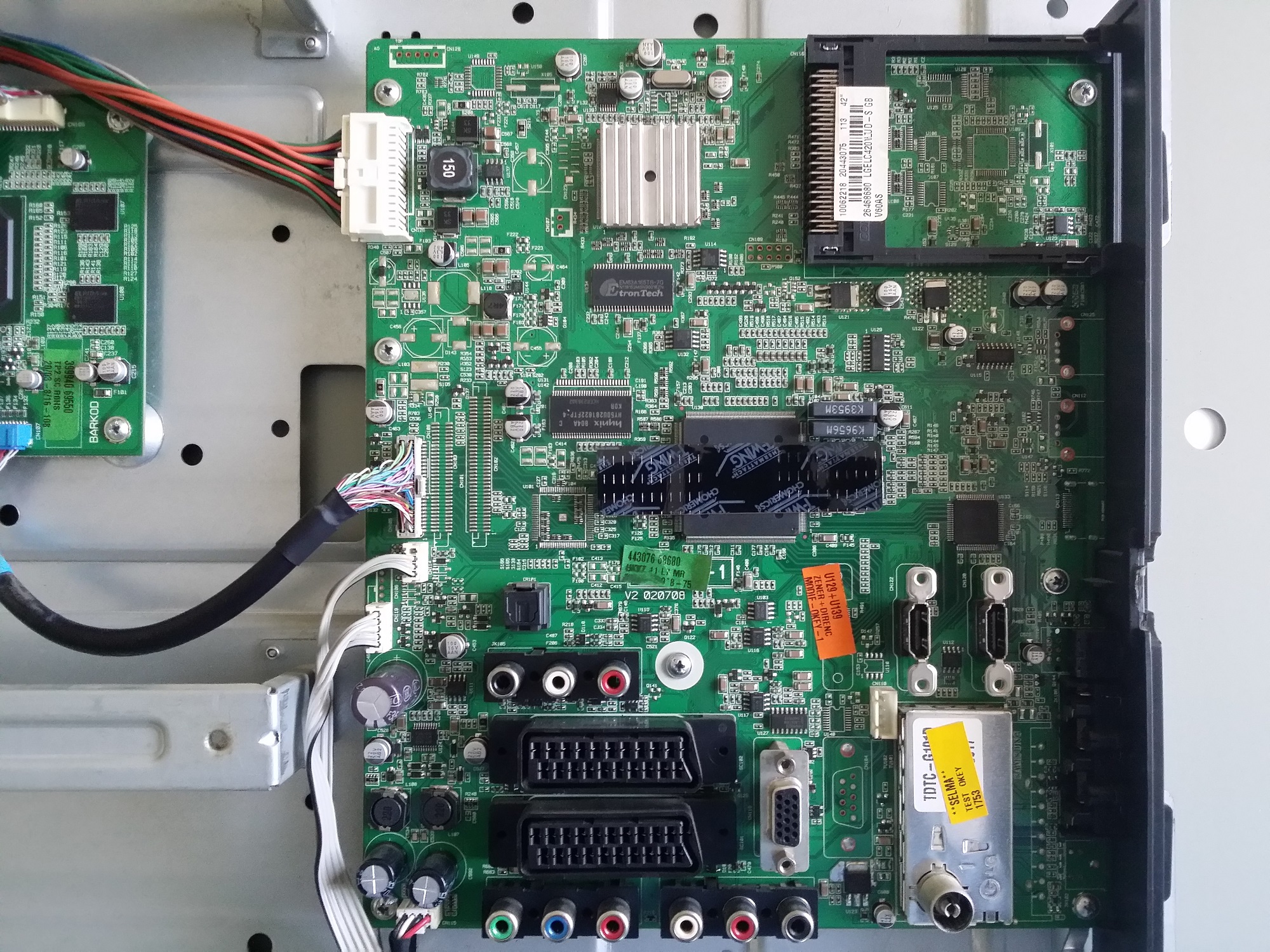

              maybe a firmware issue with the mainboard what is the number from the mainbaord also any numbers from stickers etc also on the back of the lcd panel is there a white sticker that says what lcd panel is used in the set

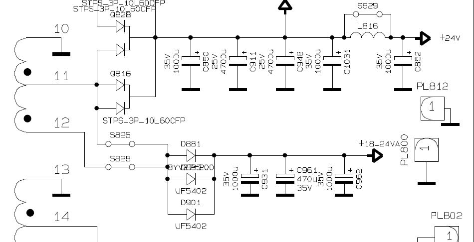

                Does Pin 13 of PL816 have an 18V supply? Can you check D881, D901

                  Main board
                  Green sticker 443076 68680
                  Under green sticker 17mb35-1
                  White sticker
                  10062218 20443075 113 42"
                  26468680 LGELC420VJUD-S GB
                  V60AS
                  Sticker on back of lcd panel
                  LC420WUD
                  (SA)(C1)
                  BAR CODE
                  42089P1752638 731C
                  LG DISPLAY

                    Pin 13 has no voltage at all
                    "Can you check D881, D901"
                    I have found D881, it has D893 printed under it on board. Is this the same diode ? or am i looking for seperate D901 ?.

                        what type of caps did you fit?

                          I don't know how closely your power supply matches the schematic but I attached a section of interest. Is there a voltage at +18_24VA
                            Re: Acoustics Solutions Lcd42761f1080p
                            D881 taken off the board
                            Reading 1. one way and .445 the other.

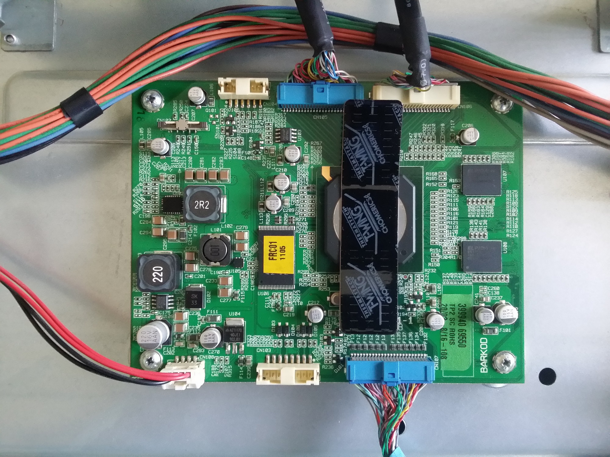

                              what is board in picture 3?

                                  it is a 17PW826-3 in picture 2? unless been changed.
                                    Just checked it again and in post #1, pic 2 it's 17PW26-3 ????
                                    Spares2Repair show the power supply as being 17PW82-3 for the Acoustic LCD42761F1080P!!!

                                    Was the original power supply board a 17pw26-3

                                        The power supply is a 17PW26-3
                                        I went to that site too Dick and it confused me.
                                        Spares2Repair show the power supply as being 17PW82-3 for the Acoustic LCD42761F1080P!!! Yes exactly right .
                                        Thats why i asked originally for the true voltages on this tv model and psu because everyone ive searched for and downloaded are all different on the voltages.
