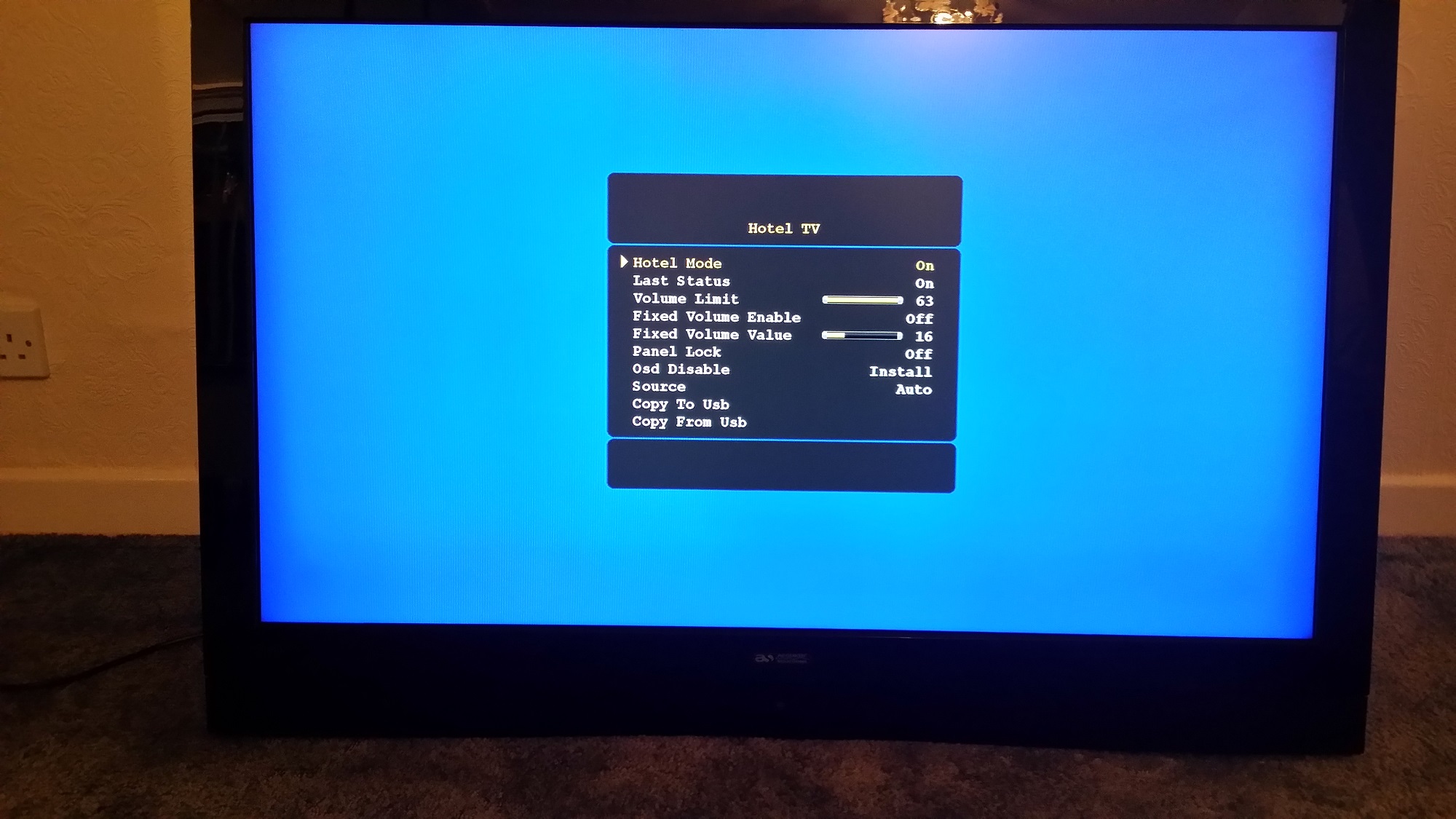

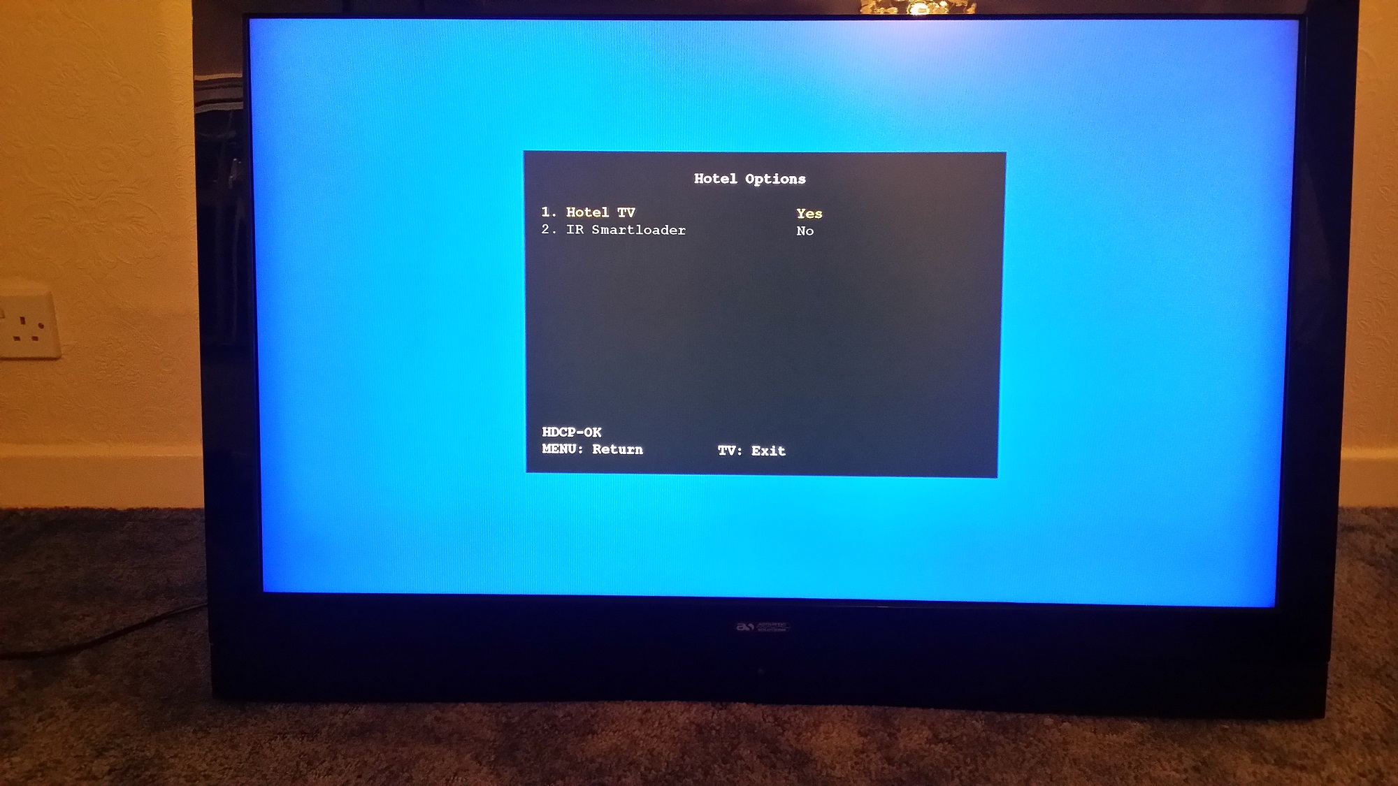

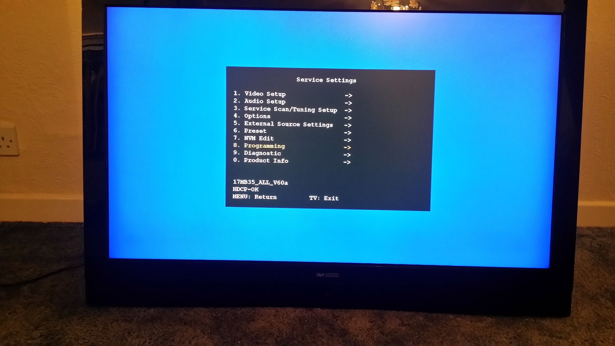

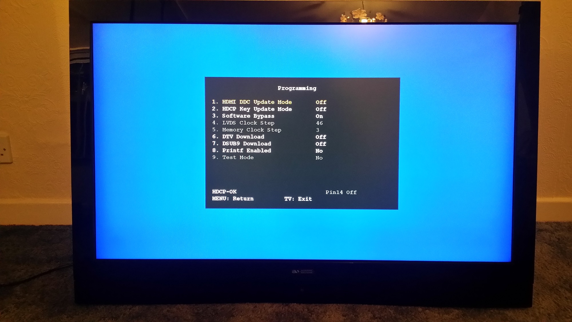

      Re: Acoustics Solutions Lcd42761f1080p
      Diah , Ty for your time.
      1st picture = Hotel tv now in 7935 menu
      2nd picture = Hotel now in 4725 menu Ir smartloader still grayed out
      3rd picture = Programming in 4725 menu
      4th picture = contents inside Programming

        okay, first programming are correct
        second when you turn on hotel with 7935 pic1 did you tried with pic2 use 4725 to switch hotl to NO , or its grayed too ?
        back to pic1 when you use 7935 after change hotel to ON, tr change the source from auto to other source you used to use the TV. HDMI or other source, it should work too.
        also after you change as pic1 if you used to put signal via scart to the tv as DTV the menu will displayed to you so you can go with to switch hotel from yes to no
