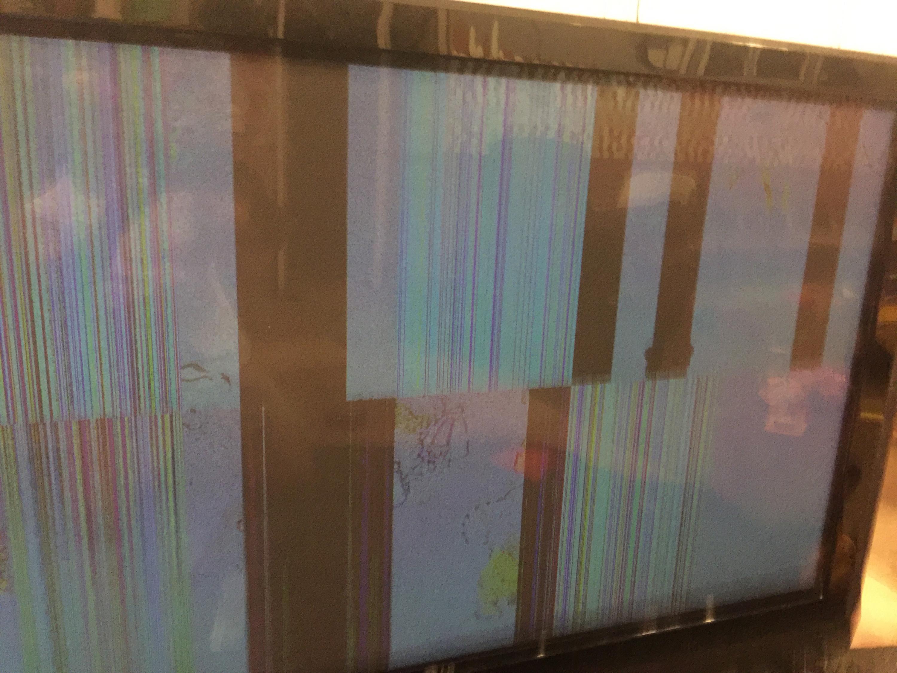

          I am unsure how to check those but will have to get my dad to do it. So I'll figure that out and then get him on the phone. In the meantime though, here's a photo of what the screen is looking like. We also found out one of the connectors on the "new" Y-SUS board was partially broken off. I'm not sure what the wires connected there are for, it is a small 4 wire connector and the wires head off underneath a small cpu style fan towards the bottom of the display.

            He shouldn't of paid that shop a penny, looks like they could have bodged it on purpose. Also thats quite bad Ive not seen anything like that before on a Plasma. I would be pushing for a control board fault but looks like the panel might have been sabotaged by the shop, the connectors at the top and bottom of the panel are they seated properly ? Also its very dim looks like Ysus could be faulty or Zsus. Could also be a buffer fwult, but I need a voltage list please.
