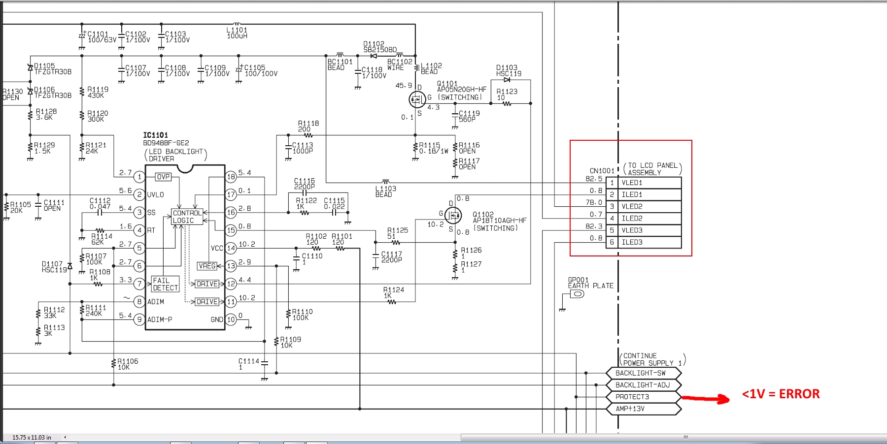

              If you look at the schematic, the 47VDC reading with all the board connected is correct, that is feeding Voltage to LED Boost Converter circuit.
              when you force on the PS-ON and BL-ON then the boost converter circuit will and give you that 78~82VDC out put. Right now the boost converter for LED1 is not working, per diagram it should be around 82V.
              So it can be that too much load is being seen due to shorted out LED, or LED has open circuit so the Voltage shot up to higher than 82V so it shutdown the boost converter.
              You need to leave the probe on VLED1 and then force on the board to see how high the VLED goes up to.
              "PROTECT 3=.075 Still" that is because there is problem so the line is held LOW.

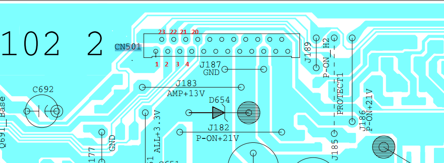

                          OKay so I followed flow chart no.3 of no picture and tested CN501 Pin 20-23 IF i labled correclty? could not find any mark besides pin one on CN501
                          (Should read 21v for Pin 20-23
                          Pin 23,22 read 21volt
                          Pin 20,21 read 11.8v
                          Pin 8 was checked just to be sure 3volt as it should
                          cathode of D650 read 21volt as it should
                          • jayjoesph
                            • Mar 2017
                            • 56
                            #53
                            Re: Funai (Emerson) LF501EM4F not turning on
                            not sure if i guessed the pinout correctly. I searched all over for some sort of key in the schematic. the last 4 do read 21v if it was counting up and down rather then straight across. still out light from led 1 just low voltage at what ever strip its hooked to . no wire fault
                            • jayjoesph
                              • Mar 2017
                              • 56
                              #54

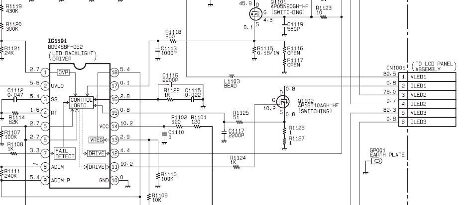

                              ALright i did some poking around before I put it to the side for a bit. Q1102 may be toast? It does not test the same as Q1202,Q1302(tested exact same) shouldn't they read the same on tester or volt meter being the 3 circuits are identical test were done off
                              voltage at source pins of those 3. Q1202+Q1302 start at about 10.5 drop to 9.5 quickly.. Gate Q1102 Starts 11.5 then drops to .006 after a few moments
                              what is acceptable replacement few part board still to look at but i have a few no match yet ?

                                    If I were you I would remove R1108 (1K) connected to pin 7 (ERROR) OF of IC1101 which is the LED driver for the VLED1, this will stop the VLED1 circuit from pulling PROTECT3 low. You will now have only two sets of LEDS working and the TV should function unless it has more than one problem.
                                    • jayjoesph
                                      • Mar 2017
                                      • 56
                                      #58
                                      worth a shot.. removed it plugged in main board and full power at rails did not push power no black lights so jumped all besides ps-on protect 3 =.5v

                                          One of the three IC is pulling down that PROTECT3, the output n pin 7 is Open Drain output so all three error lines are connected as an OR set up, there is resistor at pin 7 of each IC, you might as well remove them all to see if PROTECT 3 will go HIGH.
