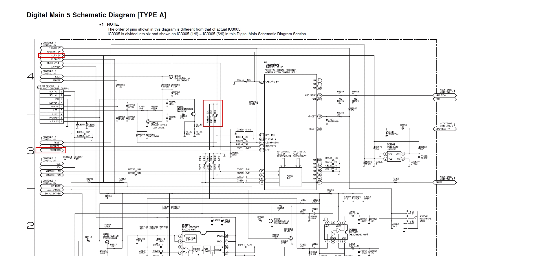

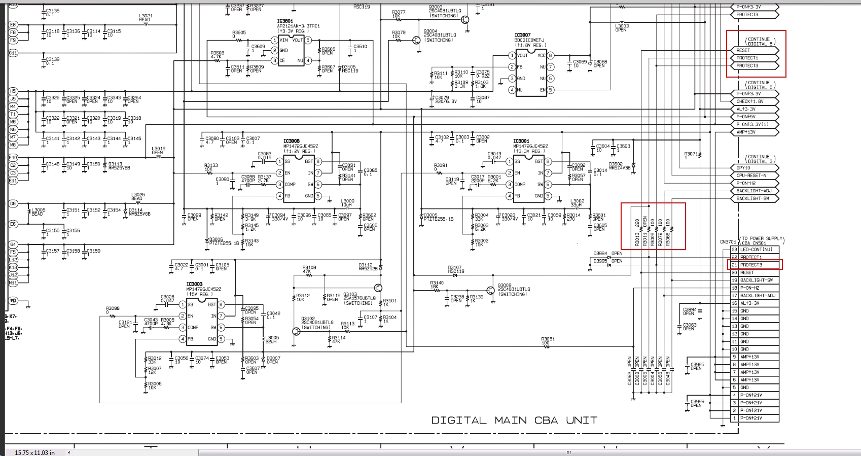

Protect3 signal route. As you can see, there is pull-up resistor for that PROTECT3 line.Attached Filesif you find these attachements useful please consider making a small donation to the site
http://www.badcaps.net/forum/showthread.php?t=24809Comment
Re: Funai (Emerson) LF501EM4F not turning on
OK, it is VERY IMPORTANT to give FULL and ACCURATE description of DATA.
If your DATA is correct, then I cannot see why you have such low DCV reading on PROTECT3 line since it has 10K pull-up resistor, something is not right, see POST 71.Never stop learning

As you can see the diagram DIGITAL MAIN 5 in post 71, you see the pull-up resistor for the PROTECT3, see what you have both ends of the resistor.Never stop learning

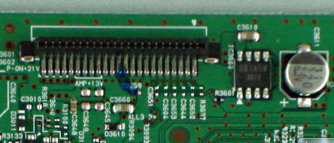

Yes i have 21vdc 13vcd and 3.3vdc at connection on main board side. I do have the flashing red led ever 10 seconds(steady lite with 1 blink every 10sec) as stated from the startComment
c3660 reads 3.25vc P-ON+21v reads 21vdc and AMP+13v reads 13vdc
http://www.tvparts.ca/images/product...2876462323.jpgAttached Filesif you find these attachements useful please consider making a small donation to the site
