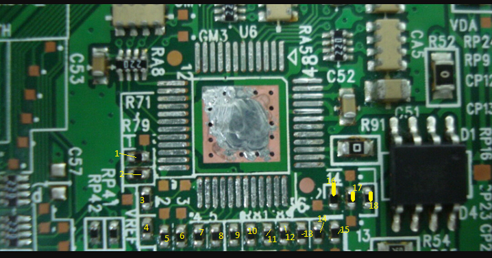

    Hi All,
    I was just in the process of replacing the usual failed AS15F Gamma IC but inadvertently removed 8 of the SMD resistors that connect to the IC!
    The values of each resistor I have are:-
    6K
    1.3k
    752r
    752r
    430r
    388r
    160r
    140r
    Would someone be so helpful as to identify which resistor goes into which position on the attached photo marked 1-8 (If only I had a spare board to compare :-)
    Cheers,
    Matt

      Thanks Dick. I've already looked at all possible datasheets/diagrams but unable to find the same values located on any of them.
      Still hoping someone may have the same board to do a quick meter reading of their resistors.

                Re: V315B1-C01 TCON - AS15F Swap out - resistor values
                Does any one have standby V315B01-C08 T-Con board . I need resistor values for 1-18 as in Picture. Some resistor are swiped by heatgun bi mistaken. IC chip is As15-HG NOT AS15- F. I have datasheet for AS15-HG but is it worth. Not clear from application data. Any on could help me please

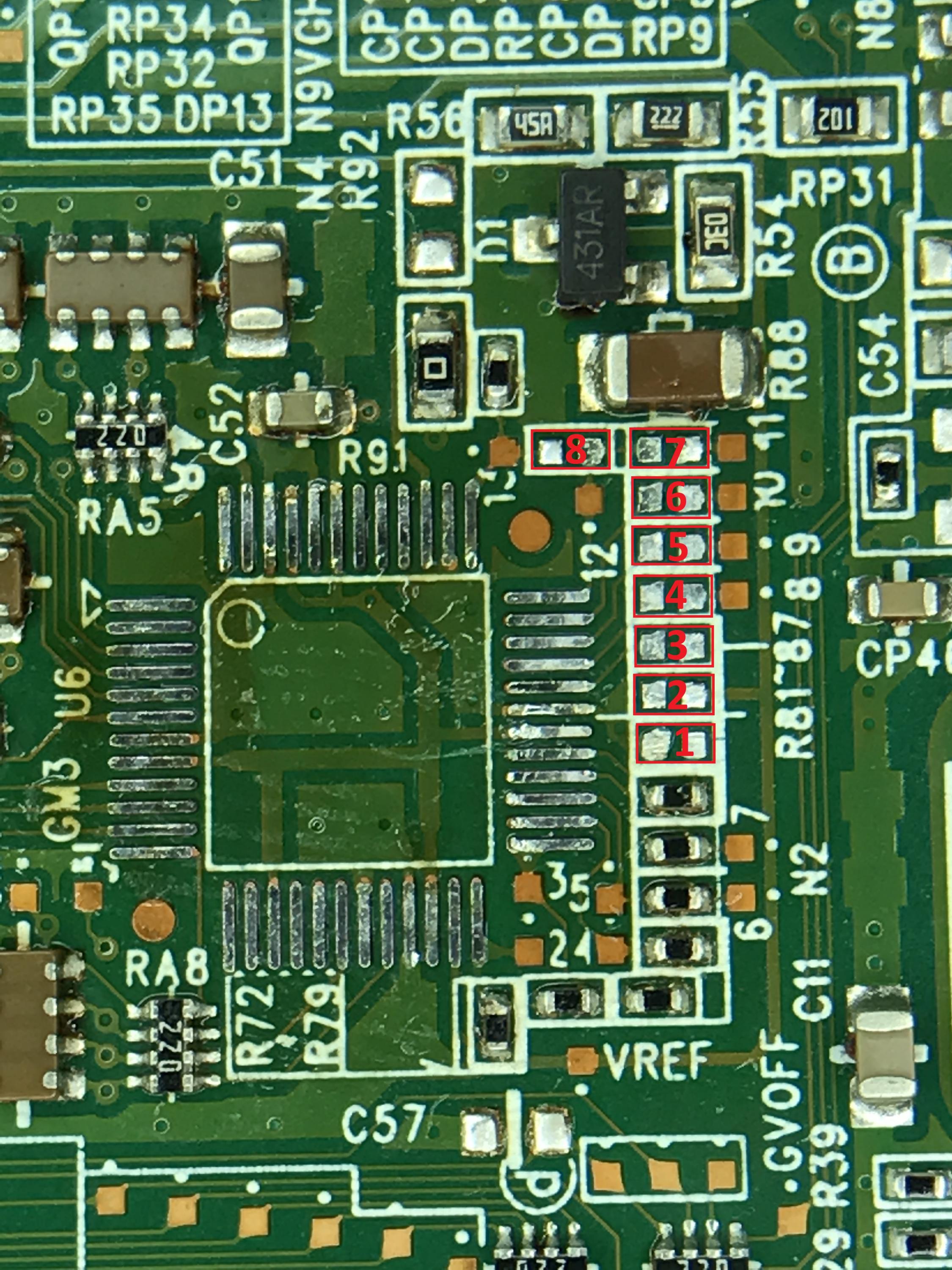

                  I realize this is older post but may help someone with the V315B1-C01 per post 1
                  1=160r
                  2=6k
                  3=140r
                  4=388r
                  5=1.3k
                  6=430r
                  7=752r
                  8=752r
