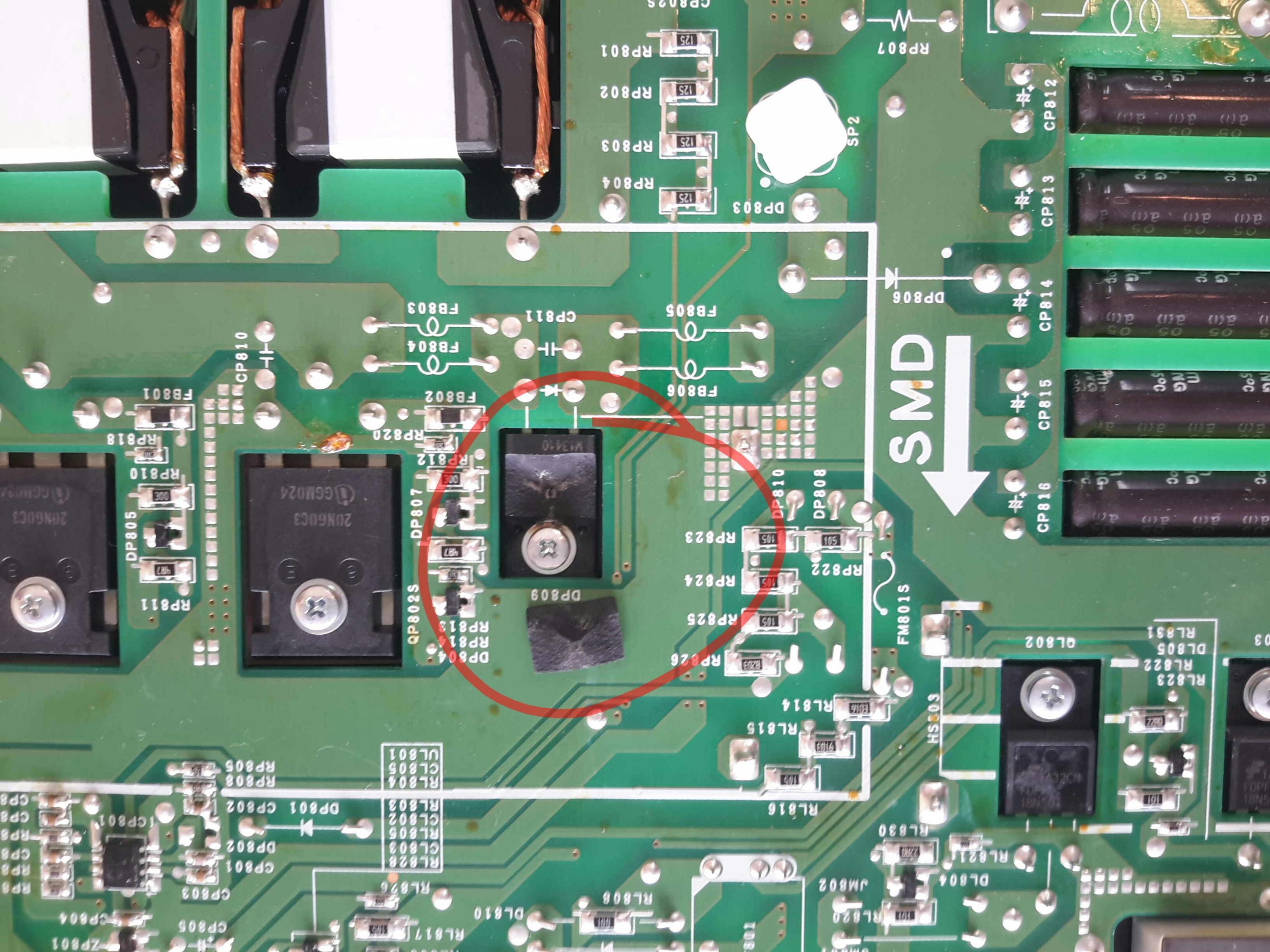

    Samsung UN65C800XF No Power

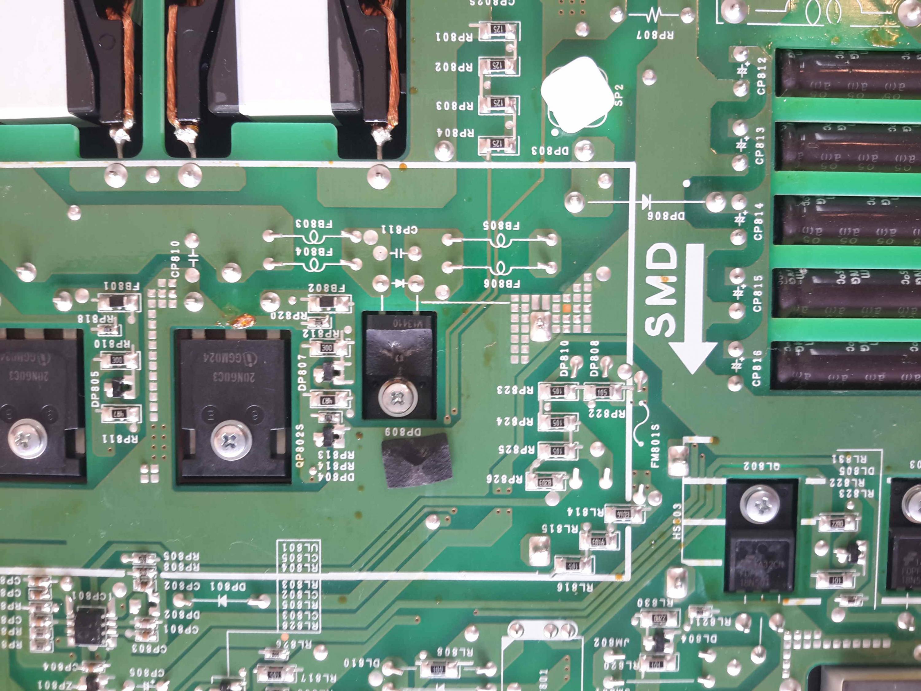

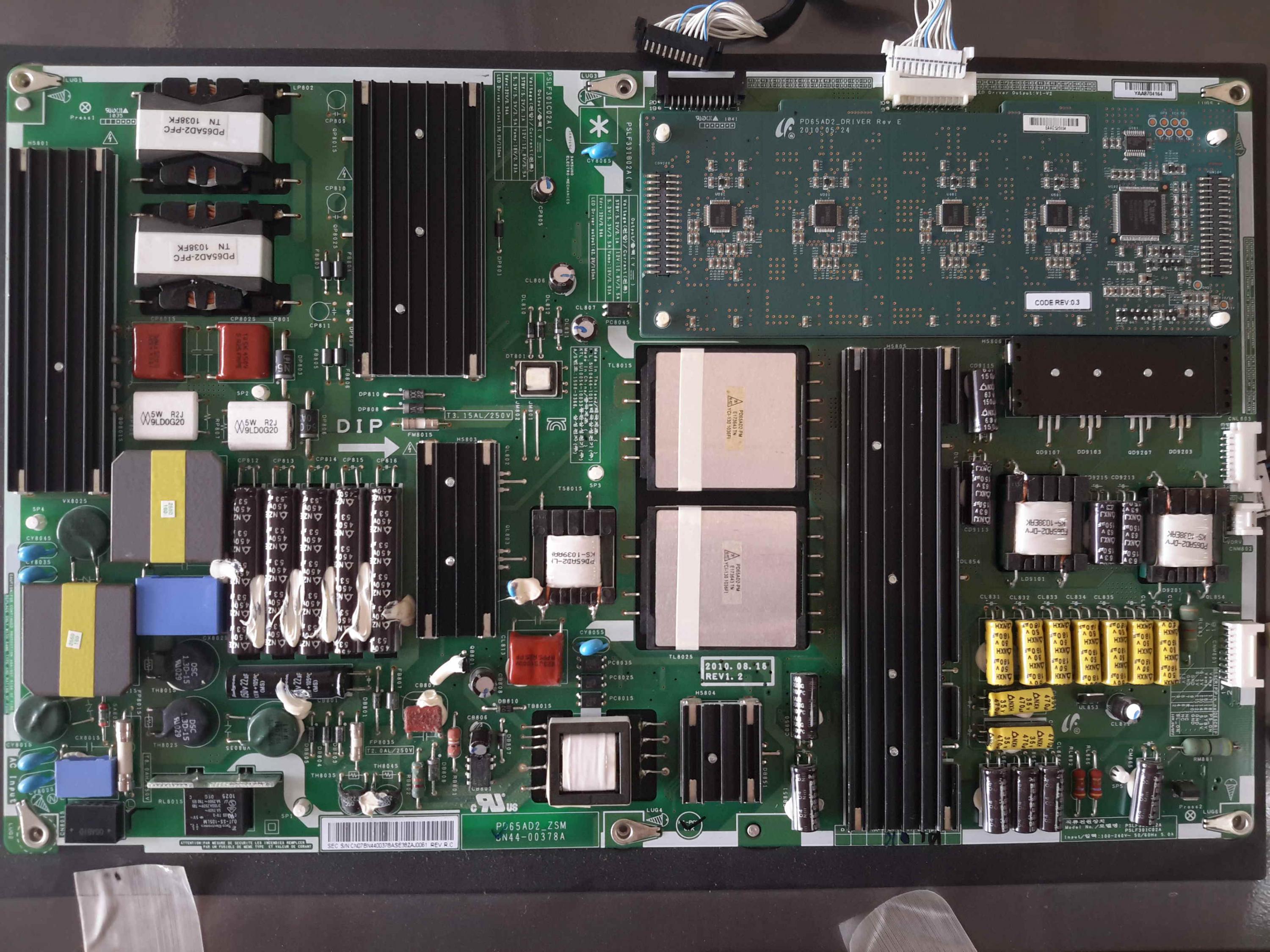

    So I opened up this TV and pulled the powerboard to find this....Check photos would this cause no lights or power..

    Re: Samsung UN65C800XF No Power

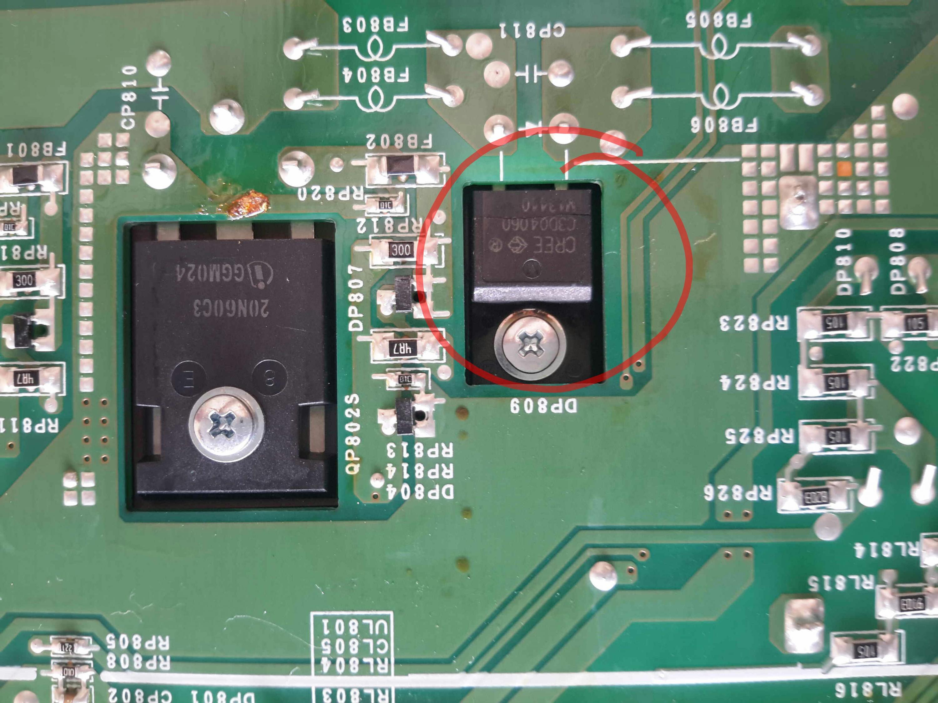

    Yes, the circled device (diode) is well and truly blown and needs to be replaced.
    The question now is why did it blow?
    I would also check out the two 20N60C3 mosfets which are along side for short circuits.
        The cracked diode is a Schottky diode, 600V and 6A. Look at Mouser, Digikey, Allied, Ali, etc.

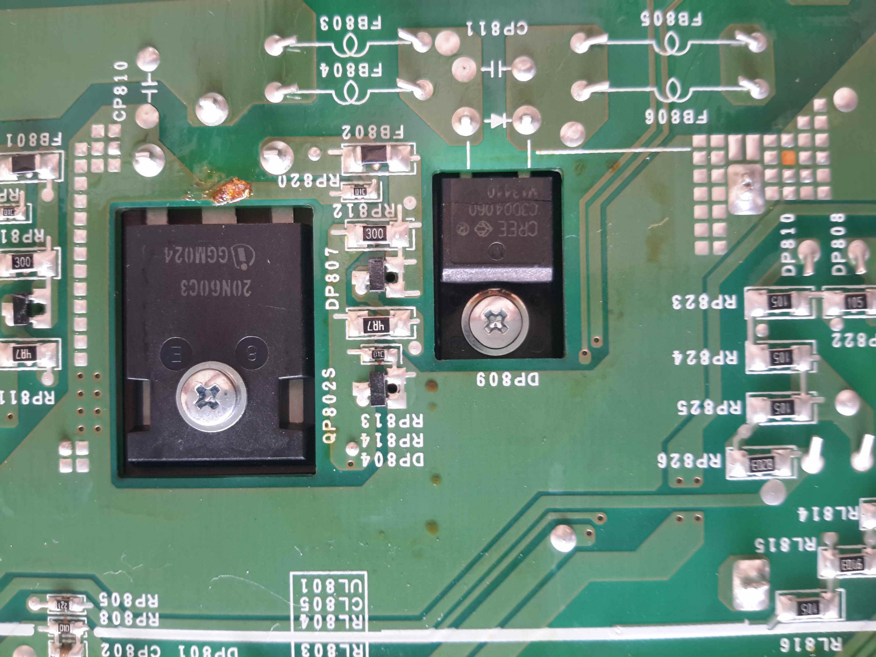

            So the part is replaced. Still nothing I would replace the board but I'm having a lot of problems finding it.
              That is the PFC Booster diode, so do you have 160VDC between the two legs of the main filter cap?
              Do you have standby Voltage?
