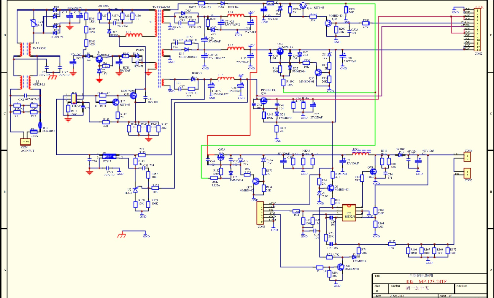

    Does anyone have the schematic for the megmeet psu board fitted in this set part number mp123-24tf.
    Thanking you in advance
    Regards Mark

    It's not ideal, but you can zoom in well enough via this site.
    https://www.scribd.com/doc/309641256...de-Alimentacao
    Attached is a single image, if it helps.

      Many thanks

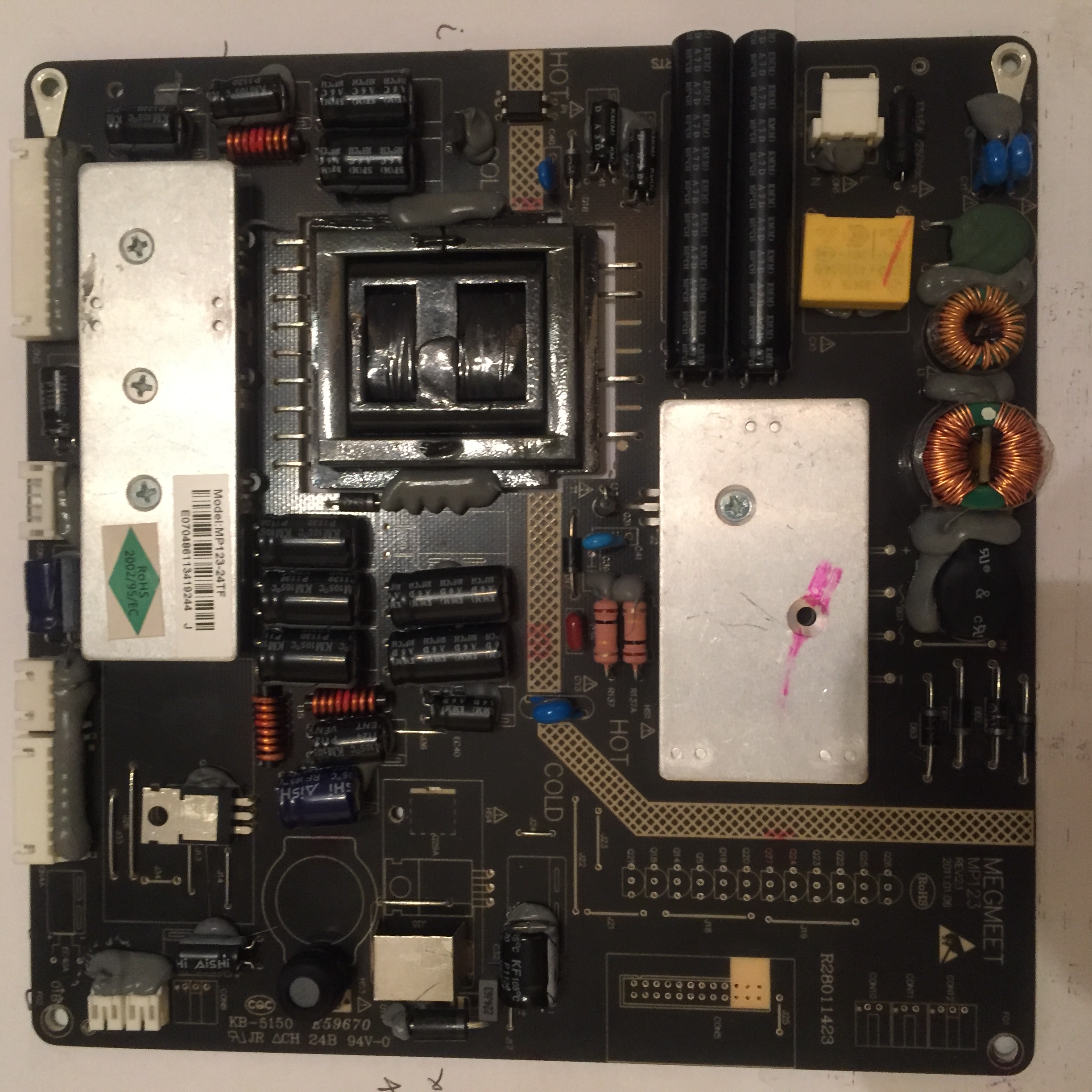

        So I might need some input on this one, I was simply going to replace the board as I have already spent more time than I would otherwise allocate however availability for this board seems to be a problem in the UK at least.
        The set itself has no standby illumination
        Visual inspection of the board has not shown up any obviously defective joints
        No obvious failed components
        Semi conductors tested no apparent shorted devices (5 volts applied diode test, fluke 77)
        No obvious esr problems (ooc tested with scope and function generator)
        On power test shows the following
        hot side
        C11 C12 filter caps 320 volts
        cold side
        vsb - 5 volts
        5 volt - missing
        12 volt - missing
        24 volt - missing
        with main signal av board connected I get a tick from the T1

            It's Christmas holidays so probably not many people on the Forum
            Check the DC voltage at L14, L15 & L16 and post them.

                if you us a 1k resistor between vsb 5v and ps.on pin do all the other voltages now test ok?
