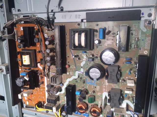

Toshiba regza 52" sound no picture
  • Dan Surra
    • Dec 2016
    • 36
    Re: Toshiba regza 52" sound no picture
    It clicks when you turn it on and off. Yellow light flashes during initial power up and then a steady green light is on at base of TV. That is basically the same as it was when it was working, Packard
        Ok, I did the diagnostic work recommended. All 5 Inverter supply pins read a healthy 24.3 volts. These would be at P861 and P860. The next step in the flow chart is pins 1 and 2 @ P810A. They read the recommended 12 volts (12.3 actual). Flow chart says if this is the case to try one or both of the CCF inverters. If that does not help replace the LCD display.
        I don't even know what or where the inverters are. Any suggestions as to how to proceed? Will post close up pics of boards in next post. Thanks in advance. Dan
            in post 12 on the left and right hand of the tv you can see the invertor transformers (6 on each side) on pcbs is there a number printed on them? these boards also sometimes have fuses on them so worth checking there ok.

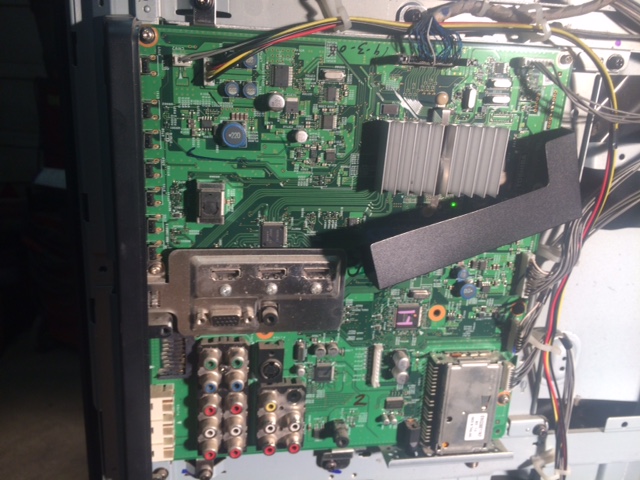

                  So you have 24V supply for the inverter board, but do you have BL-ON to turn on the inverter board.
                  See page 3 of the PDF, look at CN61 pin 1 for the BL-ON signal ,and other Voltages as well on that connector.
                    transformer #'s are 0095AD U00815 CY on left side looking from rear and 0095AD U00818 CY on right.
                    if fuses are labeled F400 and F401 on board, they are good.
                          OK, was able to get some readings on the BL-ON CN61 connector today. They are as follows, pin 1 BL ON actual 3.26v (listed to be 5v), pin 2 empty, pin 3 empty, pin 4 VBR actual 3.28v (0-3.3v listed), pin 5 BL Det actual 3.25 (none listed), pin 6 continuity to ground, pin 7 empty. These were taken with the unit turned on.
                          Thanks in advance.
                            #33
                            BL-ON of 3.26VDC is fine I would think anything over 2.5Vdc will be = ON.
                            VBR (DIM) is also fine.
                            BTW, do you see any blinking LED ERROR codes? Look at the PDF for error codes listing.
                              It blinks three times, twice (yellow) when first powering up and then goes to a solid green. I believe it always did this when turning the set on. Hope this helps, Bud. You've been a great help Bud. Any suggestions as to what else I can check?
                                Ok, I have 24v at all inverter board terminals and 3.26v at BL-ON terminal. Where do I go from here? From standpoint of a novice, I have received some great advice on here. Hope we can figure out what is causing sound and no pic issue. I hate to trash the unit.
                                          Since you do have all the required Voltages and the command signal (it is still questionas to if the BL-ON should really be truly 5VDC or not), and Vince suggested, I would look at the TV in really dark room to see if the backlights even flash on for second or not.
                                          Bad lamp/lamps/transformer will not stop the inverter circuit to fire up the lamps to start first, if it detects the problem int he first 3 seconds then the circuit will go into protection shutdown.
