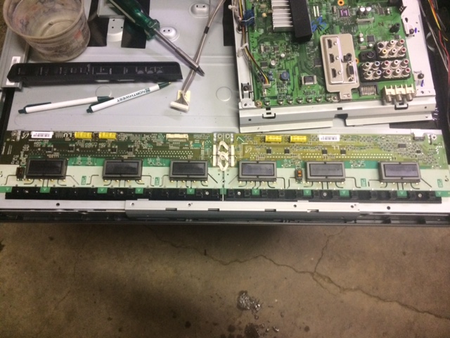

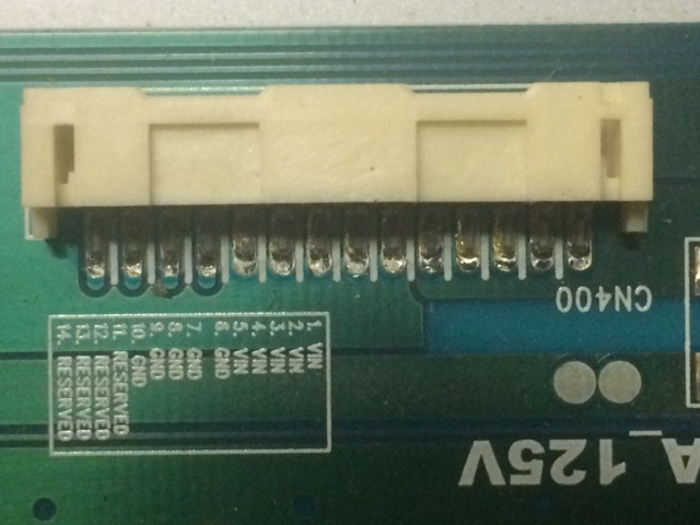

    BTW, I need good close up pictures (shields removed) of those two inverter boards, and closed up pictures around the connectors of those inverter boards.
    • Dan Surra
      • Dec 2016
      • 36
      #42

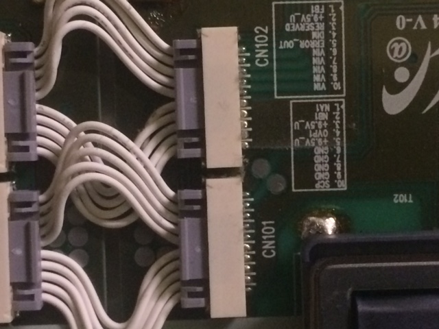

      Re: Toshiba regza 52" sound no picture
      Ok, I removed the inverter board shields and took pics of connectors. There will be pics of the main connector and then one that is in the middle of the board. I will post them first from right side (from rear of tv) and then from left. I also found something interesting that may indicate a problem. I will post those pics after the connectors. these pic are of the whole board and then the connectors rt from rear

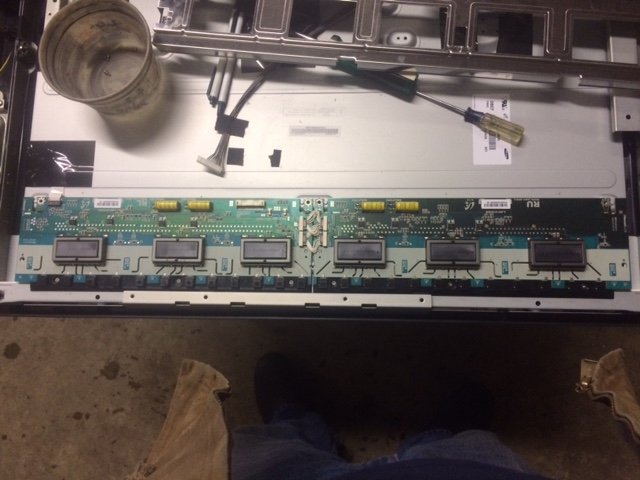

        these are same views of left (from rear) inverter board

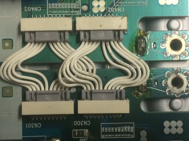

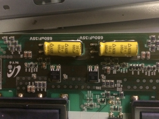

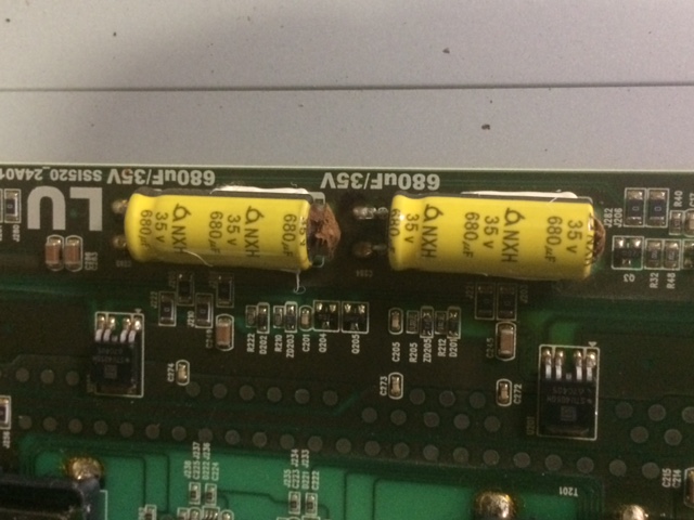

          OK, when I removed the shields from the left (from rear) inverter board I noticed some imperfections on two yellow cylindrical parts. They could be condensors, I don't know. Each board has 4 of them. Two at top and two at bottom of the board. The top two on left side have a brown substance that has oozed out of the back side. Also, the soldered area on the board itself looks like it may have gotten hot. I have also attached a picture of a set that looks like all the others. Could these two pieces have blown out?
          • Dan Surra
            • Dec 2016
            • 36
              Bad caps!. When those caps are bad, you need to check all the fuses on the inverter board too at this point.

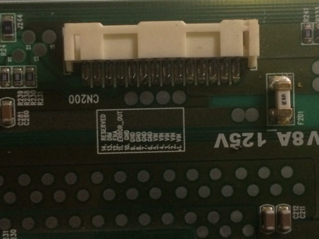

                OK, I am not sure which pieces are the fuses as I do not have diagrams for the inverter boards. However, after looking at them, I checked piece F201, F200, F400, and f401 as they look as if they could be some type of fuseable link. F200,400, and 401 have continuity. F201 is open and I would assume a blown fuse. Also, the yellow parts (capacitors??) with the brown stuff oozing out of them are shorted when I check with an ohm meter. The other 6 yellow pieces are not shorted as I get some kind of reading on ohms setting although I have no clue what I am doing there, sorry. Does this help?

                  #48
                  depending if you want to replace the board or repair it ? yes they are capacitors so they will need changing and i would replace all of them on both boards as two have failed already the rest wont be far away from failing either i guess also you will need to replace that blown fuse im not sure if any other parts maybe damaged as the fuse has blown maybe budm has some more tests you can do? so it all depends on if you can remove and replace the parts yourself.

                      #50
                      hopefully its just the capacitors that have blown the fuse if so it should be a easy fix are they all 680uf 35 volts? also if you need help with finding the correct fuse replacement upload a picture of the blown one and we will see if we can help you locate the correct one with the capacitors im not sure if you can use panasonic low esr ones in that position on the board budm etc will advise shortly no doubt.

                                #55
                                post 44 top picture under the capacitors theres some mosfets (5pins centre leg cut off) whats the part number on them then we can find a data sheet and check the source and drain pins for short circuit faults
                                  Ok, the 5 pin mosfets (little black square things) with 5 tabs and center one cut #s are (as best I can read them with these old eyes) STU405DH and under that is a small triangle with 7C405. The bottom of the board under these is discolored and brownish. It looks as if I can buy this board relatively cheap. Do you think it is worth a shot or is there a high probability of other issues?
                                    what sort of price is a replacement board?
                                    STU405DH
                                    Dual E nhancement Mode Field E ffect Transistor ( N and P Channel)
