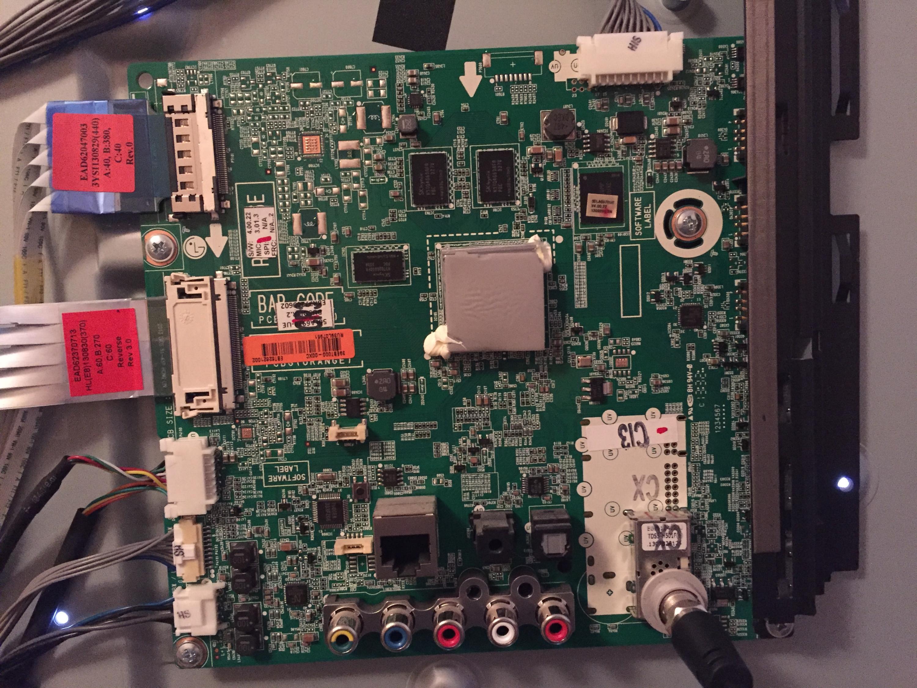

      Thank you for quick reply. I'm sorry for my post. Model no is 50LA6970.
      Voltages from PSU to mainboard are good. No badcaps as far as I observed. It turned out that flickering screen occurs only when TV is on TV mode. When it's on wifi, it's fine even TV cable plugged in.
      So I guess something is wrong with antena/cable input on motherboard or loosing cable associated with TV mode. I will open it soon and inspect them.
      Any other comments would be highly appreciated.

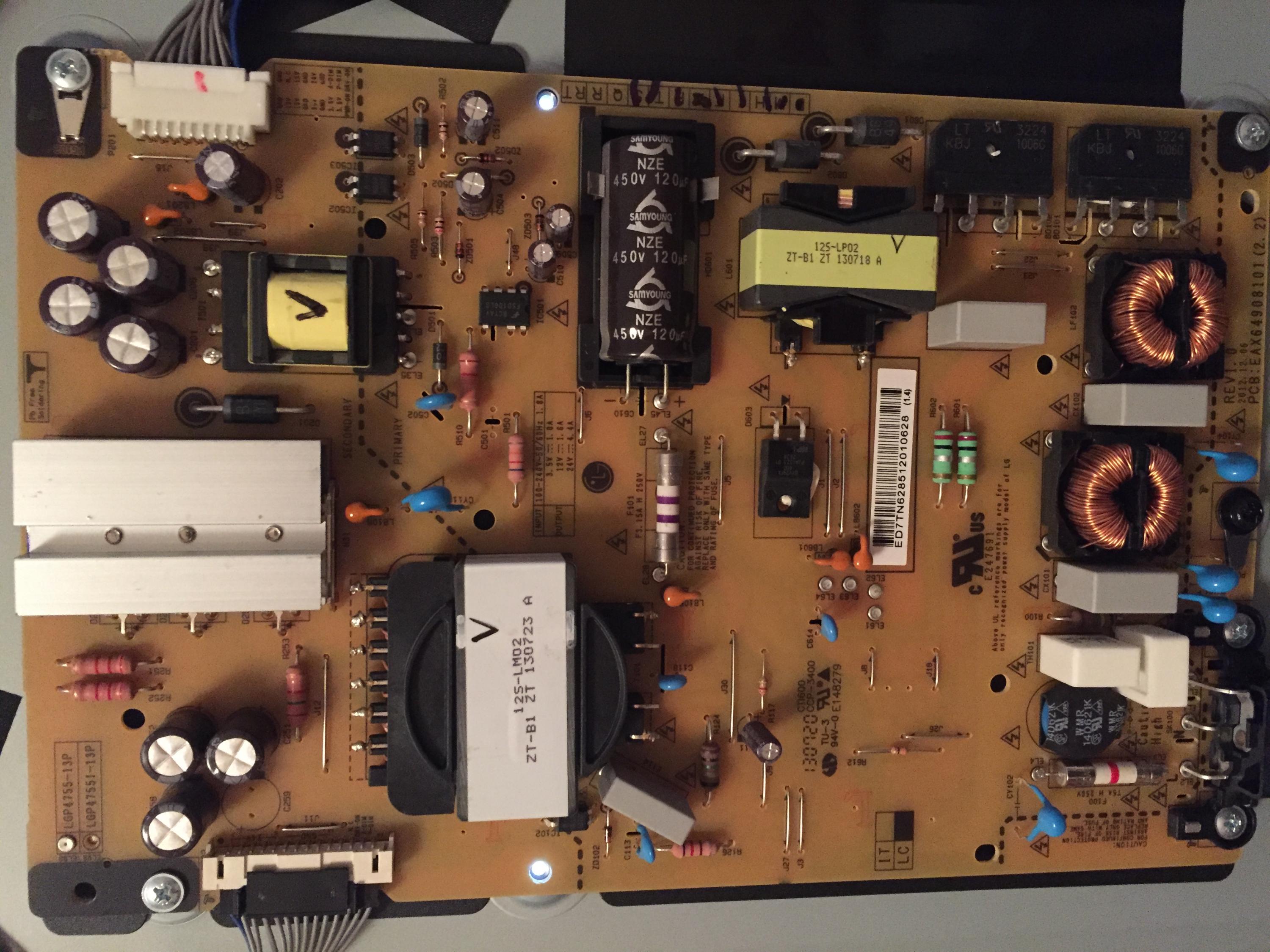

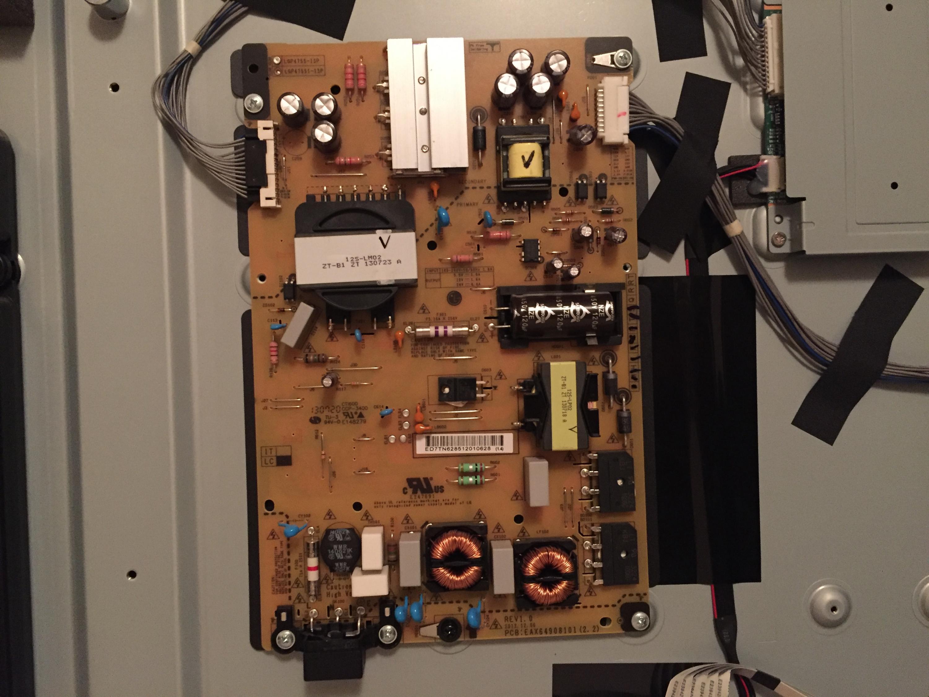

                    I recent went through this thread. https://www.badcaps.net/forum/showth...ght=flickering
                    He has a similar issue of flickering. DB also suggested the issue with grounding. So I want to try to ground motherboard and power supply to the chasis.
                    Can anyone point out where to ground motherboard and power supply to the chasis?

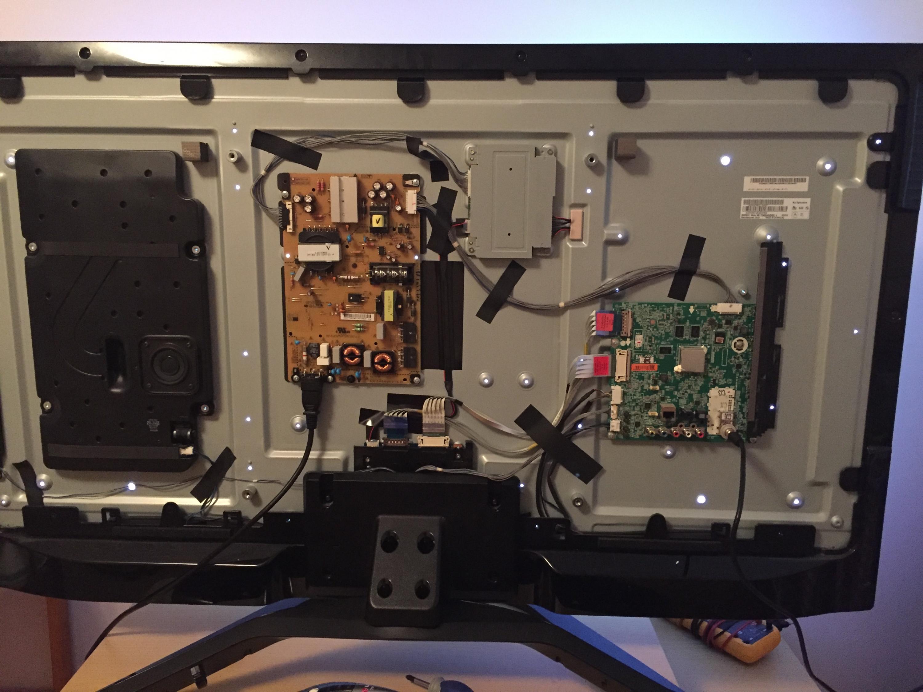

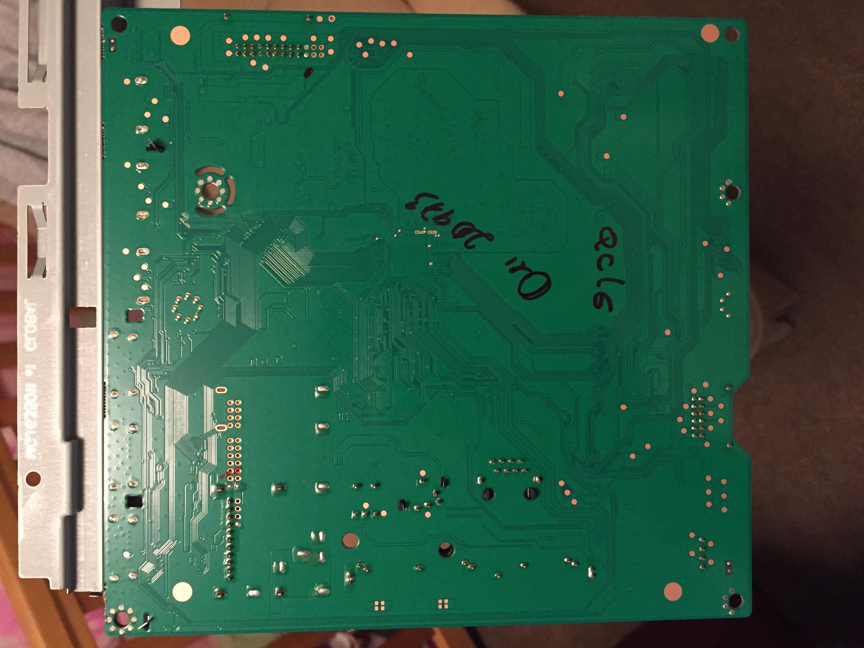

                    Pictures are of the back of the TV, mainboard, power supply and an unknown board that go to LED strips.

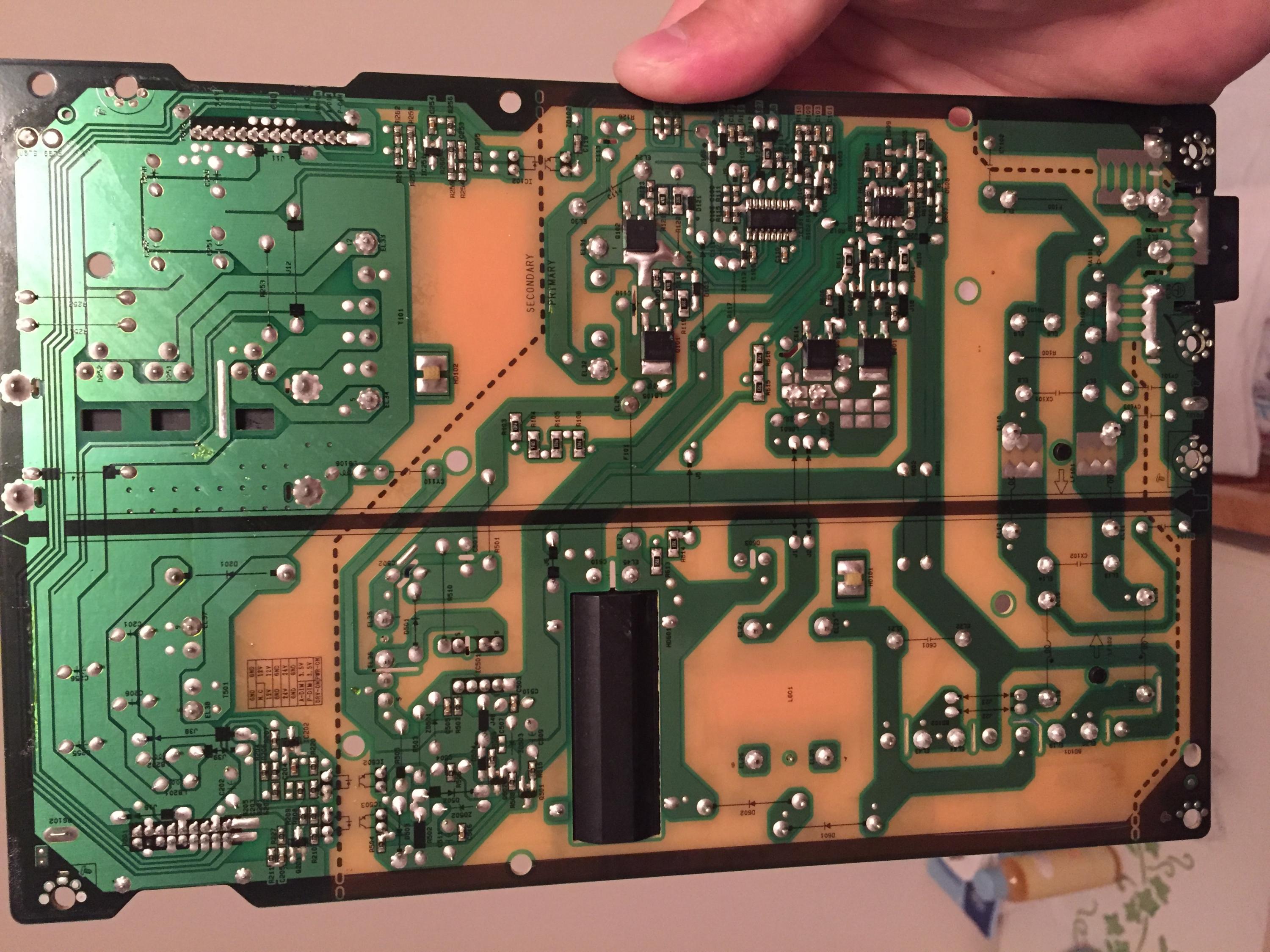

                      Here is a picture of back of power supply. I do not see any loose soldering or bad caps. Can anyone help with the location for grounding on mainboard and power supply?
                      • lukep
                        • Dec 2016
                        • 2
                        Re: LG Smart TV flickering screen
                        circle soldering (dots) -gdn

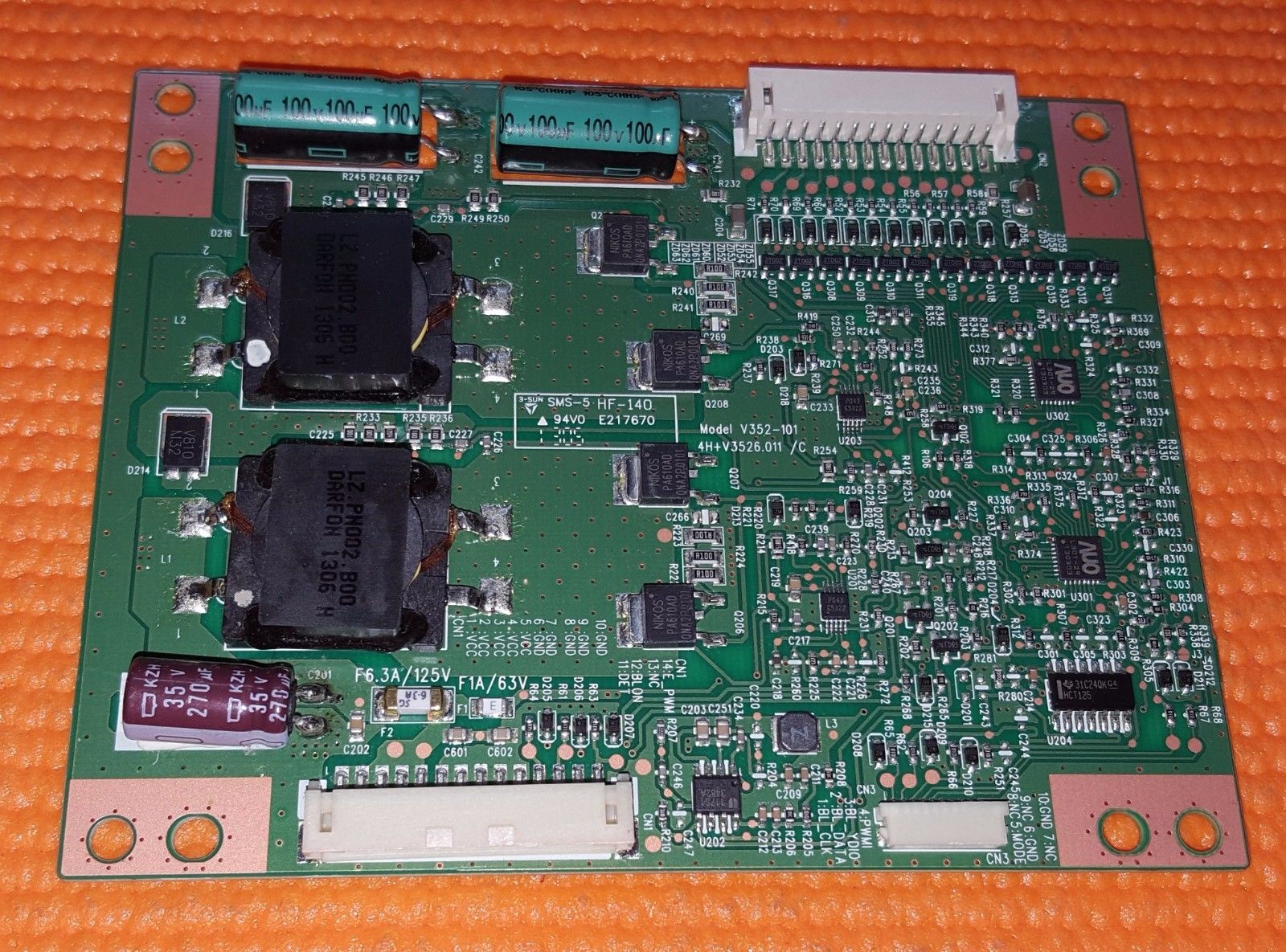

                            1- you are looking at wrong board, backlight driver are at the middle top covered with metal plate. as your first photo in post 10
                            2- from the same photo can see the black light are ON always but screen as you said flick .. keep watch from the back of the TV if the back light keep on but only the screen go black..

                              1) You are right. The backlight driver should be at the middle top covered with metal plate. I will take picture when I have time to work on it.
                              2) The screen go black when back light is off. Screen flicks when backlight flicks. When backlight is off, I can see everything on the screen with a flash light.

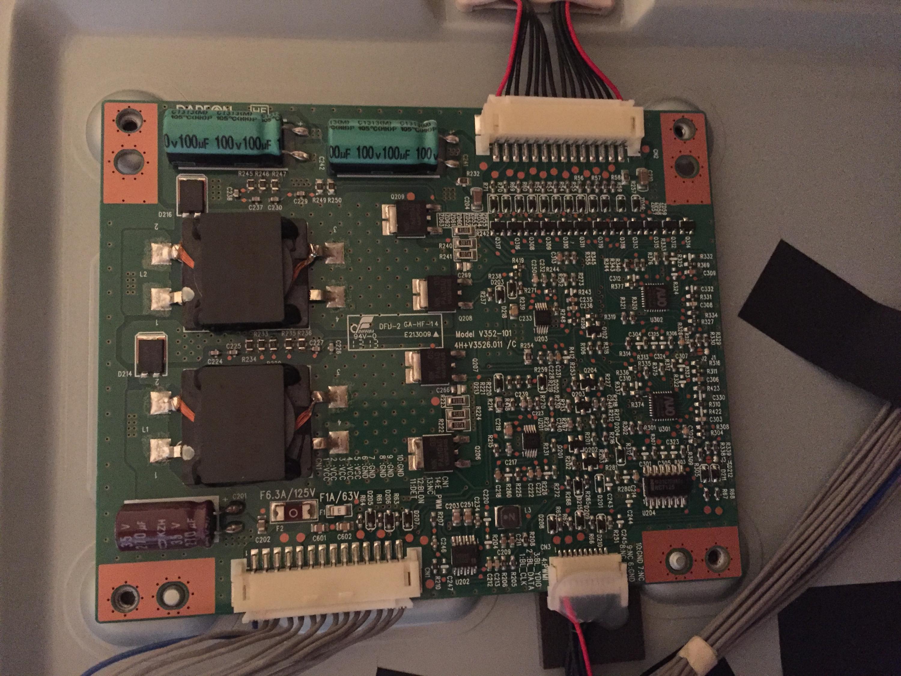

                                Hi Diah,
                                This is the picture of backlight driver board. Can you point out where is the backlight IC on this board?
                                Please refer to my previous post. Do you think the backlight IC is the issue?
                                Thank you.
