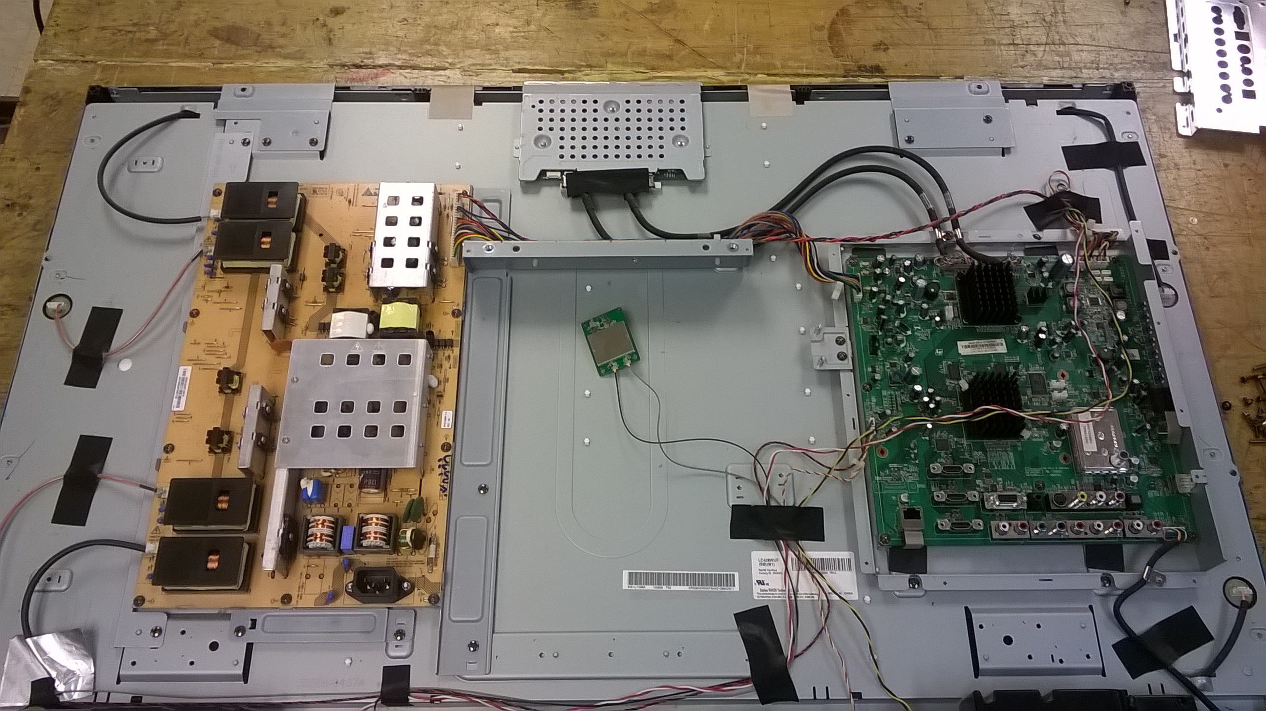

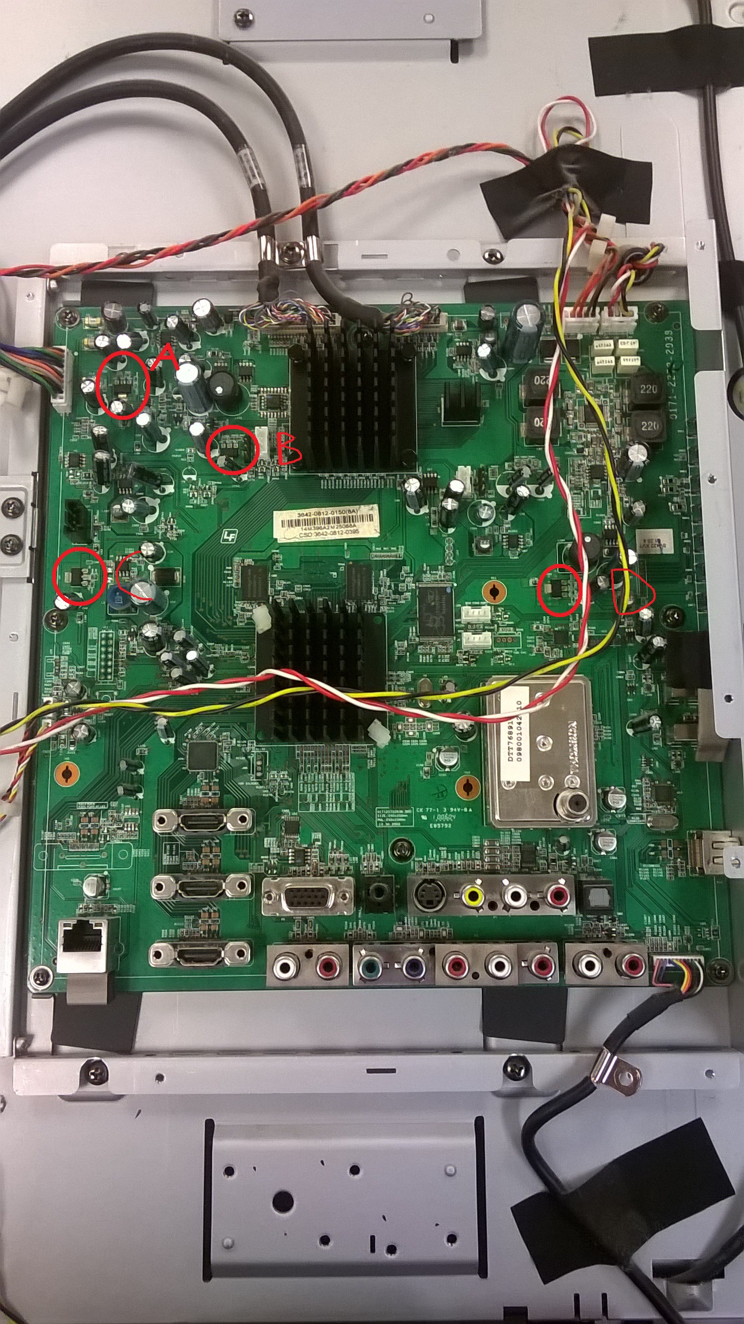

    Hello all, ive read what I could about this tv and have ran into a wall.
    Plug it in orange vizio light comes on
    press power button nothing happens - stays constant orange - no blinking white or anything.

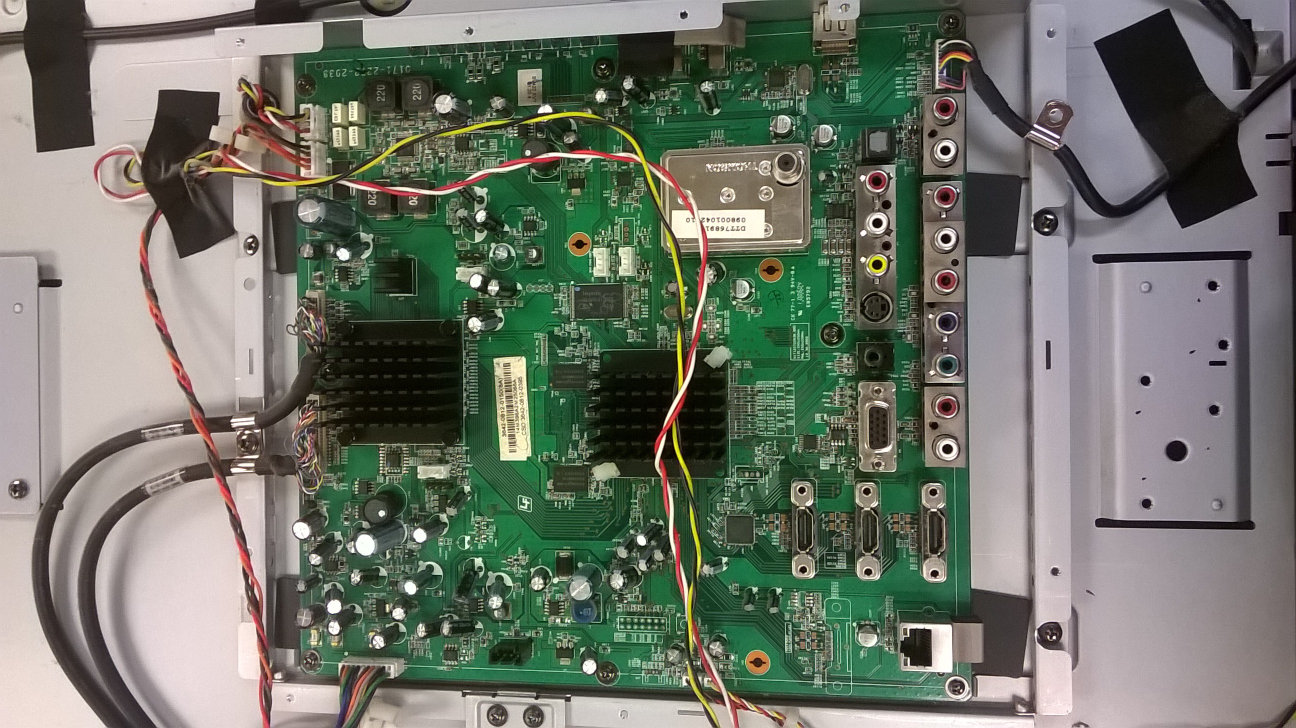

    Ive checked the 3 fuses on the green main control board (where power button is soldered and all the inputs/outputs) they are not blown. Top one has zero volts to it, bottom 2 have 5.013V on them.
    I am missing my +12v
    Ive read the thing about checking the voltage regulators and watched youtube videos but theirs blinks white and appears they have their +12.
    Where to from here? No blown or buldged rubycon caps over on the power board...
    Pics below

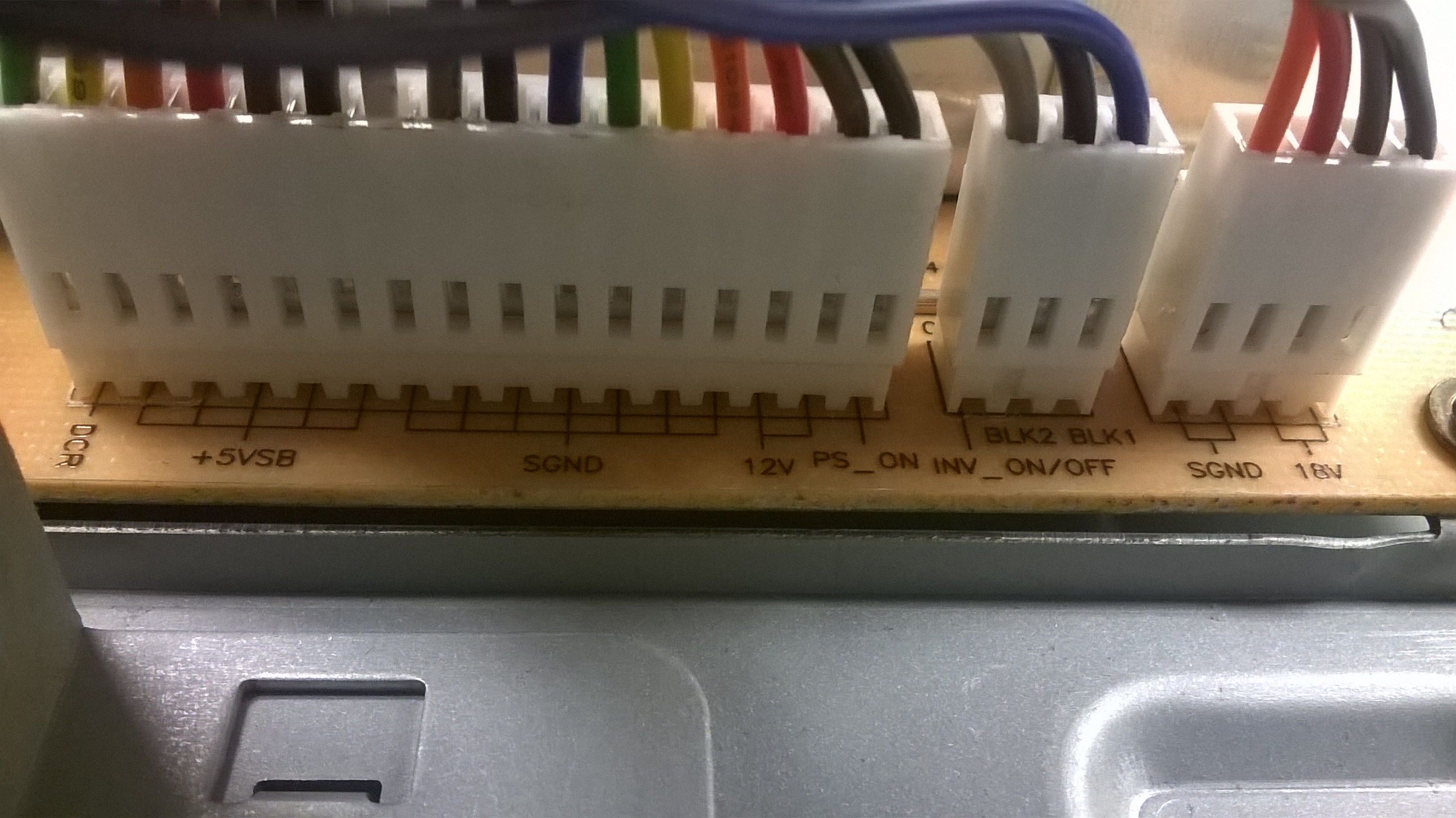

    Unplug All the cable jacks from PSU to Main Bd. Connect a 1Kohm resistor from Any of the 5Vst-by pins to the PS-ON pin...Plug PSU to AC and measure the voltage on the pin 12V is expected on the PSU. If that works then leaving the 1st resistor in place, take another 1Kohm resistor and connect it across the 5Vst-by pin to the INV-ON and measure the 24V pin. If you have the 24V you can plug in the backlights and see them turn ON. If all this works then you have Main Bd issue.

        Alright tried it- aligator clip from +5 to 1K resistor, other side of 1k resistor to ps-on with zero volts measured at +12.
        So its isolated to the power board then...

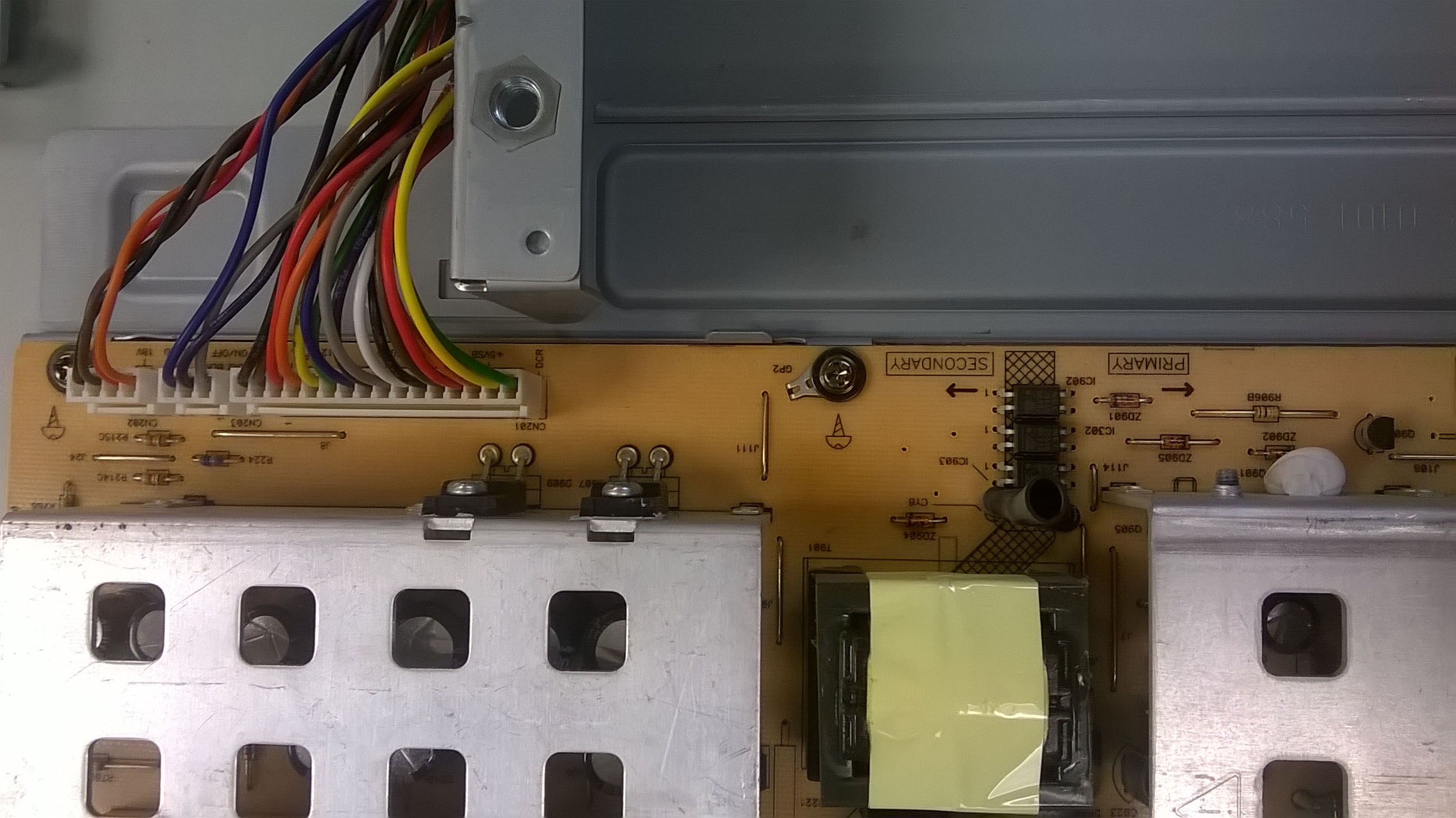

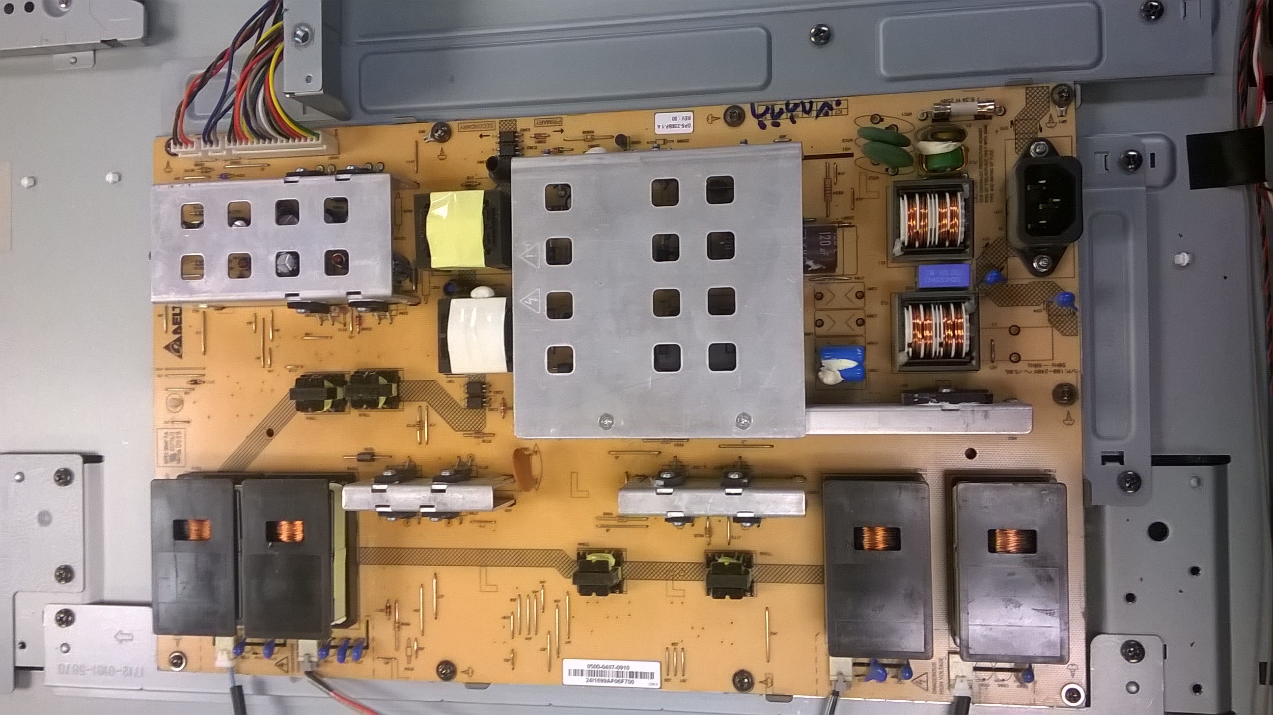

          Is this the board you have?
          Vizio 0500-0407-0910 Power Supply / Backlight Inverter for SV422XVT
          http://www.shopjimmy.com/vizio-0500-...t-inverter.htm
            Re: Vizio SV422XVT - constant orange light
            Yup that be it, looks the same and p/n tag matches (0500-0407-0910)

              Forcing on the power supply board using the resistor and the cable going to the main board is disconnected and still no switched 12V/18V, then yes the power supply is not working.

                One thing though, if you have all the cable back in place, do you see >2VDC on the PS-ON pin when TV is turned on, if not then you may have more then on problem.

                        Well, you have something wrong on the main board or something is locking out the main board from sending the PS-ON signal.
                        I would check all the fuses on the main board, check the dcv of all 3 pins of all the regulator ICs on the main board.
                          Ive checked the 3 fuses, none are blown 2 have 5V on them and one has none (supposed to be 12v) Ill check the regulators but I thought I had to have 12v signal to check those?
                          Ill check them and report back what I find regardless.

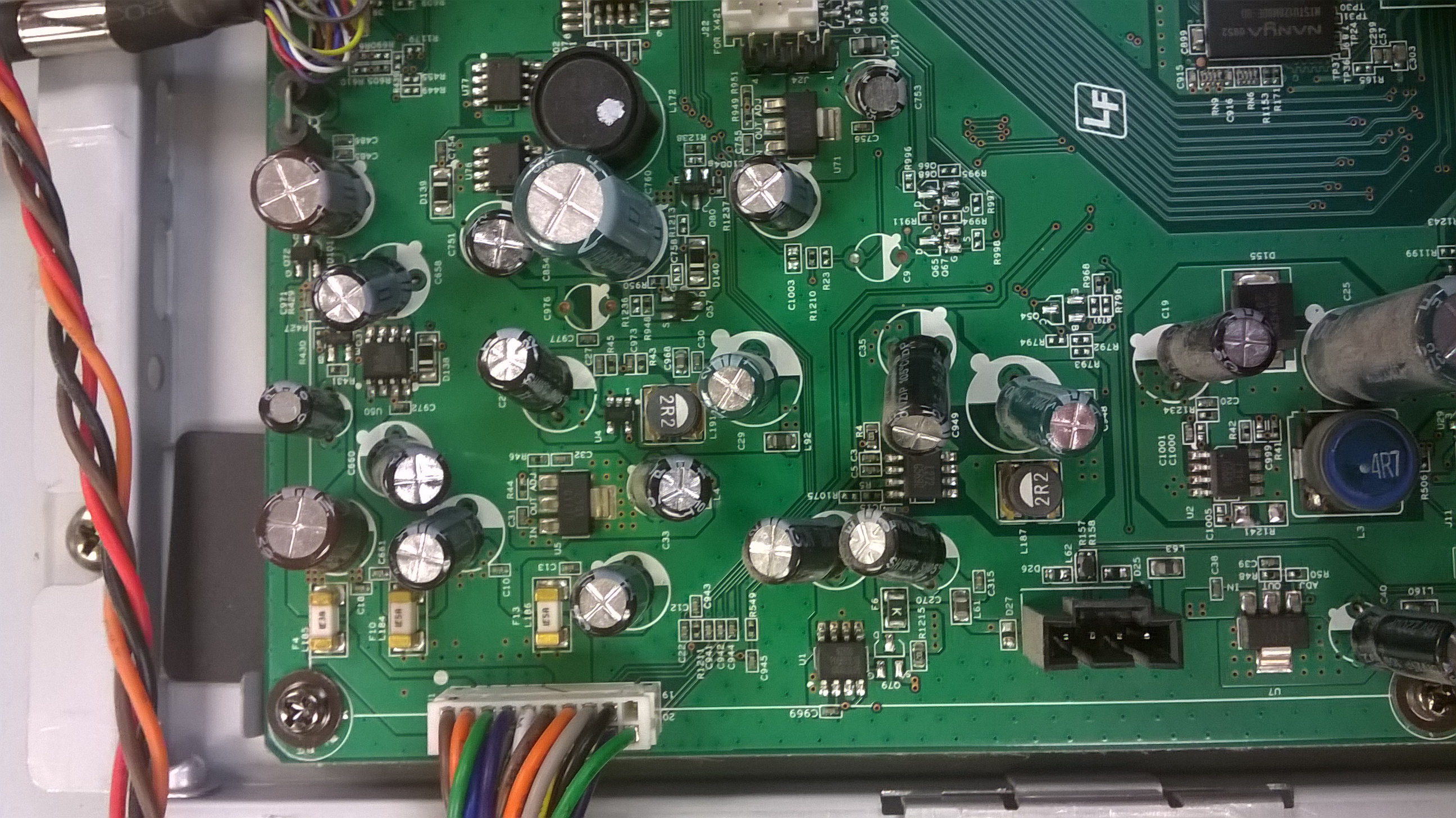

                            Alright measured and using the pic below here is what I got:
                            A:
                            IN: .004 VDC
                            OUT: .454 VDC
                            ADJ: .283 VDC
                            B:
                            .079
                            .000
                            .000
                            C:
                            .004
                            .016
                            .008
                            D:
                            .000
                            .056
                            .035
                            I would assume some of those should have the +5V on the input correct? Even when the orange light is solid? (which I am assuming is standby mode) Pressing the power button while measuring did nothing. All measurements taken using a Fluke 233.

                              You have two white ceramic fuses at 11:00 O' Clock from A. Have you checked them for continuity?
                                I expect at least one of them will have 5VDC at the input pin.
                                You indicated having 5V on two fuses, so 5VDC is shown on BOTH ends of those two fuses?
                                  Correct, there are 3 little white 5A fuses in the upper left corner, top one shows no voltage on either side,
                                  2nd down shows 5.135 on both sides
                                  3rd down shows 5.135 on both sides.
                                  I did find 3 more tiny fuses with letters printed on them:
                                  F6: K has .004VDC on both sides
                                  F12: K has 5.132 on both sides
                                  F11: G has 3.346 on both sides
                                  That F6 reading corresponds to letter A voltage regulator voltage input...
                                  I may take the board out again and investigate the backside for anymore tiny fuses...maybe do the same on the PSU board as I know theres a buncha SMD components on the backside of that too...
                                  Powered off on ohms shows they are all good fuses with .002ohms across them.
