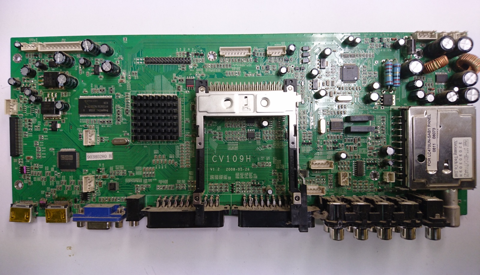

    Got another one Baird 47" with same problem.
    Standby light ON (still), TV not switching on, no reaction on remote / side buttons.
    Power supply looks alright, must be the main board.
    Main board CV109H V1.2
    Anyone had a similar problem?
    Is there any way to fix the main board?
    Thank you for support.

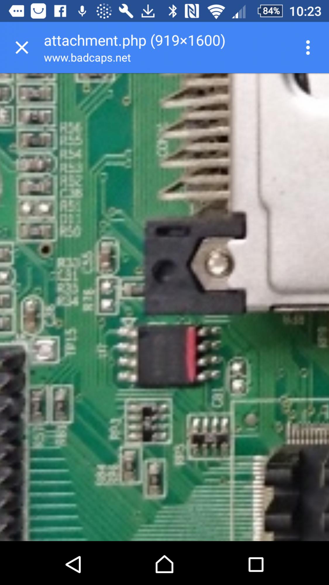

          Looks as though this set may have problems with EEPROM corruption
          http://www.tv.quuq.org/forum/index.p...29235#msg29235
          http://www.ohmsupplies.co.uk/epages/...s/E2P066-CP098

            Sorry reread the op.
            My thoughts would be eeprom.

              as above my guess mainboard issue so if a eeprom is cheap enough certainly worth a try if not look on ebay for a mainboard as long as it matches your panel you should be fine as i some times find replacement boards are cheaper than a new programmed eeprom (you can always take a copy of the working eeprom and maybe try re programming your old board and have a spare)

                          Re: Baird JO47BAIRD Main Board problem
                          TV back in action after replacing the main board.
                          Second hand main board on eBay was cheaper then eeprom.
                          Thank you for your support guys.
                          Regards.
