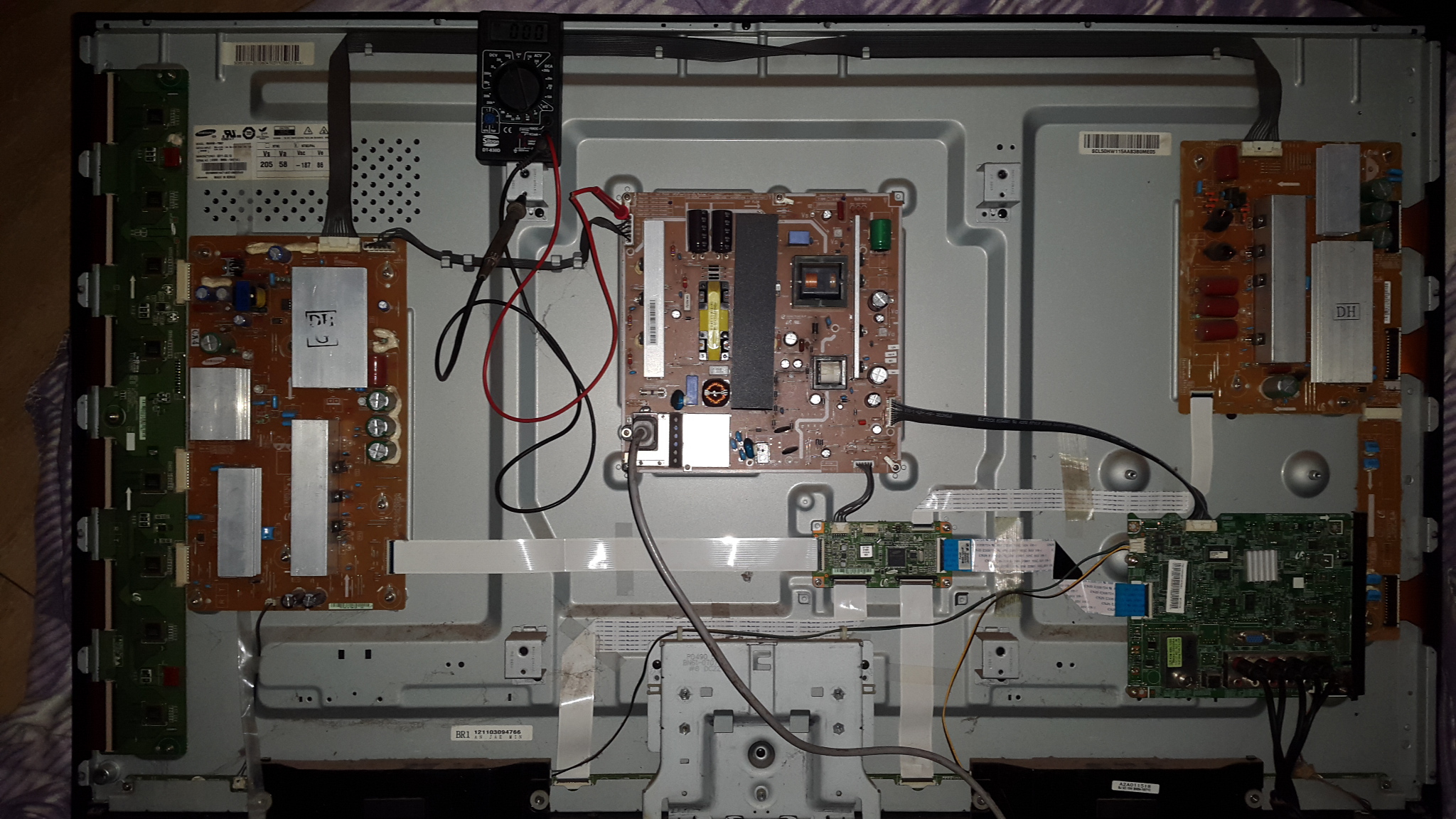

    hello Great Minds,
    I need help troubleshooting this Tv
    Samsung PS51D450AW2 (S50HW-YB07) Manufactured 2011.03.12
    Voltage Present on the SMPS BOARD are (+15 and +5) also present on Logic, Main,X &Y Board
    Voltage missing on SMPS board are (Vs, & Va) reads 0v
    Responds to all button on remote but no sound, no image
    When X main Board is disconnected and powered on with source connected,.
    it flashes image on screen for a half sec then disappears. then Vs voltage goes up from 0 to 205v then goes down to 0 immediately.
    Help,...
    is the problem from my mainboard or the SMPS POWER board. or i need to start troubleshooting the X main board for defective caps and transistor?
    is it normal to hear little whistling from the SMPS board, right after the relay kicks in to power on the unit,,..? it sounds as if a cap is leaking. please help!

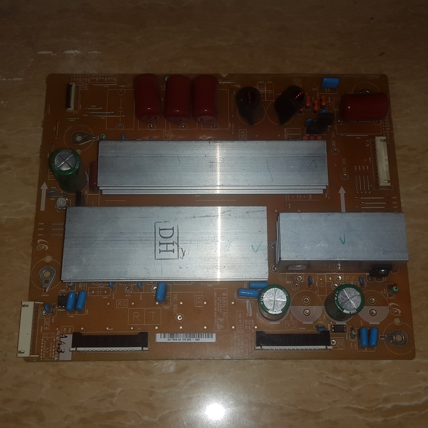

    After Troubleshooting all Board.
    here are my findings......
    I found 3 Bad Transistors on the X-Main Board.

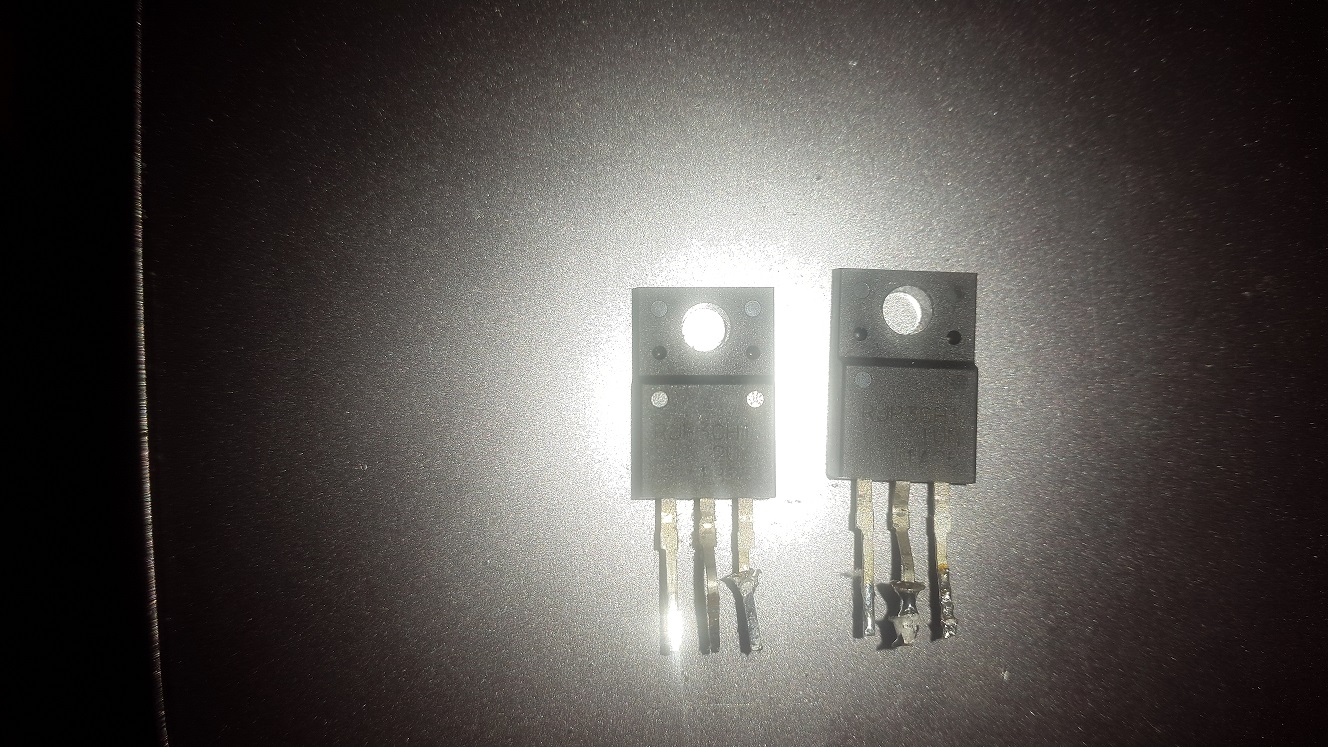

      Re: HELP! Samsung PS51D450AW2 (S50HW-YB07) No sound No Image
      here is the transistor....
      Part number written like these below
      RJP30H1
      IUN
      1A25
      • avonero
        • May 2011
        • 13
        • Guinea
        it a shame we only had 2 store here in my country and none has the transistor nor its replacement.
        Please help, is there any way to Convert or adapt another transistor to work with it.??
        • ReeceyBurger123
          Never Give Up !
          • May 2014
          • 7325
          • Britain
          Normally there is 6 transistors that short on this Xmain. Are there any more blown first ?

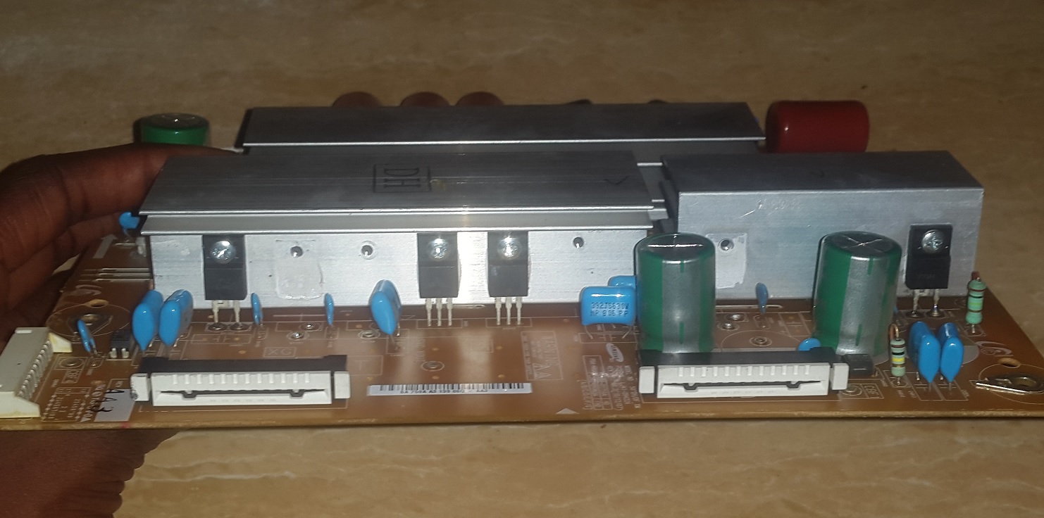

            More picture of my X-main
            Thanks Tom66 for the great write up here https://www.badcaps.net/forum/showthread.php?t=18542&
            it helps alot....
            • avonero
              • May 2011
              • 13
              • Guinea
              The rest are not installed from factory I guess. I found only 2 Damaged.
              6 was Pre-installed the rest holes are just there, i found nothing in it.
              Thanks for the Heads up
                RJP30H1
                IUN
                1A25
                my finding also tells its a High speed N-channel Switching transistor.
                Any substitute?
                I couldnt find it in my local store.
                • flocko
                  • Nov 2012
                  • 1121
                  • uk
                  the RJP30H1 is a 360v 200A IGBT in a to-220f package you should have no problem finding these (eBay)
                  • Nick's Tvs
                    • Jan 2014
                    • 621
                    Regardless of shorts you should probably replace all the RJP30H1 transistors as they are probably in parallel and may have been damaged during the failure.
                    Also as mentioned earlier by flocko ebay has dozens of sellers for these, or you can buy from utsource they sell internationally.
                        Thank you all for your inputs.
                        Today my Transistors arrives, i replaced the known damaged ones 2pcs and verify all connections i.e the flex ribbons and all other connectors.
                        Voila.....
                        It works..
                        Thank you all.
