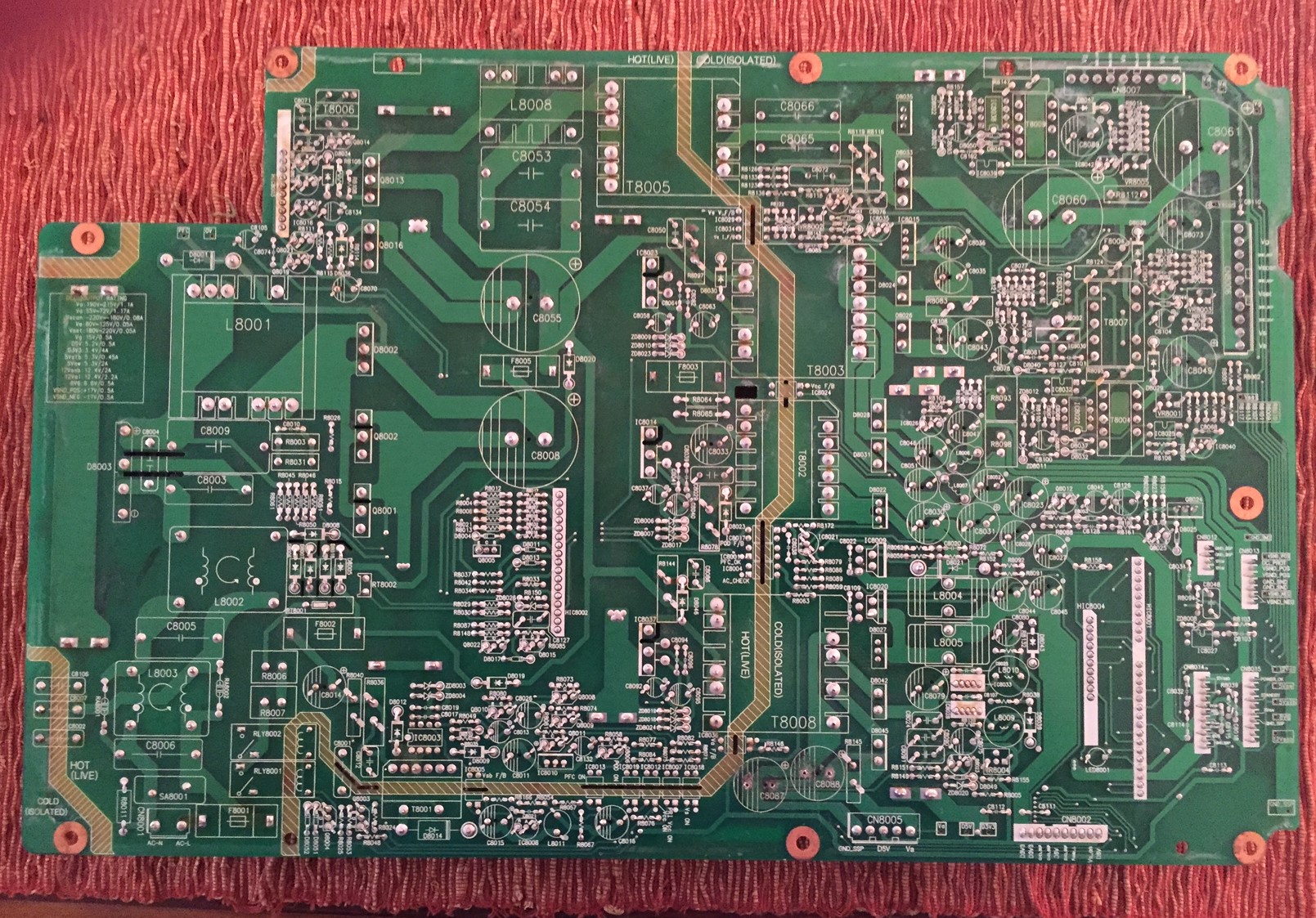

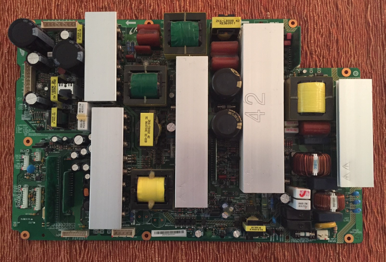

    Philips 42PF9431D/37 LED blinks 5x(red)
    This blinking LED would happen off and on for a few yrs. I would unplug the power cord and plug it back in and it would work again for anywhere from a month to 6 months. This last time it wouldn't come back on. I have attached Pics. You will notice a missing CAP in image 4329. I took (2) Samxon 680uf 100v caps out because of a post I read but don't know which brand to replace them with. I tested a cap I bought at Radio shack (for testing purposes only) and got a reading within .11 uf of the rating but when I tested these 2 caps I get something that says 0.F (which I guess means they are bad). Any help would be much needed and appreciated.
  • tlerohl
    • Nov 2016
    • 12
    Re: Philips 42PF9431D/37 LED blinks 5x(red)
    Sorry, I thought I added the pictures but here they are.

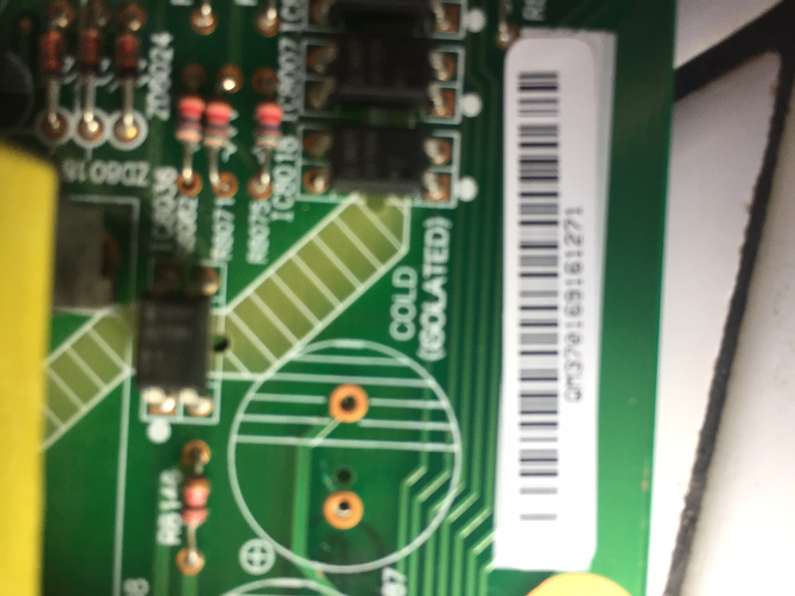

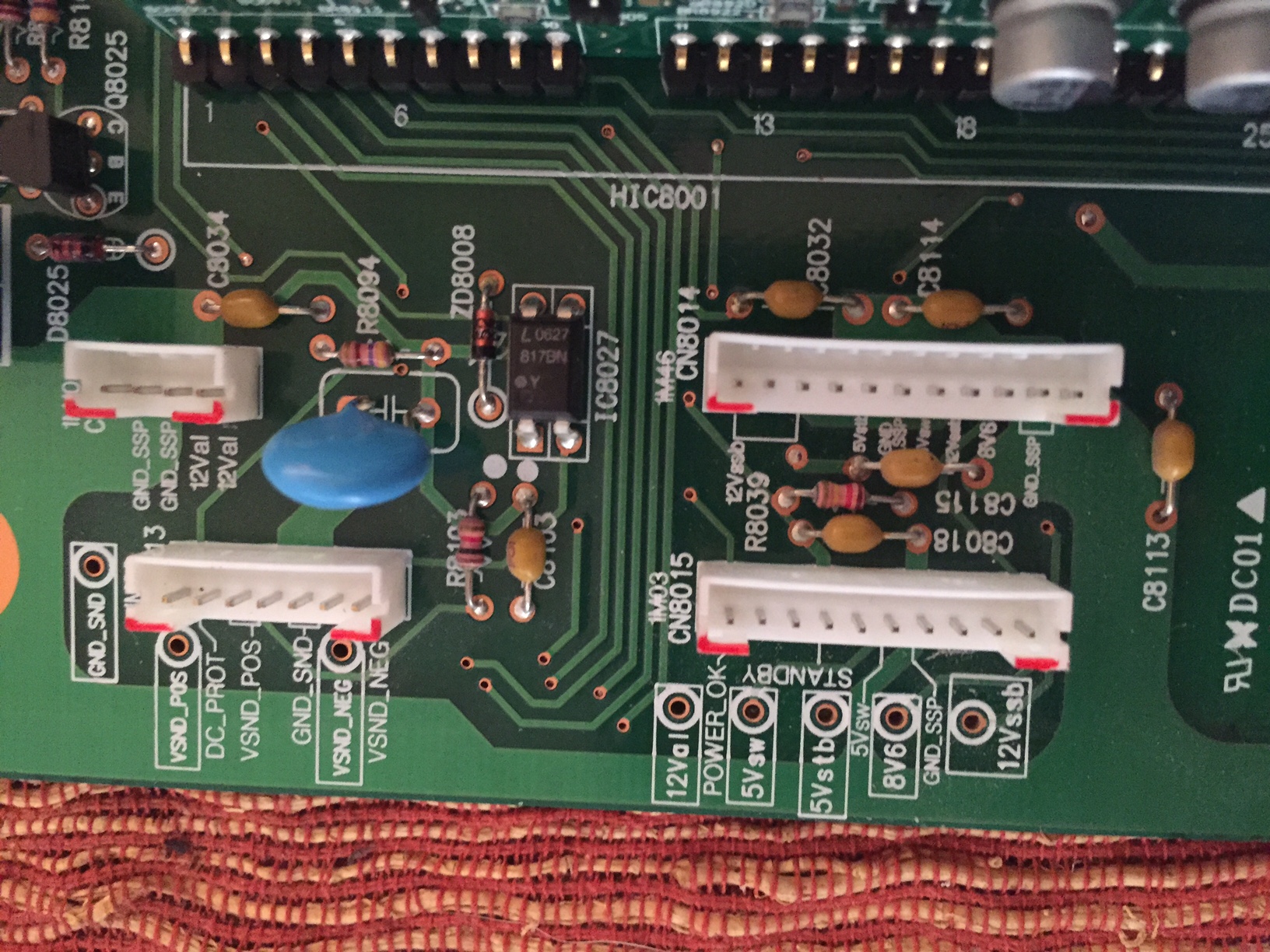

            OK, So lets first start with the LED flashed 7 times not 5. I think I read too many forums about 5 blinks before taking things apart and posting.
            With that said, once I re-installed the 2 caps initially I got the 7 blinking red lights. Then we put a hair dryer to the board and the tv powered up.
            Please tell me what my next step should be. Your help is appreciated!

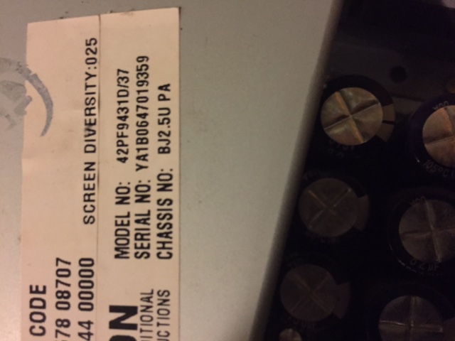

                  How would I know what Caps to buy for a full recap? I am open to it. (I waited before posting until I had a meter that could read higher capacitance. (Mine only went to 40 farad which is why I couldnt get a reading on the 2 caps I pulled). Bought a nice Fluke. I am ready to try this and appreciate any help provided.

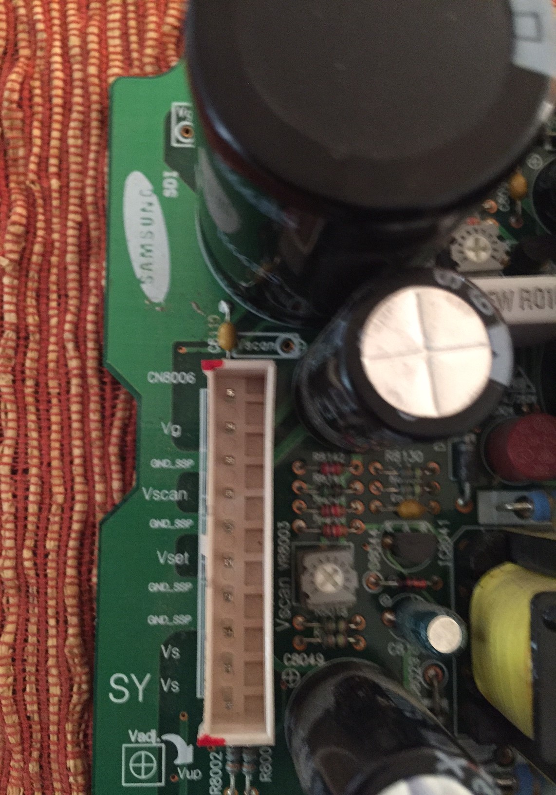

                          Of each Cap? I will have to remove each one or at least one of each size to figure that out. There isnt a list based on model of TV or board? I would hate to not get them all back in the right place a week or two later (once I have the replacement caps).
                          Does this pic help at all?
