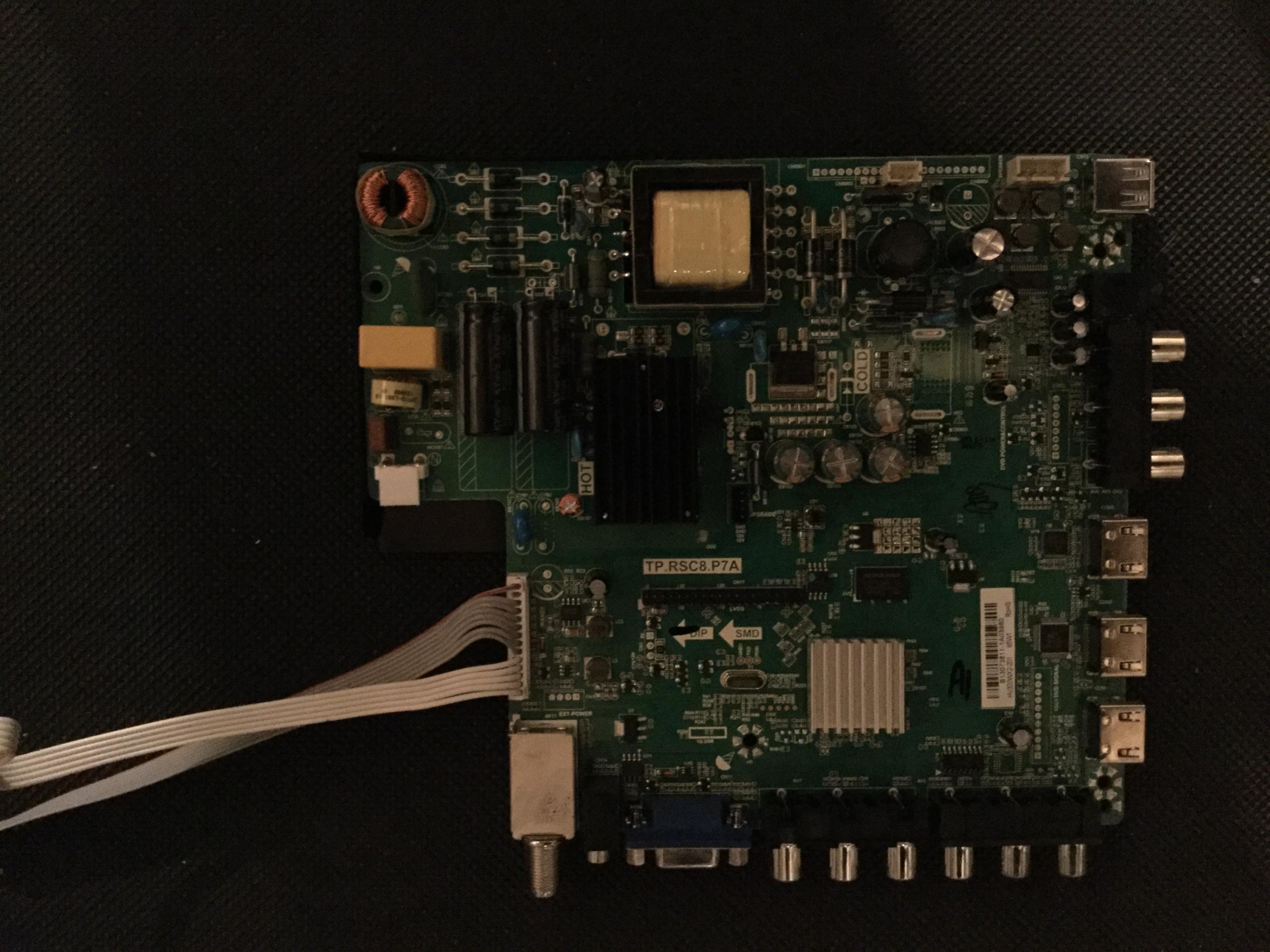

    I have an ocosmo model E32, p/n CE3200-WX2201P7A with a control/power supply board: B13073811-1A03980 HV320WX2-201 rev A1.
    Picture and sound are present, but no backlight. On power-up, the backlight voltage goes up to about 125vdc and then quickly drops to 48.5vdc and is steady there. Adjusting the brightness has no effect on the backlight voltage.
    Is this proper behavior and voltage for the backlight?

        Can you provide pictures of your boards which could prove helpful.

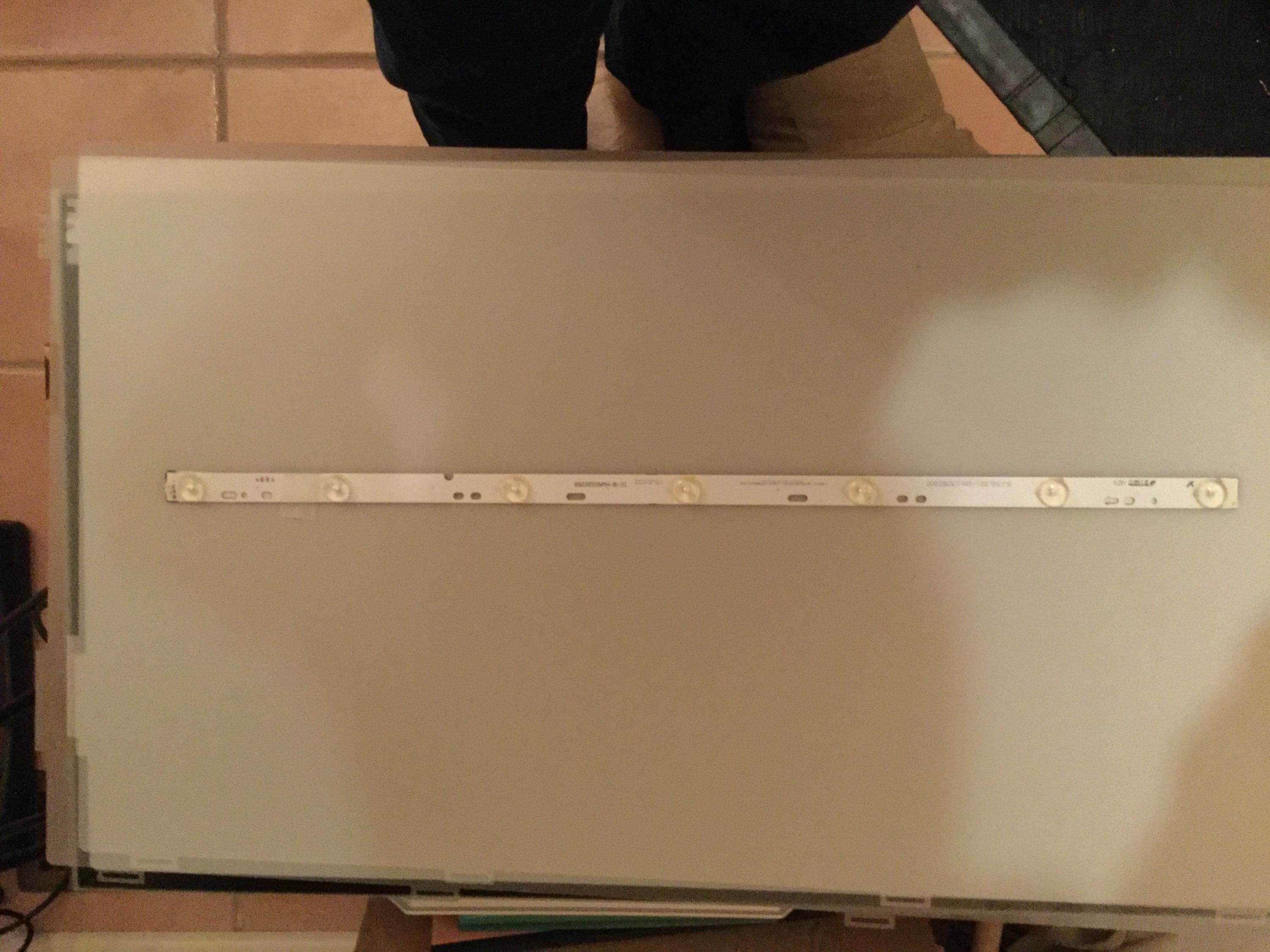

          There are 3 LED backlight strips with each strip having 7 LEDs. All of the LEDs are wired in series and one LED on one strip is bad, therefore, no LED flash on power on or ever. The LED strip has the following numbers on it:
          SJ32L321-DH-13052201
          Y5JC032
          IC-B-HWA032D255
          Does anyone know what the LED is or if the LED strips are available?
          Photos of the control/power supply board and an LED strip are attached.

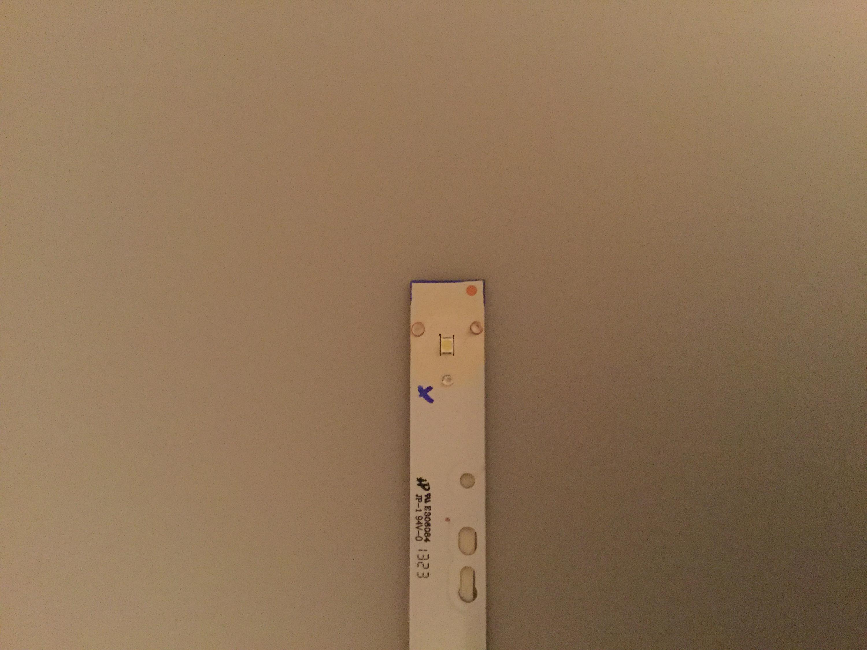

            I removed the lense and the LED measures 3.4mm x 2.8mm and is 0.85 mm tall. Picture attached.

              Shorting out the defective LED, the backlight drive is 77.7Vdc @ 347ma, driving 20 LEDs. That gives a Vf of 3.885V.
              The brightness setting was set to maximum before I disassembled the TV.
              The part size I stated earlier should probably be 3.5mm x 2.8mm which is a 3528 metric or 1411 imperial smt size.

                      TV is fixed. I used a Samsung LM301a 3x3mm LED with a CCT = 6500K. Things I note:
                      1. The existing LEDs appear to have a higher CCT because the corner of the display where the new LED is placed is a little yellow compared to the rest of the screen. 6500K was the highest CCT that was offered for the LM301a.
                      2. The intensity of the new LED is a little greater than the existing LEDs which was noticeable on the bench, but not in the TV.
