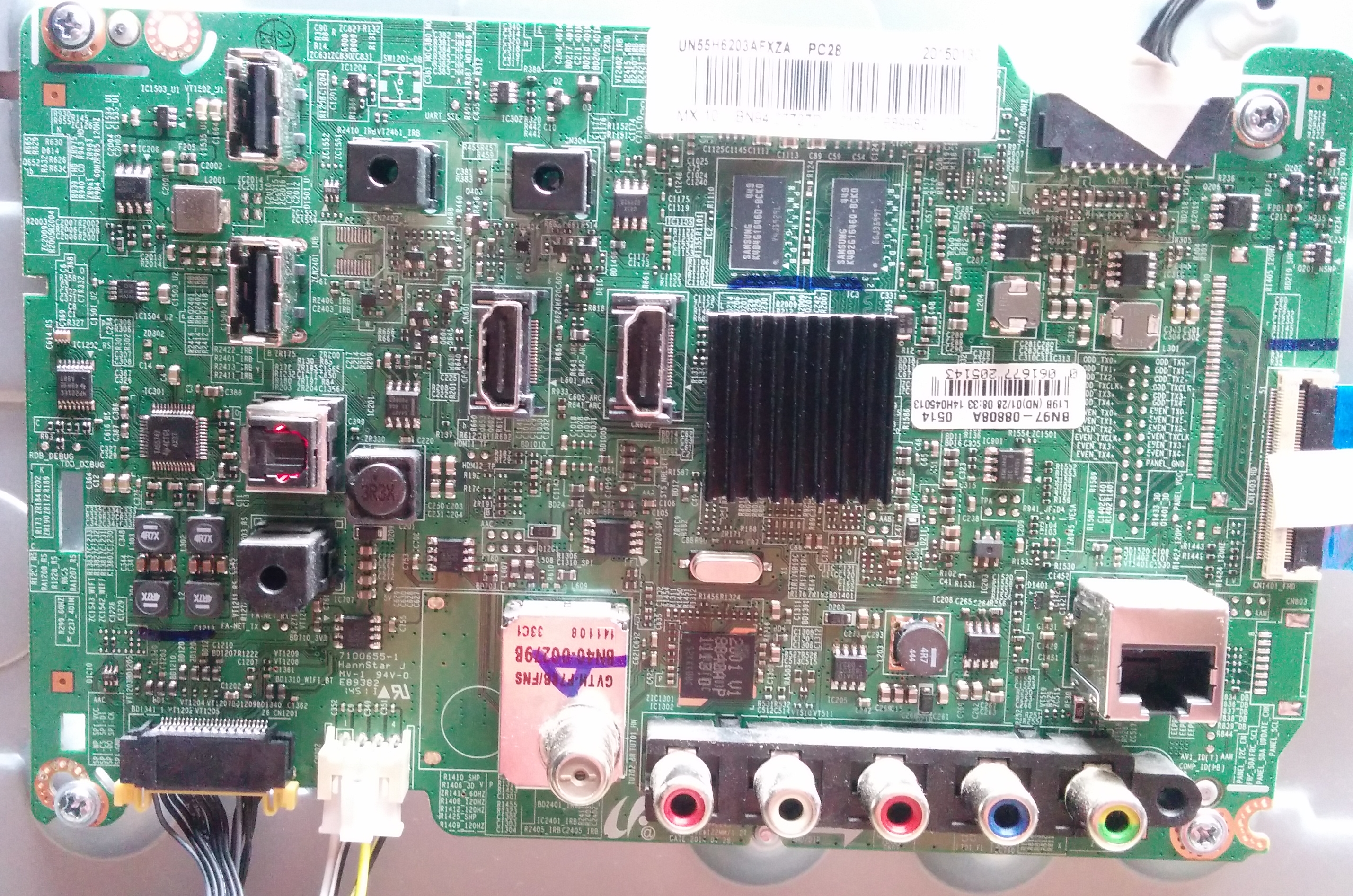

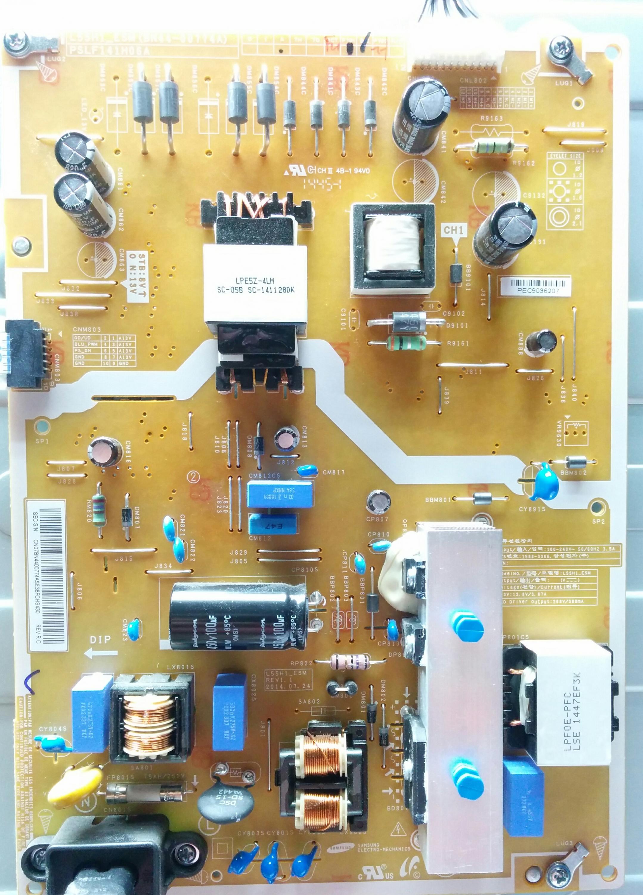

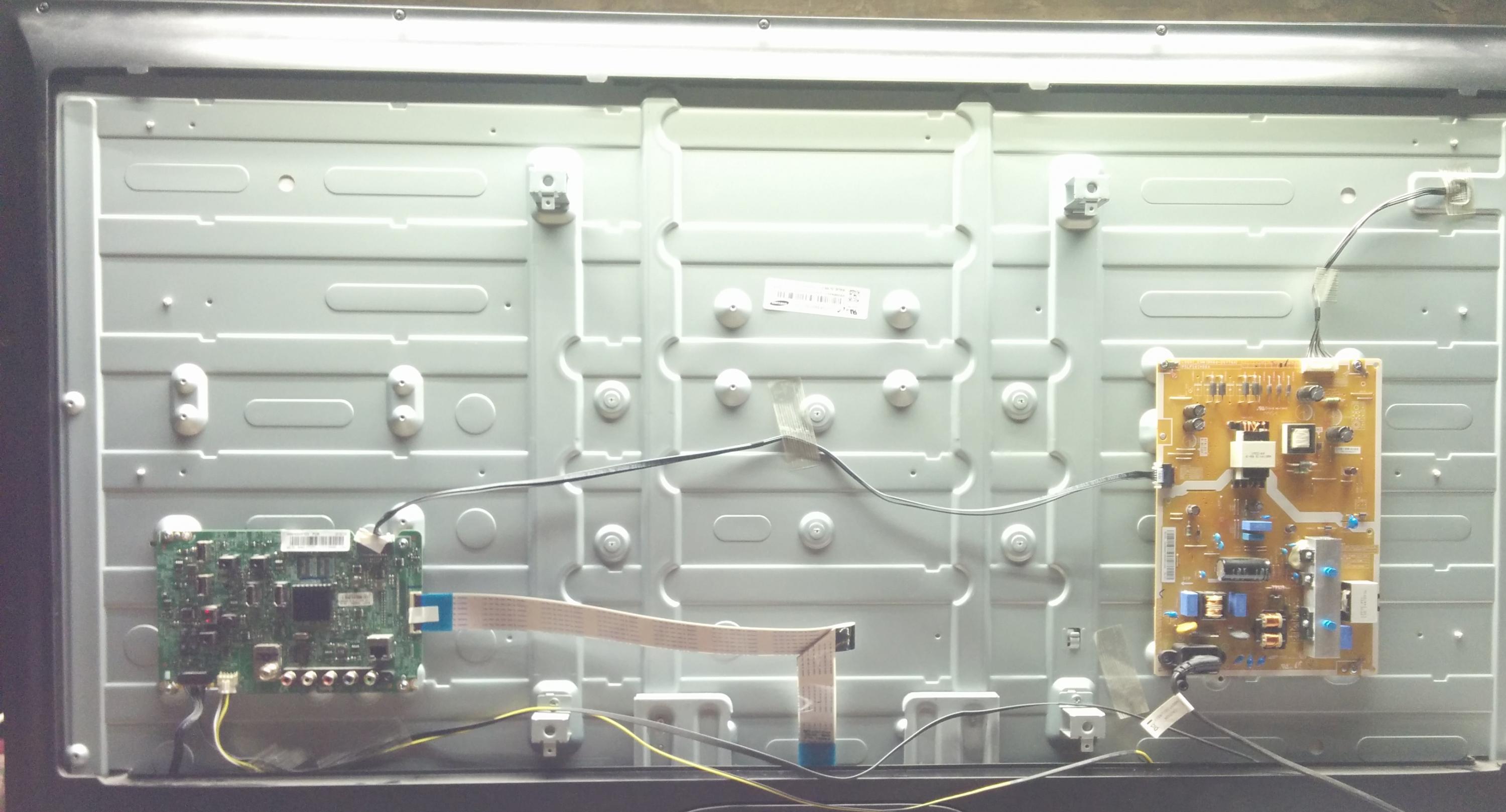

    Got this TV from a friend, about 1+ old. Was working until picture went out but still had sound. However, since I got the TV I have not been able to reproduce any sound.
    Boards
    BN44-00774A Power
    BN57-08808A Main
    ?? T-con ( have not taken apart the main cover to inspect, will do this soon )
    Observations
    I have tried to reproduce sound by changing channels, inputs and volume.
    I used a flashlight and see nothing on the screen.
    It seems the TV is responding to remote Power cycle. I can see Optical Jack light up red on the Main board and a Blue LED on the T-con board.
    I see no bulging caps on the Power board.
    I pulled the Power board and did some preliminary shorts test, nothing found

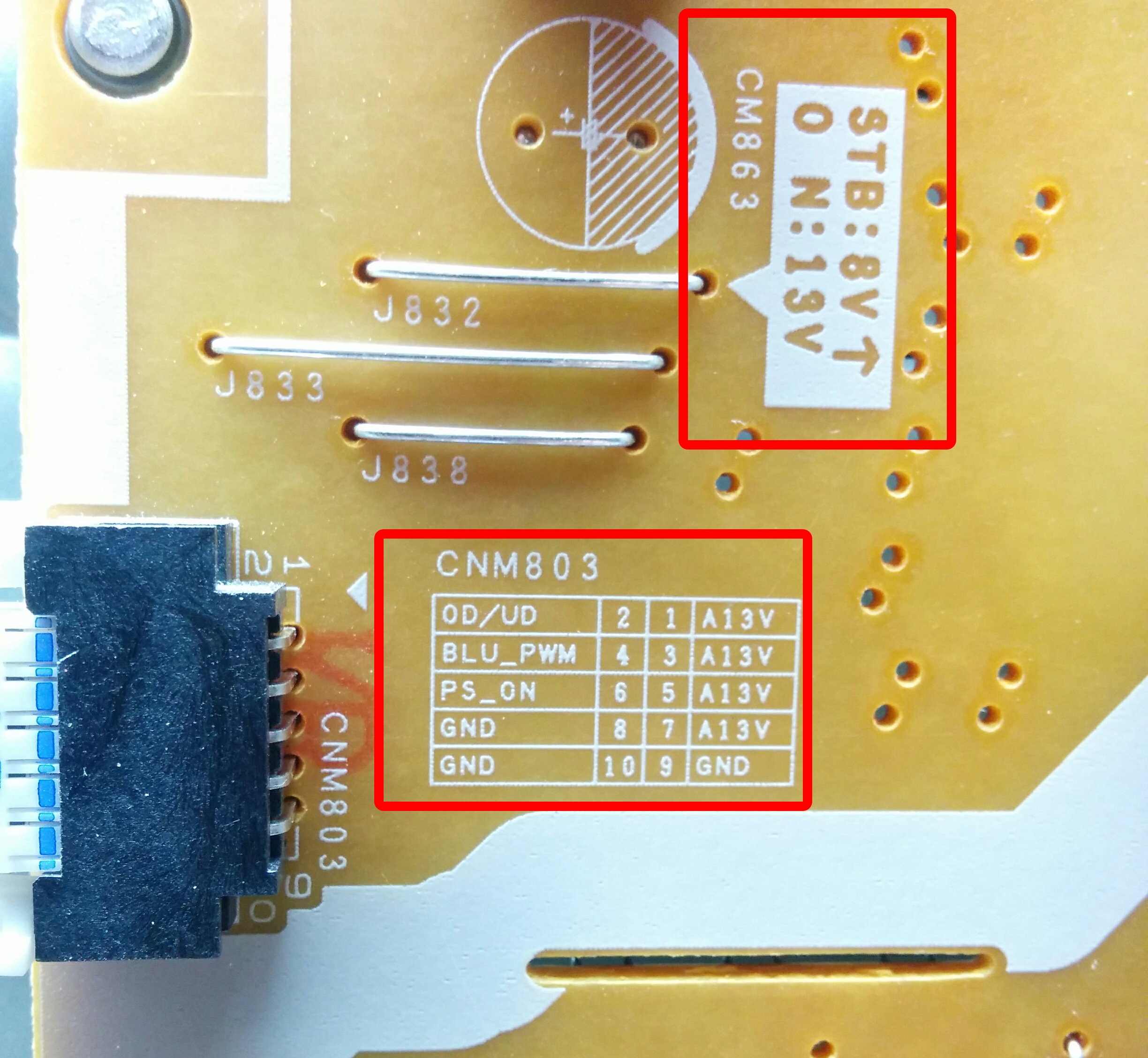

    Power Board CM863 Confirmed working ( 8 to 13V ) in response to remote
    Power Board CNM803 Confirmed working Pin 6 PS_ON in response to remote
    Power Board CNM804 Confirmed Pins 1, 2 ,3, 5, 7 13V

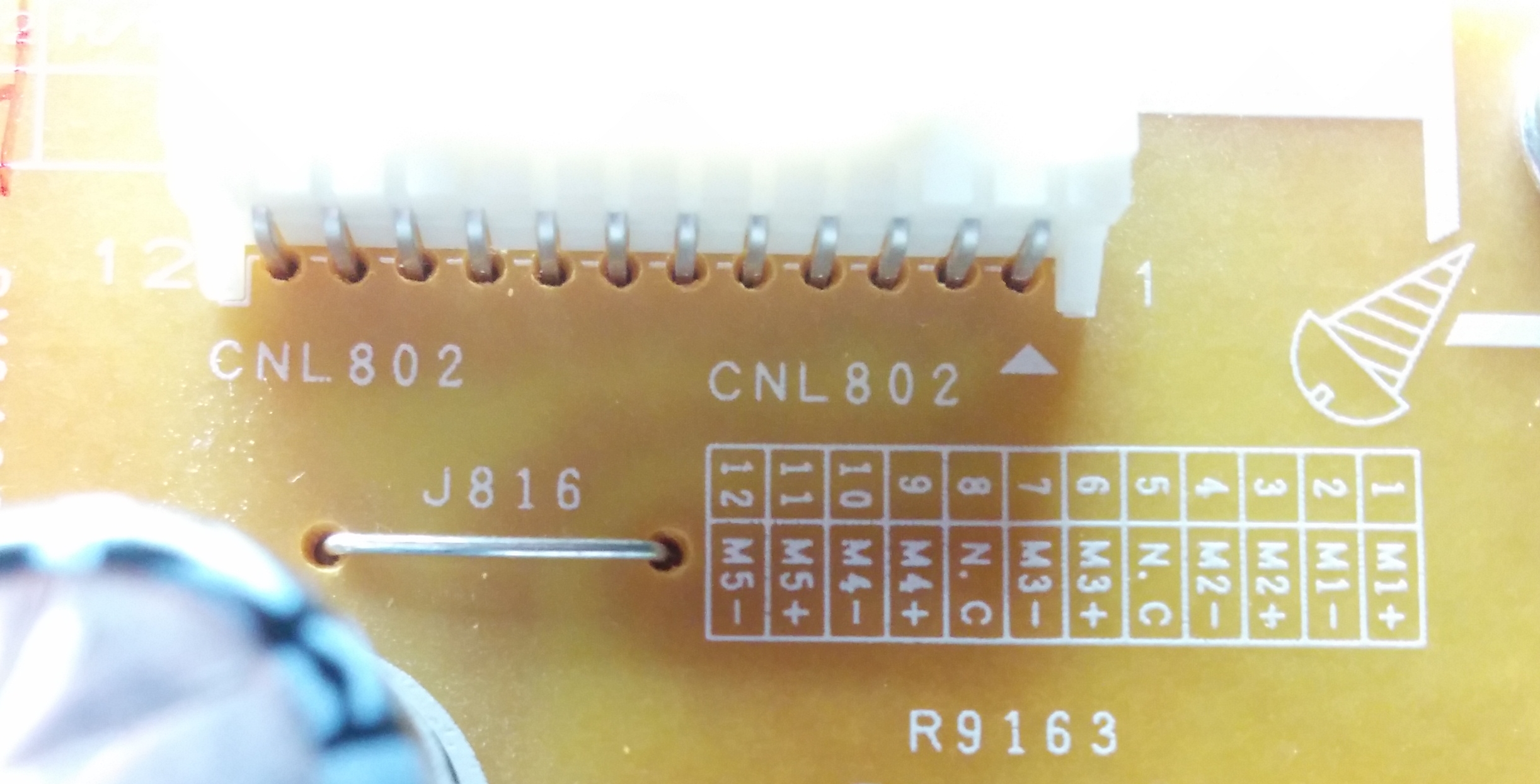

    What should be the voltages on Power Board connector CNL802 ( see attached picture ). When I measure these, I measure a fluctuating voltage starting at a max and dropping to a min, then repeats ( voltage measurement dependent on using GND or Connector M?-

    The voltage to the leds should be 268v according to the legend on the power supply board.

      M1+ 308vdc, M2+ 260dc, M3+ 225dc, M4+ 200dc, M5+ 0.1vdc
      C9132 295vdc, CM842 242vdc, DM843C & DM842C 245vdc
      Questions
      Given the M1-M5 voltages, am I correct in assuming that the LED strips are in series ?
      If true, then M5+ is failing at 0v, this should be reading a couple hundred volts ?

                    I looked up the panel # and this TV uses a total of 5 rows @ 14 LEDs per, or total 70LEDs. At the Power Board rated 268v that comes to roughly 3.8v per LED which is about right. So for each row I will need at least 42v to power the strip (3v per LED x 14).
                    I have an adjustable power supply so setting the current limit of 50ms ( thanks budm ) and adjusting the supply voltage should be no issue. I'll report back my findings, expecting strip #5 ( M5 ) to be bad.
                    • TheTesterMan
                      • Apr 2015
                      • 91
                      Re: Samsung UN55H6203AF - No Picture! - No Sound?
                      Ok, I applied 40v @ 50mA to each strip and found M4 to be defective. I now need to decide if I open it up and try to repair this strip ( I work for an LED company so I should be able to find replacement LEDs ) or simply purchase a full strip. I'll report back, I think I am going to go ahead and try the repair first.
