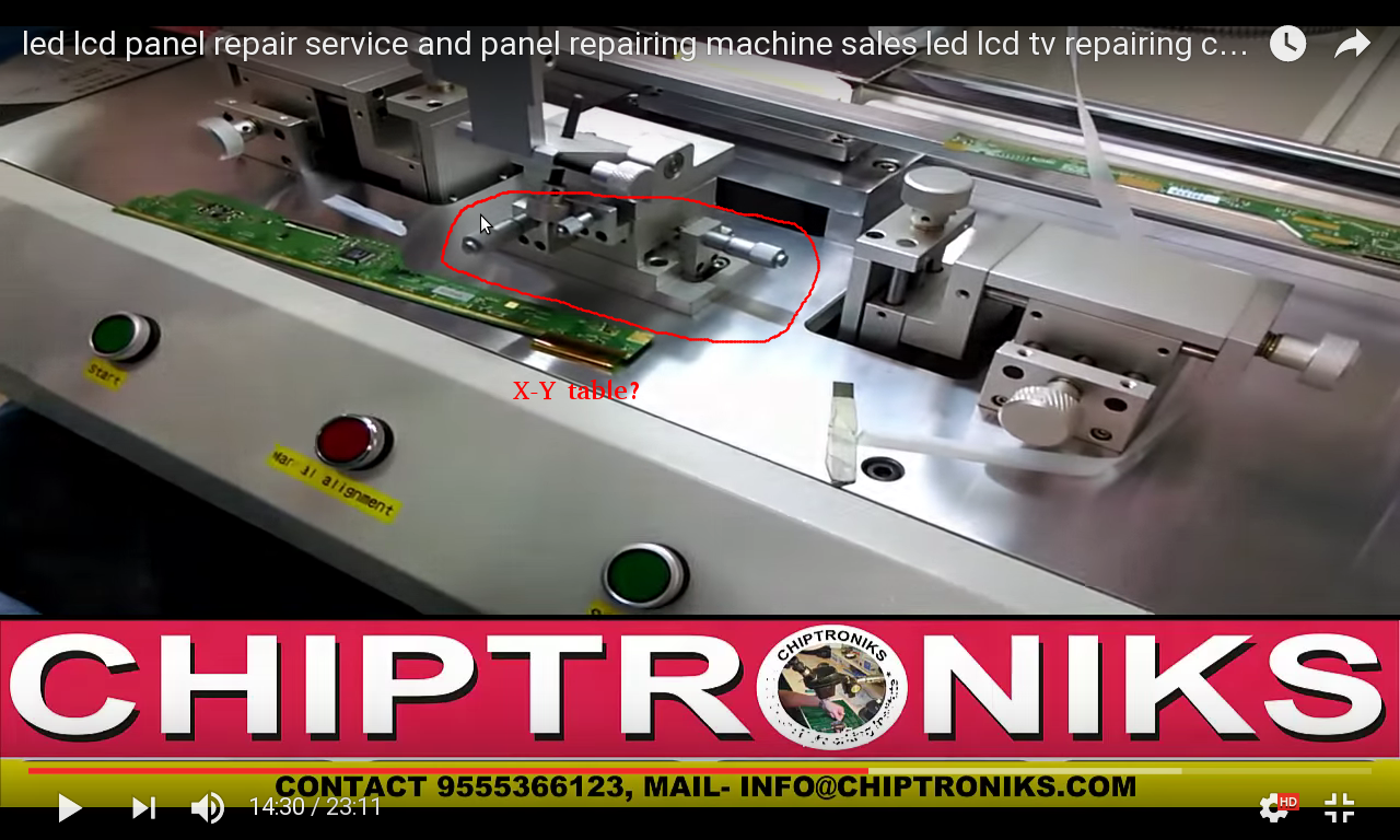

        Where I can buy this X-Y micro adjustable table (I dont know the name! pic1)?

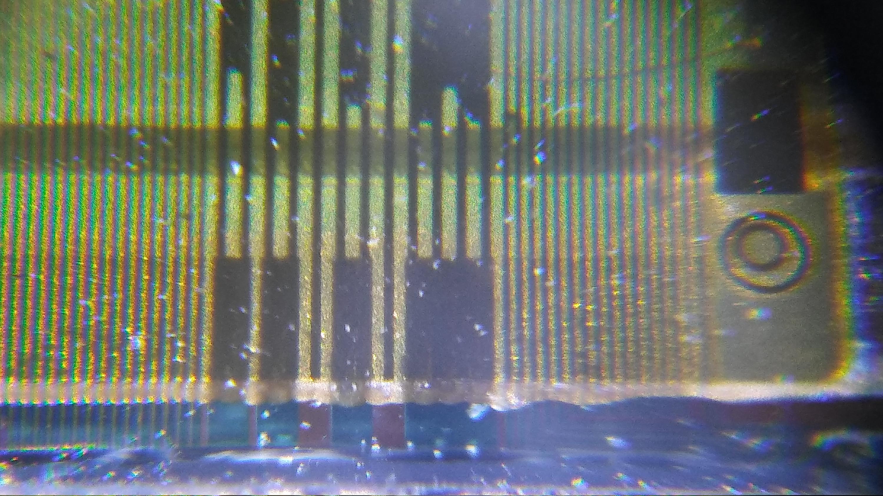

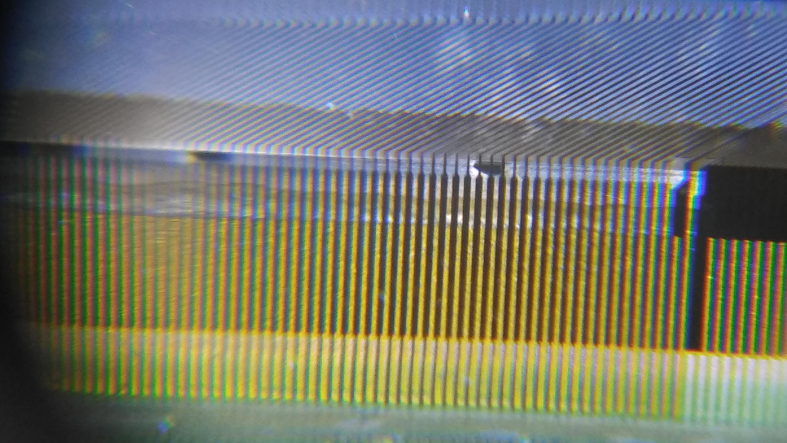

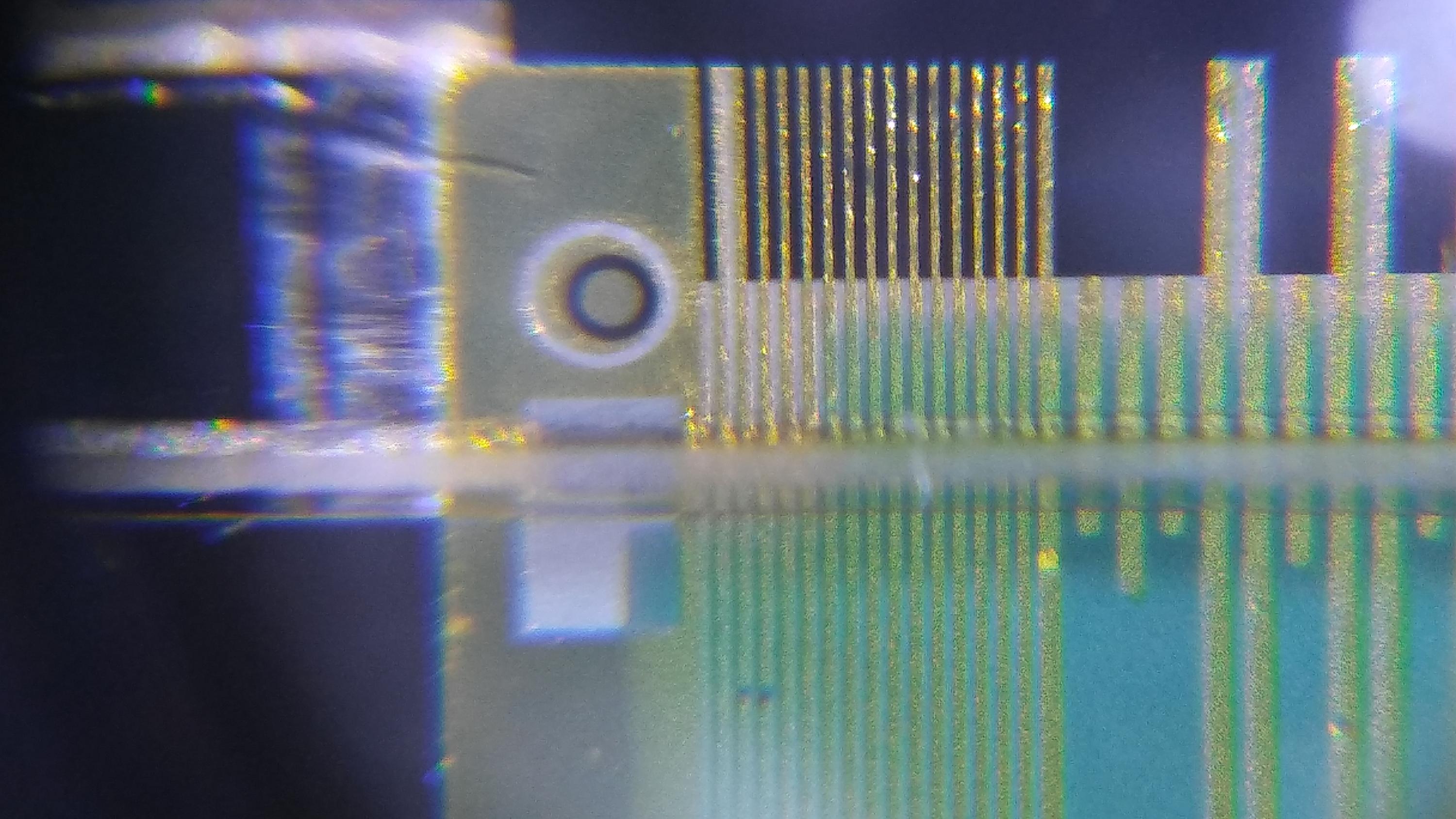

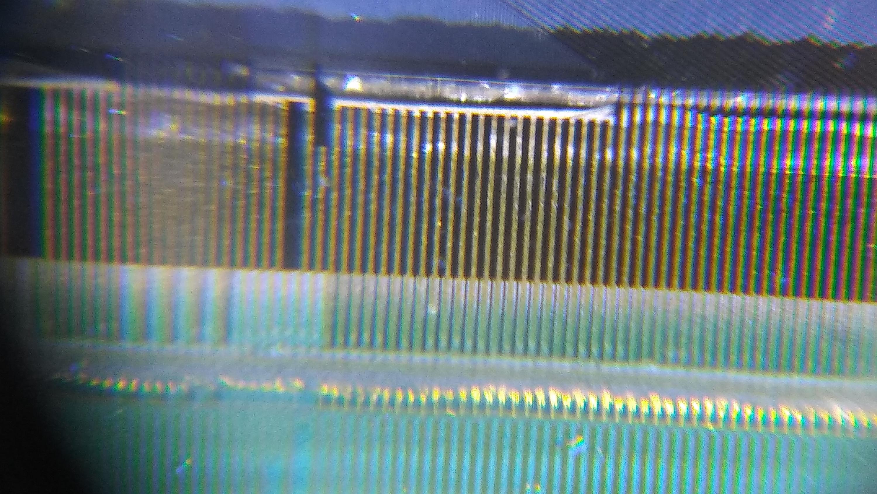

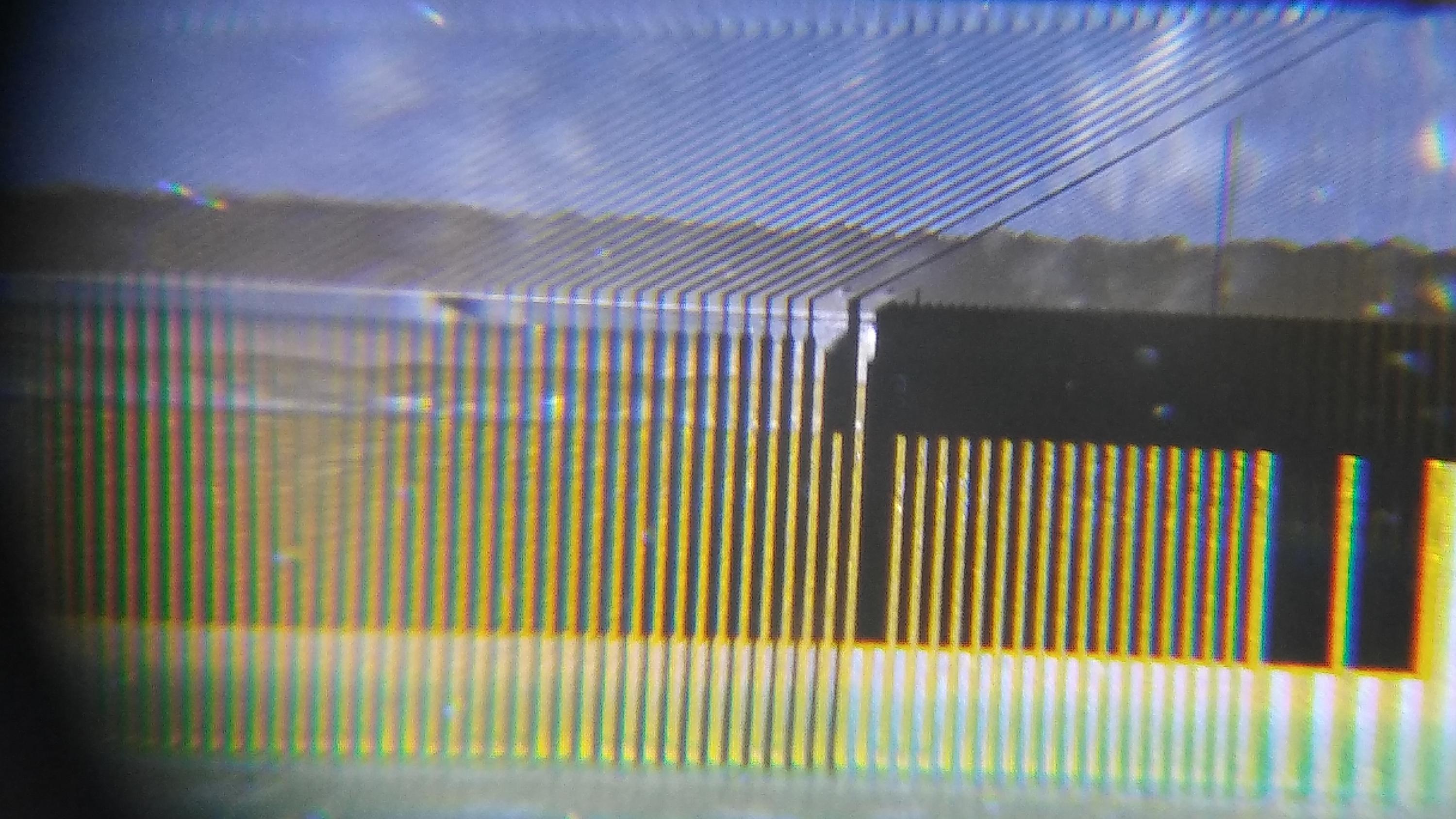

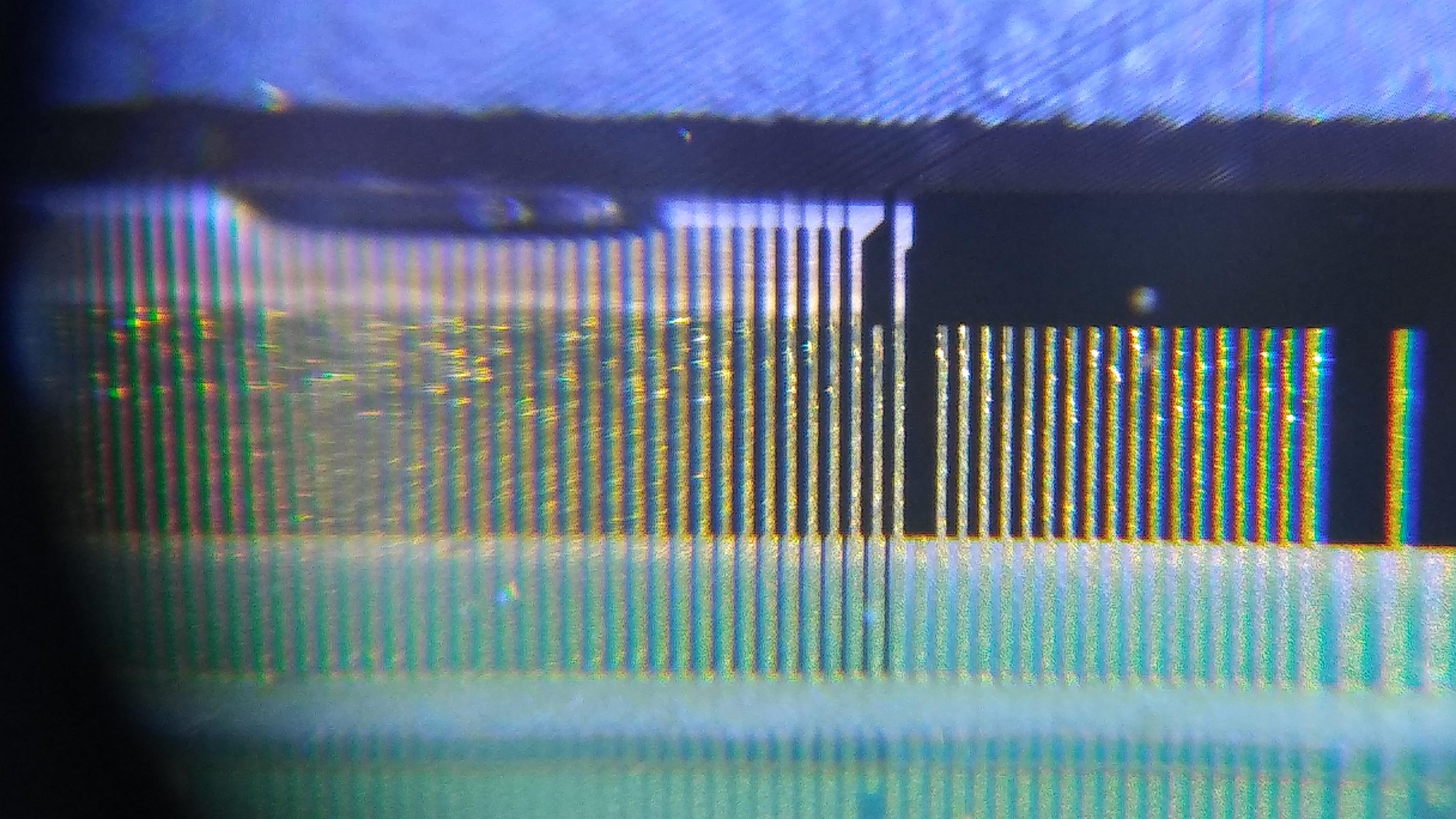

        I took those pictures two months ago. I need xy table to finish this project...
        PS: is 3D printer precision enough to do this job, I know nothing about machinarium.
