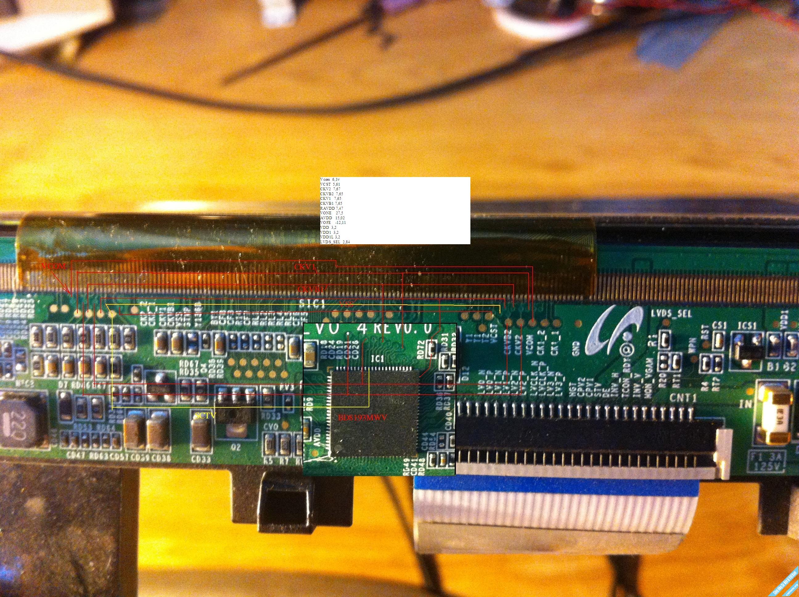

    I have sony 32bx311 ,with no video sound ok problem, when i switch on tv i can see white raster for a second and then nothing, only back light and sound ok.

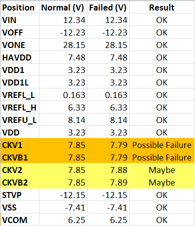

    On T-con board ,i have +12 v(Vin) only but no V-0FF ,no ha-vdd ,no V-ONE voltage.
    I dont have schematics of T-CON board, Part no: Y320AN01S4
    I have attach some picts. with voltage chart,witch i found from onther website,,
    I just want to know V-OFF, V-ONE and HAVDD voltage generate from Main board or its always should be there??
    Any help please.

          Re: Sony 32BX311 T-CON Board problem
          Hi Friends
          i am uploading new image of that board with indication of voltages which is not there ,i have only +12 v.,
          if u have a schematics of this board please upload. Thanks
          Mac
            I don't understand....You have 12Vdc on one side of the Fuse F1....but don't have the other voltages you highlighted CKV1 and etc????
            • rawan
              • Oct 2009
              • 57
              Hi
              I have just upload a image of board i have. i have 12v on both side of fuse but no any other voltages.
