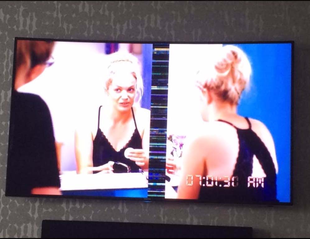

    Here we have an 18 month old Samsung curved TV with a screen fault.
    Its a UE55H8000. I'm presuming its a terminal screen fault (see attached).
    Any thoughts ?
    thanks
    Mark

    Panel failure, not fixable. More Led shite failing

      Thought as much. Poor woman is gutted, paid a lot of money for it as well. Only come with a 12 month guarantee.

            Are the tabs on the bottom on this model ? Because that's an expensive lesson learned if she was spraying glass cleaner directly on the screen.
