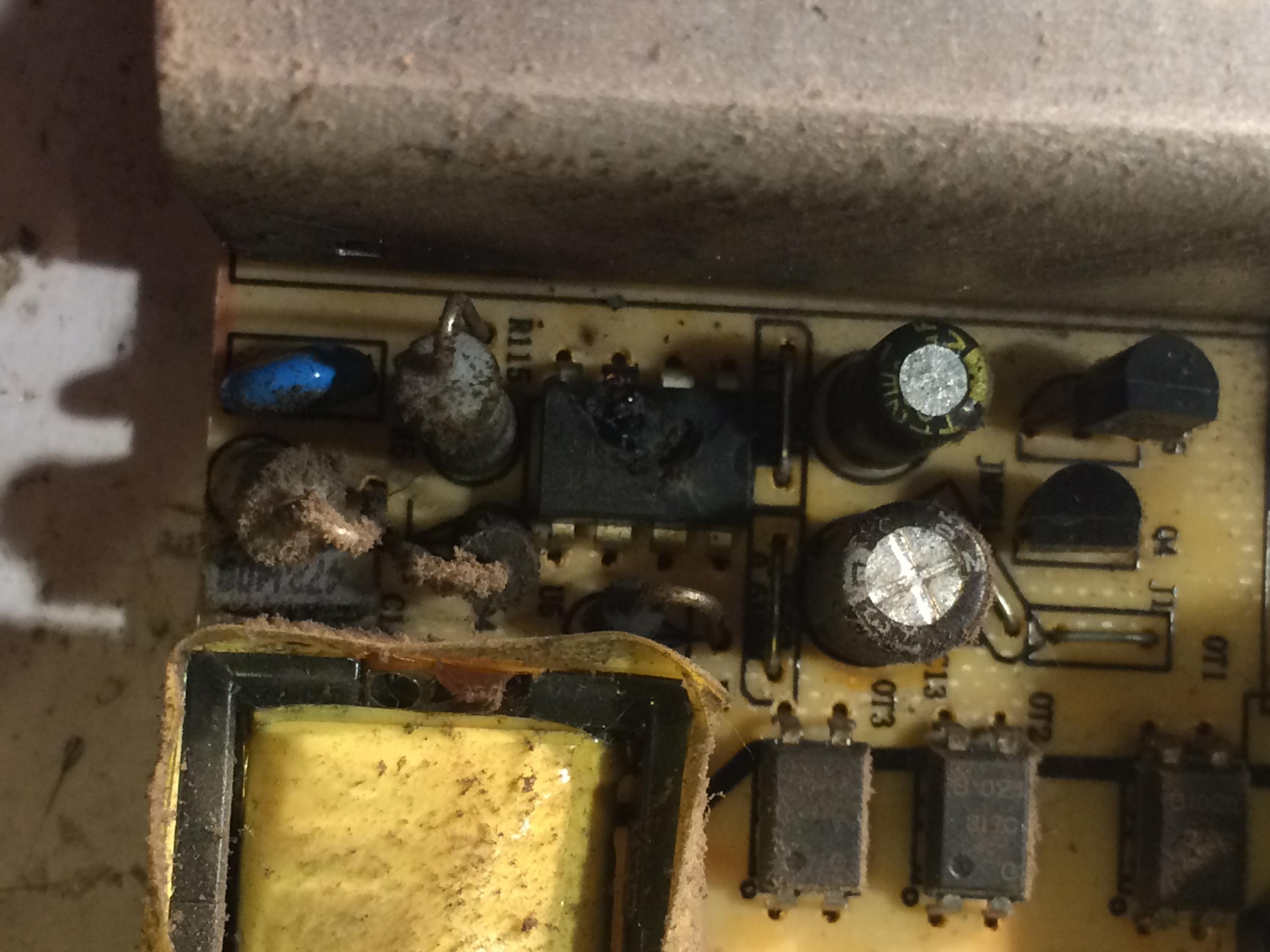

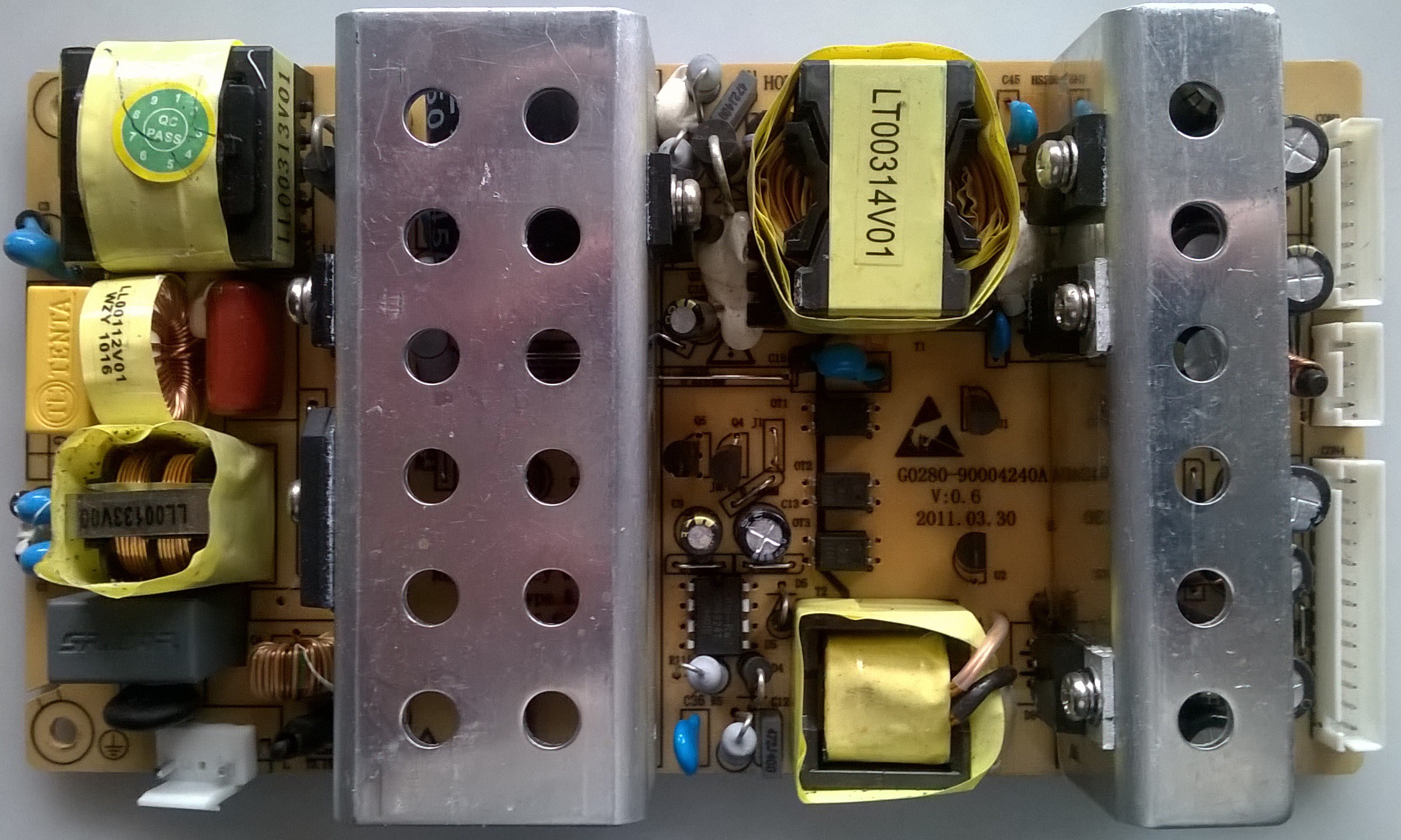

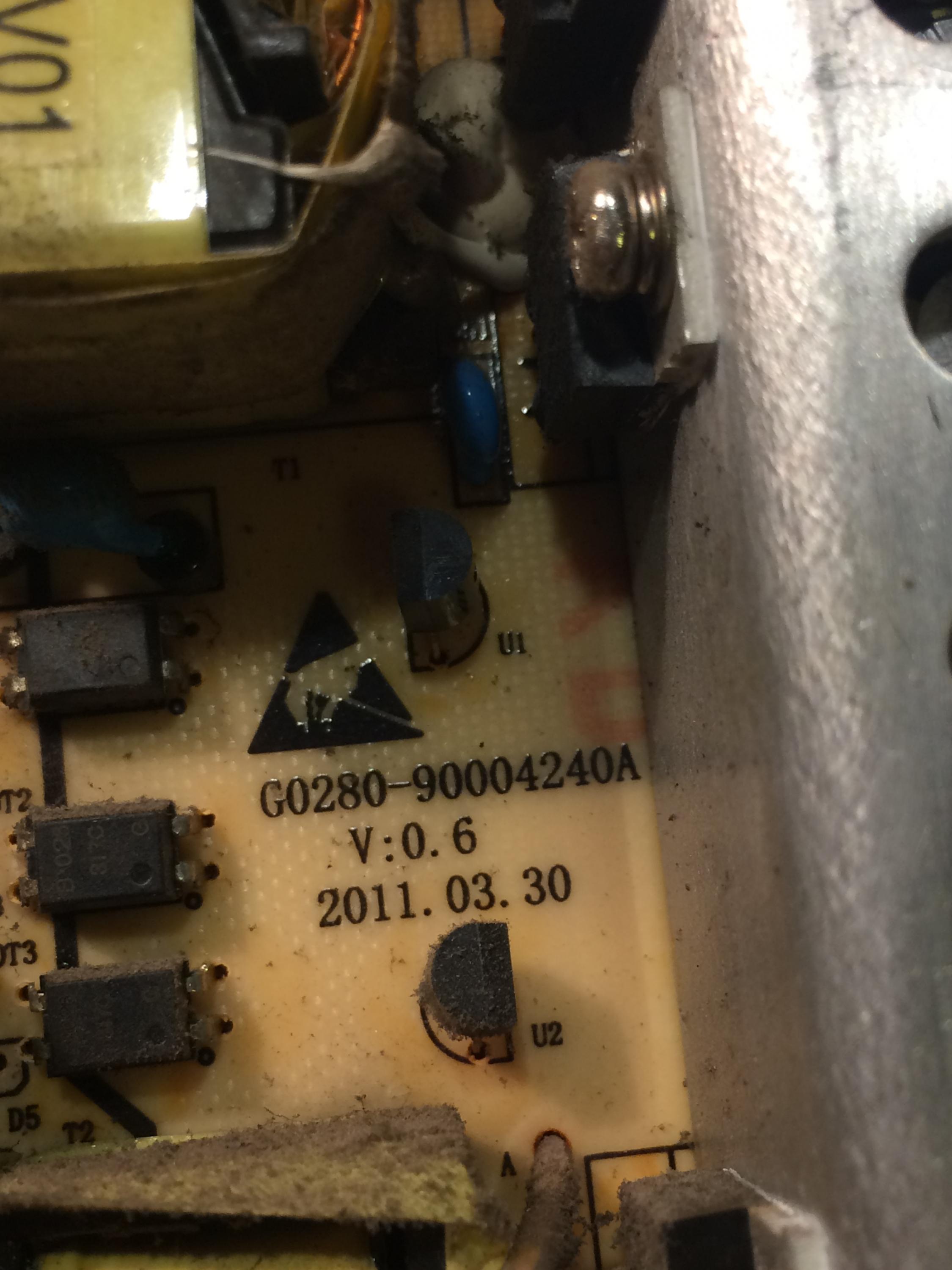

    I have a 32" BlueDiamond TV which won't power on. I removed the power board and identified a blown component but i'm unsure of the part name/number and whether or not i should test/replace anything else on the board in relation to it. I've attached pics of the board. Any help greatly appreciated

    I think it's a CR6224T

      5v stby Ic failed, its a CR6224T remove it and test all related 5vstby components for shorts or open circuits.

          Tbh it might be easier and just as cheap to replace the whole board, you can use any universal 3.3-24v output Tv psu.

            3.3, 5, 12, 24V supply--from any of those cheapo 32" Chinese crappolas will do for that!

                Just fine an Leke or Megmeet psu for 32" which has the same board mounts will work.
