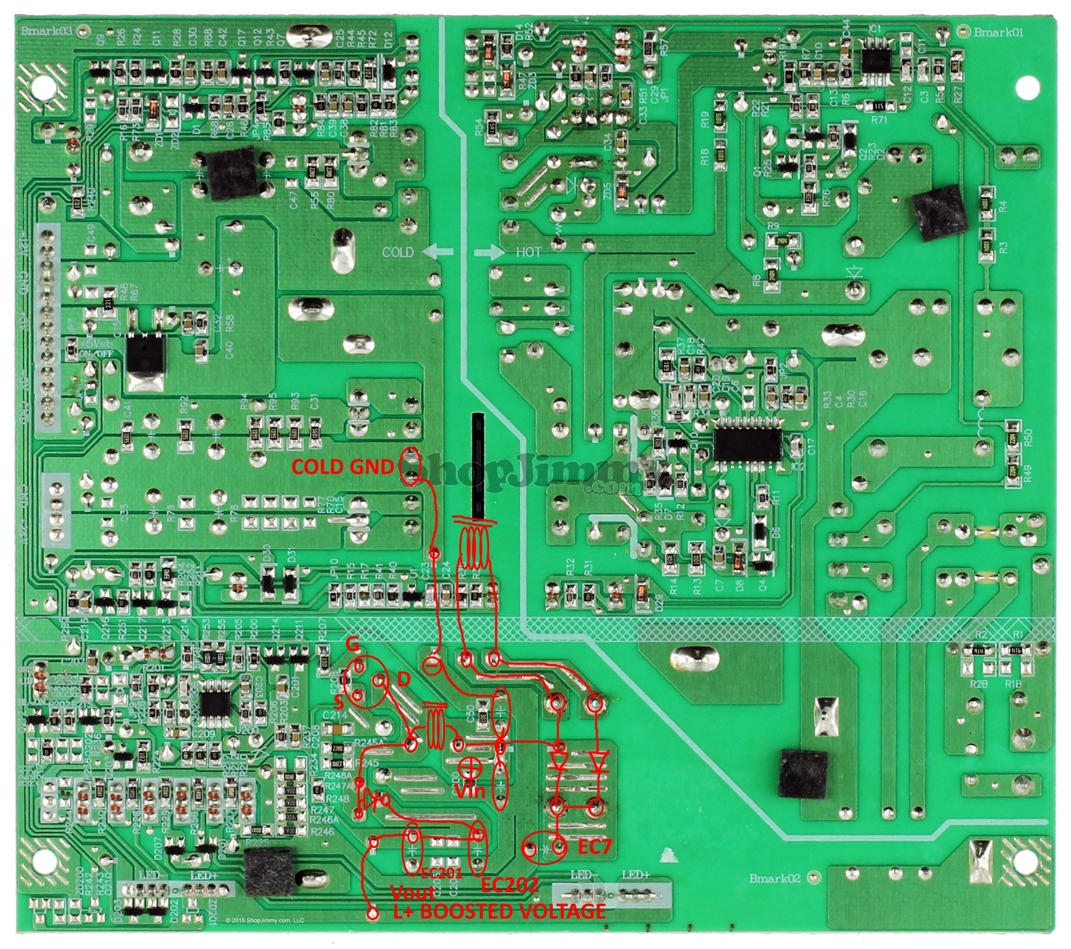

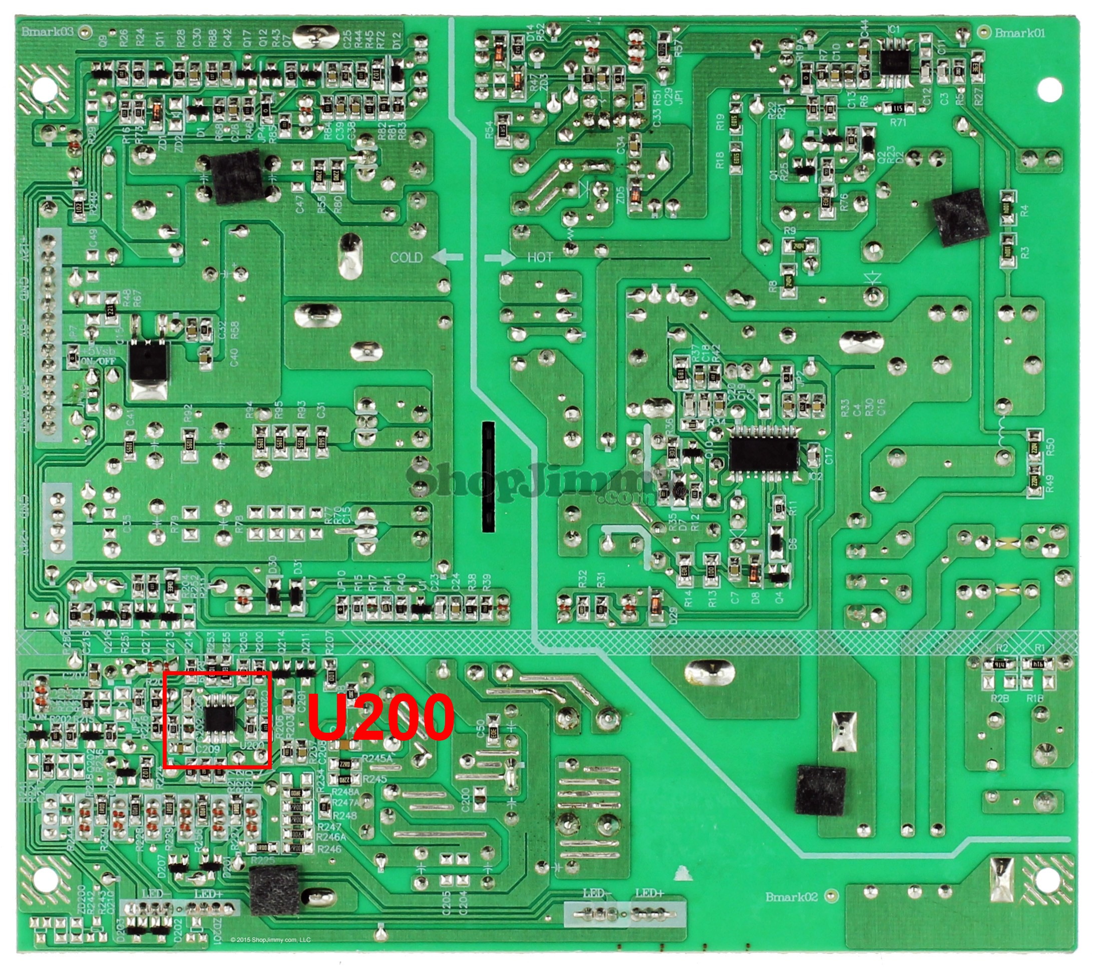

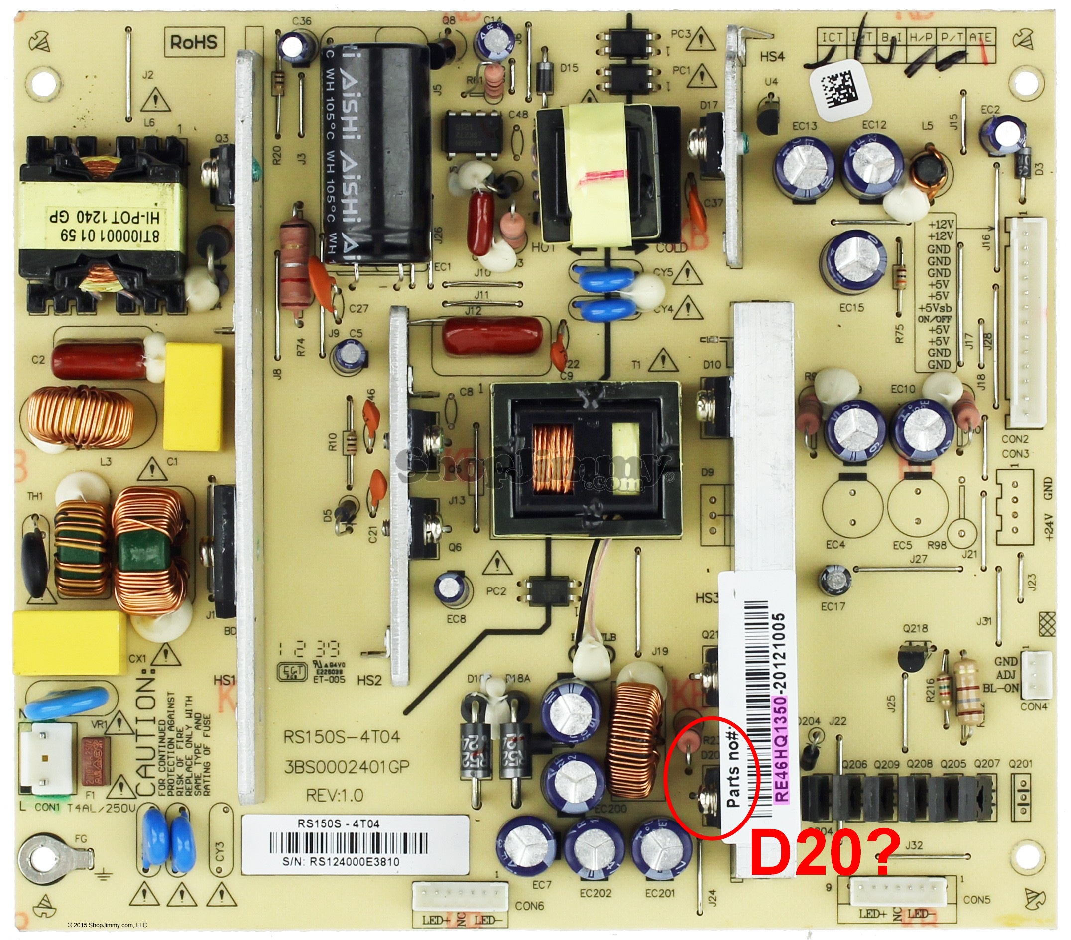

OK, what are the DCV rating of the caps EC7, EC201, EC202 by the LED connectors? Right now it looks like the L+ of 81VDC is too low.
Check the DCV between GND and the + LEG of EC7.

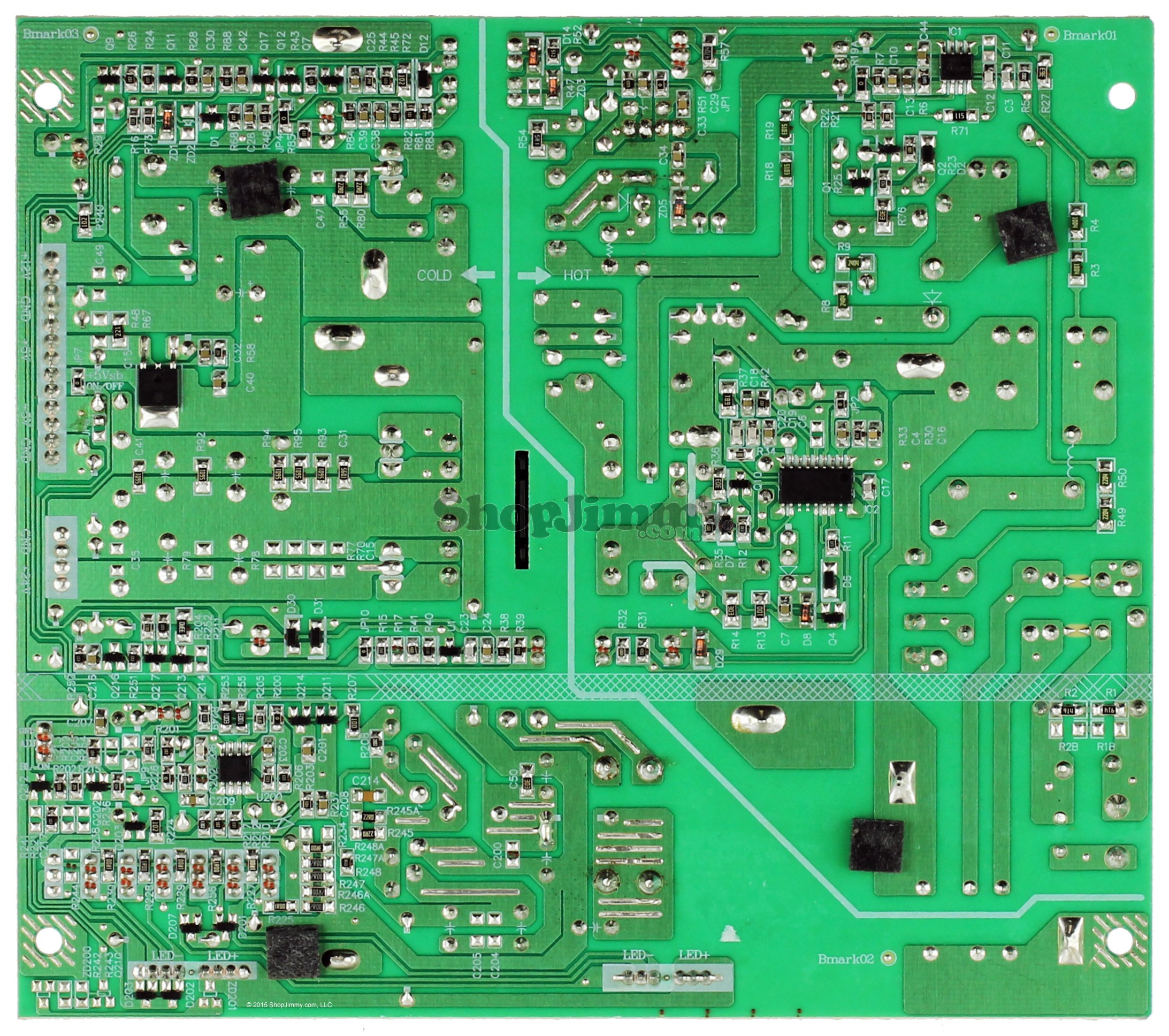

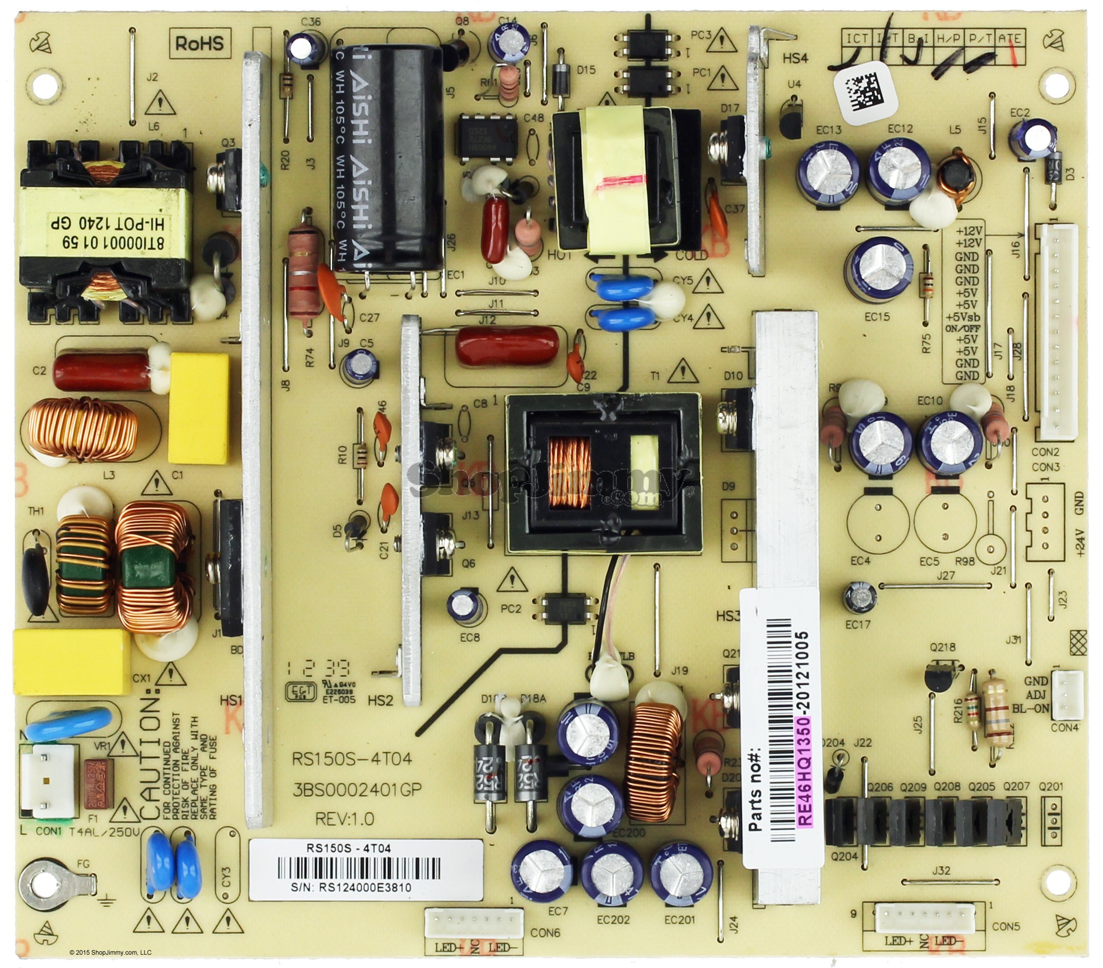

Pictures provided by shopjimmy.
RCA RE46HQ1350 Power Supply Unit.
http://www.shopjimmy.com/rca-re46hq1...pply-unit.htm#
