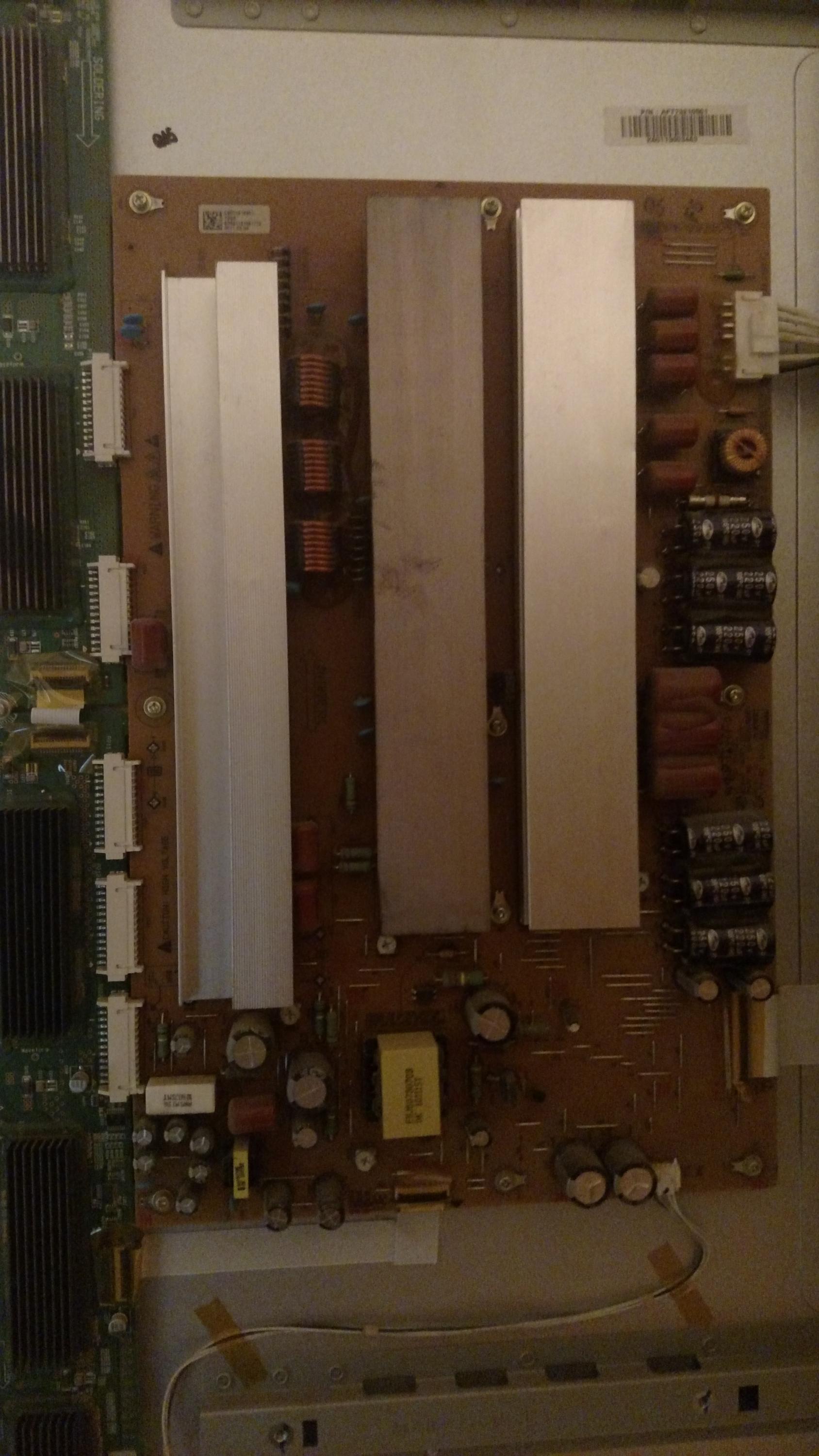

    Power supply readings
    VS - 204v
    VA - 55v
    M5V - 5.16v
    Y-SUS
    VY -180v
    VSC - 149v
    Z-SUS
    VZB - 110v

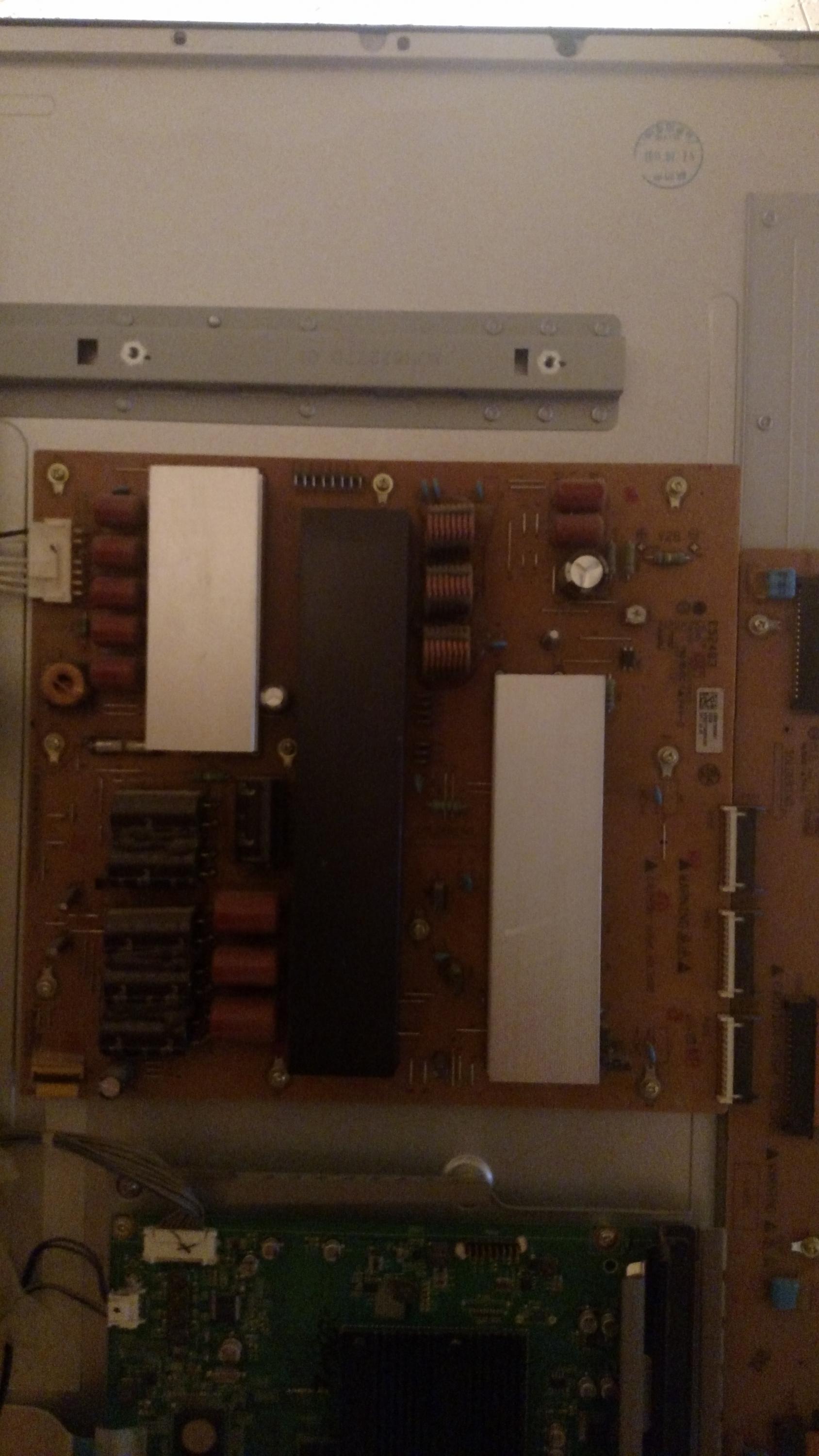

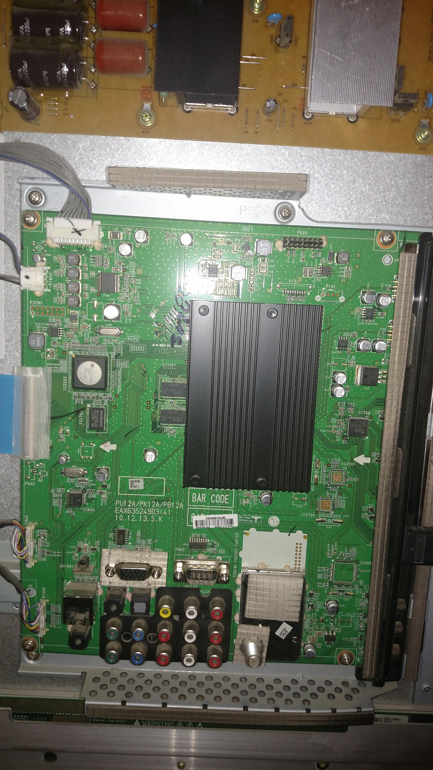

    I have disconnected the ribbon cable leading from the board containing the HDMI inputs from the board with P51 and P52 to initiate self-test. Upon doing so the TV lights up and scrolls through a series of colors and patterns.
    This is where I am at currently. My initial thought is the board containing the HDMI inputs (which i believe is the main board) is faulty. Before trying to find a replacement of this board I would like to have a greater certainty this is the problem.

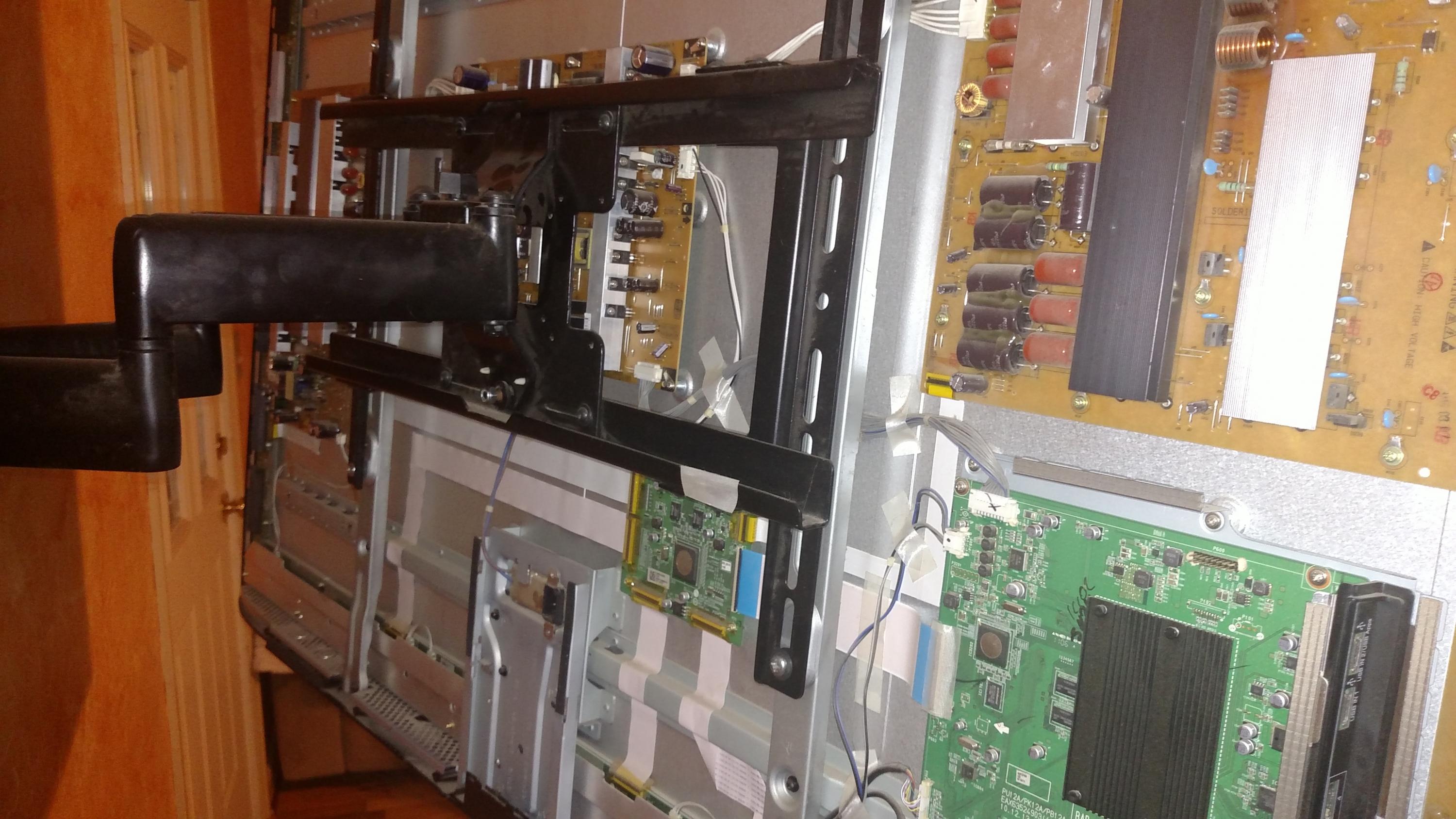

    The TV is currently hanging on a wall mount as it was the best location I could test with power, video/audio signal, and leave the TV without risking damage to the glass face. I could not photo the power supply board from this location, if needed I will pull the TV and get this photo.

          Replaced main board, problem still exists.
          Suggestions?

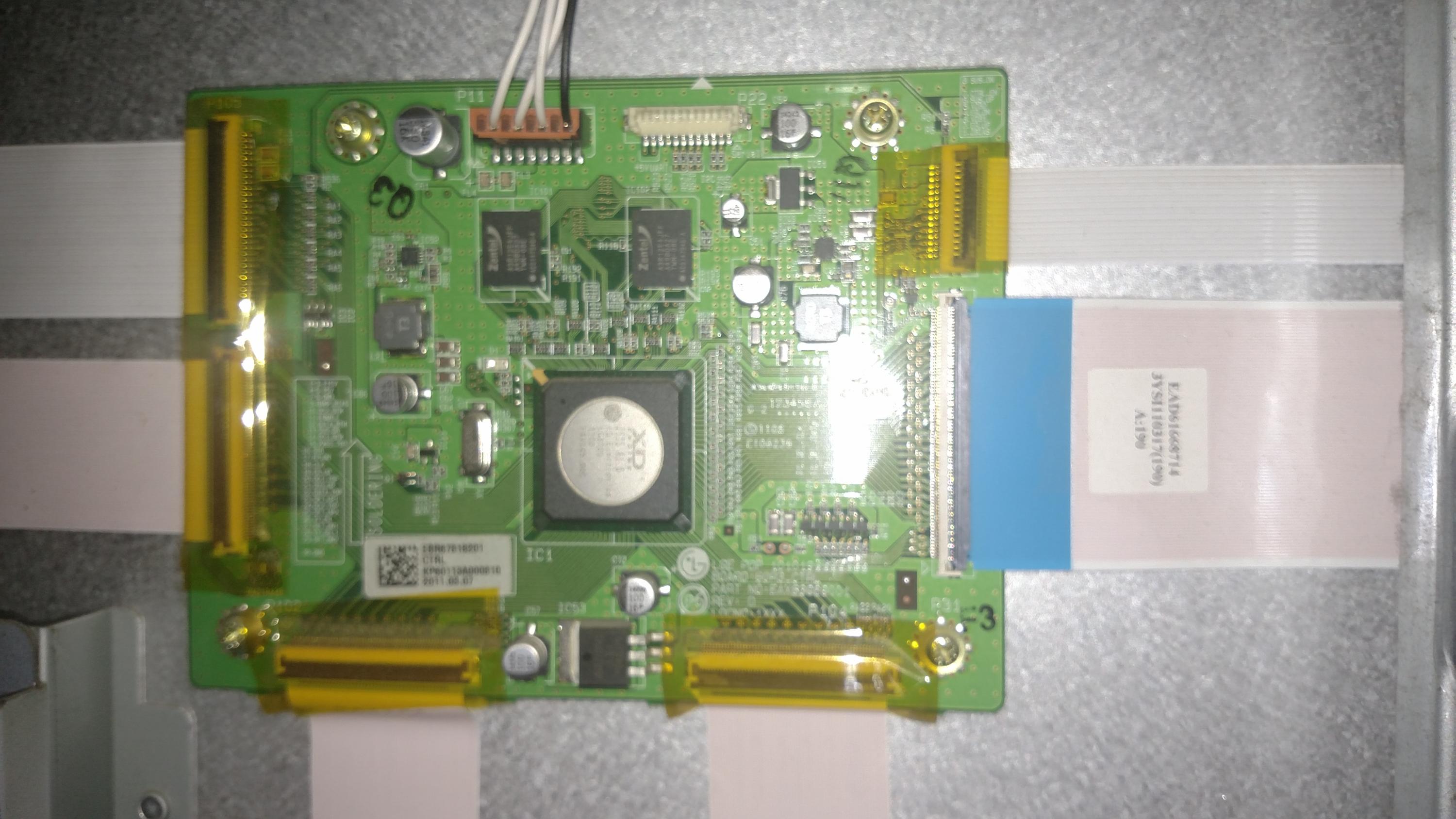

                          Could be faulty ribbon cable going from main board to logic or could be bad logic

                            I will say it again because it's solid advice especially for LG main boards... heat it up with a hair dryer focusing on the main processor. Then fire it up.

                                Yeah there is that possibility that your replacement main board could still have the same problem a little heat on the processor and around the surrounding components not going to hurt anything. Try turning the TV off heating up the processor and surrounding components including eeprom NV RAM and then powering backup. Sometimes I have found on LG main boards that no amount of heat will cause it to show a picture while the TV's been on but a quick power down and power up will bring it right back

                                    Okay, TV has the replacement board in it hit it with some heat from the hair dryer on the mainboard, turned the tv on and everything was looking good back to normal then went blank again. How much heat should I apply seems promising! Is the hair dryer fixing some bad solder joints?

                                      Send it back and get another. I know they are getting harder to find, but why pay for a crappy one? If no returns, try a reflow, out of the set. I am using a Wagner paint stripper set on LOW only(so I dont blow a bunch of parts off the board). Let us know how it turns out.

                                        The hair dryer is a diagnostic tool only and will in no way repair that fault.
