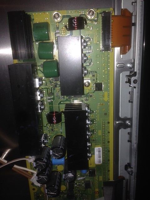

    My Panasonic TC-P54G25 manufactured Nov 2010 has worked great for several years. A few weeks ago it would turn itself off and the front power LED would blink 8 times. I would unplug/plug the system and it would come on and run for several weeks then shut off again. Now the set comes on and runs for 5 minutes before shutting off with 8 blinks. I researched the issue and most point to the SS board (my set uses the TNPA5082 board on the right side and the TNPA5081 board on the left side looking at the back of the set). The first step seems to be to make sure the flex cables are securely attached to the right SS board.
    If you have any advice or Panasonic service guides I would greatly appreciate the help. I hate to throw away the set -- it has a great picture and up until this problem has worked great.

    Could you please provide some pictures of the set? ( The boards )
    It sounds like a mainboard problem deu to overheating but pictures first!

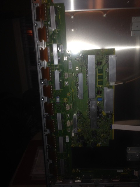

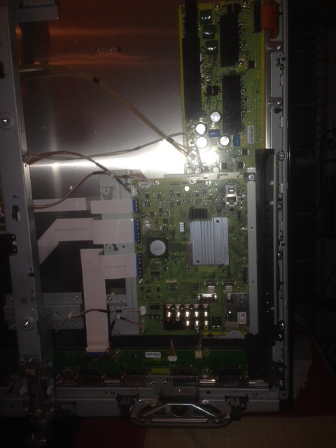

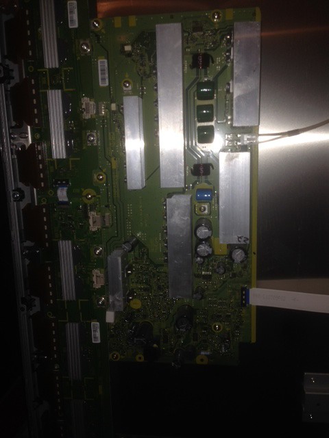

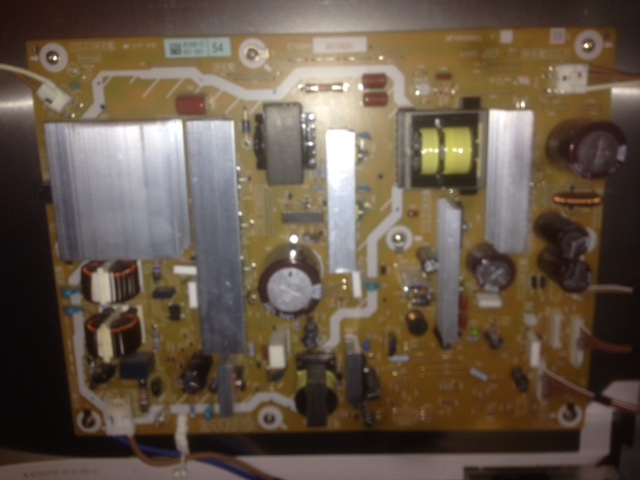

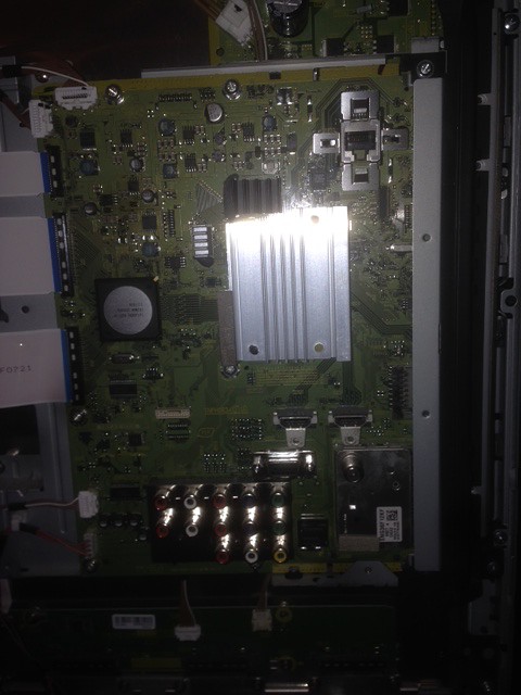

      Starting from the rear right side of the TV the images are: both SS and A board, just right SS board, just A board, power supply, left ss board and the entire left side.
      I think I have the board names (ss, a...) right but I'm not sure.
      The right ss board has the part number TNPA5082
      The A Board (has all the video connectors) part number TNPH0834
      The left side ss board part number TNPA5081
      If you need more detailed pictures of any boards let me know
      Thanks for your help

            Re: Panasonic TC-P54G25 8 blinks
            Your welcome! With a multimeter you will get some results.
            The fets and diodes are marked with Q and D on all boards.
            Q is a mosfet wich you can measure in diode mode , measure outer legs.
            D is a diode. Black prope on middle pin and red on left/right pin. In both situations a beep is usually not good.
            Also measure the prong connectors on SC and SS board in diode/beep mode. Could you also check the back of the SS board for bad solder? Maybe reflow the solder and also the ground area's ...maybe some arching happened.
                Strange symptom. I would not be surprised if this is a mainboard problem deu to overheating. ( BGA Solder problem ).
                Why do i think that? The parts on the SS / SC board / PS either work or dont work.
                I think that the CPU is overheating causing the set to shut down with a blink code. Follow the chart for 10 blinks and see what happens. If you get weird results from the tv that dont match the troubleshooting guide then i would replace the mainboard.
                Also check on all boards if the screws are tightened and all grounding is ok.
