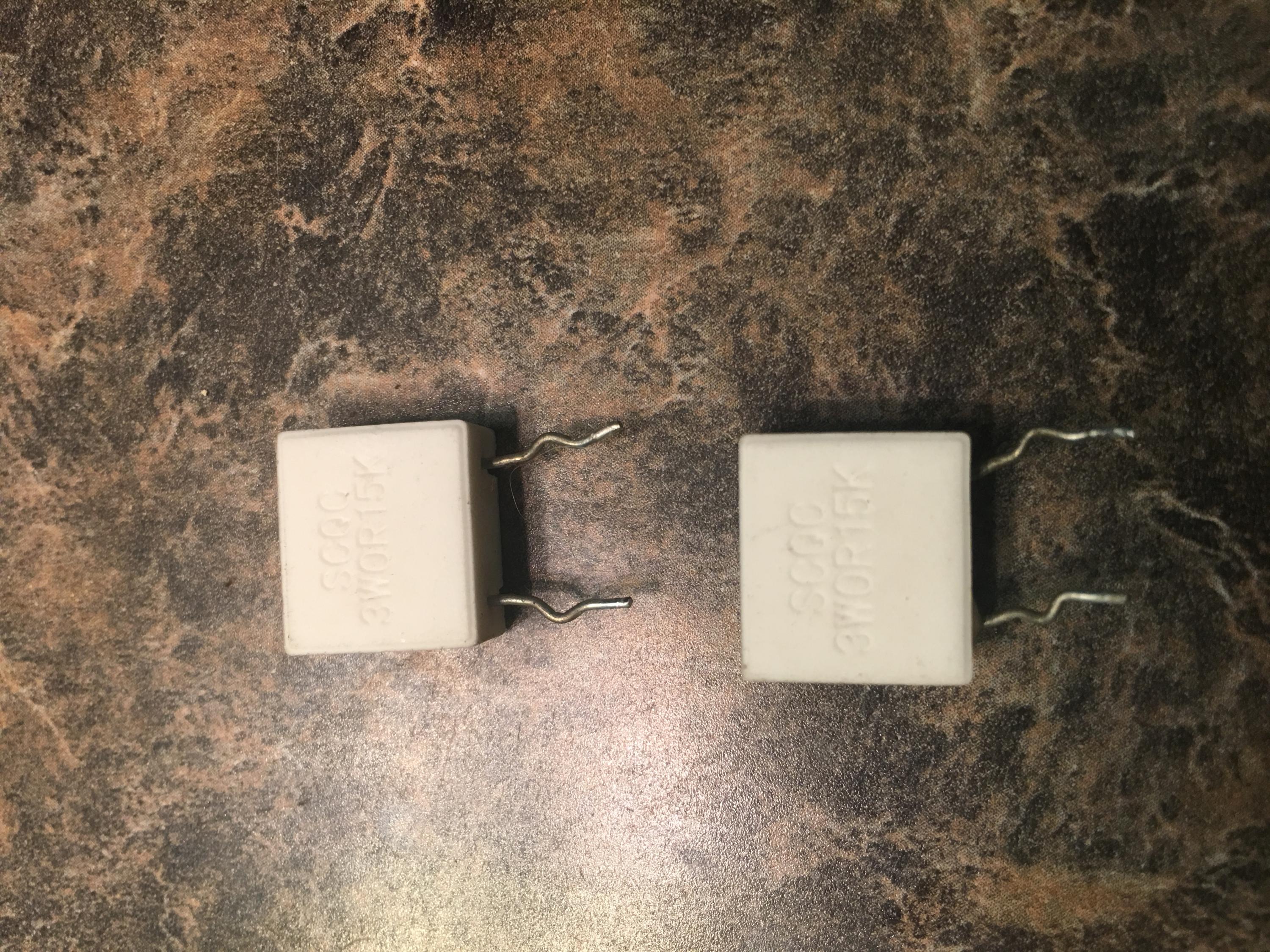

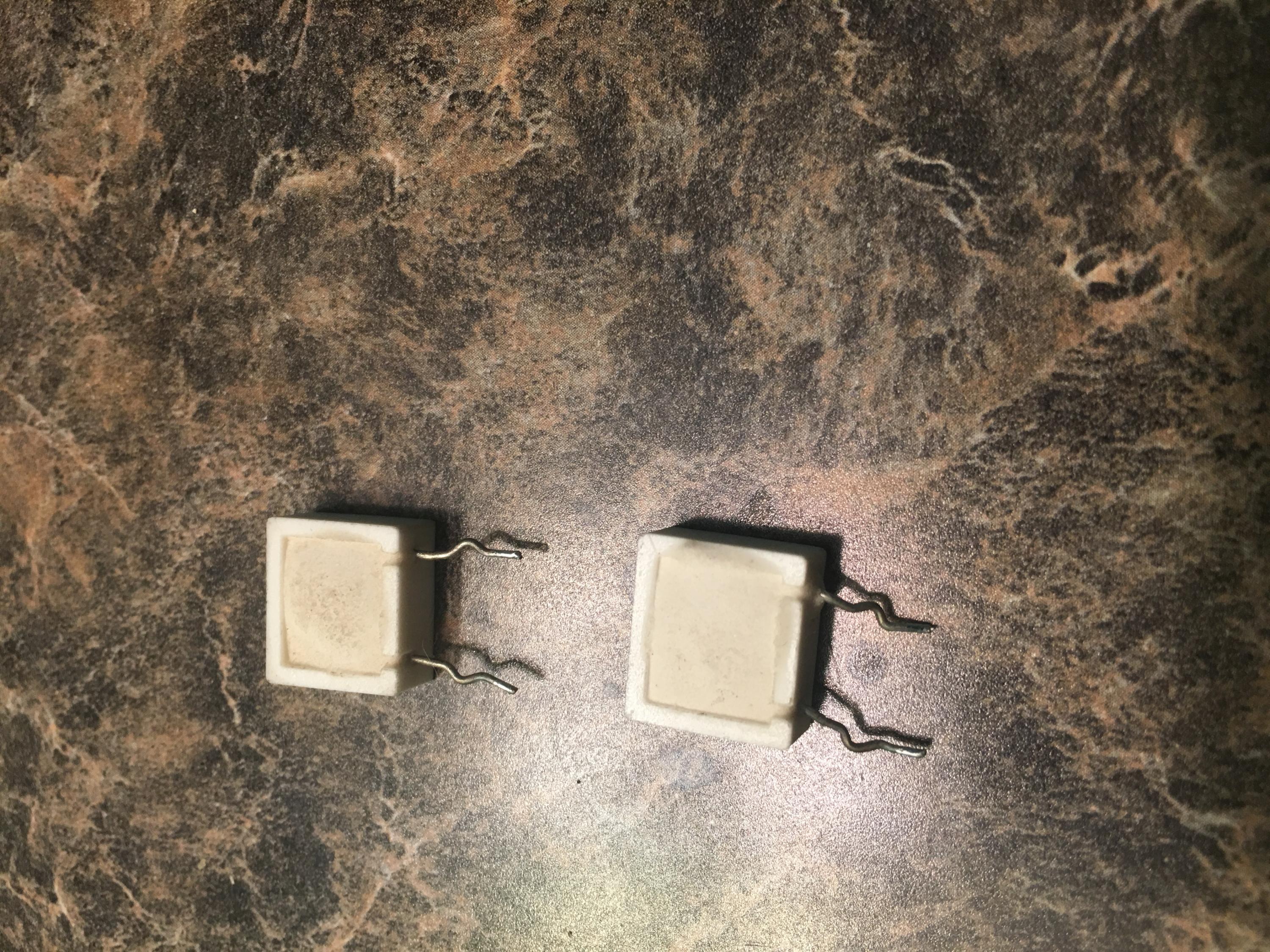

    I was doing some testing of components on the power supply board in this tv and came across 2 resistors that appear to have over heated ..
    They are marked 3W0R15K..
    Does anyone know the value of these ?
    Wondering if they are 15 ohm or 15K ohm?
    Wondering since they measure 0.2 ohms

      Re: Element ELCHW402 resistor question
      Ceramic resistors 3 watts, 0.15 ohms
        Ok replaced the resistors and blue poly cap ..
        Power supply board is working correctly ..
        Tv still won't power up ..
        If I jump the 5 volts to the standby pin all voltages are correct so the main board has problems ..
        Anyone know if any common problems with the main board ?
        Also can the main boards be repaired or once they stop working the only option is to replace them ?
