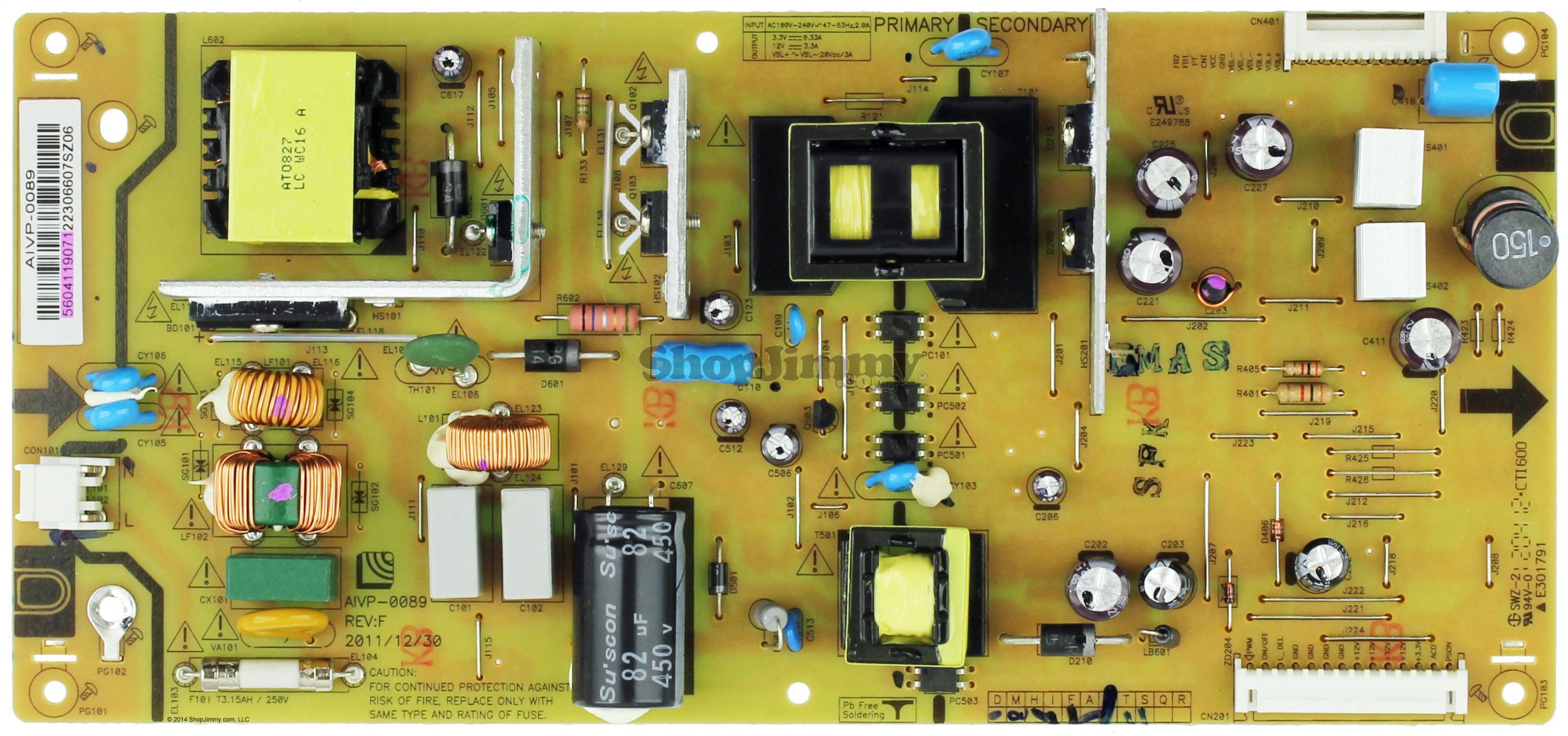

    Pic here for metal tabs on psu. http://hdtvparts.net/images/thumbs/0011676.jpeg
    On the psu in this set the plastic lock spacer was not holding the metal spring tab to the psu board tightly. Causing a fault on backlight circuit shutting it down.
    I found it by pressing on psu while backlight was on, the loose connection would cause the b/light to flicker.
    I figured wth and soldered a wire from ground plane to the metal tab to make sure it has a good connection.
    It now turns on everytime, tapping on psu has no effect on b/light and cost nothing to repair (I did add better tape to hold tabs down with).
    So basically all i need to know is where exactly im soldering the wire to im not sure what a ground plane is or where its located according to the picture linked above. Please if anyone can help me as to where i need to solder this wire to fix it so i can get back to Overwatch it would be highly appreciated.

    Can I see STRAIGHT shot picture of top and bottom side of your board?

      Re: Vizio e320ar flickering and backlight goes out for long periods of time
      its this one
      http://www.shopjimmy.com/vizio-56-04...pply-unit.htm#
      only difference is the one on shopjimmy is missing the metal spring tabs with plastic lock spacers on the secondary side

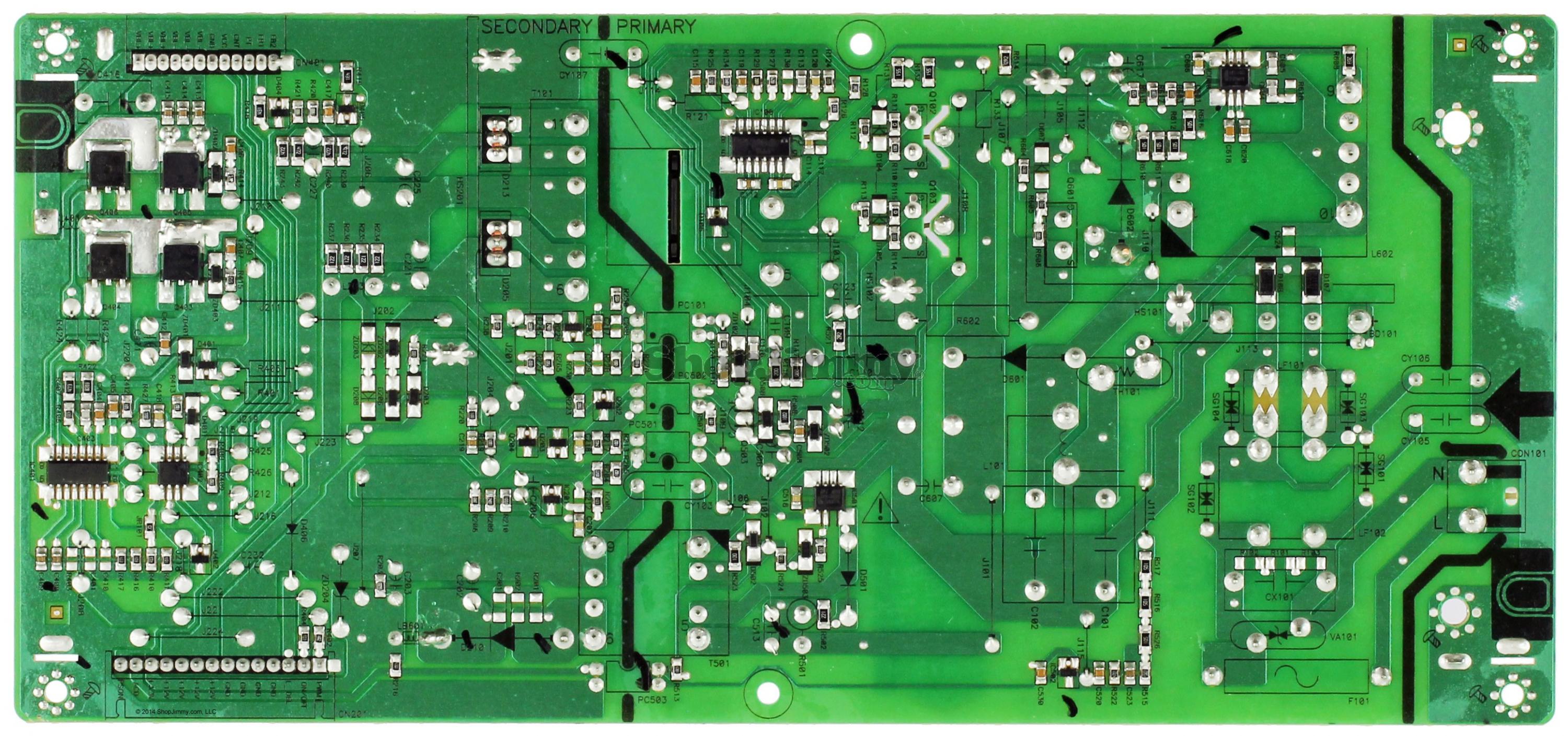

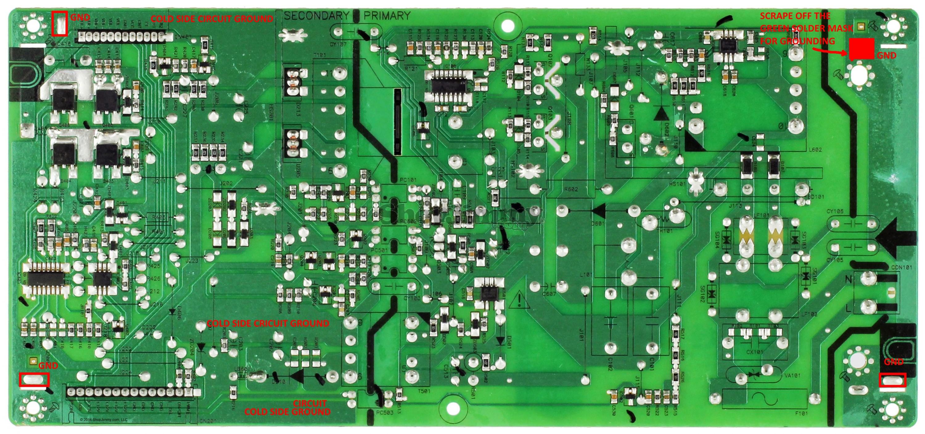

        Vizio 56.04119.071 (AIVP-0089) Power Supply Unit
        Pictures provided by shopjimmy.
        Ground those 4 'GND' points to the chassis.

          Got the tv working perfect for a month and the screen is now flickering. Small tap on top of the set fixed it. Suspect a bad connection on the board.
          I found another forum about that I need to reground the secondary part of the board to chassis. Cause the metal tabs are cheap and do not do not work well once the tape has been removed.

            soldering ground wires from the board directly to the chassis completely fixed any of the flickering or screen shutting off
