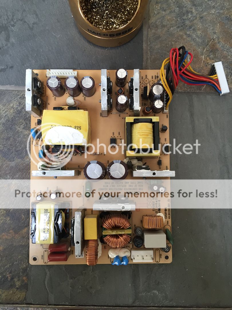

    Hello All, I have a ViewSonic Monitor with a dead power board and was wondering if anyone could tell me where to begin with this thing.
    I've diagnosed and repaired just about every other board on various TVs(all thanks to this amazing forum)but this power board is driving me crazy:
    The transformer on the right hums when plugged in, but other than that sign of life I can't seem to find any useful reading that might uncover where the issue lies. All I know for sure is there is absolutely no power getting to the main board whatsoever.
    I know my way around a meter, but please treat me like I'm naive. I've attached the service manual, it may or may not be useful. If anyone could point me in the right direction or explain how I should start to troubleshoot this board, I'd be forever grateful!

    That top right transformer is the Standby power supply, so that will be the section to get it working first.
    So did you check the rectifier diode on the cold side of that standby power supply, the MOSFET, and the SMPS IC yet?
    The bottom left the inductor for the PFC Voltage booster.
    The top left is the 12V/24V power supply.
    BTW, the schematic for the power supply does not have the designators or the value of the parts, and I am not sure if it matches your power supply board or not since this TV model uses many versions and manufacturers of the power supply.

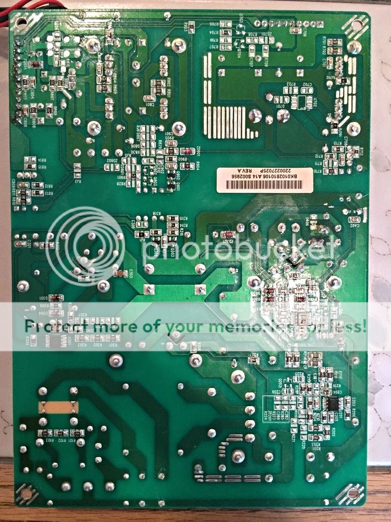

          Re: ViewSonic N2751W dead power board
          I need good straight shot pictures of the whole bottom side of the board that is clear enough for me to trace the copper traces on the board, I also need straight shot of the whole top board but a little closer because I have a hard time reading the designator of parts.
            no prob, here you go:
              Great, now I need the bottom side pictures.

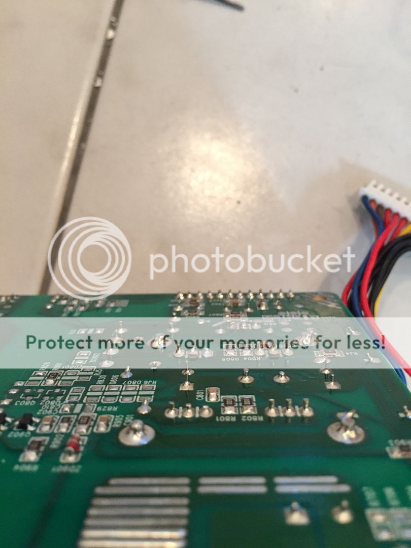

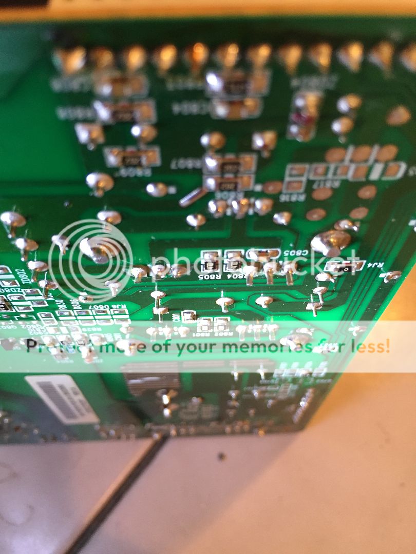

                My apologies, I guess I put the bottom side picture in as a link, should be fixed now.

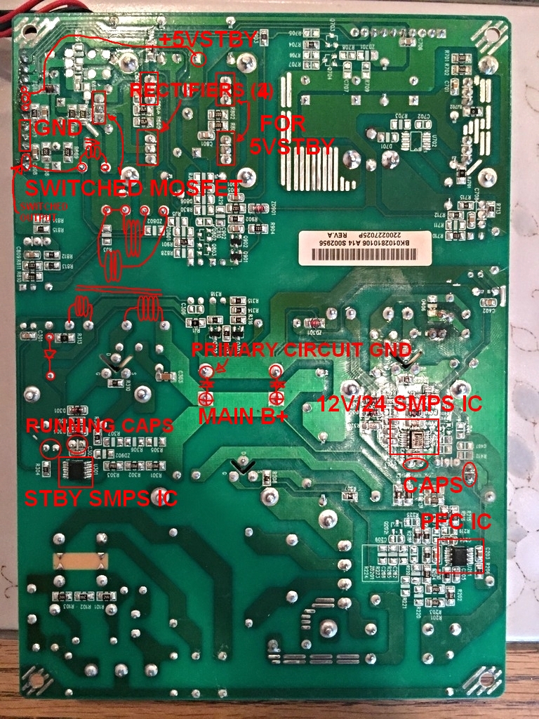

                        Check those rectifiers in that standby section.
                        Check or replace those two startup/running caps and also the other 2 caps by the PFC section.
                        BTW, check the output +5V STBY without having the board connected to other boards to see if +5V STBY is present and steady or not.
                            Those two rectifiers are for the switched output supply (it will have output at the connector when the PS-ON is present).
                            So at this point do you have the +5V Standby output Voltage on the pin I marked as +5VSTBY?
                                OK, then we need to get the P/N of the STBY SMPS IC so we can the spec sheet to check and see what DCV we have on each pin and what each pin is for.
                                    If it is the correct IC (LD7552B), then you need to see if it has VCC Voltage at pin 7 with ref. to the GND pin 1.
                                    BTW, you may also try heating up those 4 small caps I marked in the picture with hair dryer then apply the AC to see if the +5VSTBY will be present.
