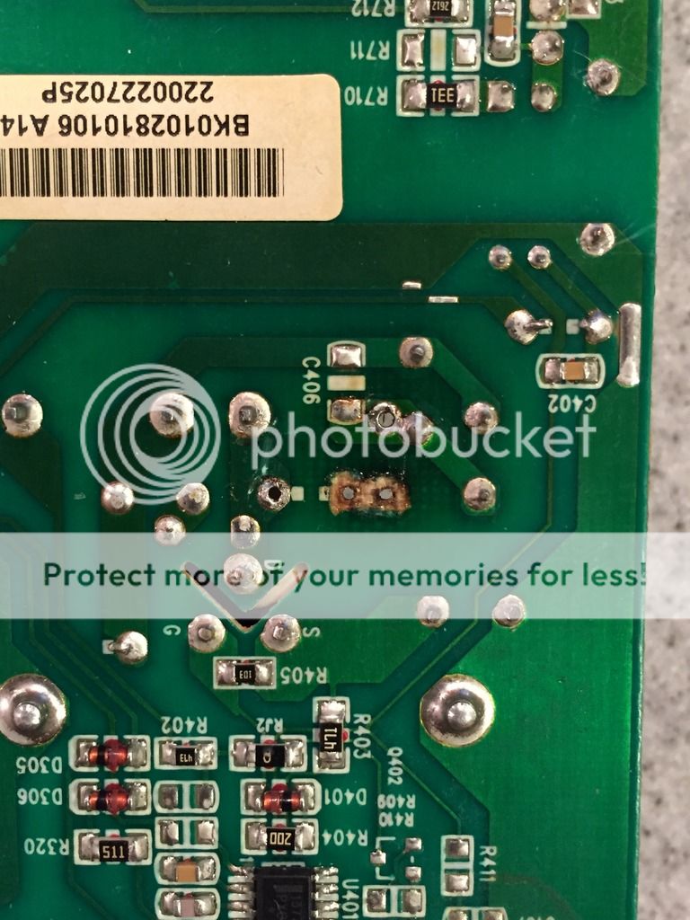

        I cannot find D402 in the pictures of post #6.

          Re: ViewSonic N2751W dead power board
          Middle of the picture left side, right above a big green resistor

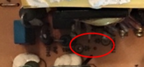

            There are two diodes connected in series to form the snubber circuit, it looks like they were getting hot by the look of the pads. Is it one of the two diodes I circled in red?
              yes it's the bigger red oval but the other end of it is directly above the circle.
              I've got a bunch of spare diodes laying around, I wonder if one of them would work? I'm assuming it'd have to be a 1 amp? I've got 1A, 1.5A, and 3A diodes ranging from 50V-1000V......

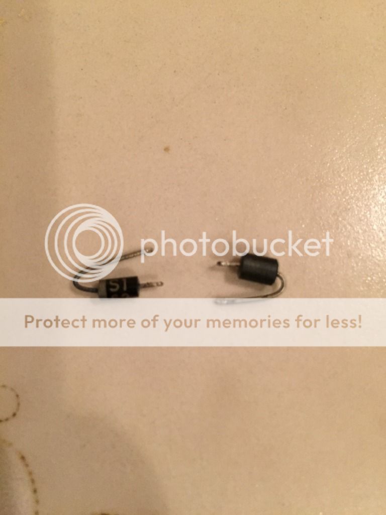

                #67
                When I removed it and the component next to it(an unmarked barrel that seems to act like a capacitor), the pad that was connecting them fell right out of the board....
                  OK, I think one of them is the diode for sure and another one is a ferrite bead with bare wire going through the middle of it. Can I see the picture of the part? Looking at this clear closed up picture it looks like it uses RCD snubber.

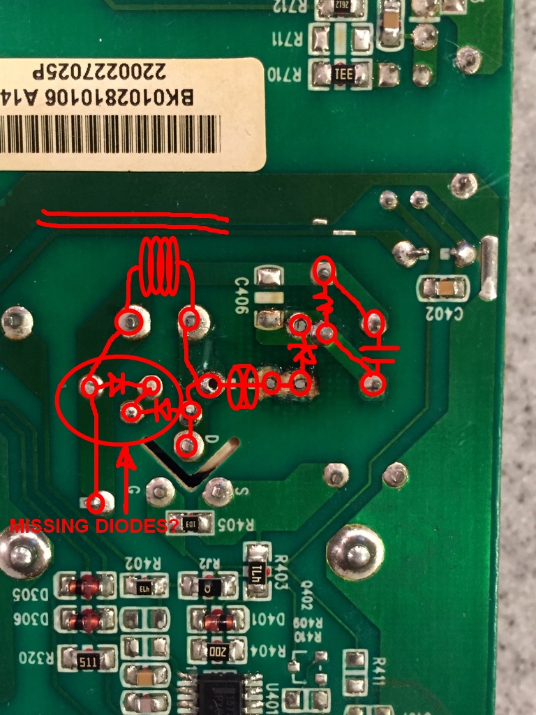

                    #69
                    Did someone else work on this board before? It looks like two diodes are missing and I can see the left over leg on the top side of the board.

                          #72
                          The board was untouched before I butchered it......

                            #73
                            I have an IN4007, would that be compatible?
                            "You can only learn so much doing simple recapping and fixes. Ideally you want a really hard one to fix where you end up with a lot of dead ends and frustration. Then, and only then, do you learn how things really work."
                            -retiredcaps
                              #74
                              1N4007 is too slow and will get hot and burnt up. The UF4007 is the fast speed version of the 1N4007.

                                #75

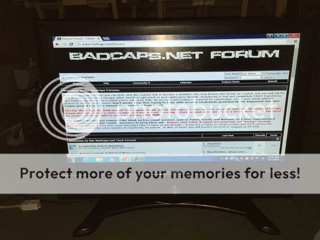

                                Since I have absolutely no patience, I threw the IN4007 on the board as a test and fired it up, only had the monitor on for about 5 minutes but it's working perfectly, I've ordered the UF4007 and will put it on the board as soon as I get it.
                                I couldn't have done it without you bud, your diagnostic and component knowledge are top notch, thank you so much!!!!
