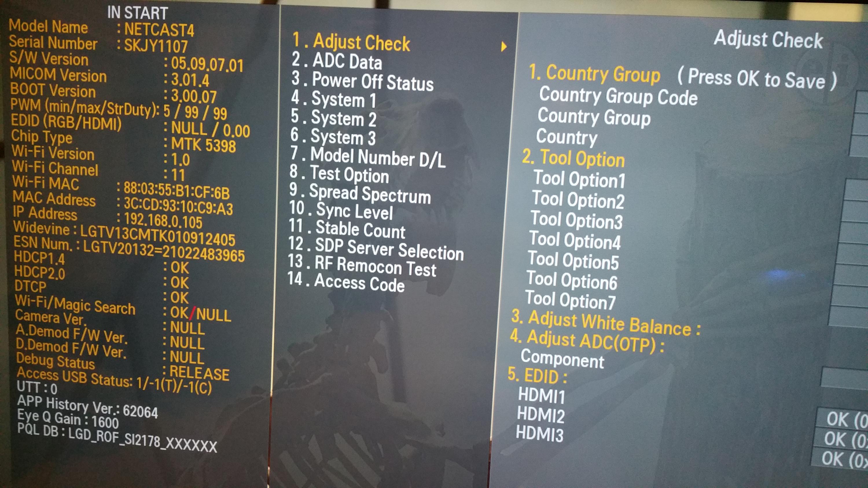

    Got into the service menu, and attached are what I found. It has "Magic Search" as Null. Can I change that?
    where would I find info on the bluetooth module, like mac address?
    • Diah
      • Feb 2013
      • 6614
      Re: LG 47LN5750 Magic Remote
      no don't change,, as it is OK
      go down to No 13 RF Remocon Test . is there bluetooth addresss firmware listed ?
      • jason123
        • Oct 2015
        • 1154
        No, all 00000000
        • Diah
          • Feb 2013
          • 6614
          then the service manual correct its dongle as the link of yous MR. will be inside the MR packing. ask the owner.

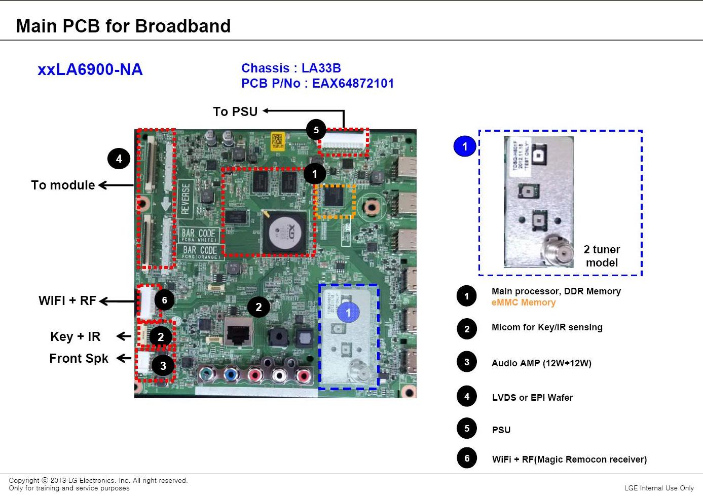

              its time now to take out the back cover and post all broads photo to trace where yours Bluetooth receiver. between the photo of your main boards label wasn't belong to yours set?
              • jason123
                • Oct 2015
                • 1154
                Ok, so what it is you want to see?? part numbers? just so that I open it once take photos and put it back together for "use"...
                The bluetooth module number is EBR76363001, a separate wifi module p/n 141812220005J. Wifi is bottom left (looking from front) and the Bluetooth is about 26 inches to the right from that. A cable goes from Wifi, a cable goes to bluetooth, then a common connector from both of those cable (shared connector) connect to the main board.
                • Diah
                  • Feb 2013
                  • 6614
                  well , you need to see and compare yours MB and EAX of it. this one the chassis LA33B as yours but the EAX different and it had micom , remember when i asked you to check RF Remocon Test you said it was all 0000 ... do we keep believe owner or TV never opened it back cover LOL

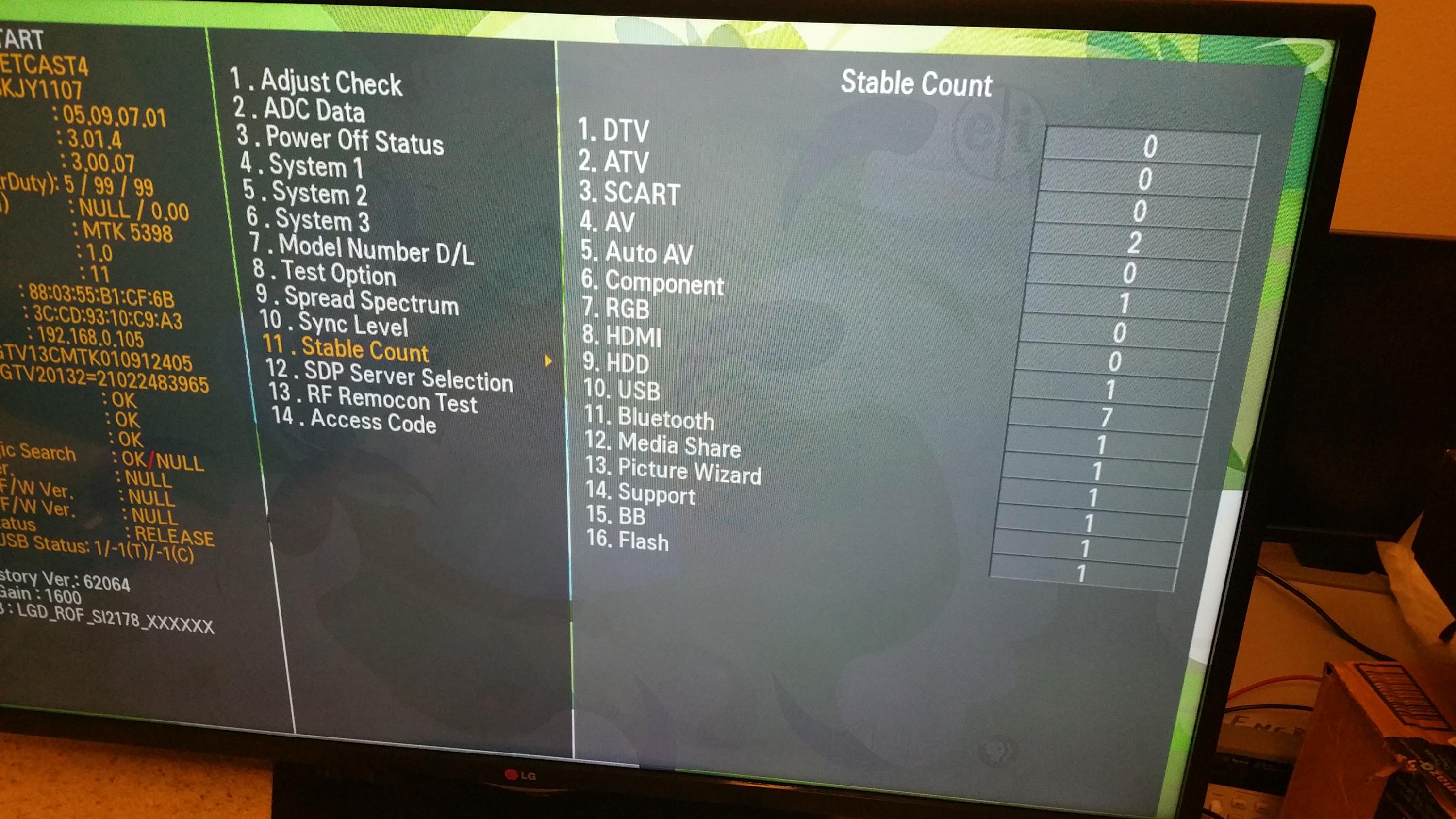

                                I agree with you on IR and Bluetooth part. I believe IR is working but Bluetooth is not since I can operate everything with the Logitech Harmony remote. I could even get into Service Menu using the Harmony remote.
                                I am going to upload what I noticed in the service menu regarding the RF module.
                                I reopened the set again just to check the RF module and its there plugged in properly. Checked for the voltage also as mentioned in the service manual. Everything looks fine. The board I bought has the same markings and version number as the board I replaced it with. Tested with the original remote that came with the TV and no luck.
