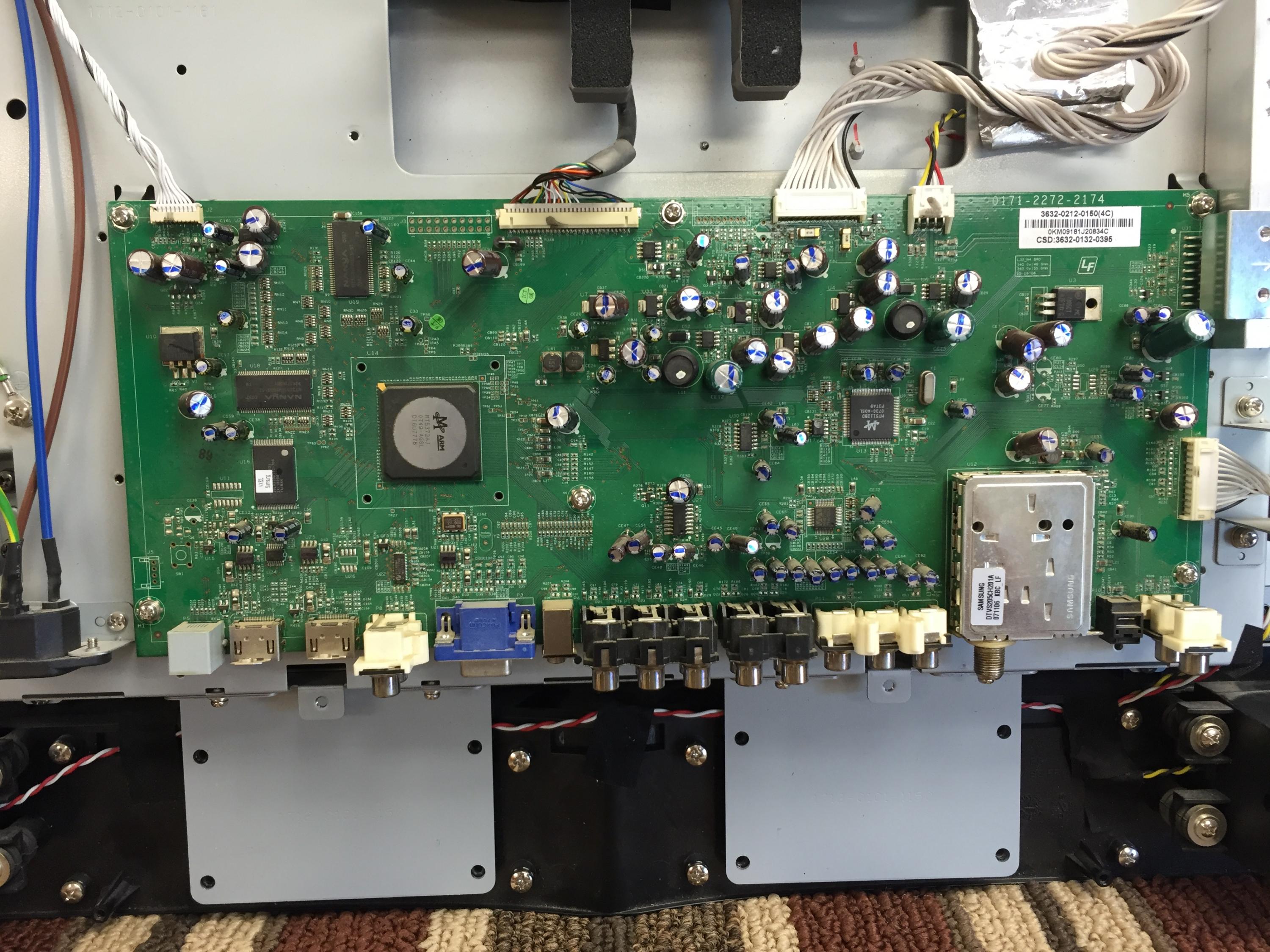

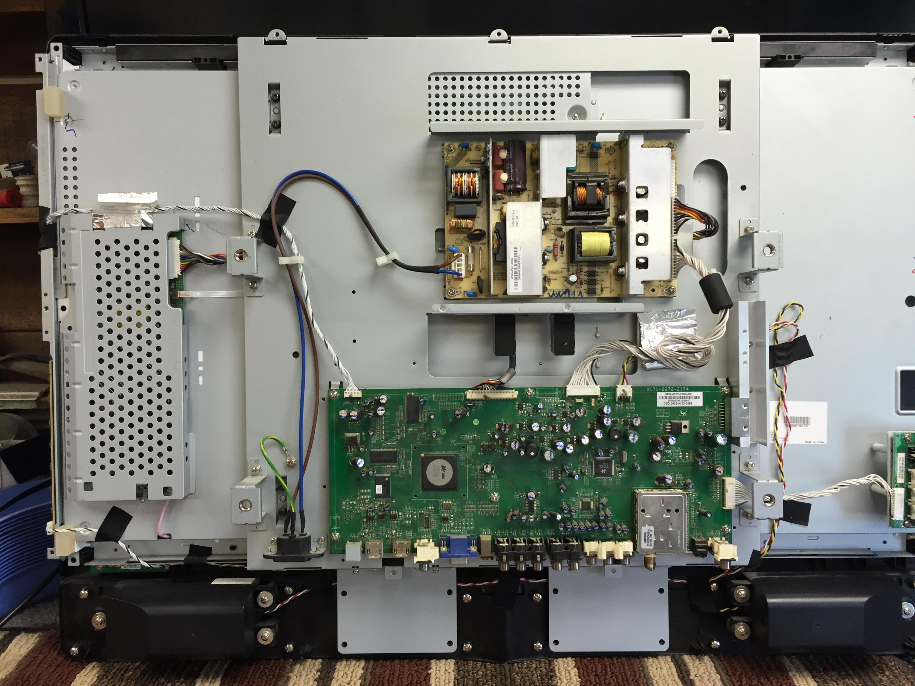

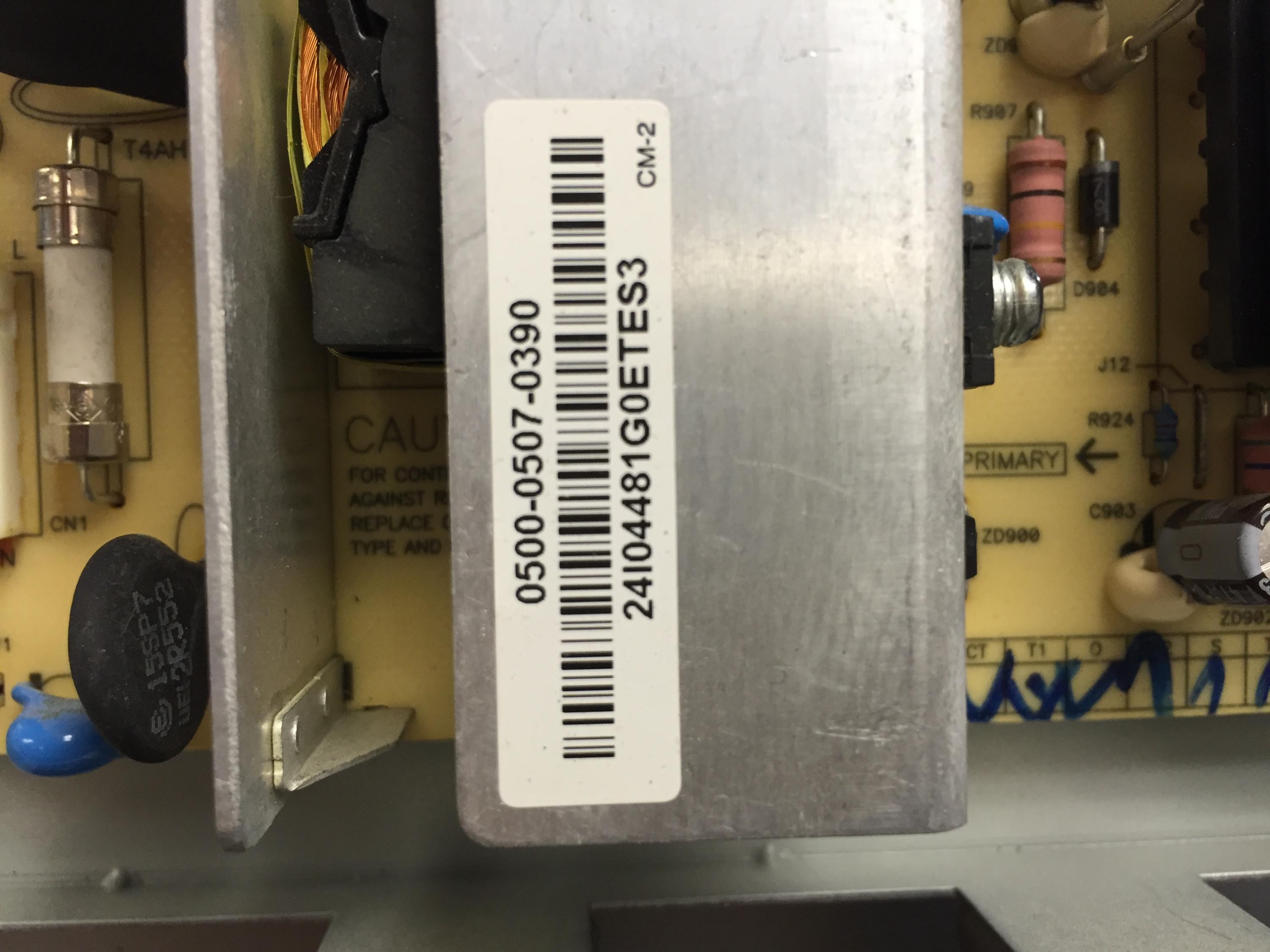

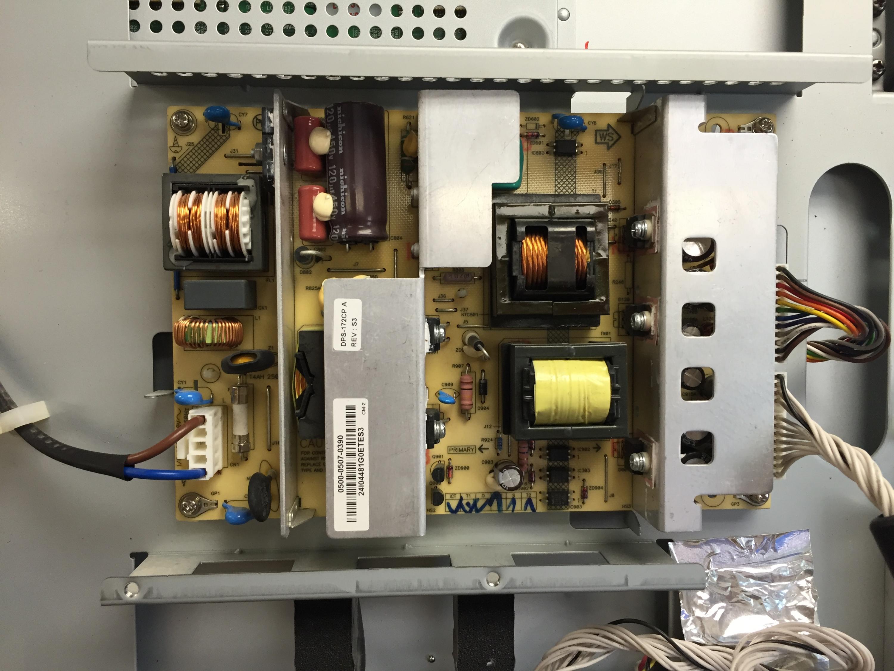

    Vizio VX32 HDTV10a powers on/backlight/no picture...powers off in 30 seconds. Can power right back on w/switch but shuts down again.
    Disconnected inverter board...same shut down
    Standby and 12v all OK
    Changed out power and main board...same problem...
    What am I missing?

    Pictures of the whole backside of the TV so we can see what we are dealing with?

      Will get photos...disconnected tcon harness...still shuts off after about 30 sec. Failed after a lightning storm/voltage spike

                      BTW, you indicated that you do have 12VDC, you mean the 12VDC is present at both end of the SMD fuse for the 12V supply on the main board, right?

                          There are two white fuses with gold ends right by the main board connector that goes to the power supply board, one fuse should have 5V, another one should have the switched 12V.
