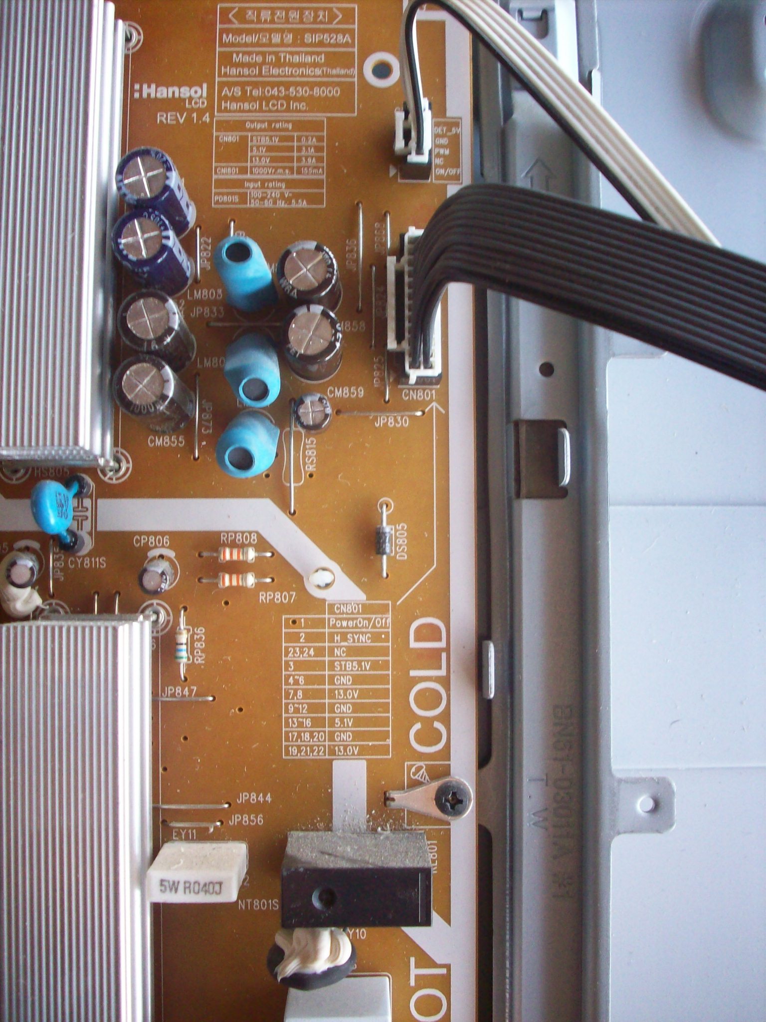

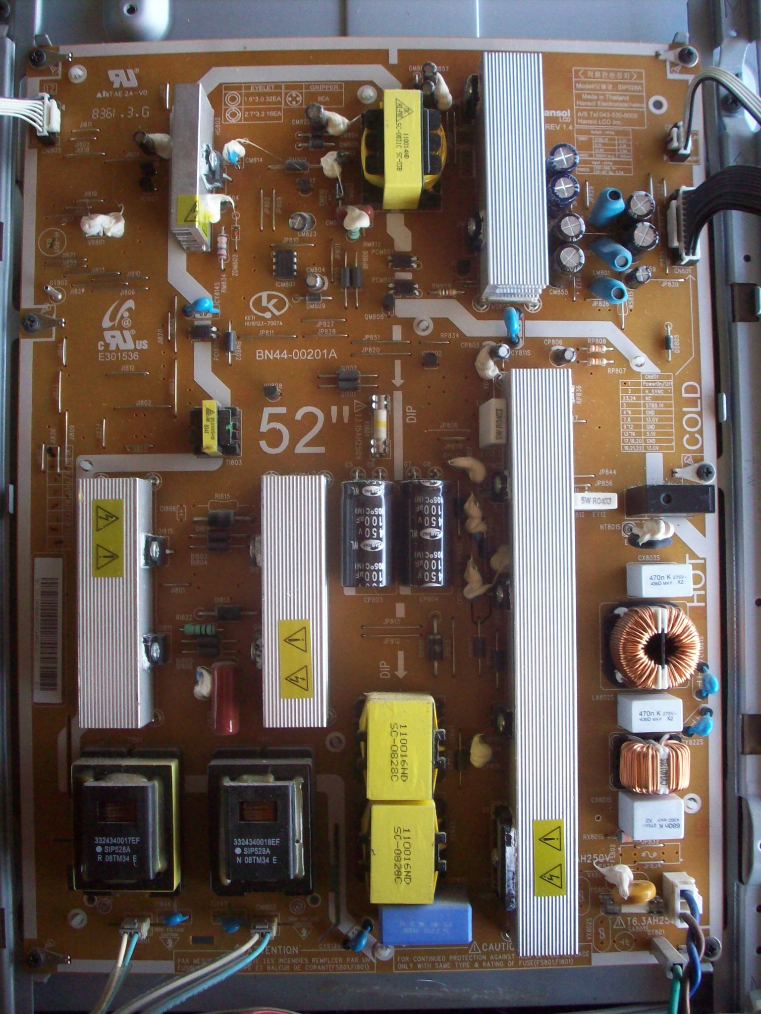

            Could we see clear pics of the Pwr Bd, please...especially the connector that goes to the Main Bd. i.e. to determine which pins are Stby 5V and etc?

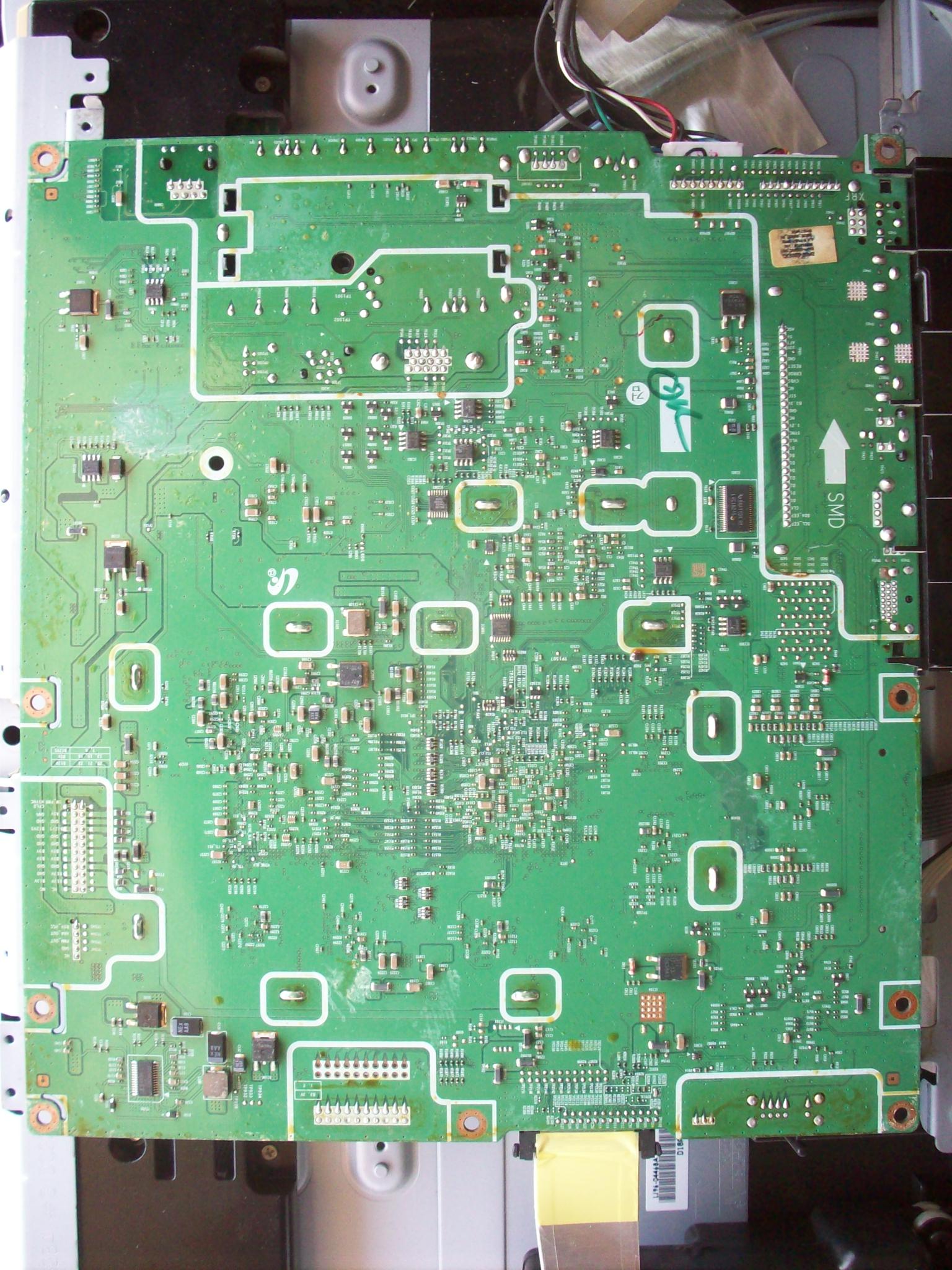

              Post a high res, straight shot picture of the back of the main board.
              • LITEZONER
                GO BOLTS!
                • Mar 2010
                • 223
                Re: samsung ln52a750r1fxza red light blinks
                so i get the 5.1V on pin 3 no other voltage is present, i have not tried holding down the spot that makes the relay click and measure the voltages, included is a picture of the back of the main board as well. Thank you

                  try to turn the TV on and measure the DC V on all the pins on the PSU connectors CN801 and CN803.
                  Post the pin out name with the voltage measured.

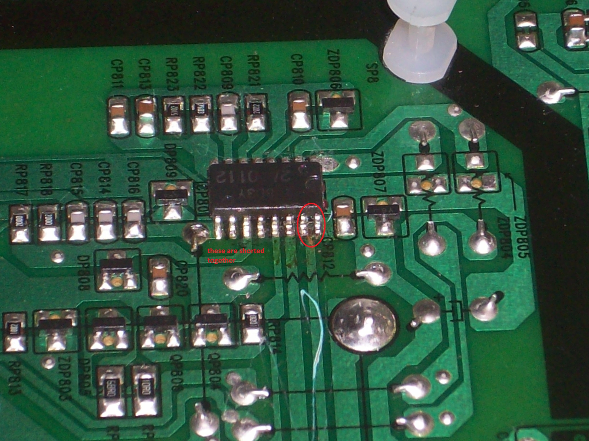

                    Okay so here is what i found so far, based on the relay clicking in i was led to think of a cracked solder joint or loose one, re worked a few suspicious welds, found big blob of solder crossing the pins in the picture, got out my wick and cleaned it up, Put board back in, blew fuse. URG! so back to the bench under magnification, i noticed a jumper that I think is suppose to be there but it was missing, so i checked over all the welds on the cold side and soldered in a Jumper in that position in the picture, Put board back in Blew Fuse. URG! Again.
                      if the fuse blows instantly, you got something shorted on the primary.
                      I see you circled something on the first picture, but I cant read it. I don't think there should be a jumper there. What is the P/N on the IC? Check all the devices installed on the long heat sink.

                          IC part is on the Hot side and number is 2A20112 the only thing i can think of is i shorted it when removing the big blob of solder from it that was shorting across three of it's pins, but it wasn't blowing the main fuse before . SIGH.....
                            this is the location on the IC where there was a big blob of solder i removed most of it and that's when the fuse started blowing, the two pins circled are still shorted together, I was given this set to repair two others in hopes of getting this one repaired to use for a while, it appears it has been worked on at least once and it pretty toasty, meaning that when i slightly move a component you can hear the solder cracking, maybe time for a fresh board???
                                thank you for all you help, I know when i am in over my head and now that i have a serious short i am near drowning, I'm opting for a replacement board, sucks, but thats how it goes, sometimes you win and sometimes you loose. thanks again to everybody.
                                  My guess is that you shot that PFC IC, maybe the gate drive circuit and some Mosfets. Pin 16 of that IC was VCC for the PFC IC. Pin 15 is the Master Mosfet drive terminal. So yep... shouldn't have soldered that bridge to those 2 pins.

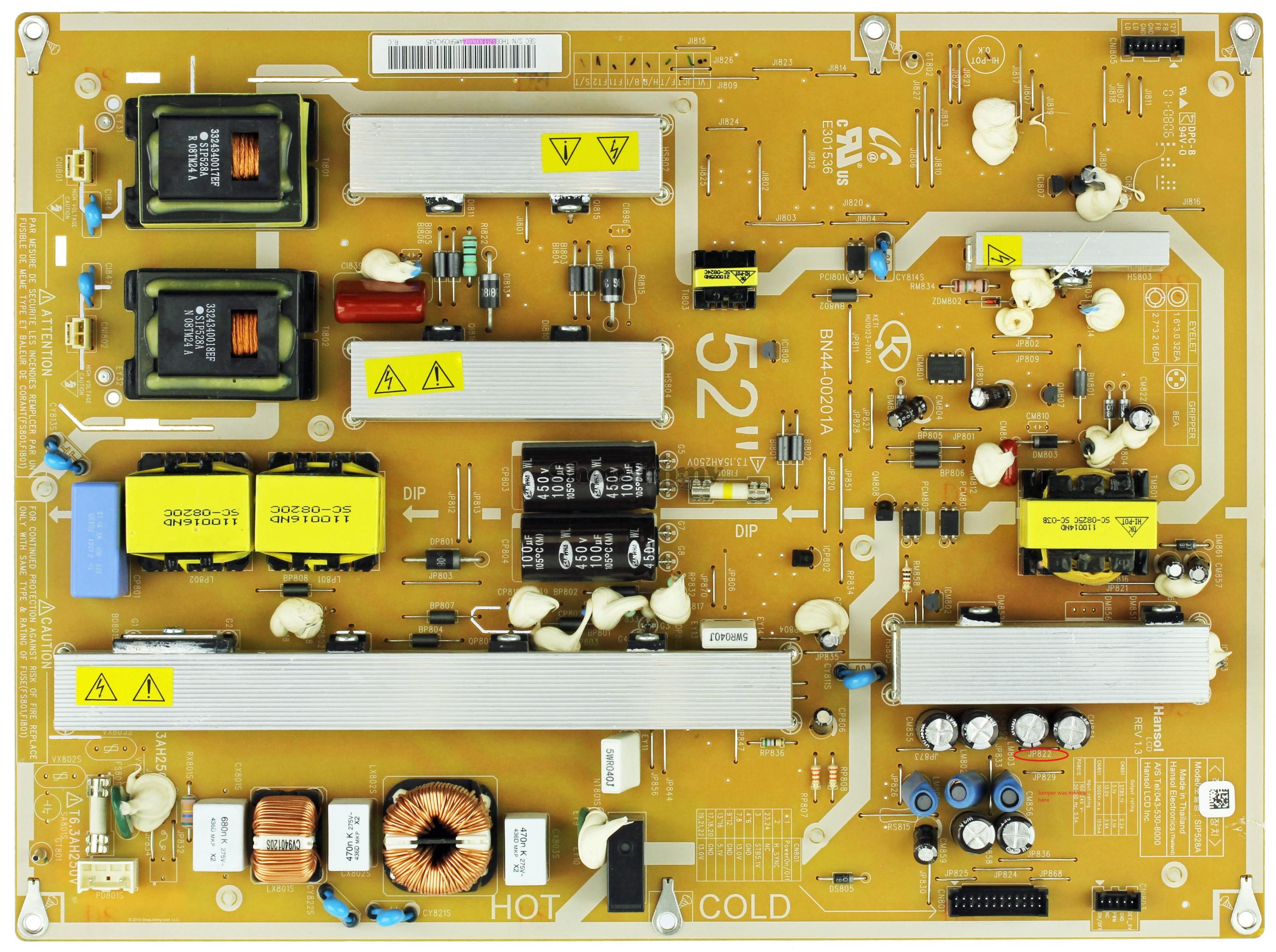

                                    do you guys know if the power supply's are interchangeable on these is has the BN44-00201A I am looking at the BN44-00202A they look nearly the same? Thanks
                                    39 Soldering Iron burns And Counting
                                      Shojimmy does not list any sub for the 201A.
