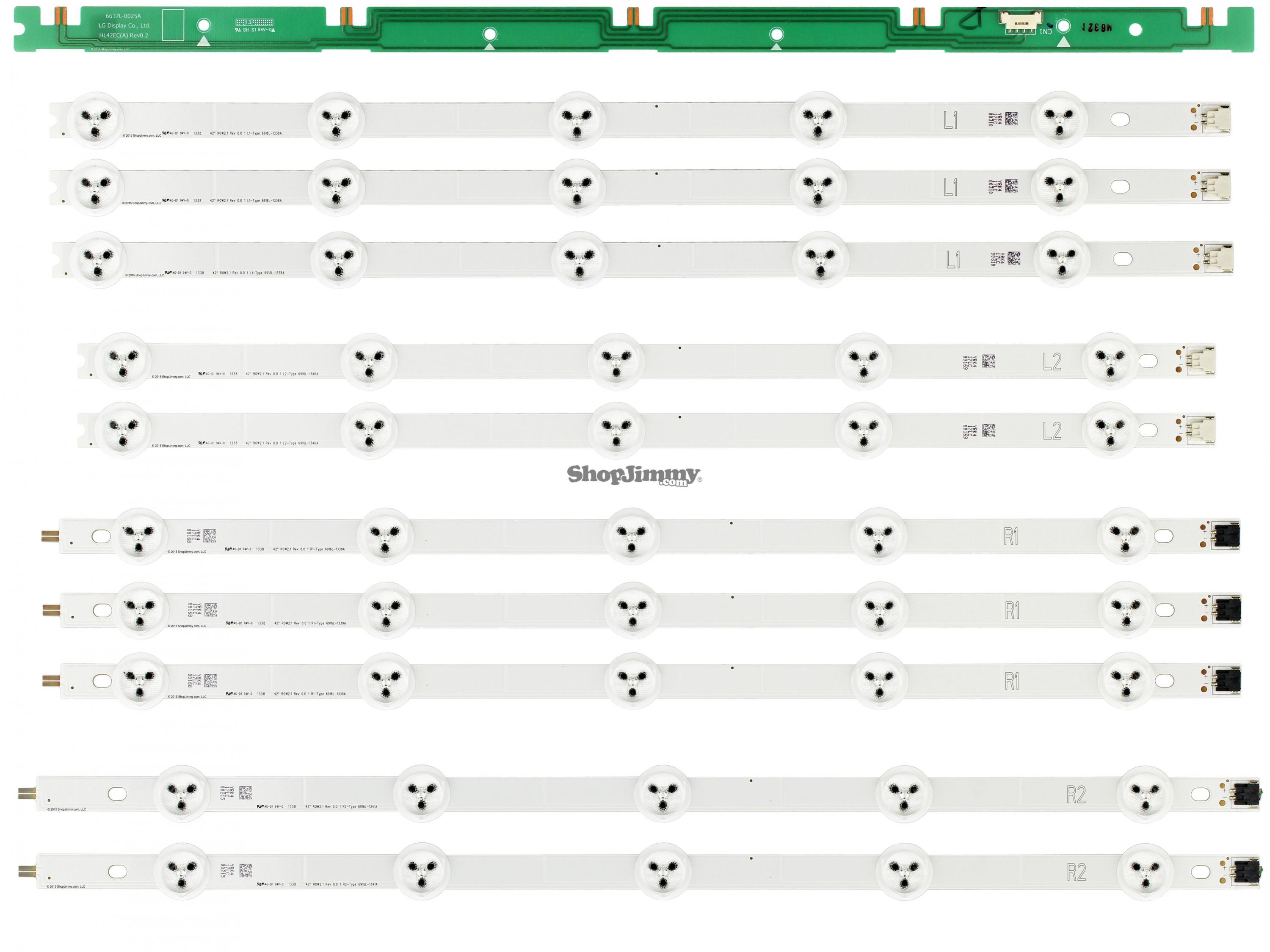

                          found some bad strips, cannot seem to find replacements in stock anywhere, any suggestions? Thank you Panel is LC420DUG JFR1

                            Do you want to replace the strips as a whole or just the bad LEDs on the strips?

                              not real familiar with SMD soldering and do not have the right equipment, so probably all the strips, thought about finding somewhere to send it out for replacement of the bad one's because i cannot locate the strips.

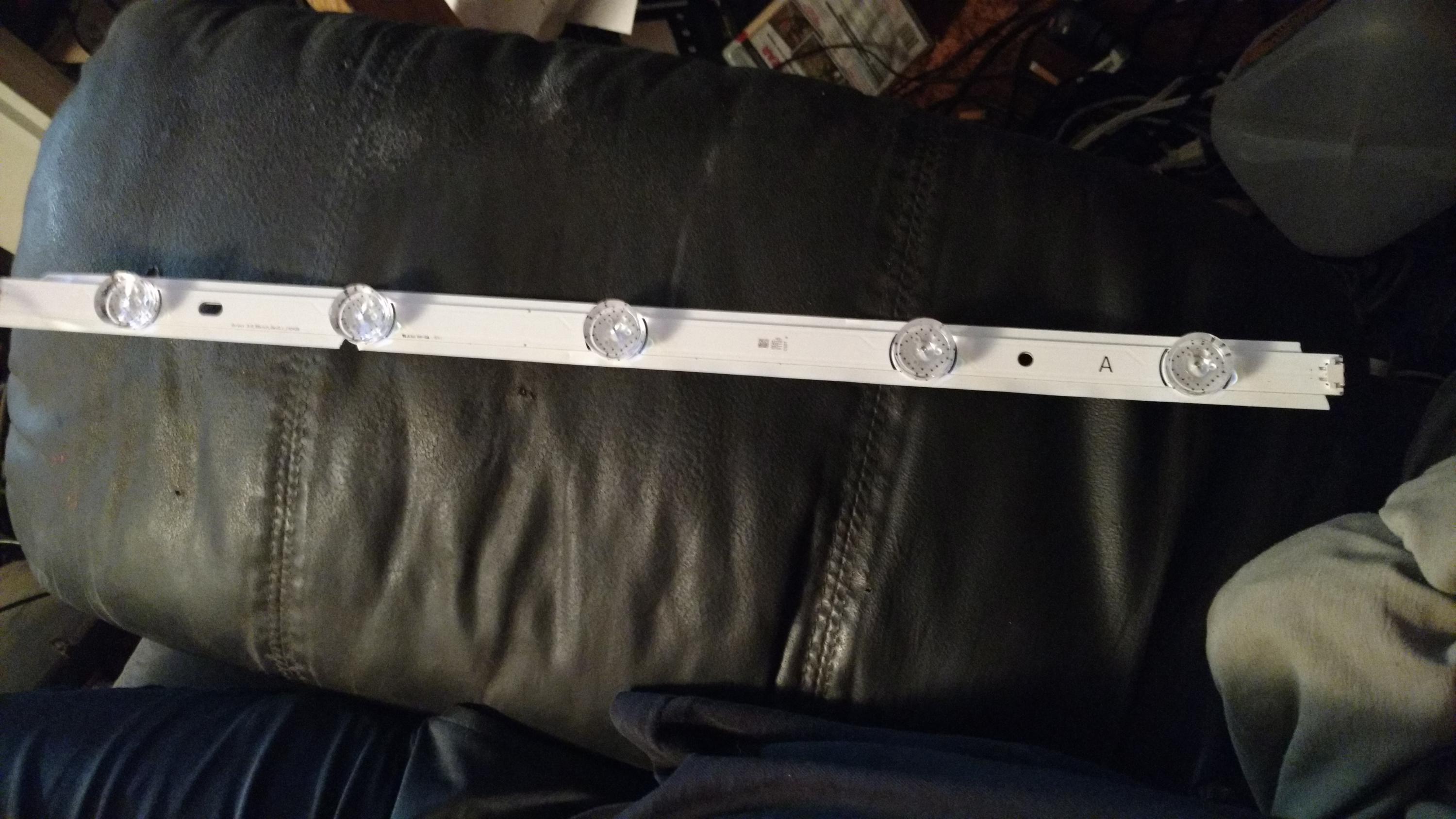

                                Got pics of the strips? I may have them or comparable? Depends more on the panel than the tv....and I do think I have a known good set here. I wont charge much for them.

                                  Re: Vizio fading Light asking for help and Thank you
                                  here is a pic, thanks Oz

                                    Closes thing I have is this, looks very similar. Except polarition lenses are different. There is a whole set of them from one tv, but some strips have 6 leds instead of 5.
                                    Maybe you can make them work?
                                    I'm here and there.....quickest method is 5705071838 to reach me.
                                    I can take pictures of the entire set of strips if you want.
