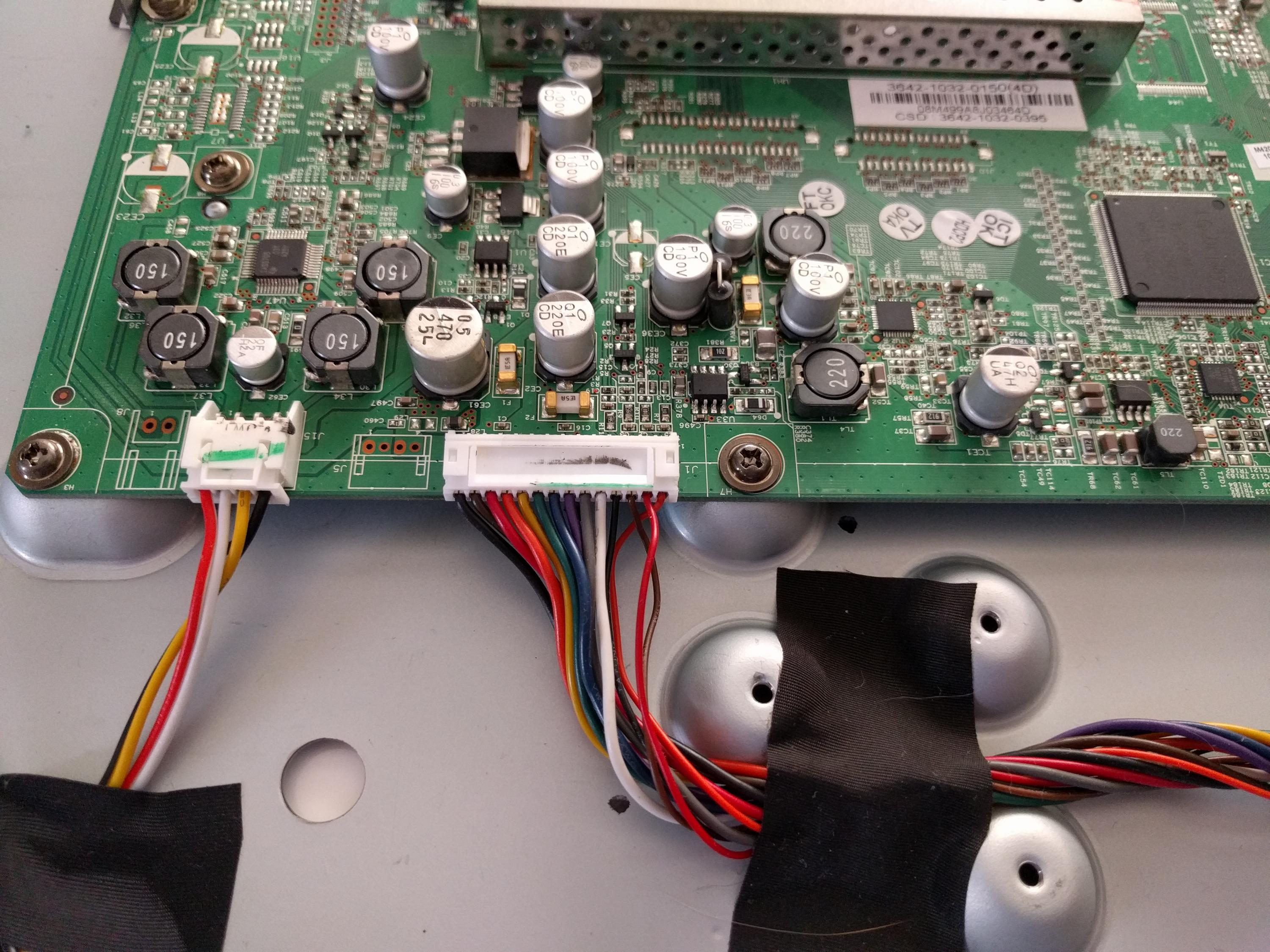

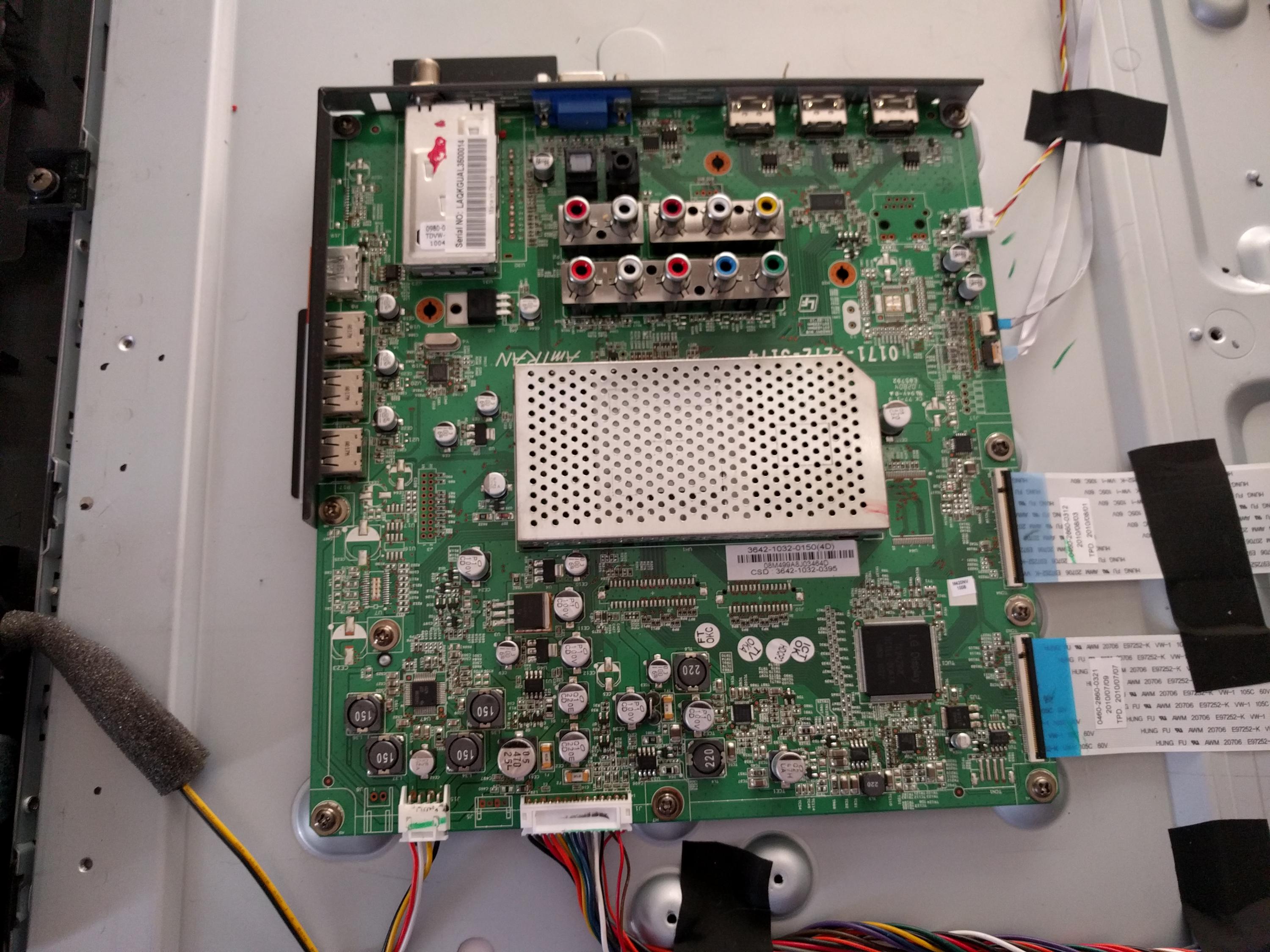

    Hi guys,
    Looking for some advice on a Vizio M420NV. The screen comes on and the tv functions fine, audio and video, but the backlight is completely out. I was only able to tell the picture was still there by holding up a flashlight to it.
    There is never any flicker at all from the LEDs, they completely do not come on. I'm a novice on hardware stuff so any advice on what to test is appreciated. I looked for a BL_ON pin but I cannot find one labeled that, and don't know what it would look like.
    Thanks in advance!

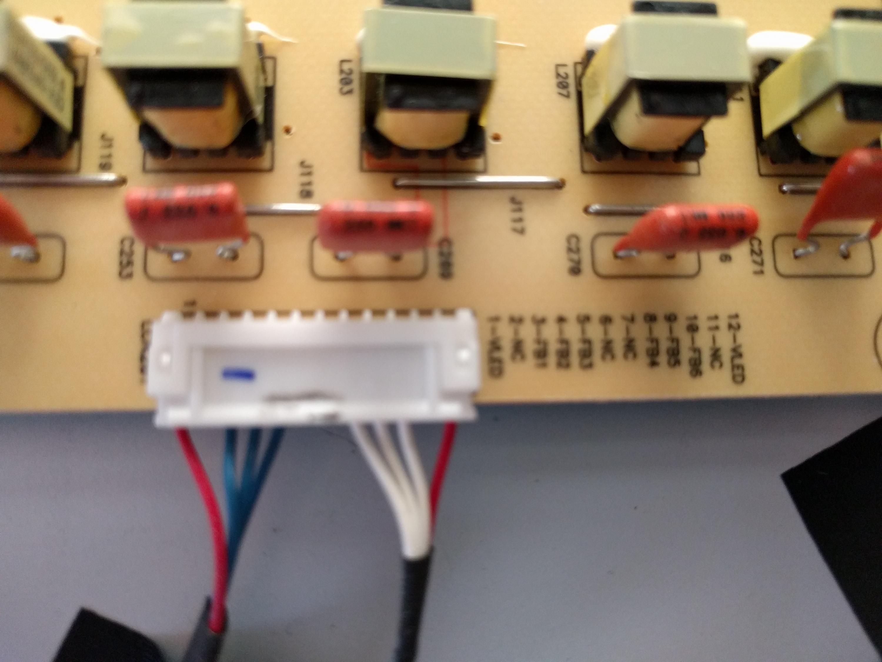

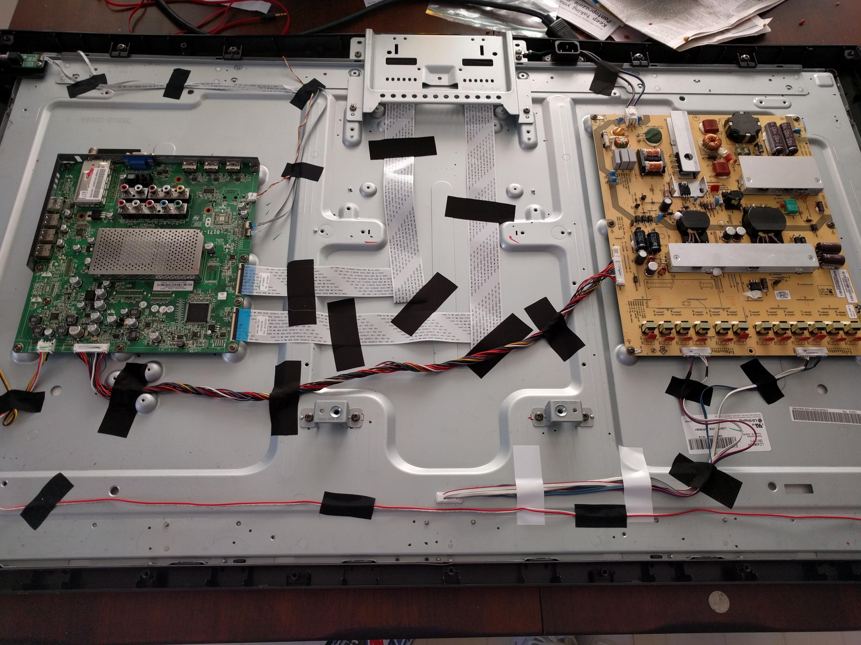

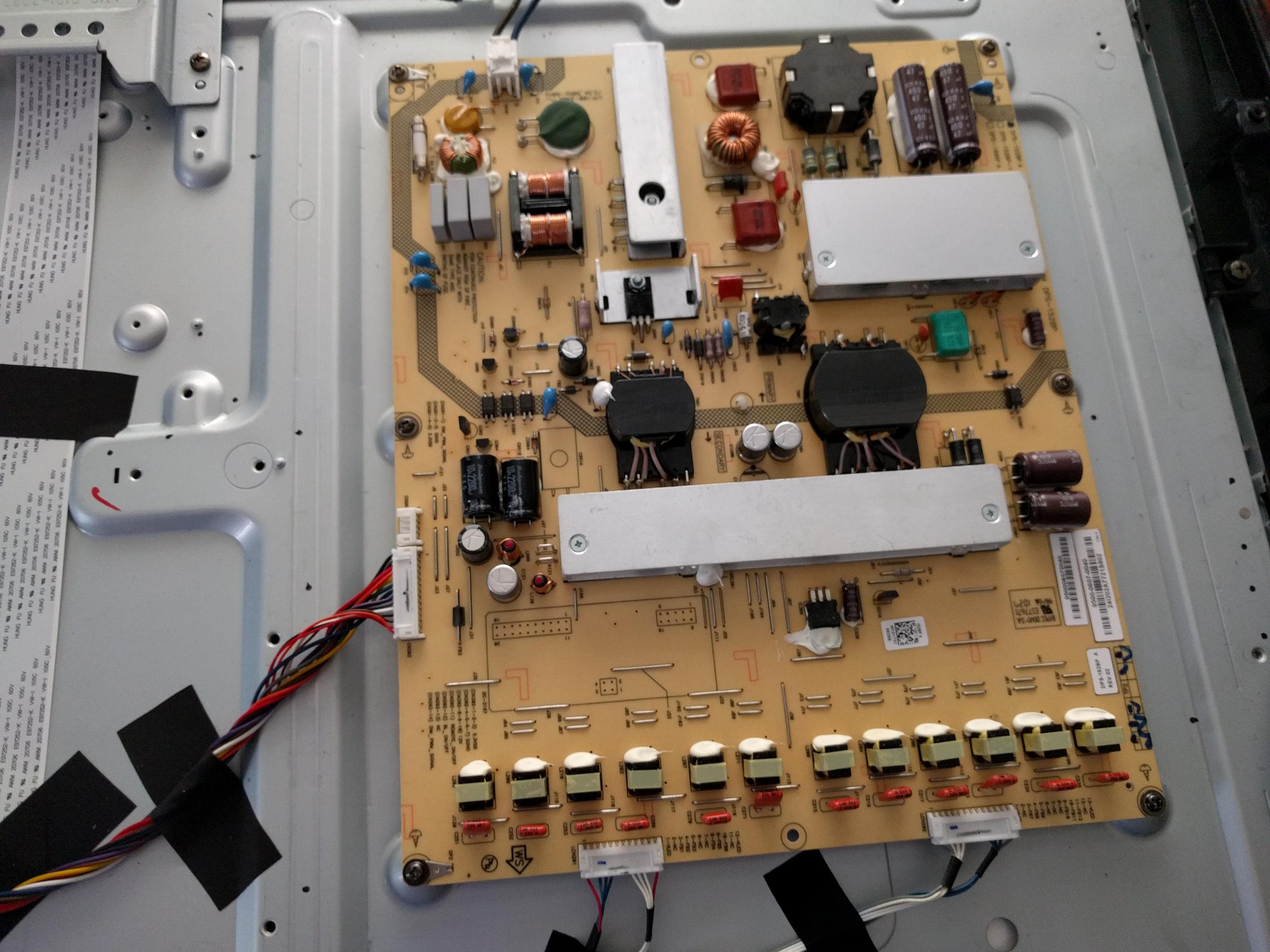

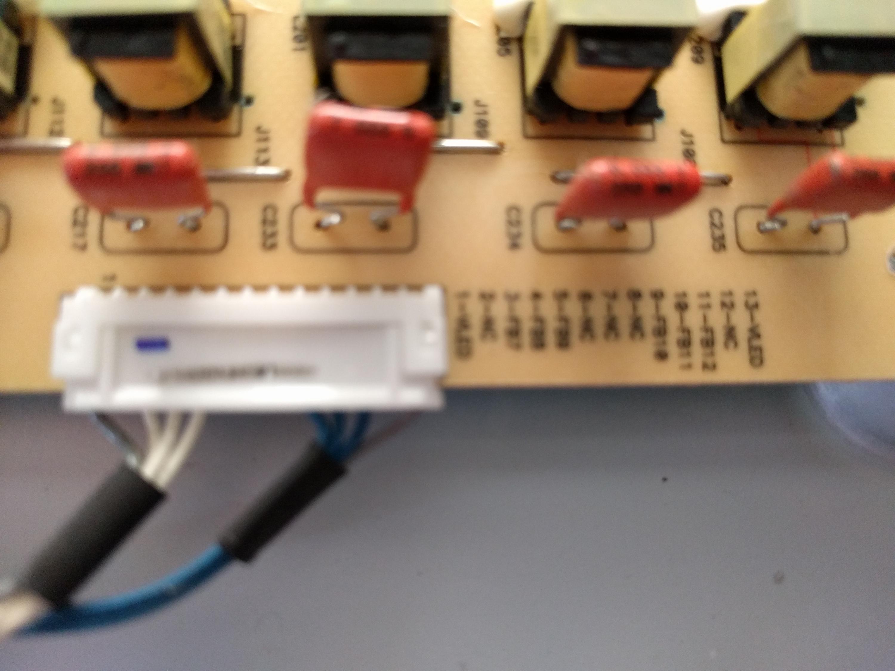

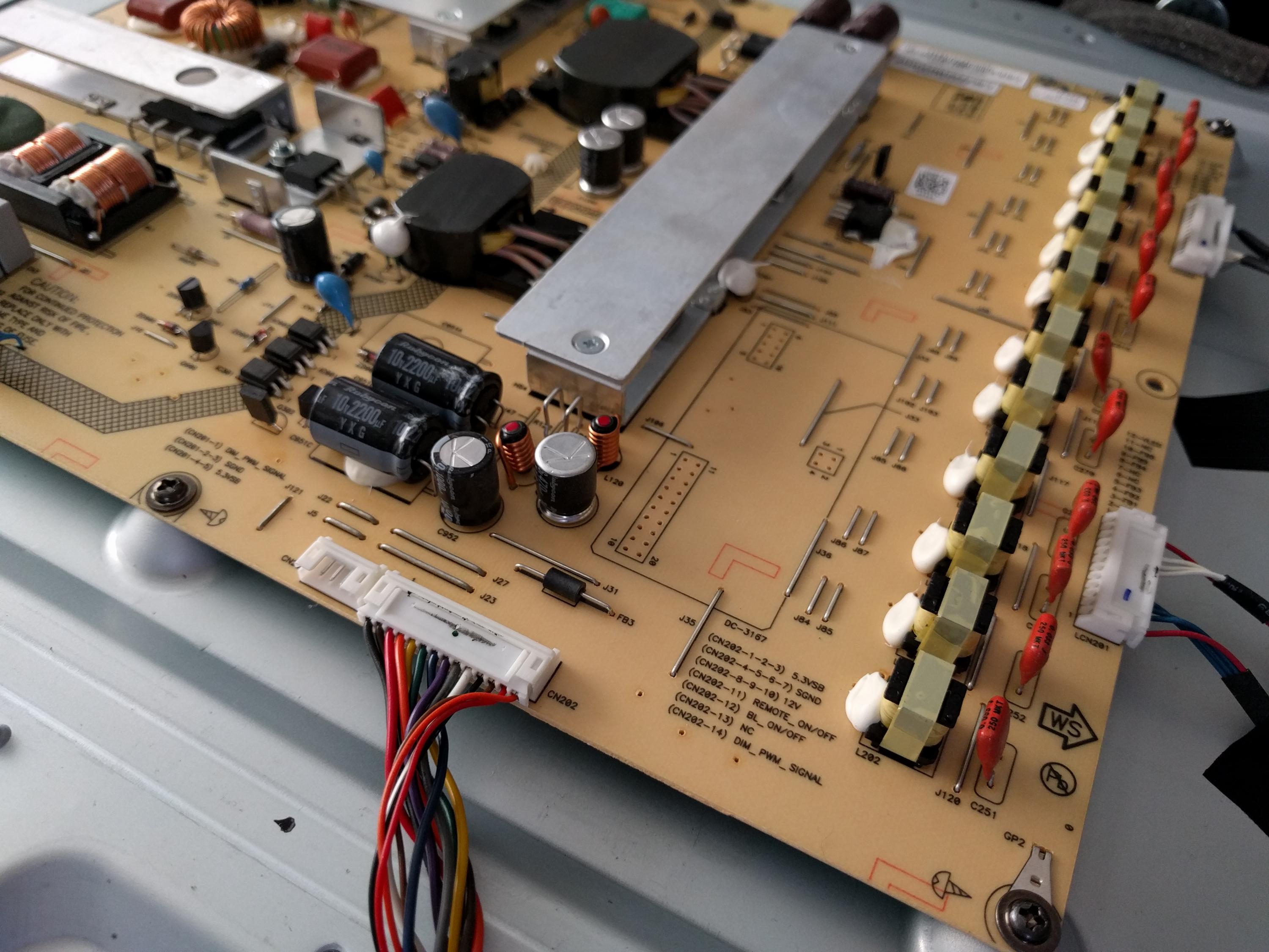

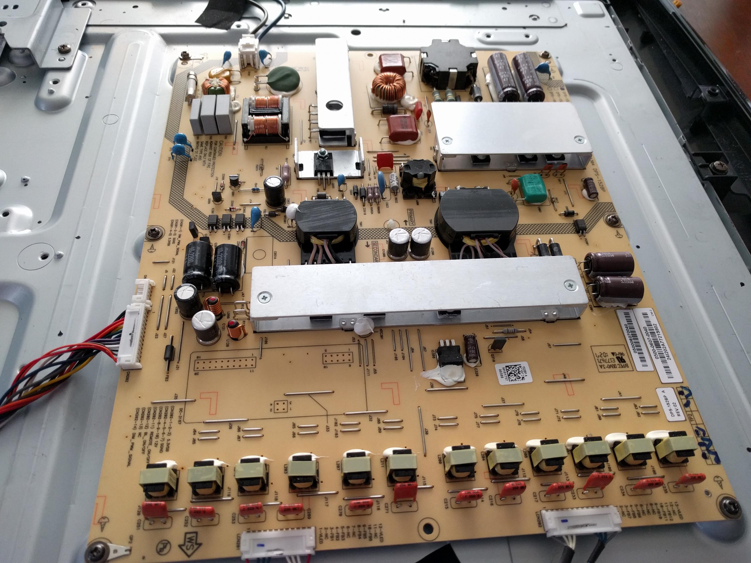

    Re: Vizio M420NV no backlight
    We need good clear pictures of the whole backside of the TV showing all the boards, and then pictures of each board.
    • jman100
      • Aug 2016
      • 5
      Sorry for the delay, here are a bunch of pics.
        turn the tv on and check the DC V on the BLon pin.
        • jman100
          • Aug 2016
          • 5
          Once again sorry for the delay.
          BL_ON shows .03 volts while the tv is off, and goes to .12 when the tv is turned on.
          • CapLeaker
            Leaking Member
            • Dec 2014
            • 8352
            That sux. Main board isn't sending BLon signal...
            since the tv comes on and the backlights stay off, it's a bad EEPROM on the main board.
            Your choices are to get a new replacement main board, or buy the repair kit at Shopjimmy for your board number 0171-2272-3174. You would have to change 2 two ICs (U14 and U33) on the main board. U14 fixes the frozen on welcome screen, U33 is for the backlights.
