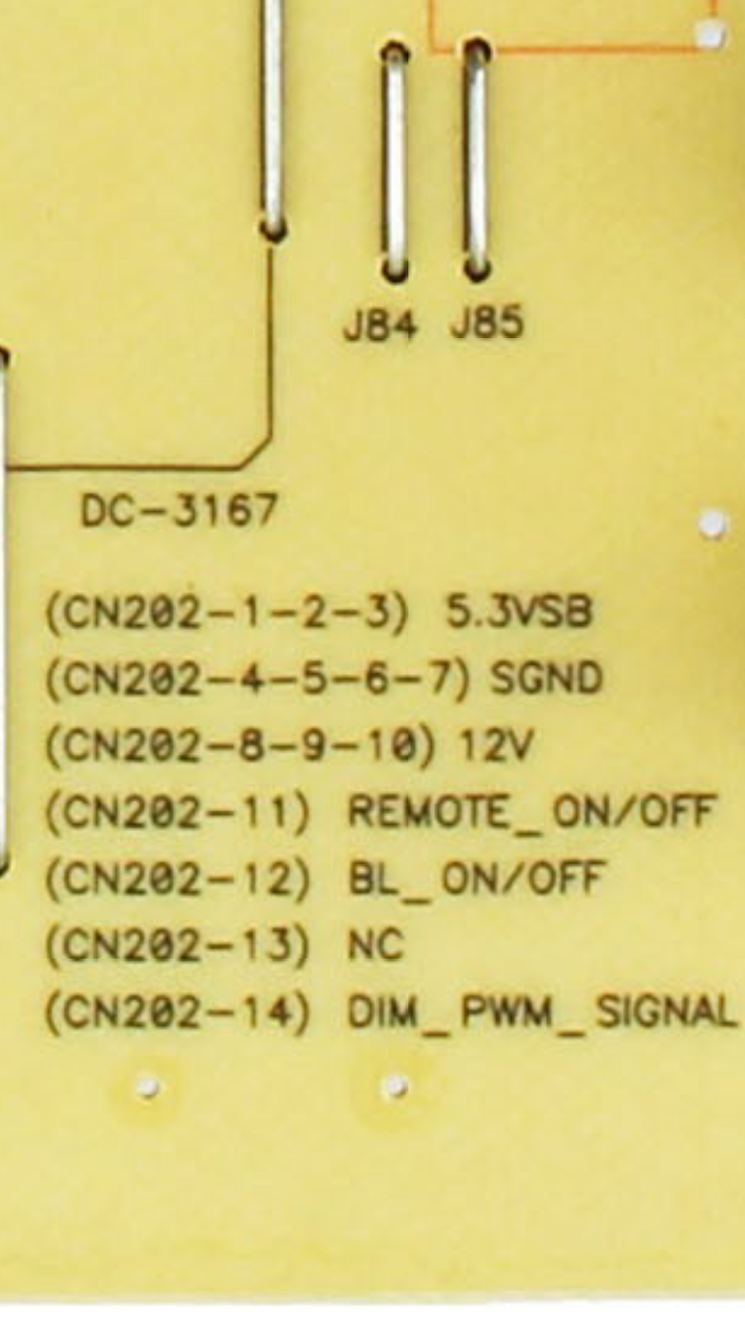

    There's some other things you can test on the mainboard, looks like you need to know why the mainboard isn't sending the bl_on signal.

        If you can force the backlights on using the resistor, then you can disconnect just the BL-ON signal wire going back to the main board and put all the connectors back in place, and then keep the pull-up resistor for the BL-ON pin on the power supply board in place, power up the TV and everything should then work normally if the BL-ON signal is the only problem on the main board.

          Nothing happens when I disconnect the motherboard from the power supply and plug in.
          In regards to the resistor test in post #8, my board lists no "PS_ON," as far as I can see. Are any of these other pins indicators of a ps_on?

            The backlights do come on with a 1k between BL_ON and 5VSB!

                    If you trace the bl_on wire from powersupply back to mainboard so you know which pin it is, unlpug connector at mainboard and see what voltage you have there, I always unplug tv first then unplug connector from mainboard then plug tv back in, to try not getting any strange surges.

                                    Budm, that's what I did this morning, and the backlights work great! Ran off my Raspberrypi just fine. Thanks for the input.
                                    I had only a minute before work, so haven't been able to play with the other posts yet. I want to see if I can gain some experience isolating the culprit component(s) with some more precision.
                                    If it promises to be too frustrating or expensive, I'll just jam that resistor back in.
                                    That will keep my sunk cost at $25.01...not too shabby.

                                      We can use other signal as the BL-ON.

                                          You can use T-CON ON signal for BL-ON.
